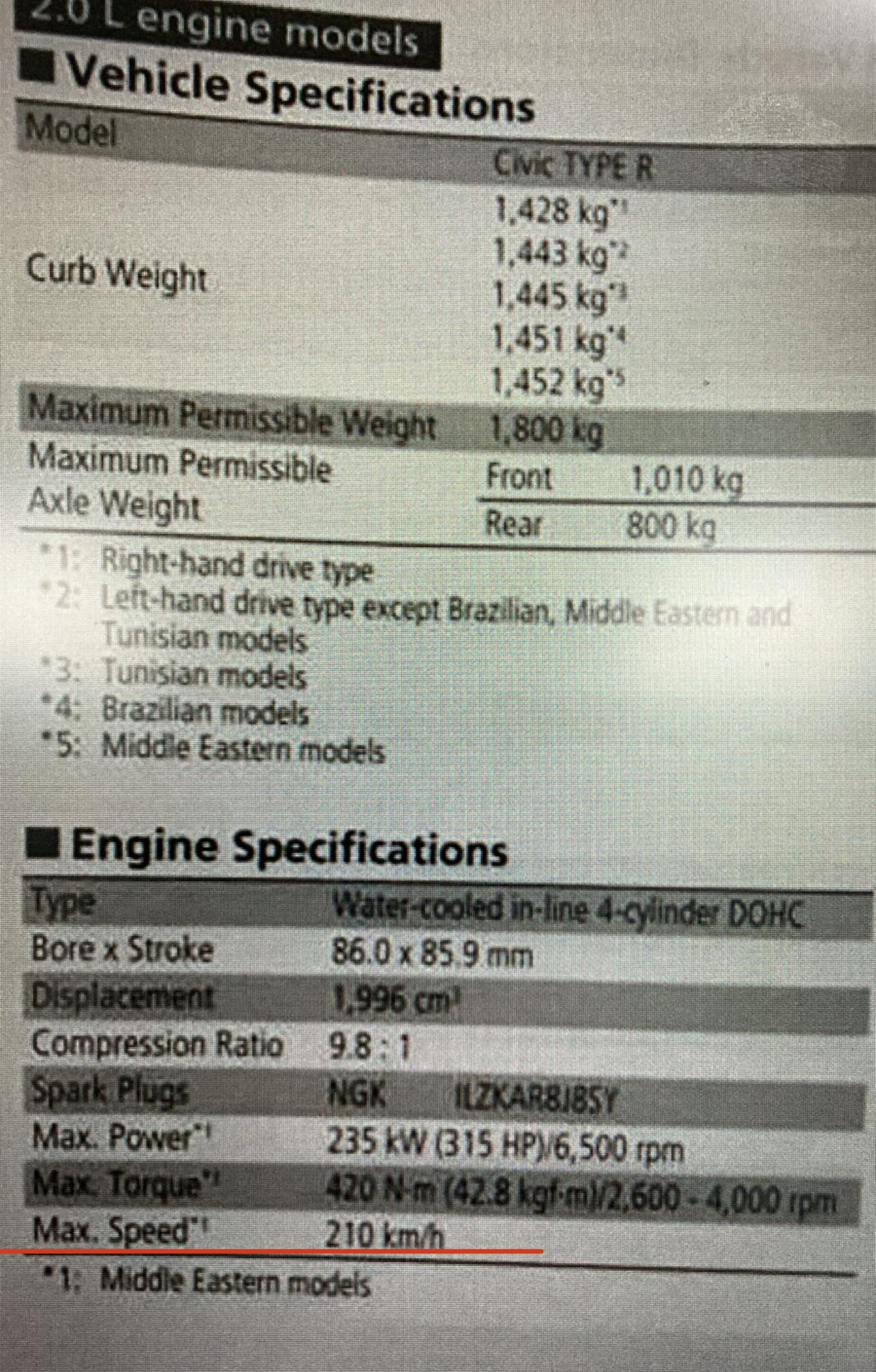

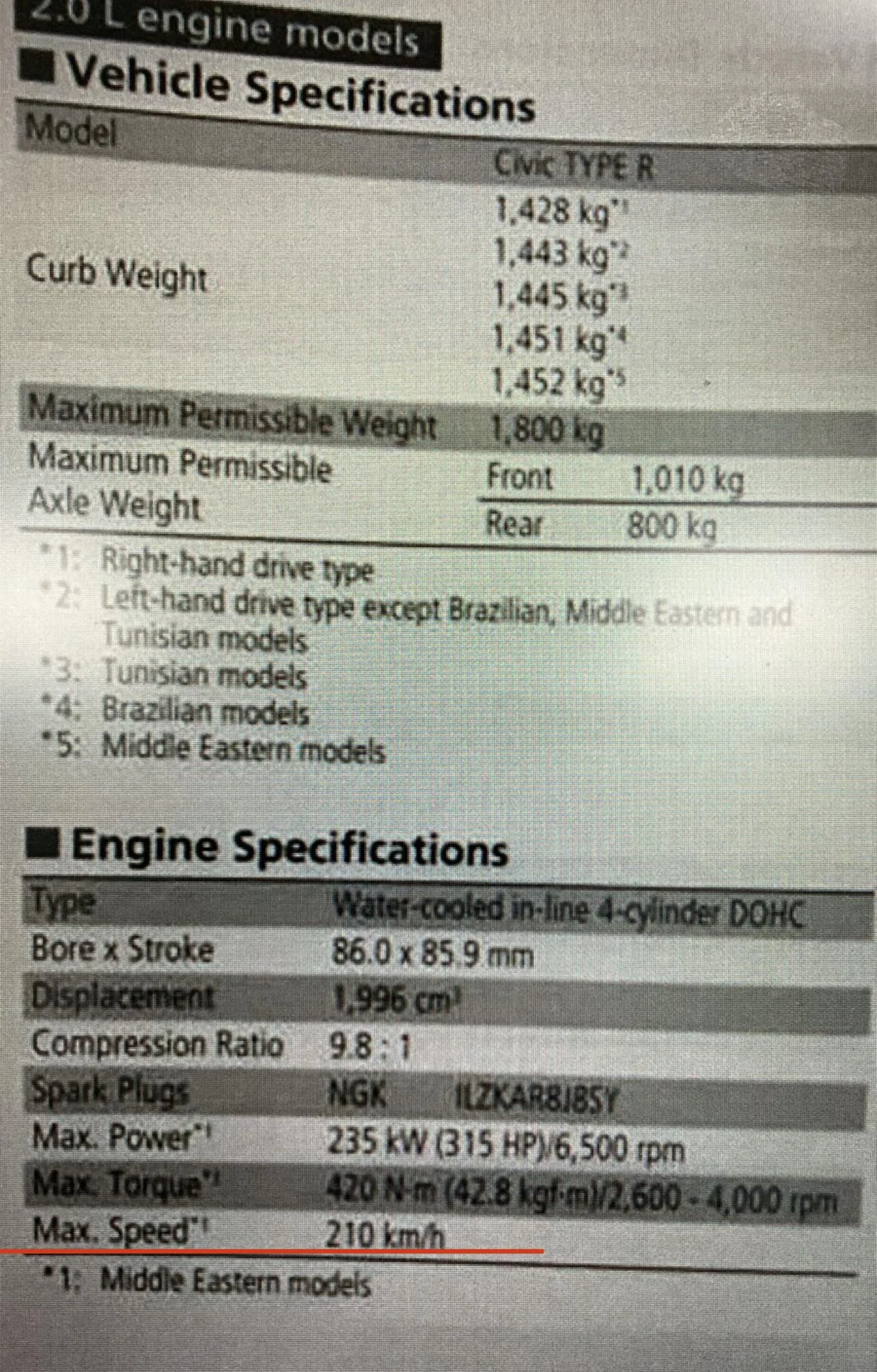

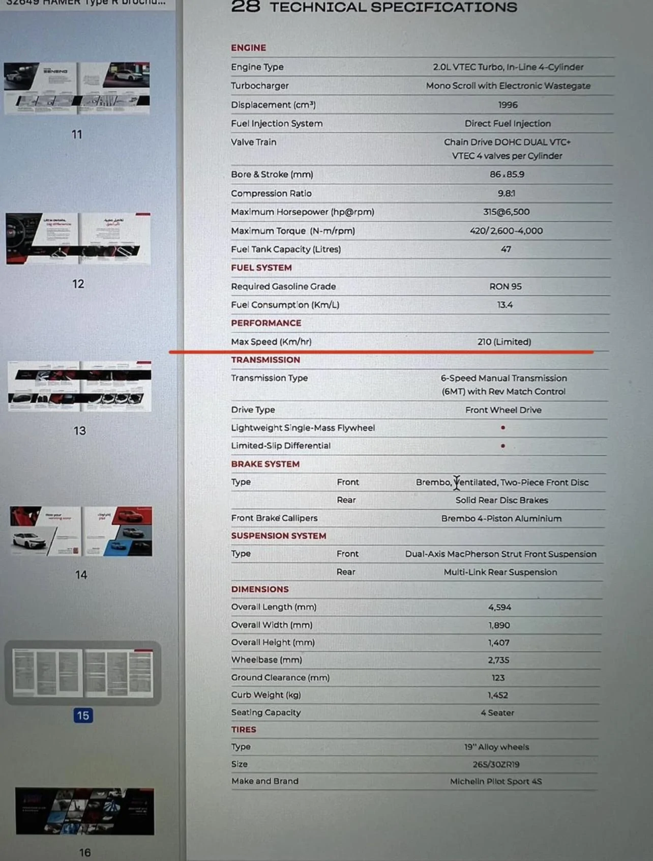

MashTypeR
Mashhur
Dec 12, 2023
Mashhur34
FL5 Type R
I'm from the middle east ( SAUDI ARABIA) and I have a civic type R FL5 AND YES I can confirm I have the same issue with speed limiter 220 is the max speed I just tried it past weekend and was surprised.
Road & Track did a test recently to see how long it would take for each car in the test to go from 0 to 150 mph (~241 kmh) then back to 0. It took the FL5 52.7 seconds. It is limited by gearing and aerodynamics. This car is built and geared for curvy tracks, not straight line speed. I think if you keep pressing on the gas you can continue to 150 mph + if you have enough straight road to drive on and no headwind.
https://www.caranddriver.com/features/a45765845/honda-civic-type-r-0-to-150-to-0-speed-test-2023/
11th Gen Honda Civic max speed restriction at 220kmh ( Middle Eastern models ) C95BAF1C-2DE4-4965-841C-C85F76662E97
11th Gen Honda Civic max speed restriction at 220kmh ( Middle Eastern models ) 40ADA929-E528-489B-955B-BE6B0A833AF6
TypeRD
Jan 20, 2023
1,210
1,224
IL
Wow. Must be some kind of government regulatory thing in your country. You’ll probably have to jailbreak the ECU and get a tune to bypass the 210 kmh limiter. This could get you in trouble if you have yearly car inspections as I’ve heard some countries do.
