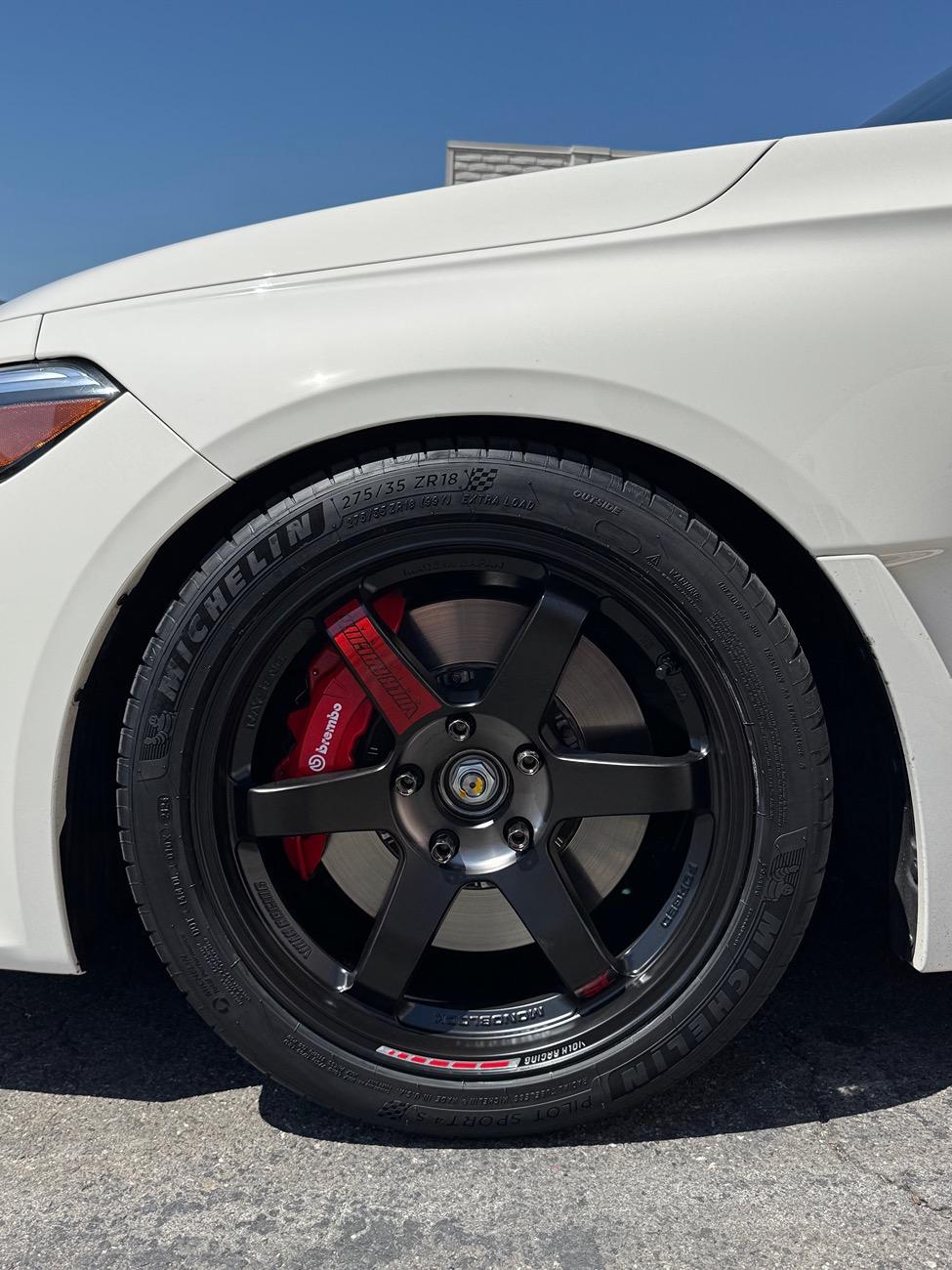

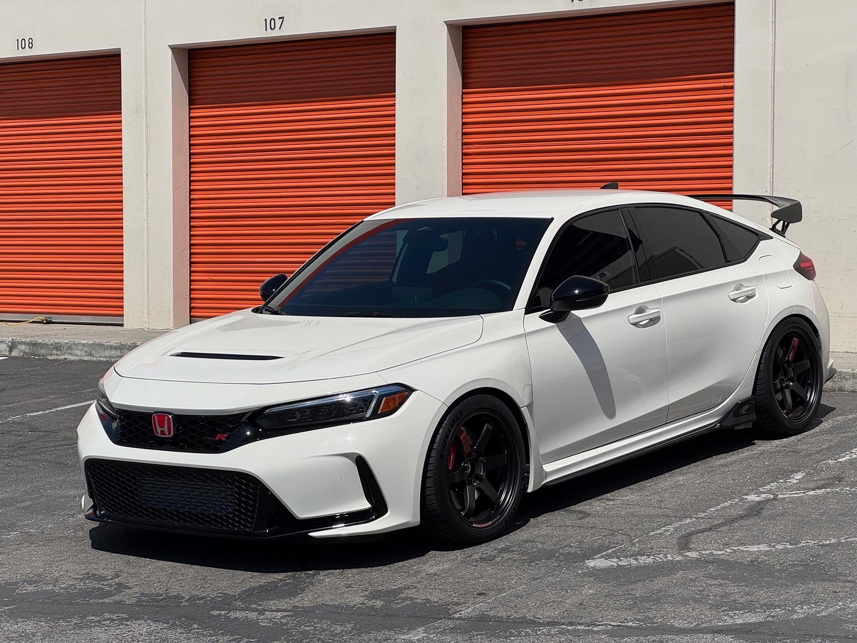

Got my TE37SL Black Edition III's from System Motorsports. Car is filthy in these photos (especially rear fender). Going to install Hardtrace lower ball joints for extra 1.0 of negative camber in the next two weeks, can give update then. No rubbing just that I want more than then 1.7-1.8 stock with pins removed gives.
18x9.5 +37
Michelin Pilot Sport 4S 275/35/18
Spoon Springs

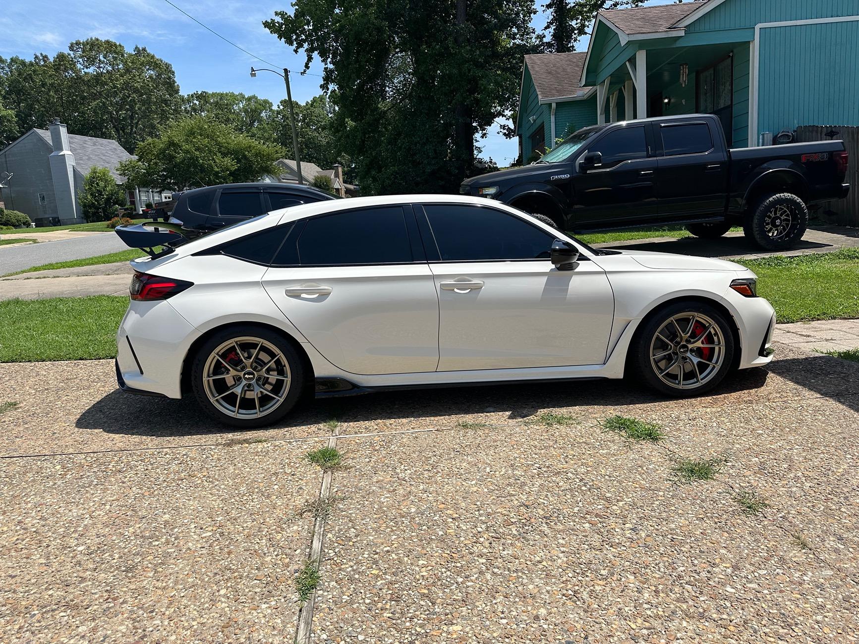

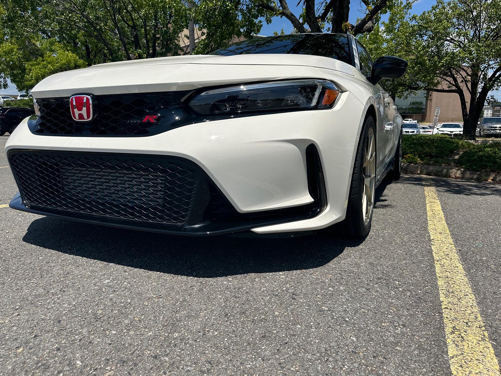

Would Enkei Kojin 18x9.5 +35 be an issue? Stock suspension, tire size 265/35/18. Enkei site does show they make them in +45 but seems most online stores only list +35.
icemansi
Rob
Jun 9, 2019
177
90
Chesapeake VA
This is +45 with 265/18 and there is plenty of room so I’d say you’d be fine
