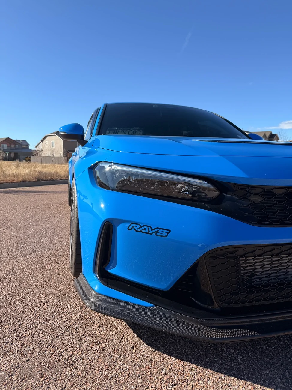

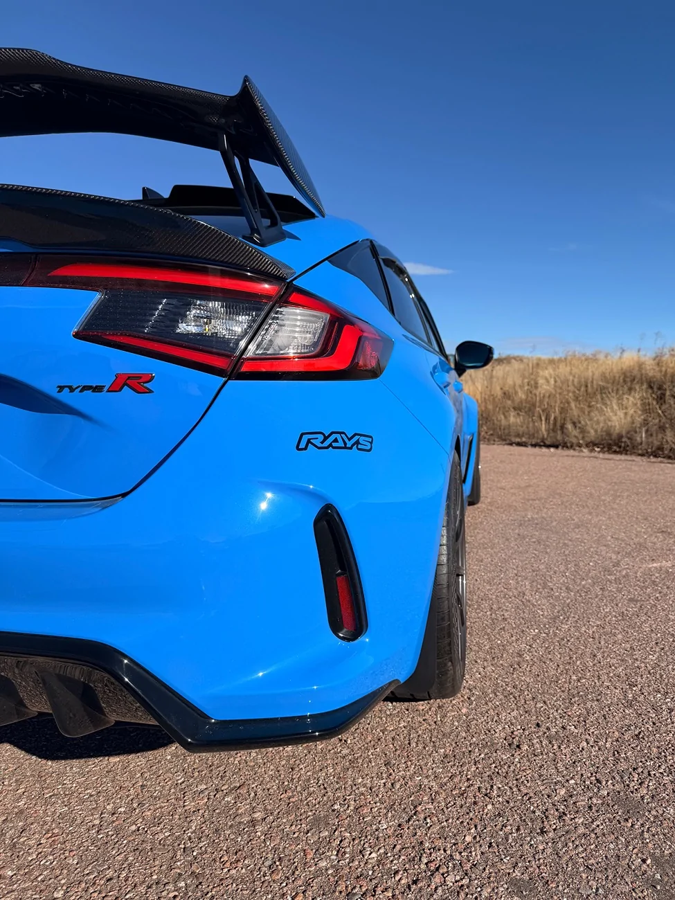

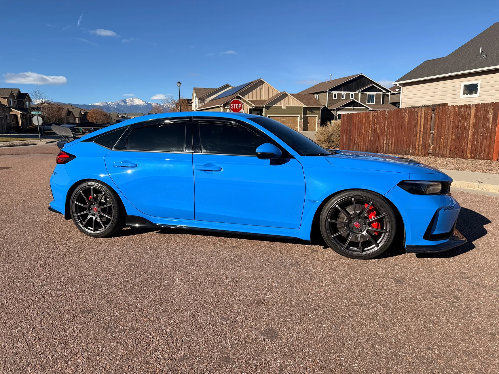

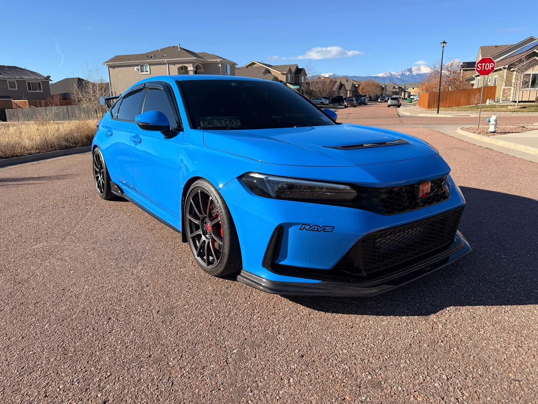

1. Year and model:
2. Wheels/offset:
Front & rear: 19x9.5 Honda Modulo Accessory Forged Wheels 08W19-T60-100, ET +60
3. Tire size:
Front & rear: OEM Michelin Pilot Sport 4 S 265/30ZR-19 93Y XL)
4. Suspension:
Eibach Pro-Kit Performance Springs
5. Wheel Spacer Brand and Size:
Front & rear: AeroflowDynamics’ 20mm Hubcentric Wheel Spacers
6. Clearance (i.e., Does it rub? If so, when?)
No rubbing experienced so far. Natural camber, no correction parts.
7. Wheel Studs
Front & rear: Stock
8. Insert photos. Don’t mind the Rays stickers, took my CE28SL’s off for these. Not gonna remove/apply stickers every time I swap wheels. lol.
11th Gen Honda Civic The FL5 Civic Type R Wheel Spacer Reference Thread IMG_3719
11th Gen Honda Civic The FL5 Civic Type R Wheel Spacer Reference Thread IMG_3720
11th Gen Honda Civic The FL5 Civic Type R Wheel Spacer Reference Thread IMG_3721
11th Gen Honda Civic The FL5 Civic Type R Wheel Spacer Reference Thread IMG_3722

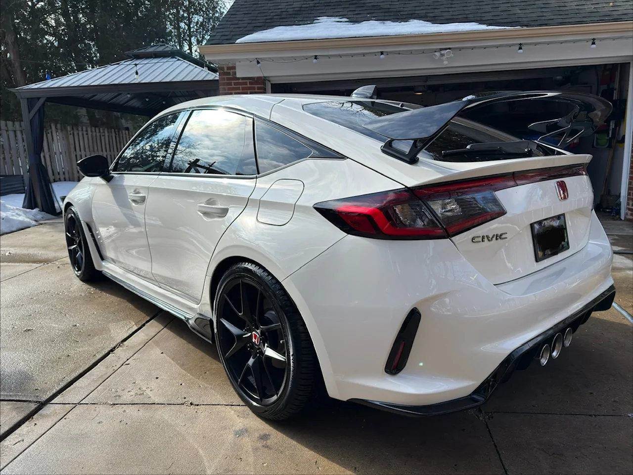

1. Year and model:
2025 Civic Type R
2. Wheels/offset:
Front: Factory: 19x9.5, OEM, +60 w/ 13mm spacer
Rear: Factory: 19x9.5, OEM, +60 w/ 15mm spacer
Front: Forged TDP5: 18x10", +52
Rear: Forged TDP5: 18x10", +52 (maybe 5mm spacer)
3. Tire size:
Factory:
Front: Vredestein Hypertrac 275/35-19
Rear: Vredestein Hypertrac 275/35-19
Forged:
Front: Kenda UHP Max+ 305/35-18
Rear: Kenda UHP Max+ 305/35-18
4. Suspension:
Stock, but adding J's racing .8" drop front and rear (removing spacers for 19" wheels)
Front: Akata 13mm
Rear: Akata 15mm
Factory
Front: Flush, nice small gap
Rear: Flush, small gap
Forged: UKNOWN yet....coming soon
7. Wheel Studs
Front: Stock (Racesang lugs)
Rear: Stock
8. Insert photos
11th Gen Honda Civic The FL5 Civic Type R Wheel Spacer Reference Thread IMG_3369

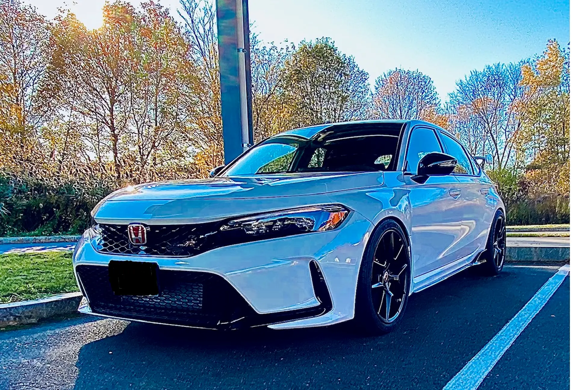

2024 Championship White FL5
H&R Springs - H&R Spacers 20MM (F) - 25MM (R)
