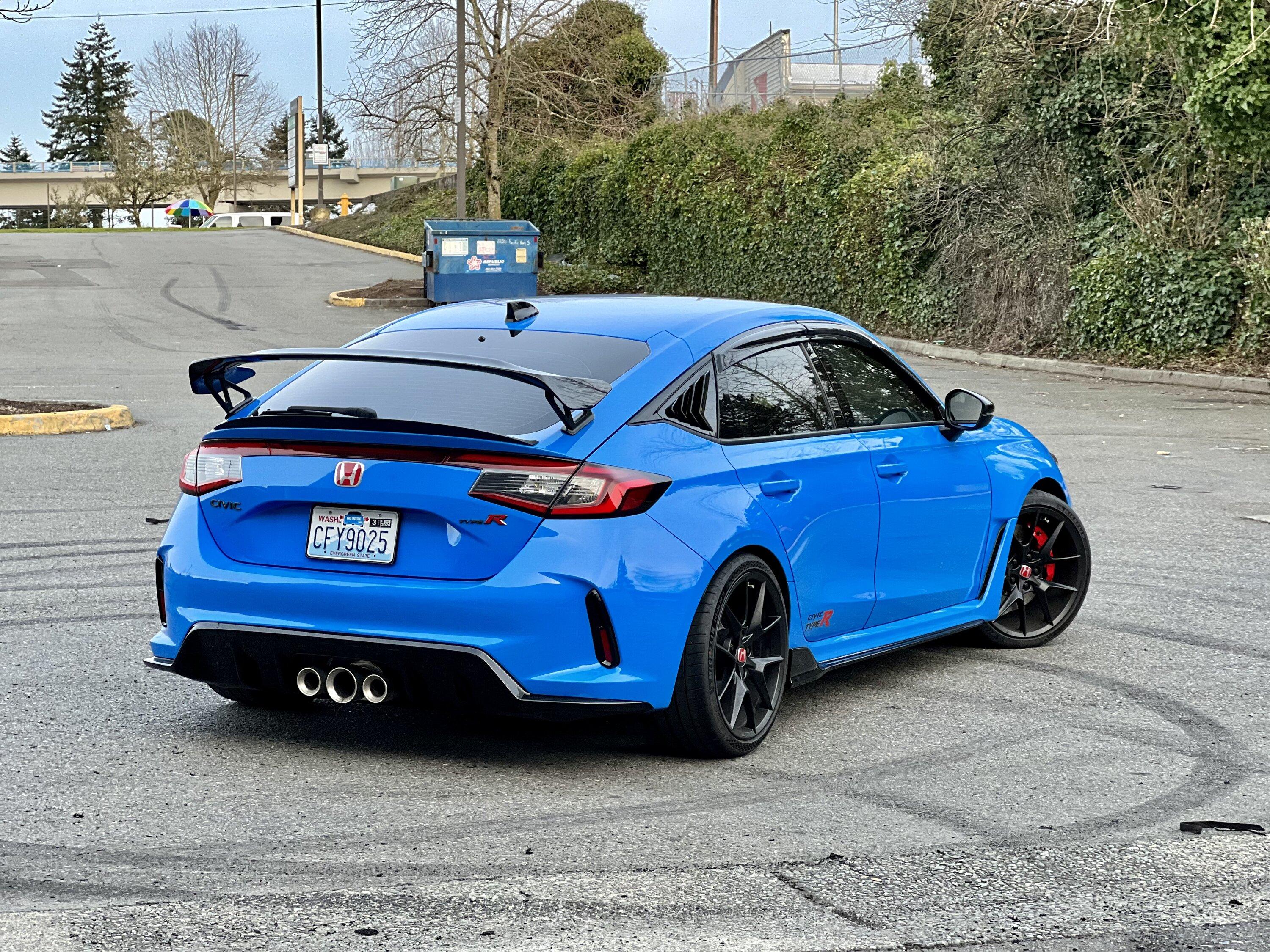

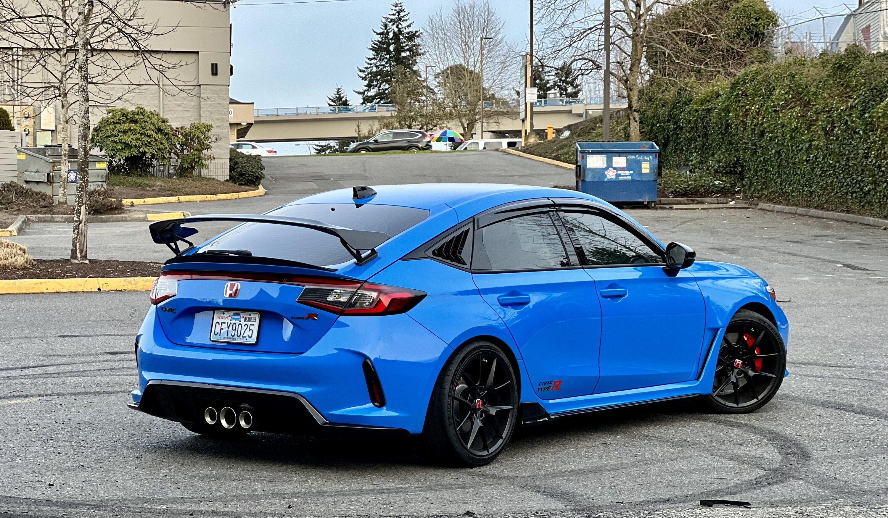

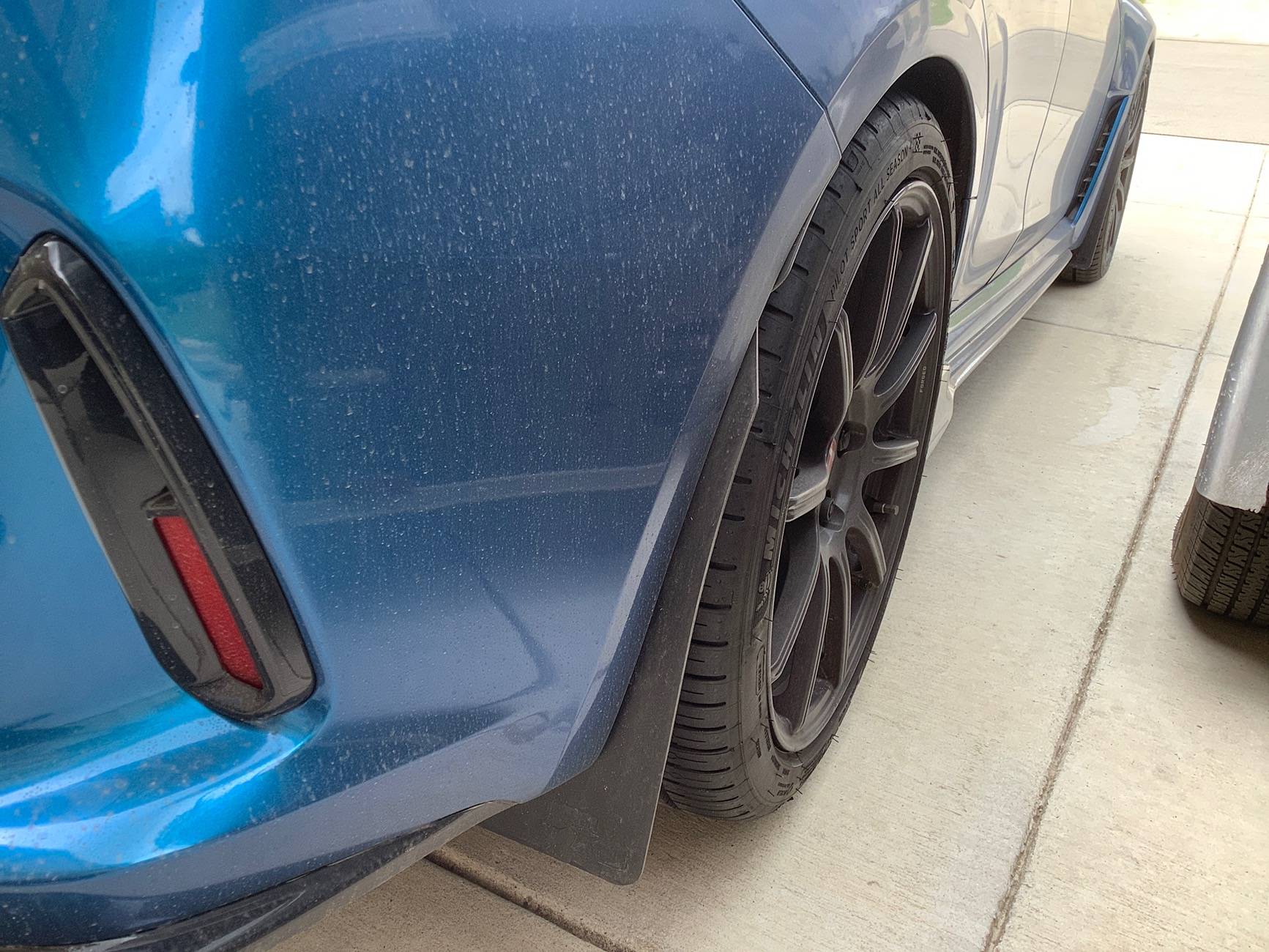

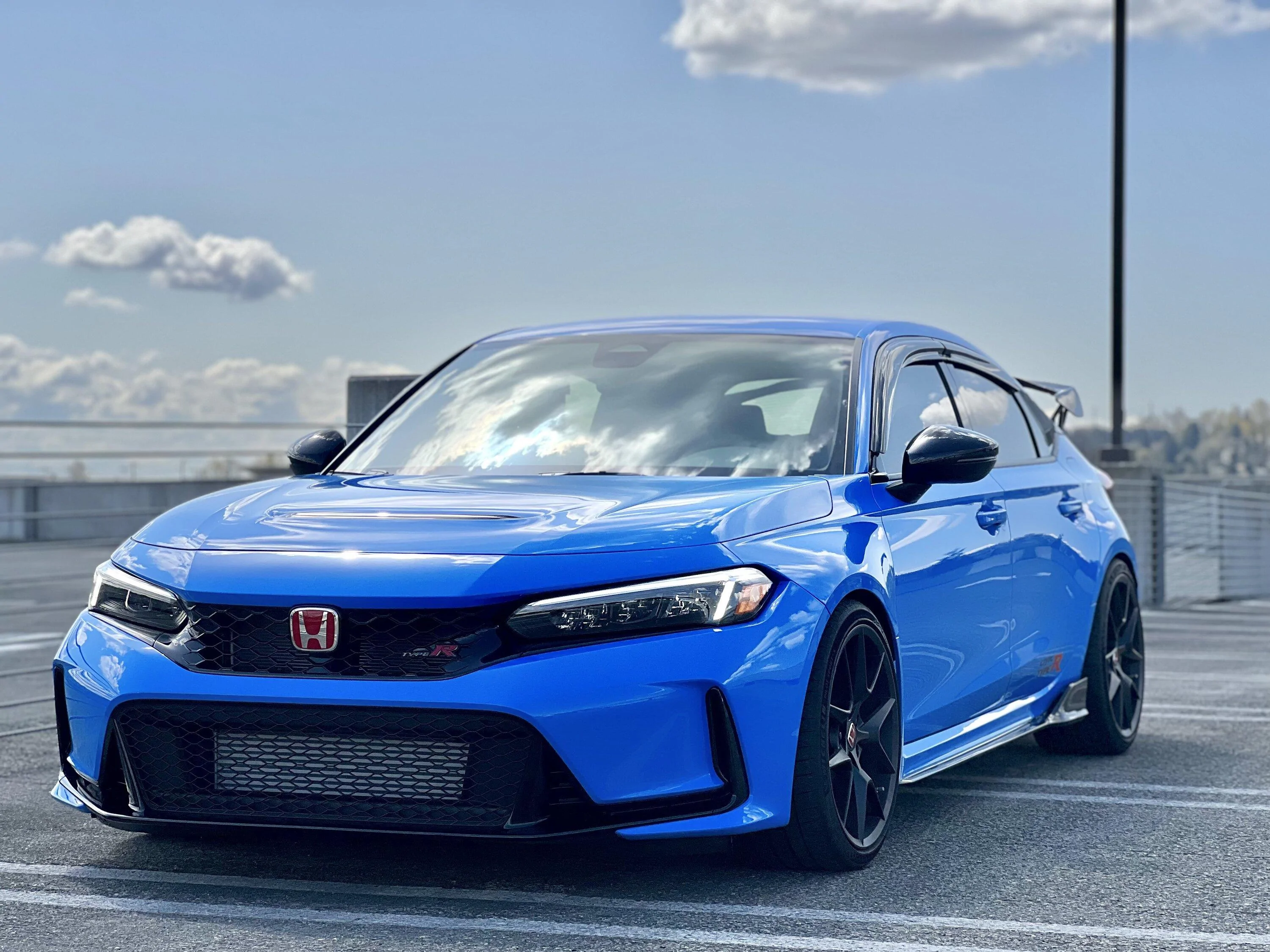

Swapped the stock wheels back on with 20mm spacers front and rear with Swift Springs.

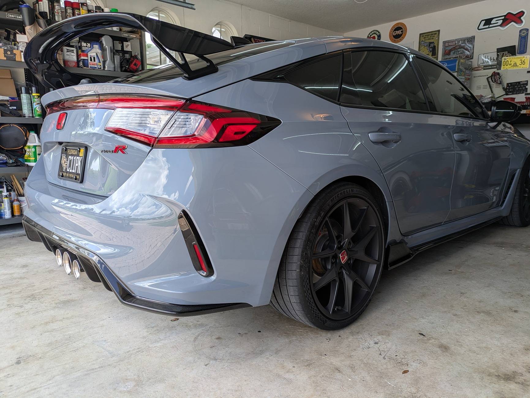

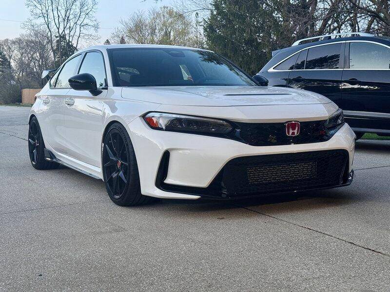

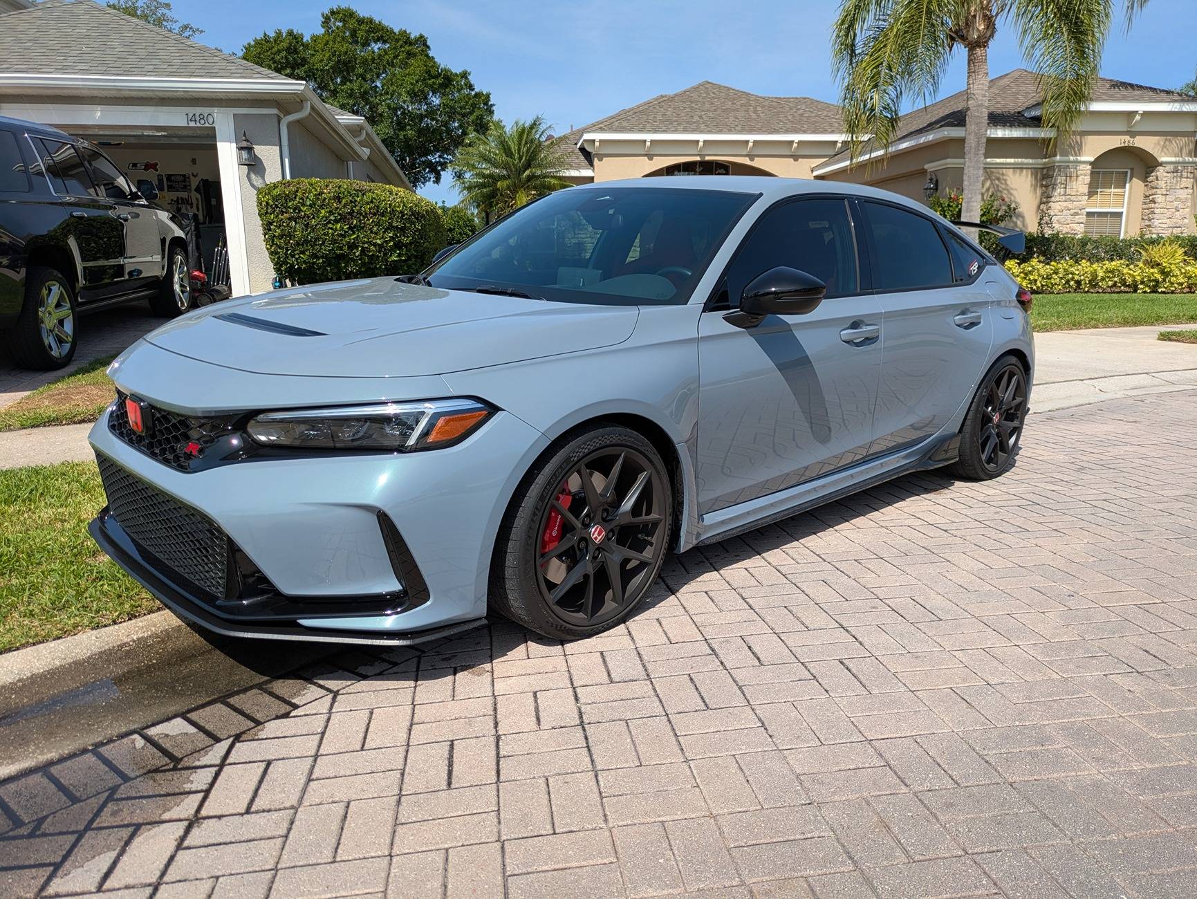

These are Bonoss spacers but they are 20mm all around, so the fitment will be the same.
Spacer have been the best looking modifications yet.

Thanks! Your car looks super neat :) . Do you have a pic of the rear arch side profile that you could share? I'm just weighing up 15mm vs 20mm. Just afraid that 20mm might be too flush with the body if that makes sense.

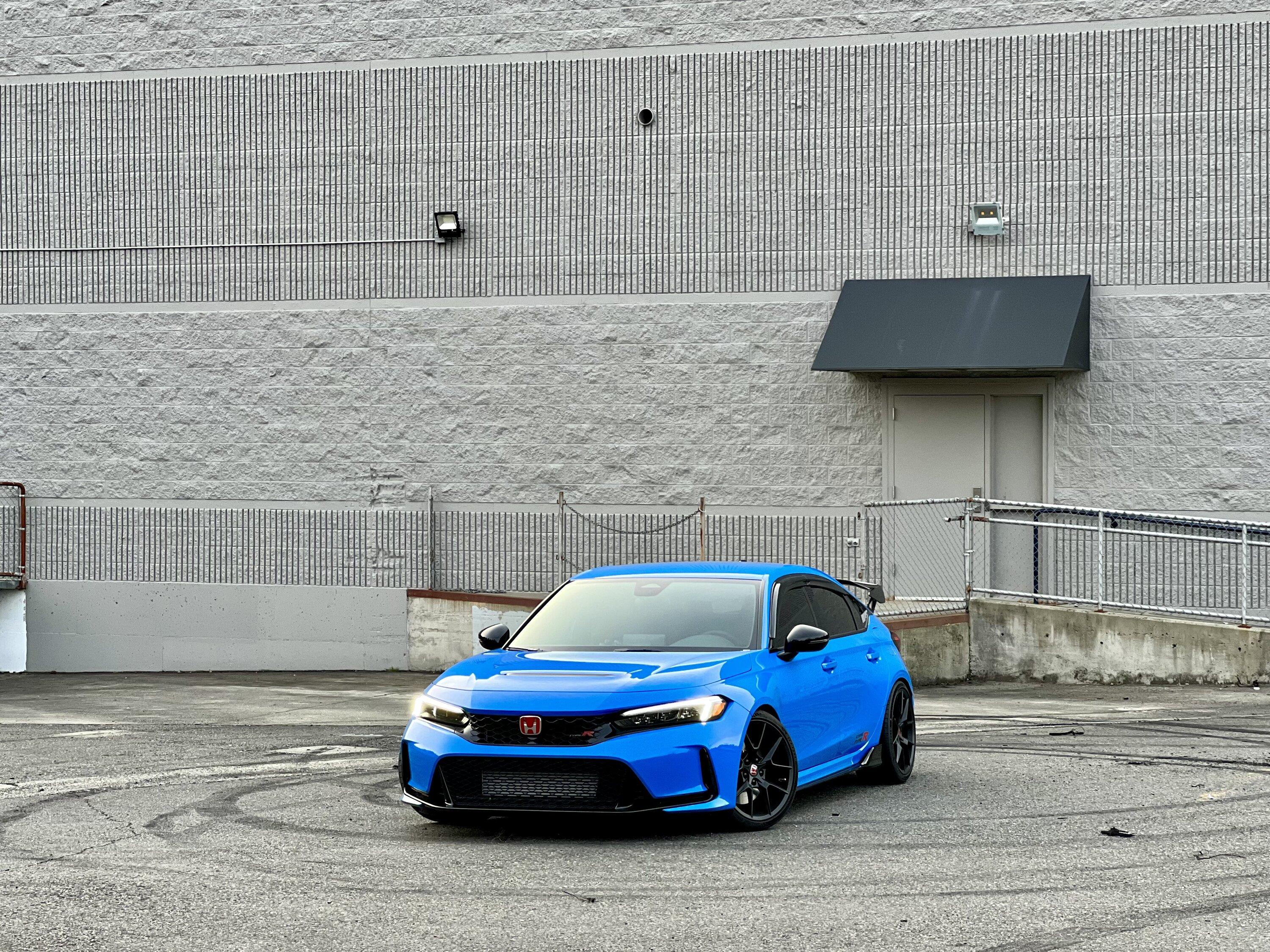

This might be more of what your asking. IMO 20mm is perfect, no poke at all just flush fitment

20mm is exactly flush on the front. The rear could use an additional 2-3mm to be perfectly flush. I have Bonoss with 20mm all around and am happy with it.

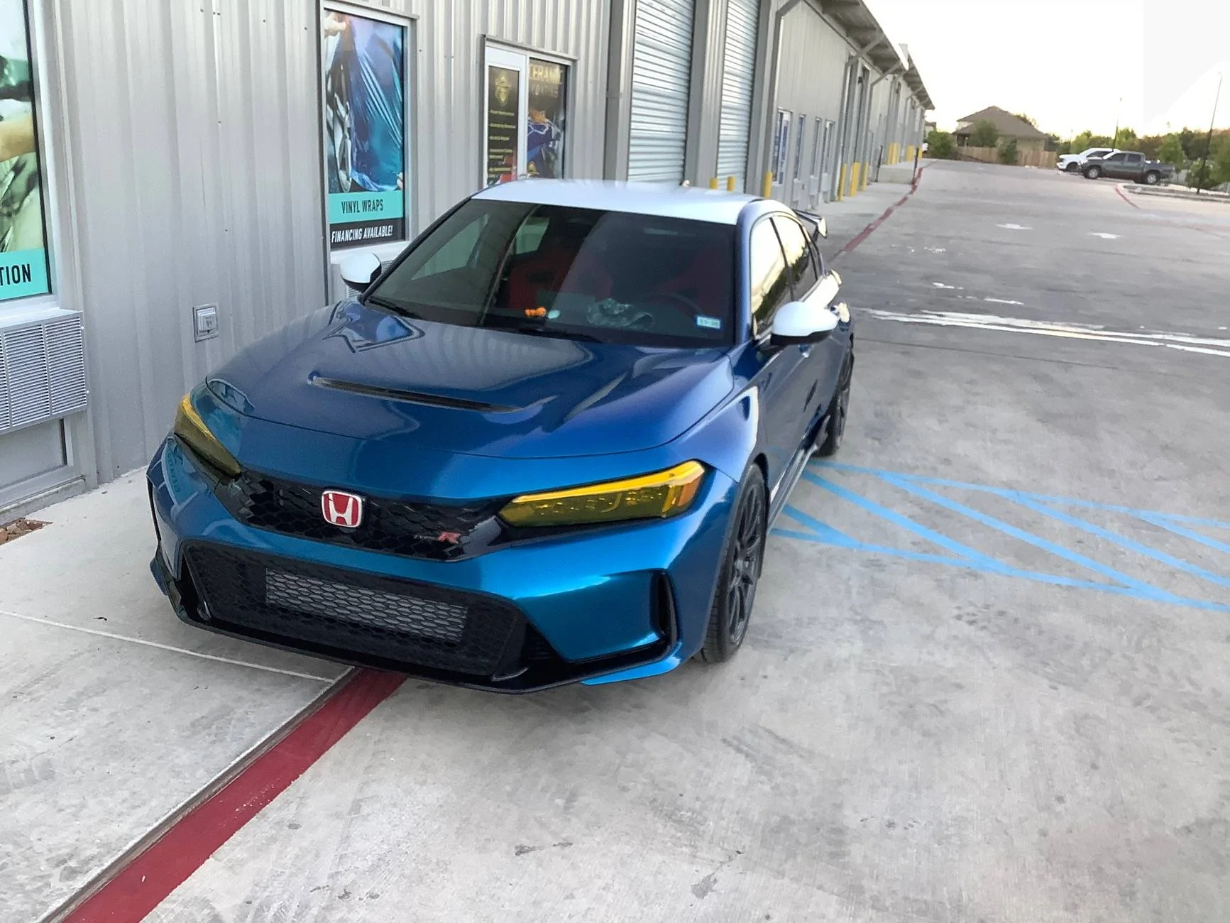

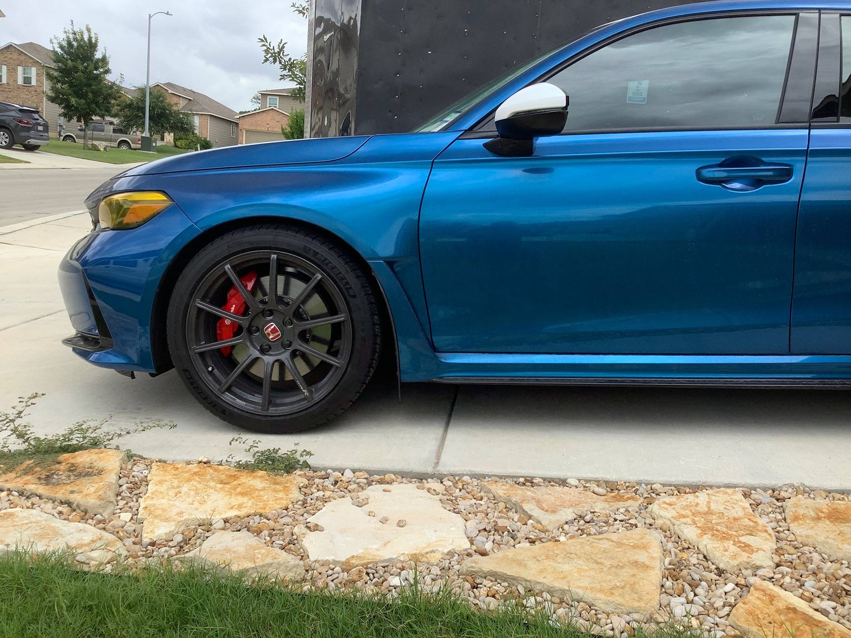

One of the first items I wanted to address on the FL5 is the less than ideal wheel offset. I didn't want to turn to aftermarket wheels since I'm a huge fan of the 19-Inch Matte-Black Alloy OEM wheels. I decided the best path forward is to explore wheel spacers to move the wheels and tires outwards so they are more flush with the fender. The question that often arises is, "What size wheel spacer should I run to achieve the desired stance?" The answer is: It's a matter of personal preference. This thread will serve as a reference to help make that decision a little easier.
I will get us started.
Thanks for starting this thread, Clark.
Never thought I'd be here, because I never thought I would buy spacers, yet here we are.
Never Say Never Again.

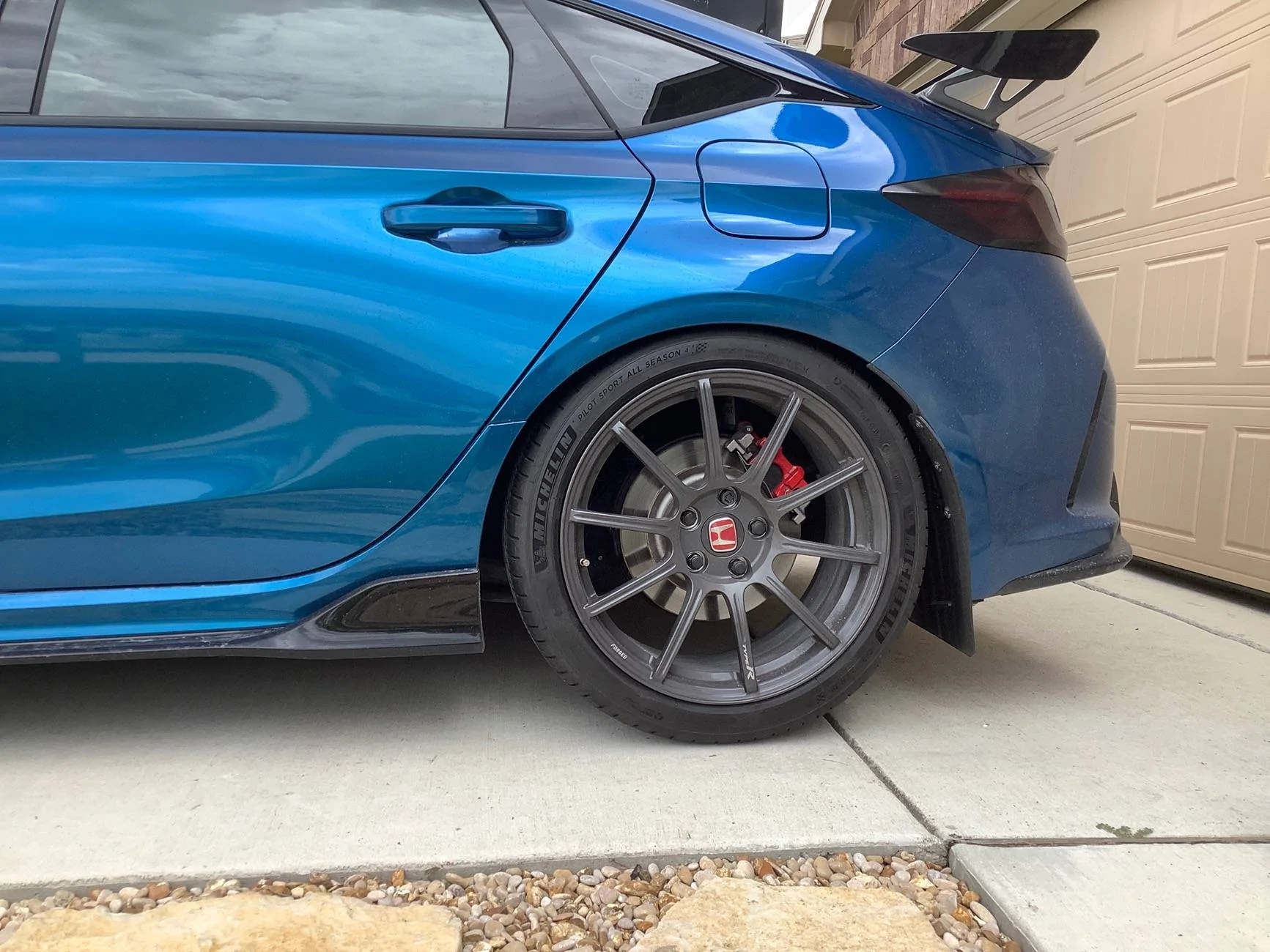

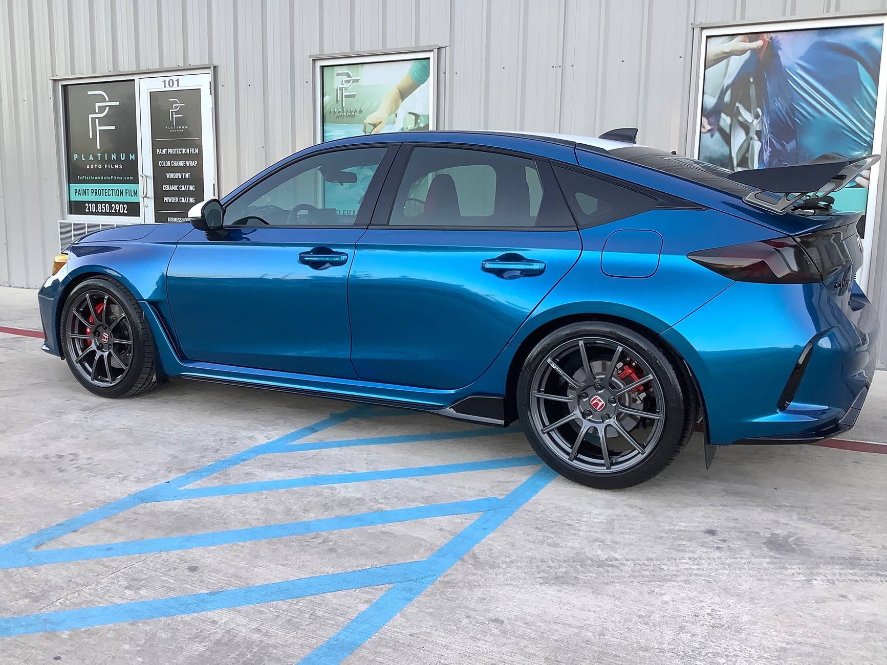

1.) Car:
2025 Honda FL5 Civic Type R .
2.) Wheels, Front and Rear:
Honda (Modulo?) Forged Shark Gray FL5 Type R 19x9.5J , ET +60 .
3.) Tires, Front and Rear:
Michelin Pilot Sport All Season 4, size 275/35ZR19 100Y . Bigger, heavier tire probably negates most of the benefit of the lightweight, forged wheel.
4.) Suspension:
OEM Honda FL5 Type R .
Suspension Damper Module:
5.) Spacers, Front and Rear:
H&R Trak+ 15mm Wheel Spacers, Black .
Note:
Weight of the spacer along with weight of larger tire has got to be heavier per corner than heavy stock cast wheel + lightweight rubber band tire.
I have not measured, but we can just add the weight of an H&R 15mm spacer to the 51.4 pound wheel and tire combo to get overall weight per corner.
Gonna definitely be heavier than stock FL5 setup. Something to keep in mind.

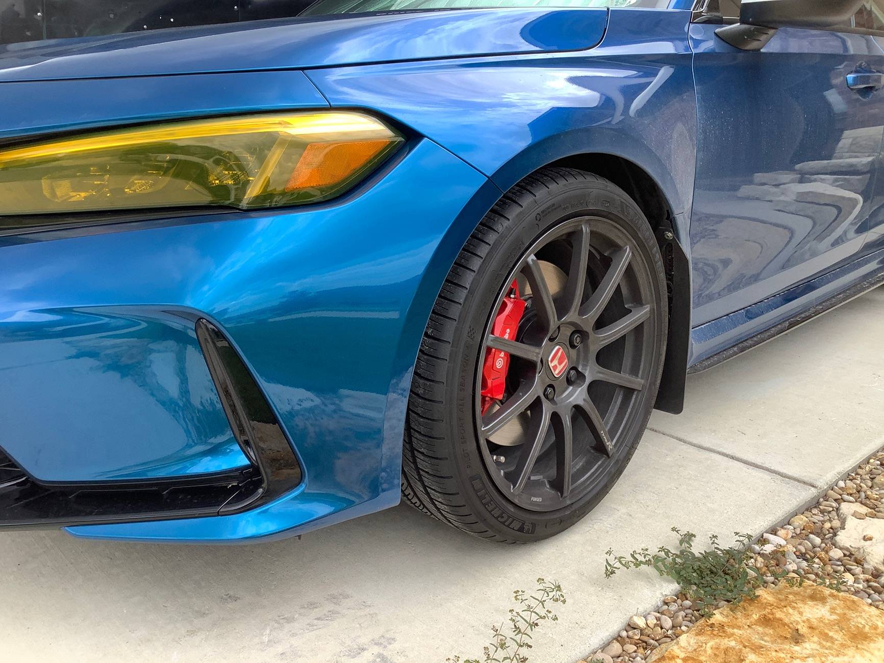

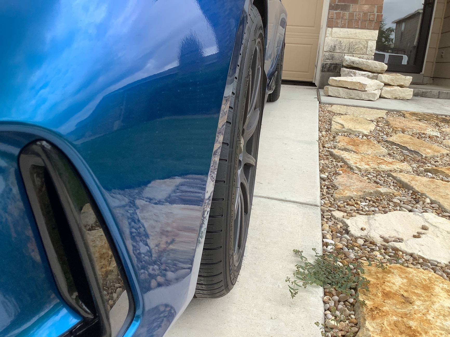

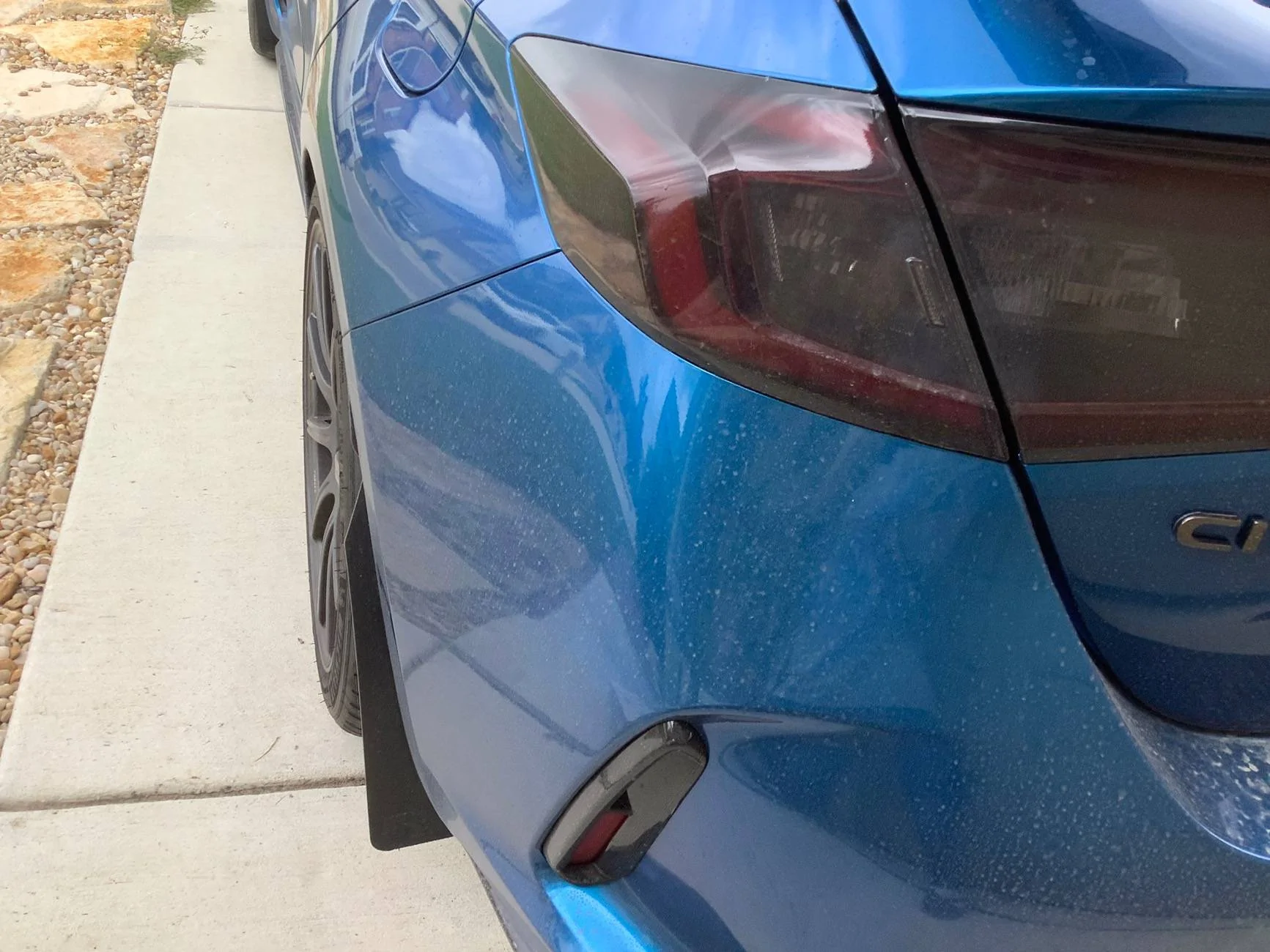

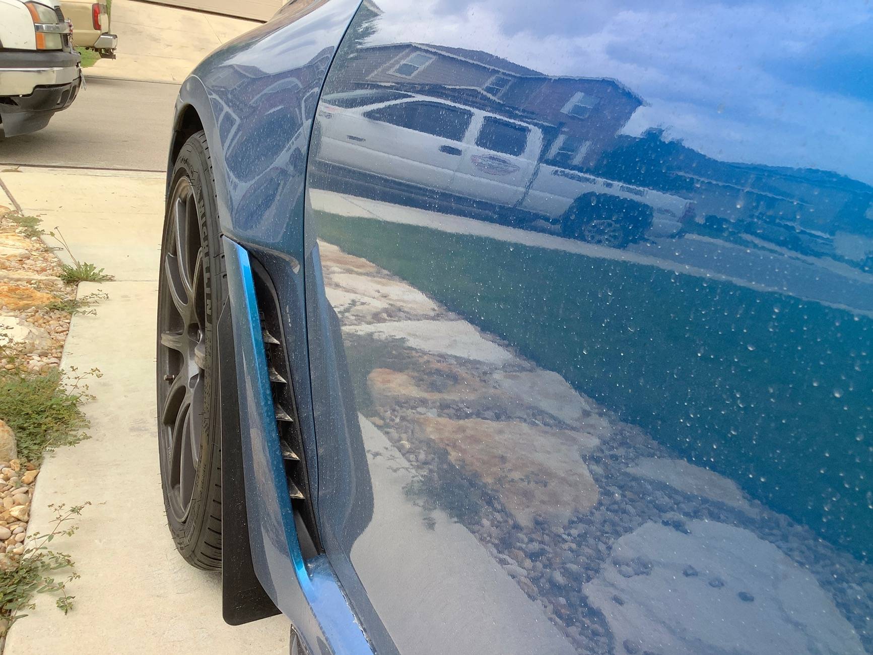

6.) Clearance and Rub:

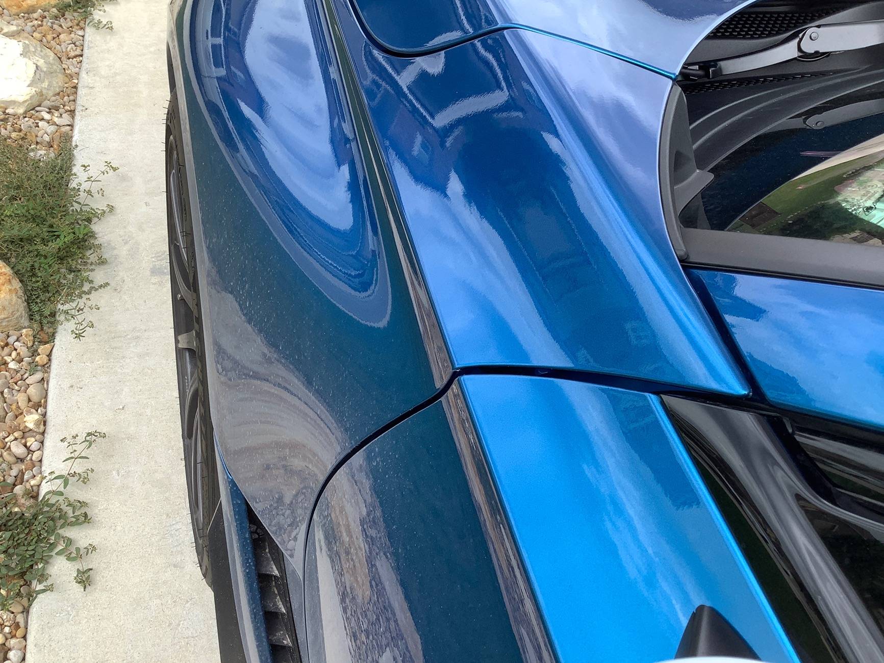

Front: Close to fenders, yet, so far, clear. I also have RokBlokz FL5 Rally Mud Flaps installed, which potentially closes the gap between each fender and the rolling rear of each tire. Just did over 600 miles round trip to Dallas and back home to San Antonio. No issues that I have seen or heard.
Rear: All Clear, but looks a bit tight for my preference. I'd prefer about a good half inch increaae to the rear springs, especially since I'll be keeping a full size (51 pound wheel + tire) spare in the boot. Personal preference.
7.) Wheel Studs:
Stock OEM FL5 Type R studs . Also stock FL5 lug nuts plus Honda McGard FL5 wheel locks.
8.) Photos:
11th Gen Honda Civic The FL5 Civic Type R Wheel Spacer Reference Thread IMG_0652
11th Gen Honda Civic The FL5 Civic Type R Wheel Spacer Reference Thread IMG_0650
11th Gen Honda Civic The FL5 Civic Type R Wheel Spacer Reference Thread IMG_0648
11th Gen Honda Civic The FL5 Civic Type R Wheel Spacer Reference Thread IMG_0725
11th Gen Honda Civic The FL5 Civic Type R Wheel Spacer Reference Thread IMG_0726

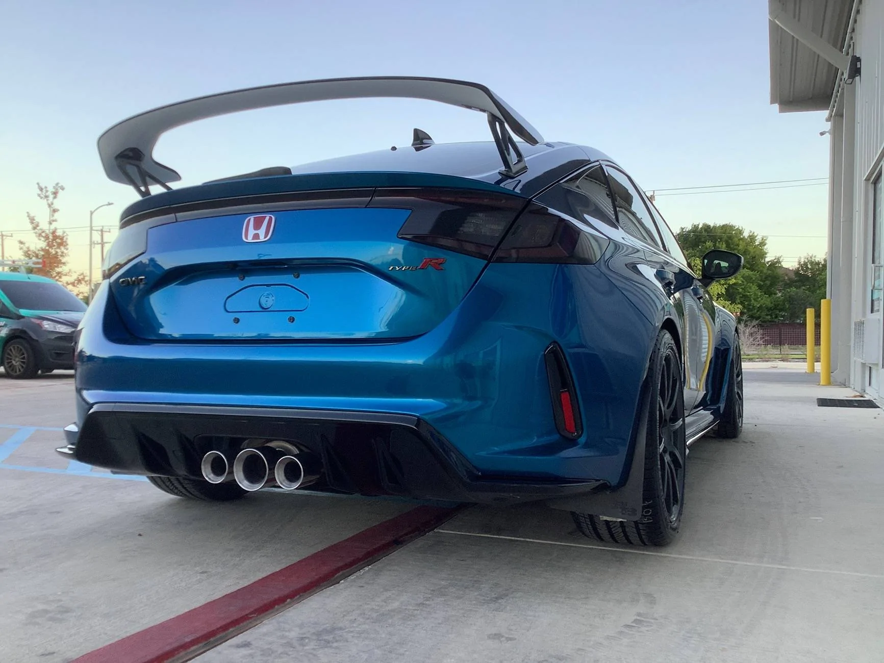

Note the car is on a sloped driveway here, so the rear left corner is compressed.
The rear right corner is extended.
11th Gen Honda Civic The FL5 Civic Type R Wheel Spacer Reference Thread IMG_0727
11th Gen Honda Civic The FL5 Civic Type R Wheel Spacer Reference Thread IMG_0733

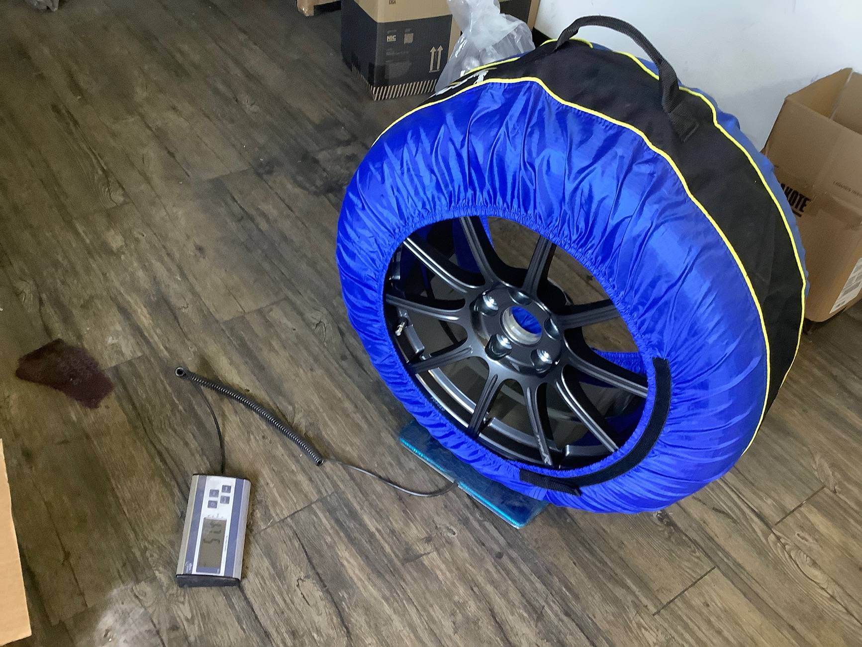

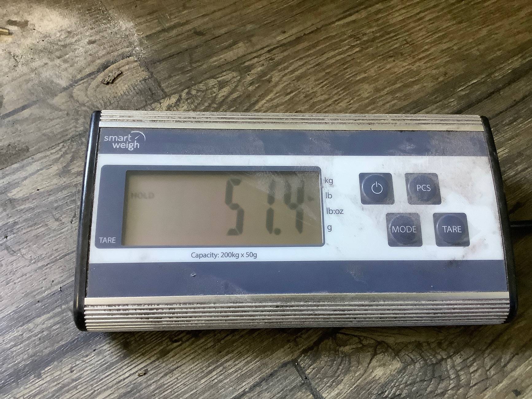

EDIT:
Overall weight of Honda Forged FL5 Type R wheel + Michelin PS AS4 in size 275/35ZR19... minus the plastic Honda center cap.
11th Gen Honda Civic The FL5 Civic Type R Wheel Spacer Reference Thread IMG_0603
51.4 pounds.
Maybe 51.5 pounds with plastic center cap and Tyre Tote included?

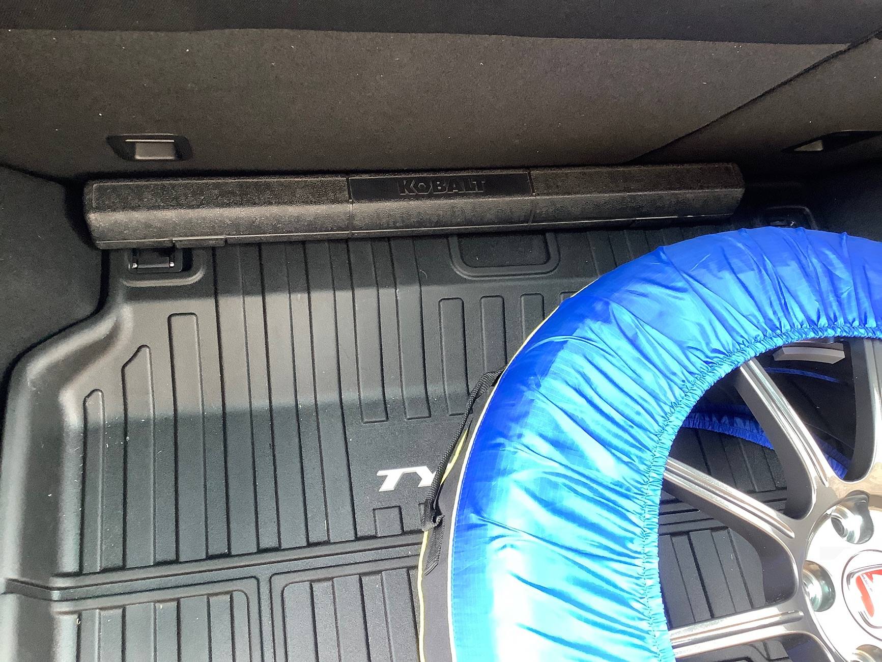

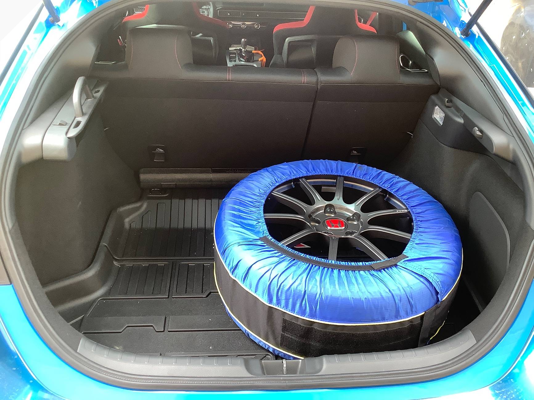

Full Size spare and torque wrench in the trunk. Torque wrench gonna add a few extra pounds.

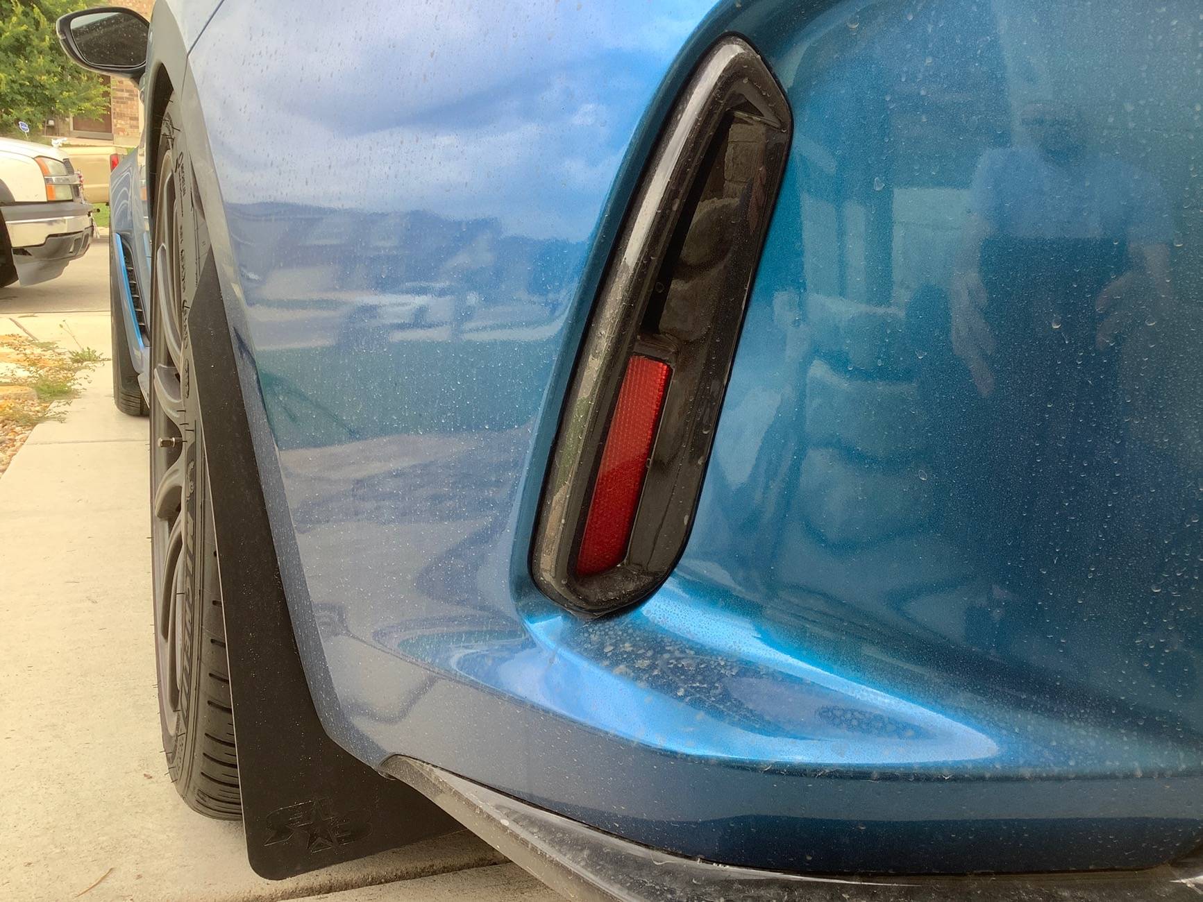

Some wheel-to-mud flap comparisons.
