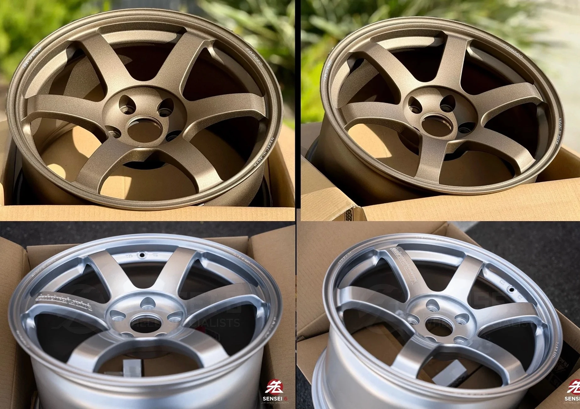

I used actual sized product photos from retailers to put this comparison image together for my own research, the angles are slightly off but you can see the difference between god spec s-plus and SL faces for the saga line if you know what details to look for. Top is SL, bottom is s-plus both are 18x10 +40 5x120. Basically you give up about half a pound for a deeper concave face with saga s-plus and increased stiffness. Sort of overkill as our CTRs are not particularly heavy or high torque but the wheel in face 4 looks undeniably deeper than the SL line but you get lighter weight rotational mass bragging rights with those so… there are no losers. Ain’t variety great? In a perfect world we’d all have a set of SL for track and s- plus for street.

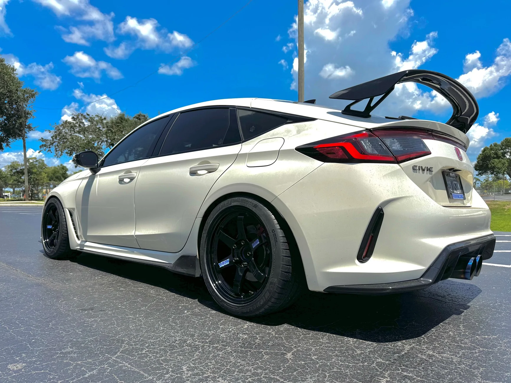

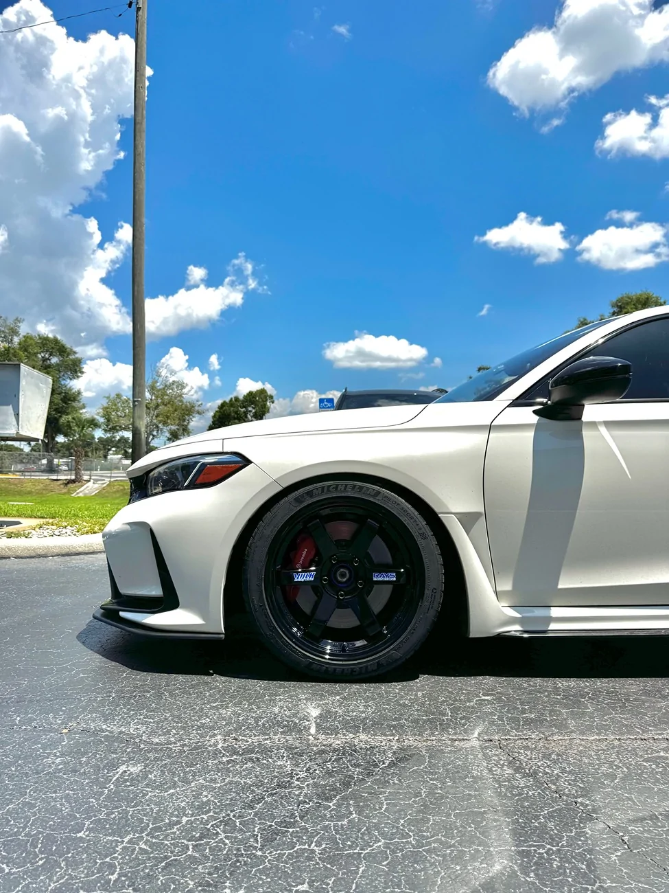

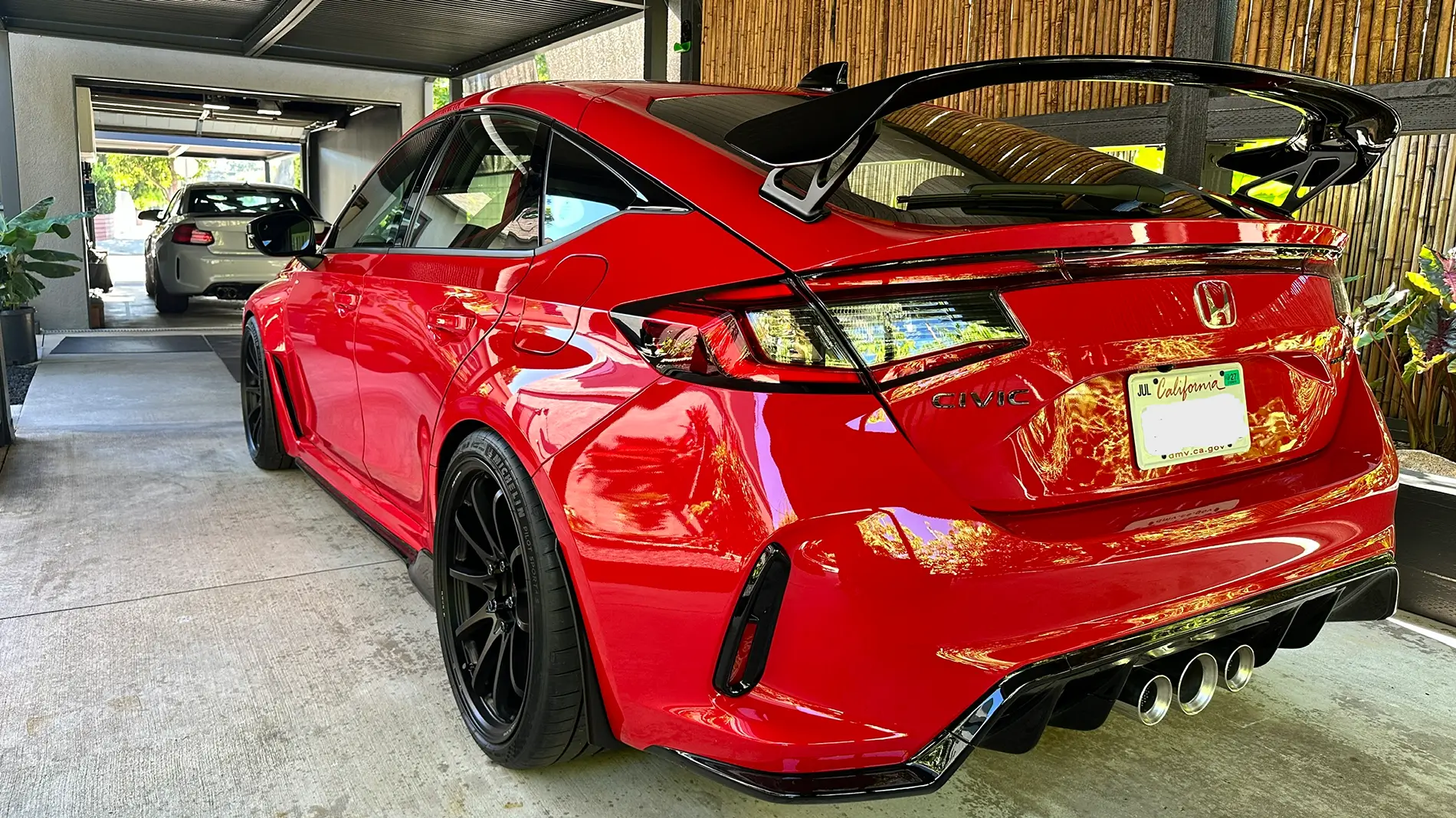

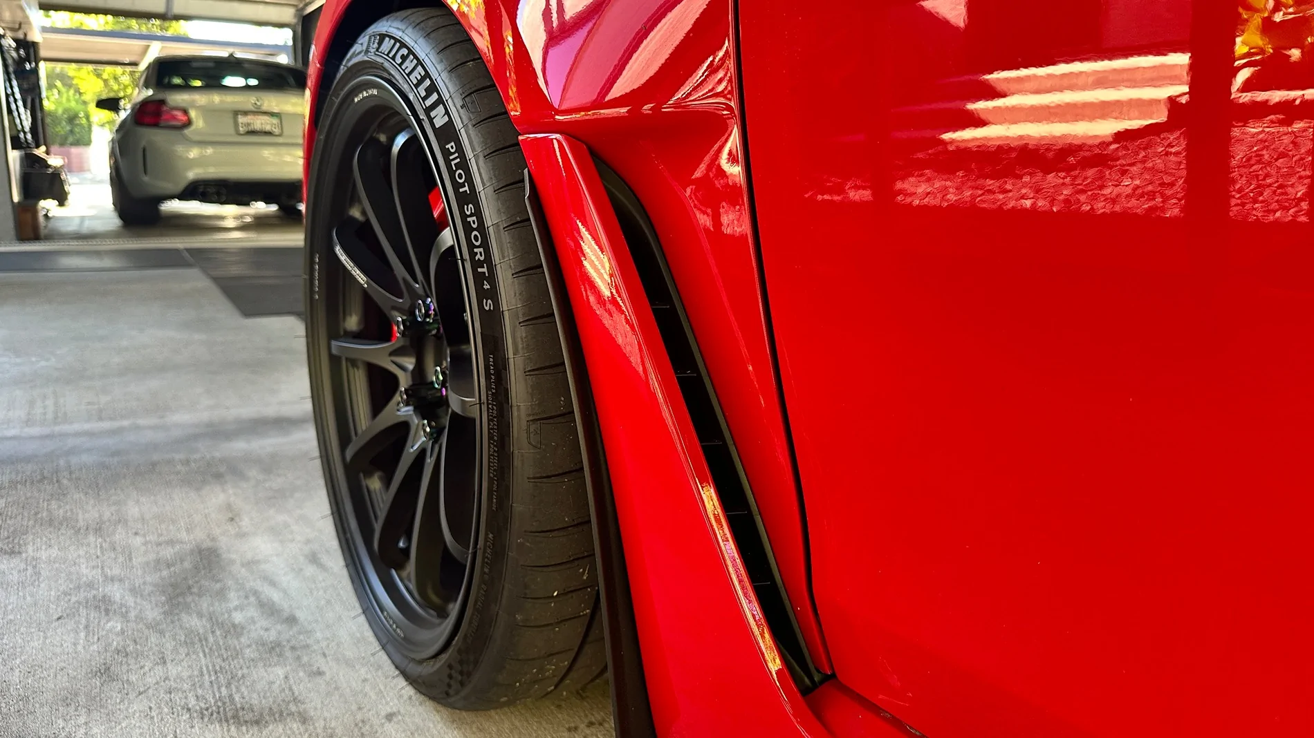

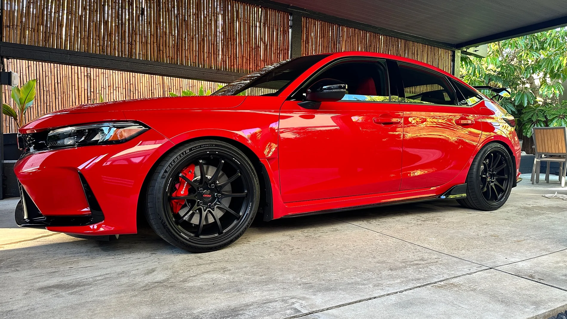

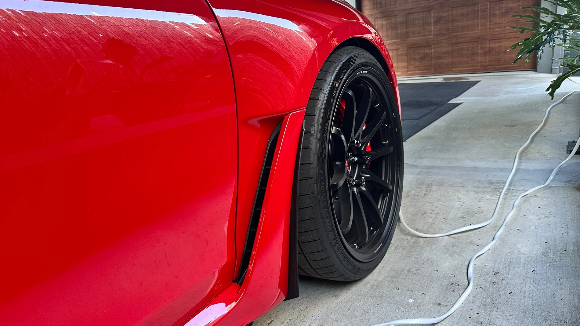

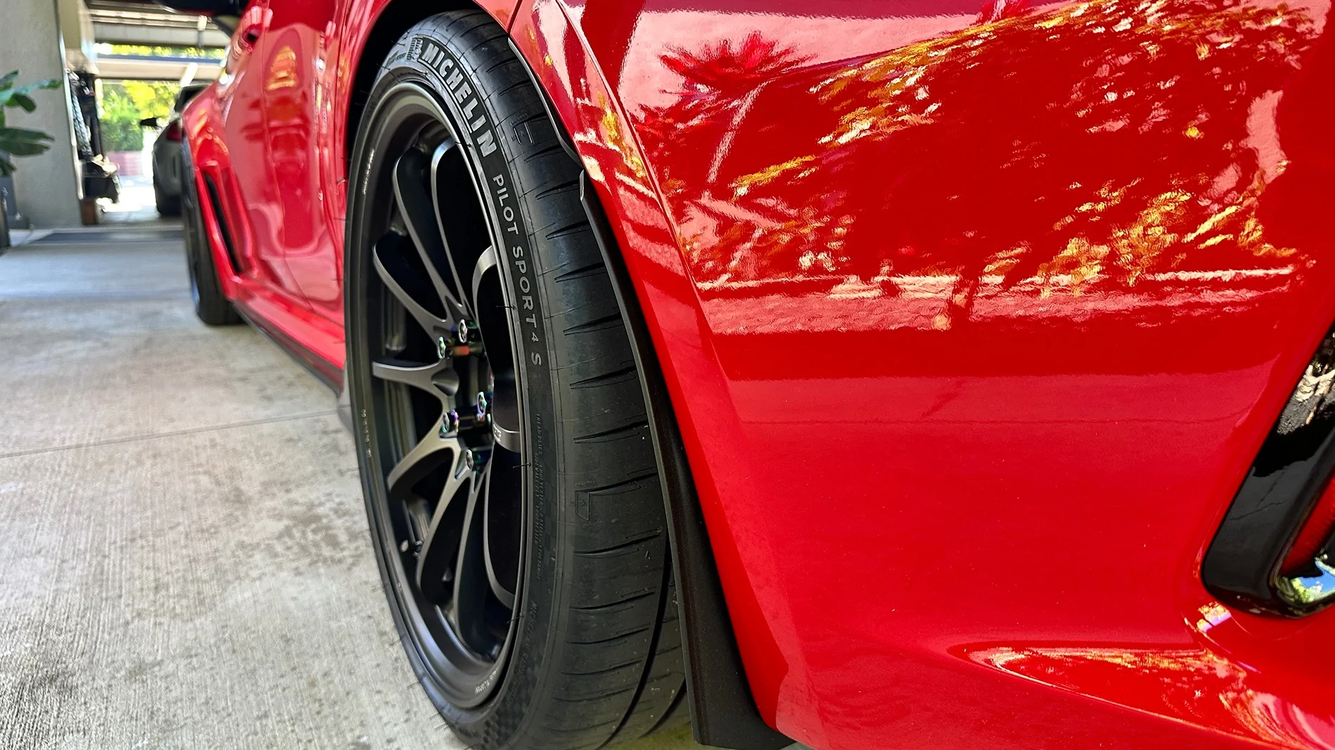

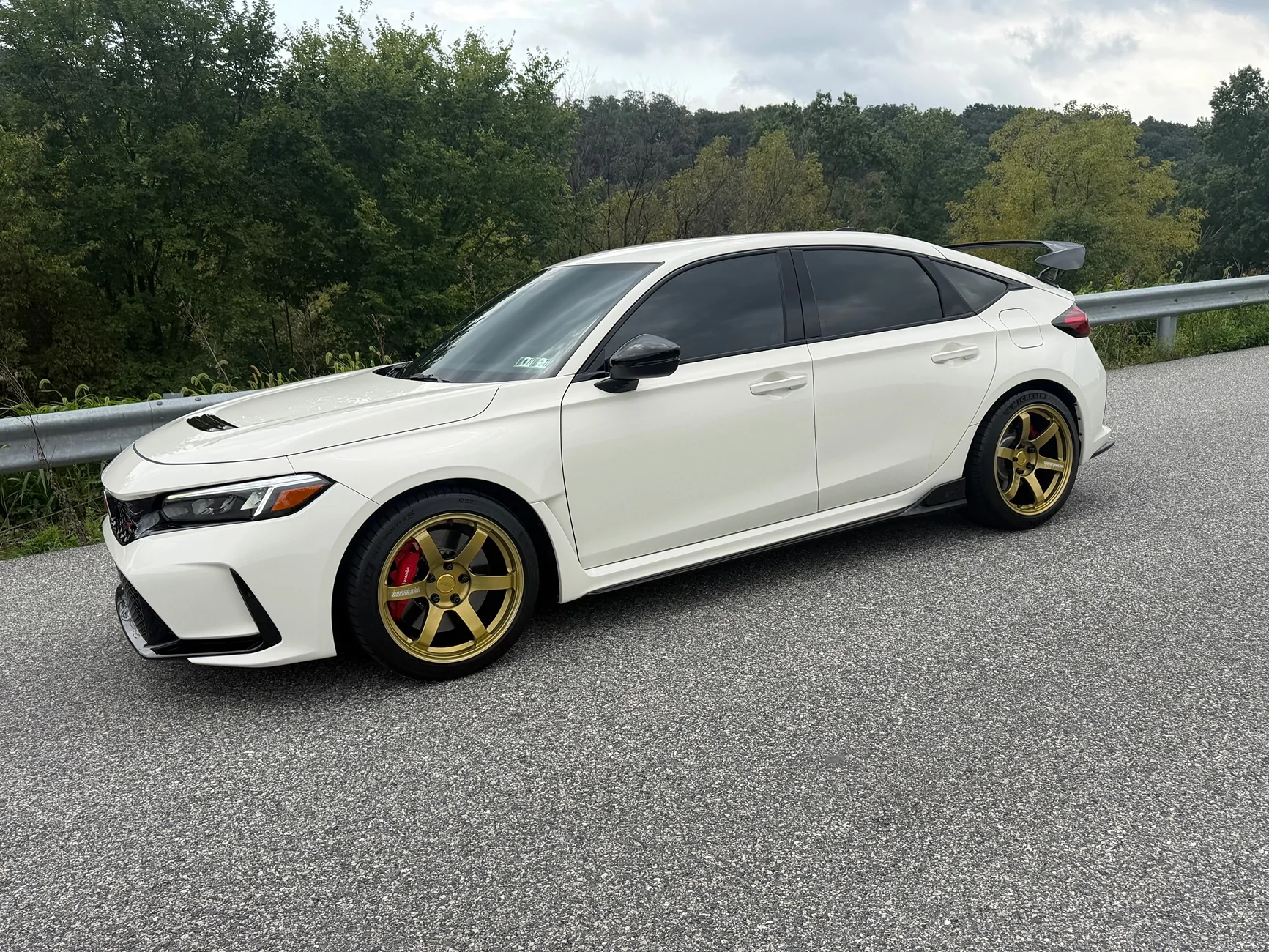

Fitting 19x10 +38 wheels on the factory 265/30/19 MPS4S tires lowered on Spoon Springs. Will removing front strut pins provide enough camber to effectively run this setup without rubbing?

You shoul
You'll be OK.

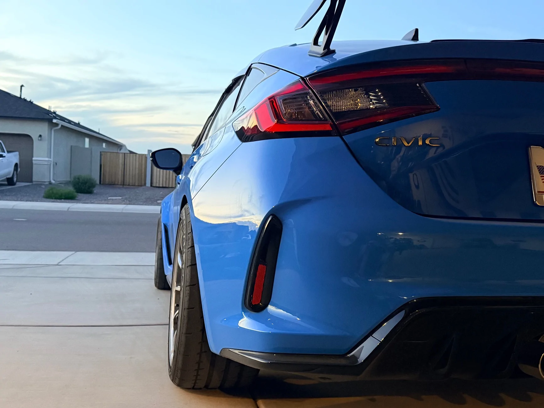

Easy. I’m running 265/35 on 19x10 +40, lowered on H&R’s. Pins removed as well, and there’s no rubbing.
