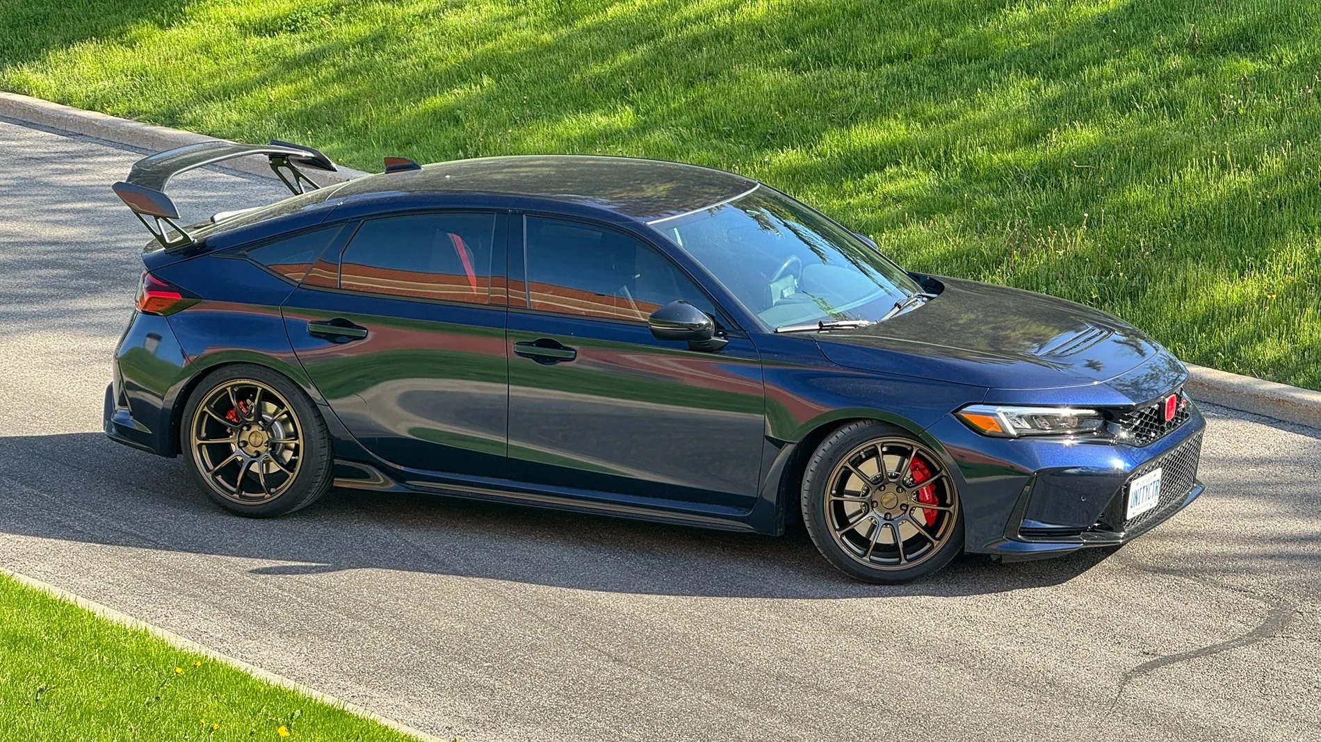

Rays ZE40 19x10 +40 with 265/35R19 Conti ECS 02. H&R Springs, Wunderladen Rear Camber Arms, and front guide pins pulled. No rubbing, even with multiple passengers :)

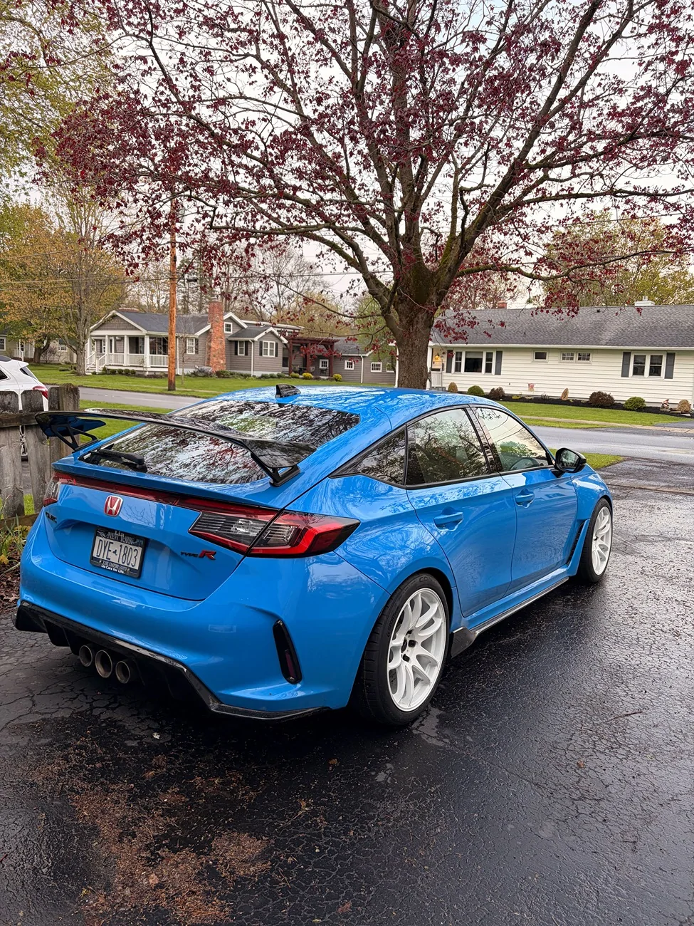

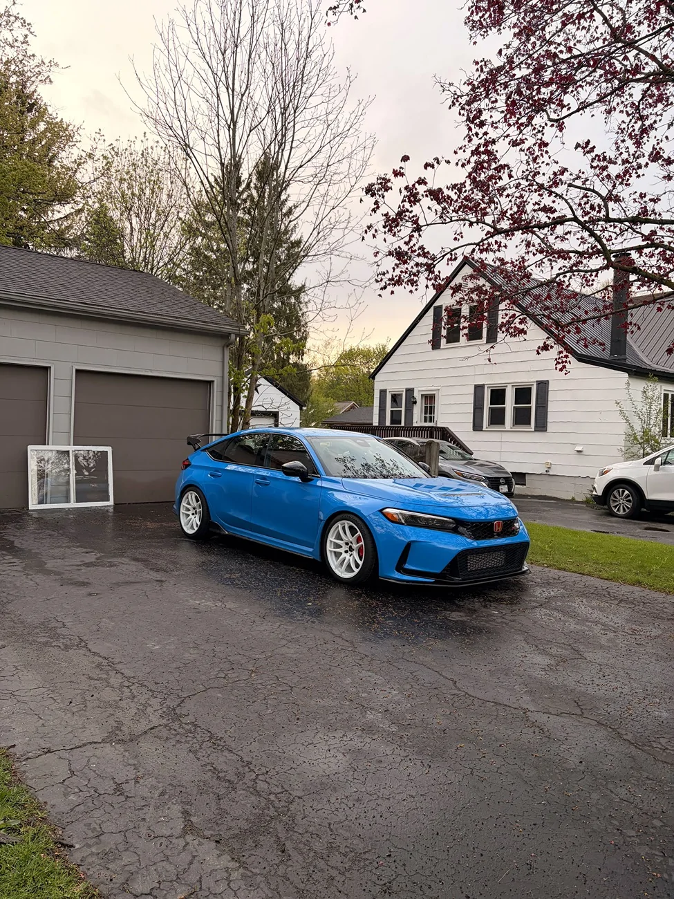

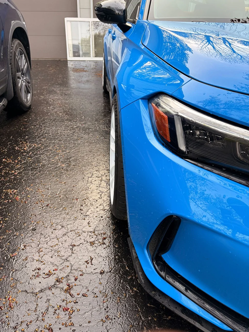

Hey Thanks! For sure. I have a few more pics below. I really like them. Im not in the position to be tracking with fatherhood, work and the distance to the closest place so I figured id go for something I hadn't seen before. Plus im a bit of a "Work Wheels" fan boy. I ordered these in and got them redrilled to 5x120 from i believe a 5x114.... I can't remember. And to be honest the process was a bit of pain, the place took forever scratched the hell out of them and didn't send any of my order other than the wheels them selves... no hub rings, center caps ect...turned into a credit card dispute. BUT all that said at the end of the day i'm super happy with them and do highly recommend trying something different or a quality place to redrill to 5x120 to open up some solid options.

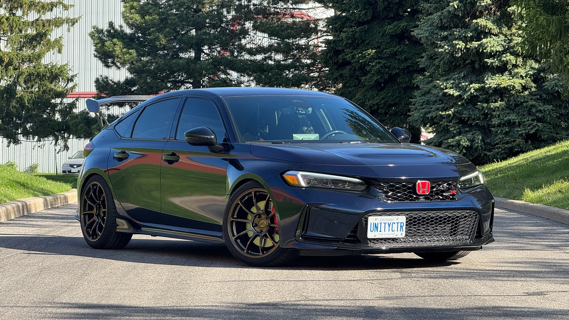

Do you have any shots from the front or back? I’m mainly concerned with less aggressive camber and too much poke or rub since I was looking at getting the same spec and wheel

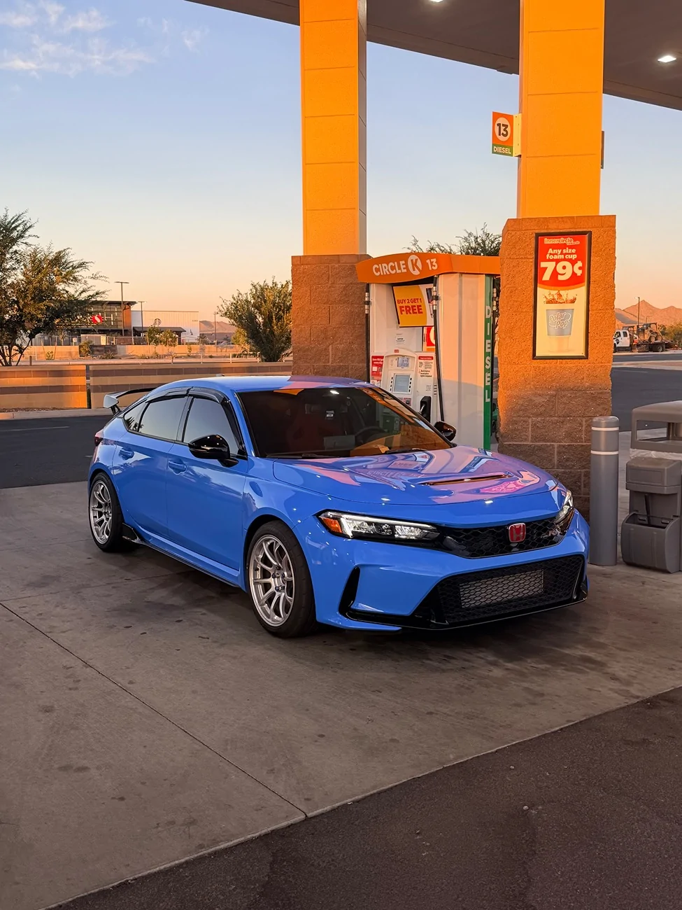

ZE40 M Spec in 18x10 +40 from @lmtlsauto with a 275/35/18 Advan Apex V601. Stock height for now, Tanabe lowering springs waiting to be installed. Side note is there a cost effective center cap for Rays wheels? 80-120 a piece is a bit ludicrous.
