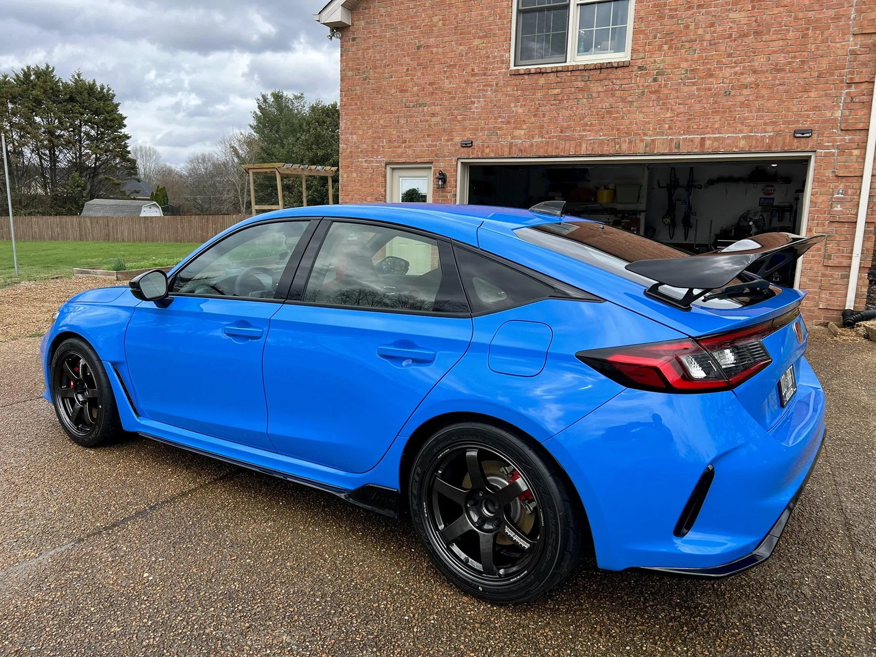

I'm honestly surprised that post #281 doesn't look extremely stretched.
I did a bit of snooping on @Noize 's build thread to find the wheel size on the TE37, hope you don't mind, Noize!
Knowing that the TE37 wheel is 18" X 9.5" wide, a 255 width tire seems very narrow to me.
For example, I got 18X8.0" Honda Pilot Bronze HPD wheels for my "Winter" setup, and put 255/40 ZR18 tires on those wheels.
To me the 255 width tire looks perfectly square on the 8.0 wide wheel.
Both of our cars are on stock suspension.
Of course, the differences in perceived width likely have to do with
1.) Different brands, and
2.) Different "Season Focus".
In this case, the tires on Noize's FL5 look fairly square, which is mind boggling on 9.5" wide wheels.

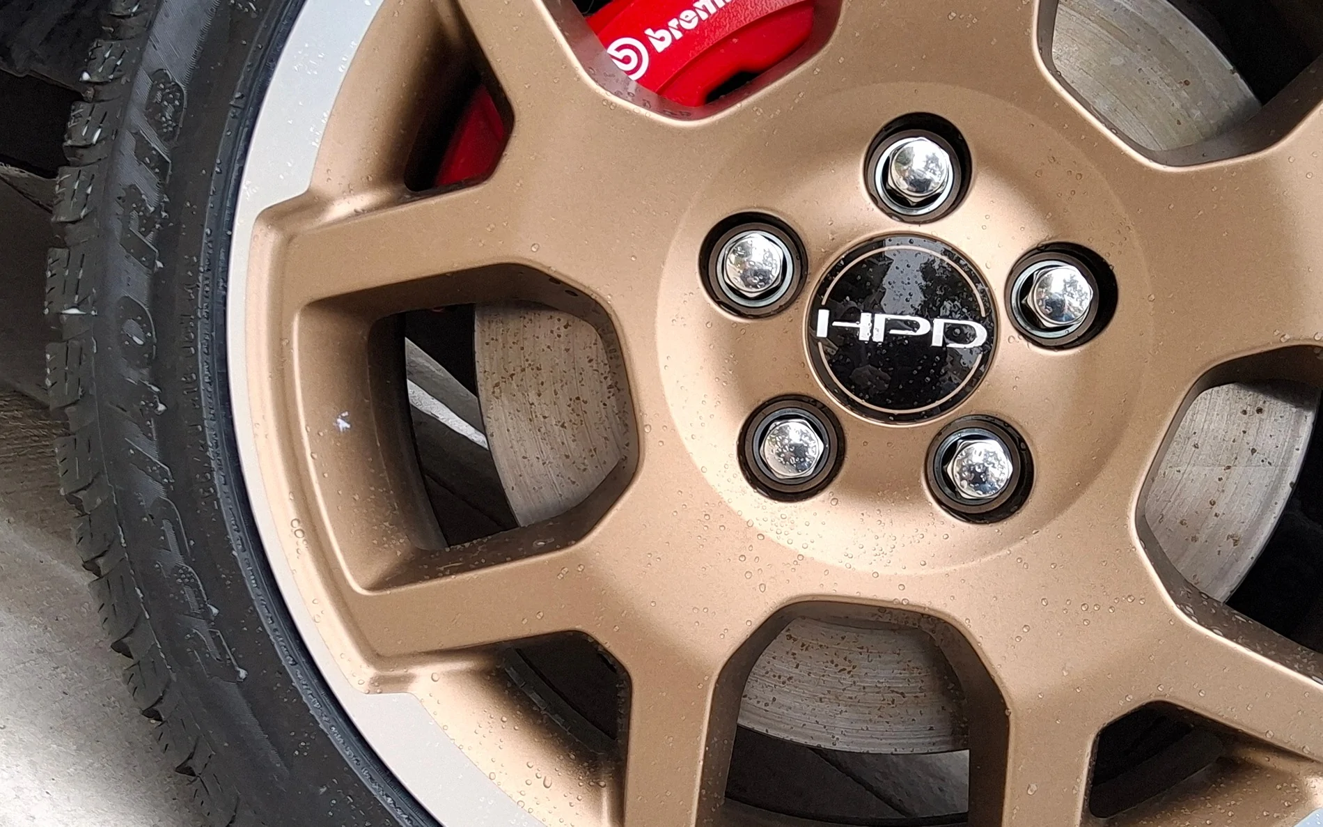

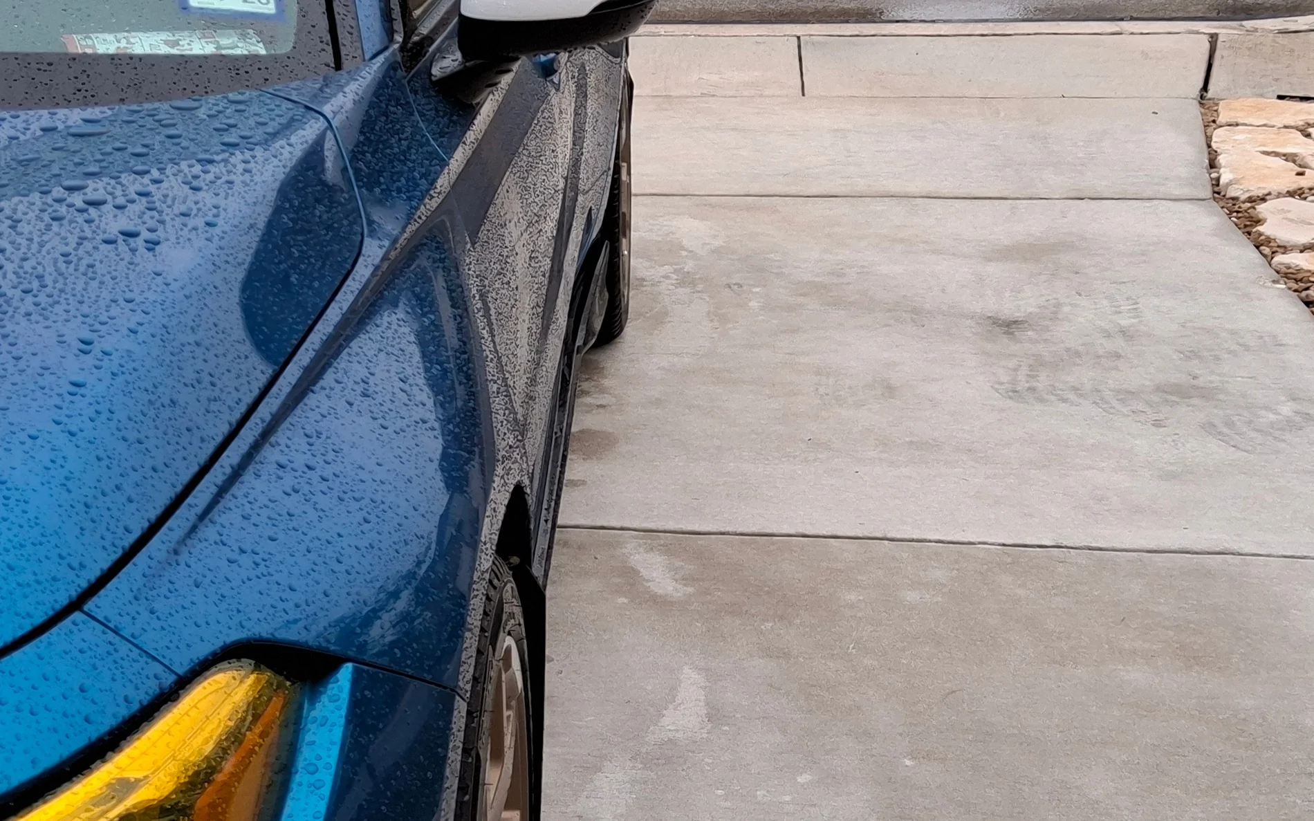

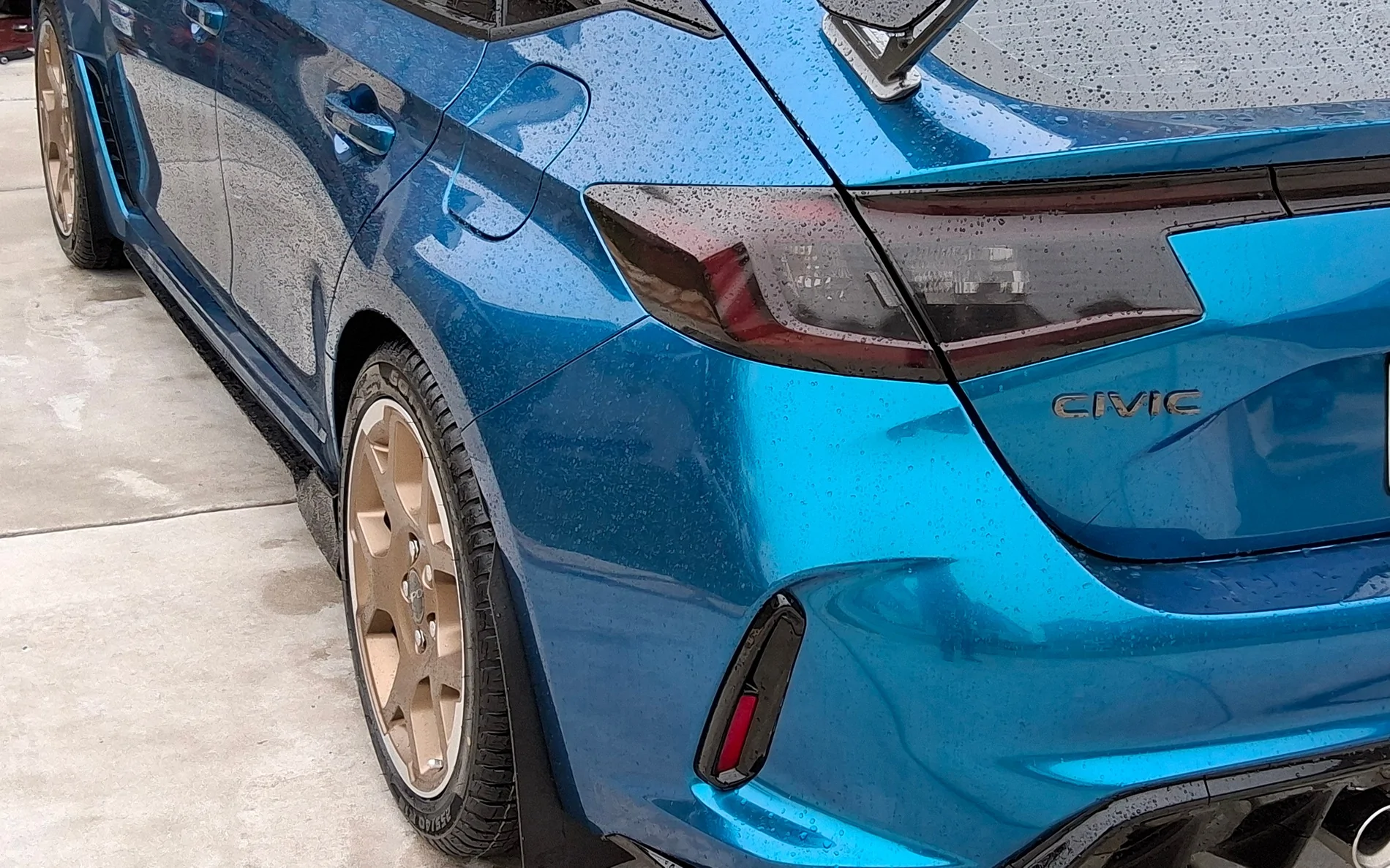

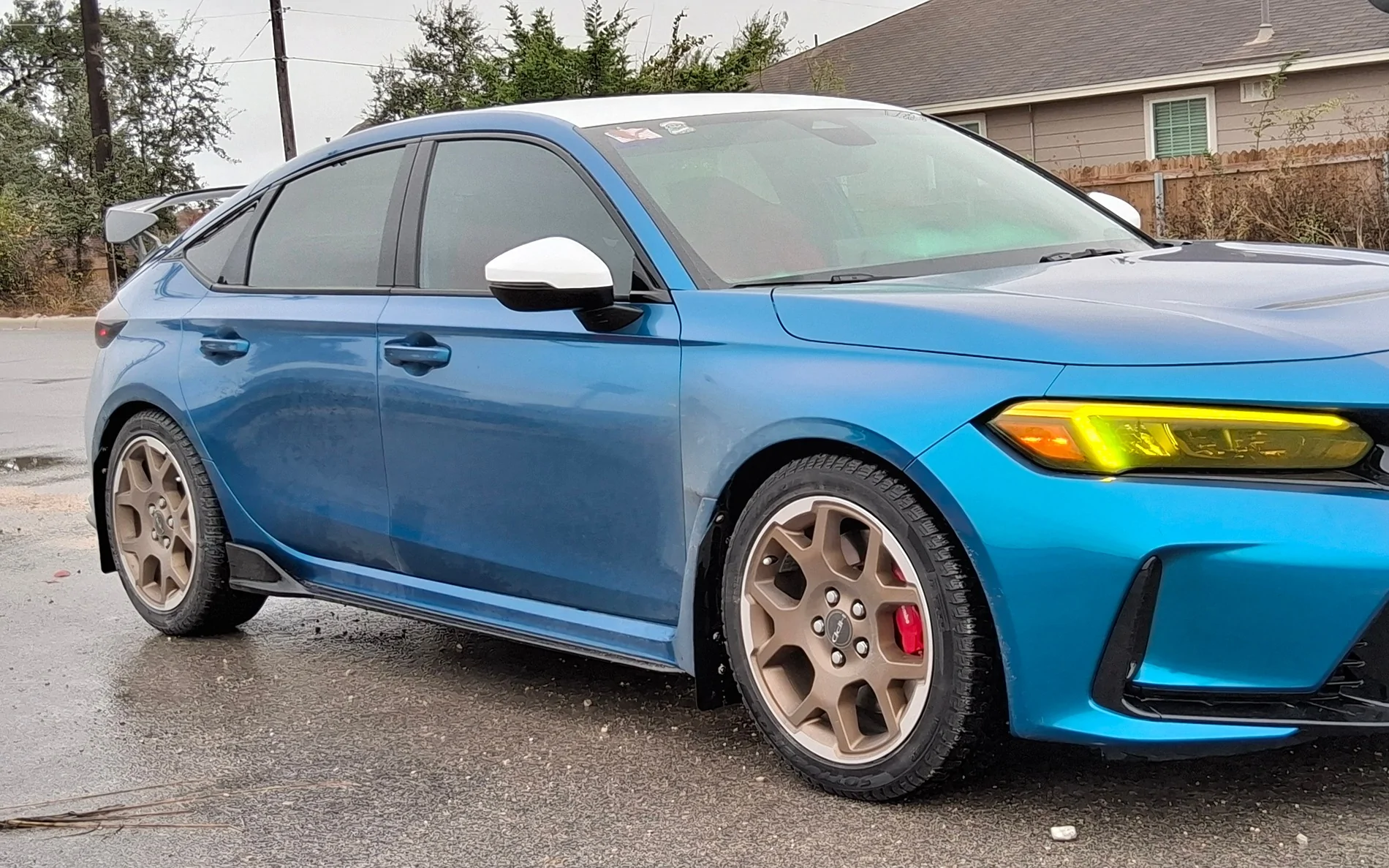

Here is the Pirelli Winter Sottozero in 255/40 R18 on the 18X8.0" ET +50 Pilot Bronze HPD wheel.
NOTE: If anyone is interested in doing a setup like this for the winter, you will need AT LEAST 20mm spacers in order to clear the Brembo front calipers. These wheels have nearly zero backspacing, and the spokes are THICCC with three "C"s.
25mm spacers are recommended for these HPD wheels. The setup shown is with 20mm spacers.
11th Gen Honda Civic Official Wheel Fitment Thread for 11th Gen FL5 Civic Type R 20251216_161306
11th Gen Honda Civic Official Wheel Fitment Thread for 11th Gen FL5 Civic Type R 20251216_161530
11th Gen Honda Civic Official Wheel Fitment Thread for 11th Gen FL5 Civic Type R 20251216_161421
11th Gen Honda Civic Official Wheel Fitment Thread for 11th Gen FL5 Civic Type R 20251217_163200
So here we have two examples of 255/40 ZR18 tires, both on very different width wheels, yet both sets appear to be fairly square.
Are winter tires designed to be narrower than Summer tires by default? ... because they need to break through snow and ice, whereas Summer tires are wide in order to maximize dry surface grip?
... and are All Season tire widths "somewhere in between"?
Sounds logical to me, but makes tire shopping confusing.

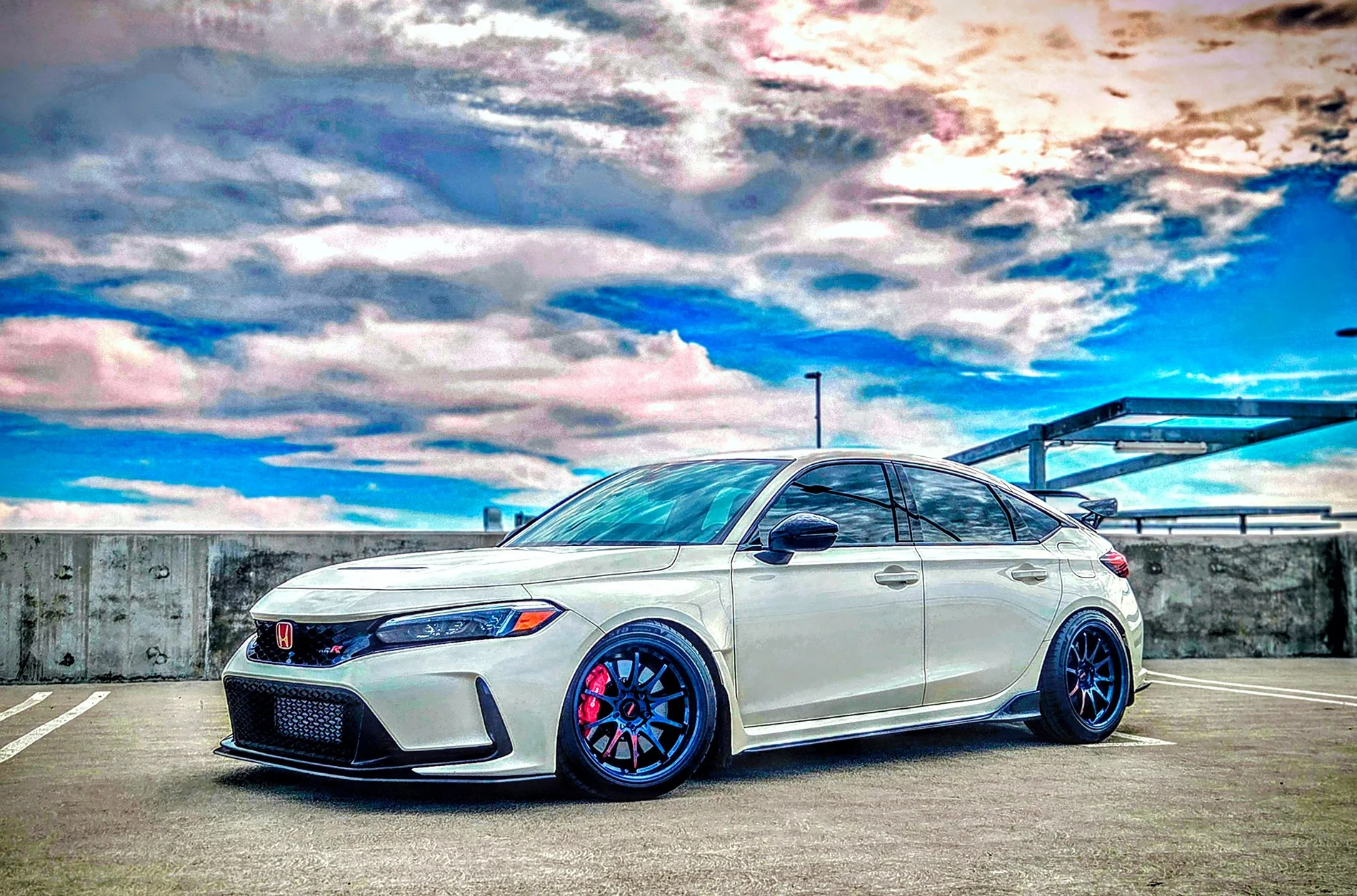

Did a quick google and it seems that RT660 runs wider than usual compared to other tires of the same spec.
11th Gen Honda Civic Official Wheel Fitment Thread for 11th Gen FL5 Civic Type R 1778087807209-on
source:
Going back to wheel/tire decisions, I do want a bit more meat so I'm considering 275/35/18+45.
