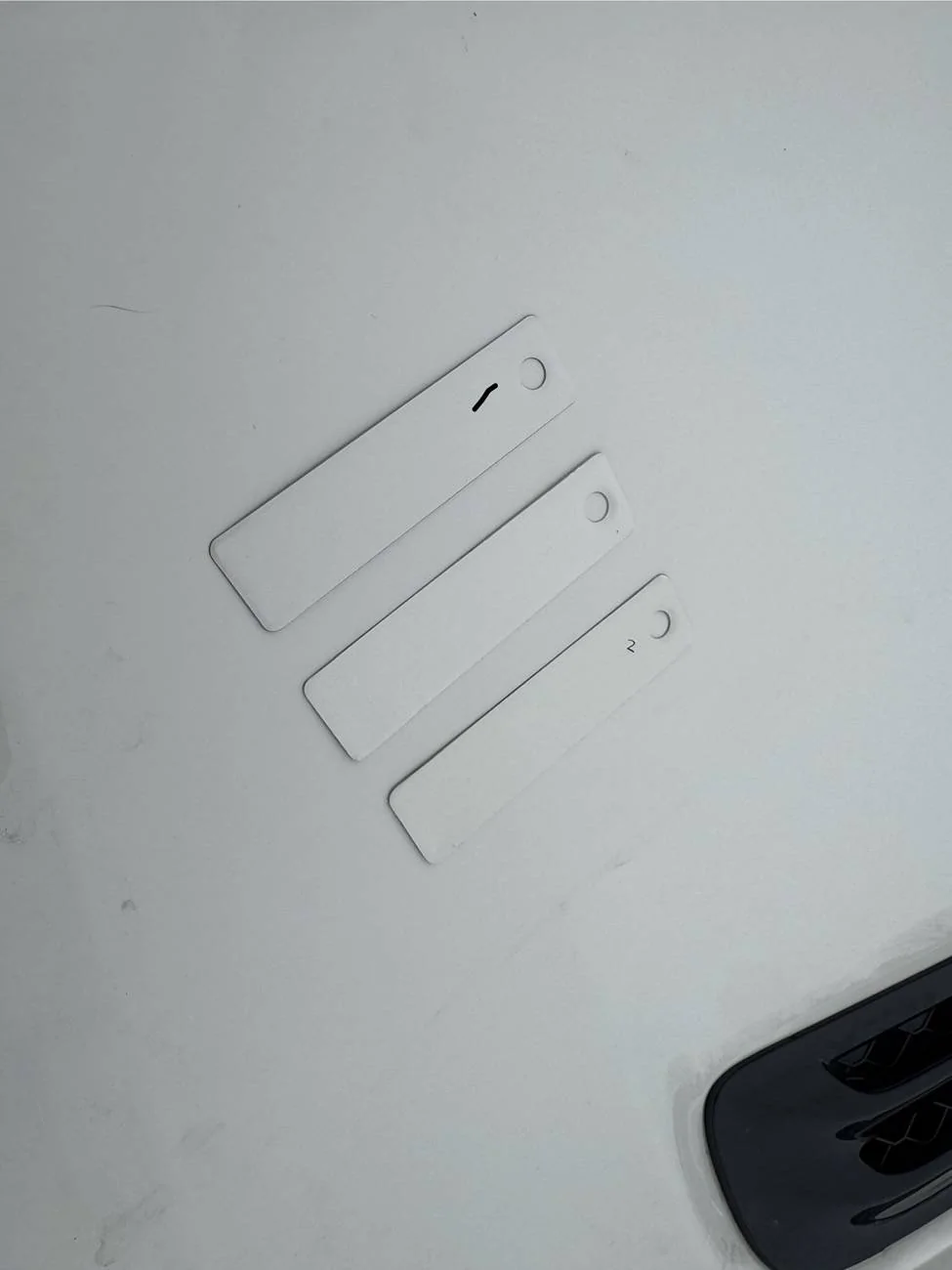

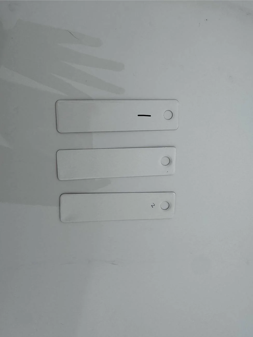

So after looking through 100 samples of different shades of white for powder coating, I think these 2 are the closest. Number one is called off-white-II and number two is called snow bunny. Company is prismatic powders.
I am planning on trying something on a set of wheels with off white II but likely not till March or April.
Also, three looked close but then I put it with the other two and it was much too light so I didn’t really think it would work.
Reviving this old post. I ordered some powder coat swatches as well. Indeed the closest are called "Snow Bunny" and "Off White II" from Prismatic Powders. "Snow Bunny" is a satin finish though so while out of direct sunlight it looks really close, in the sunlight the gloss of the car's paint becomes a different shade while "Snow Bunny" stays the same and it looks quite different. "Off White II" is a gloss finish, but it still isn't as glossy as the car. It's the color I would try if I had to go with one, but it's still going to look slightly off in certain lighting conditions. The only way to get a true color match is to go with paint or you could try adding some type of gloss finish over "Off White II" to get it closer to the gloss level of the car. Interestingly, some other colors their website says are a copy of Championship White are not even close. Anyway hope that helps someone.

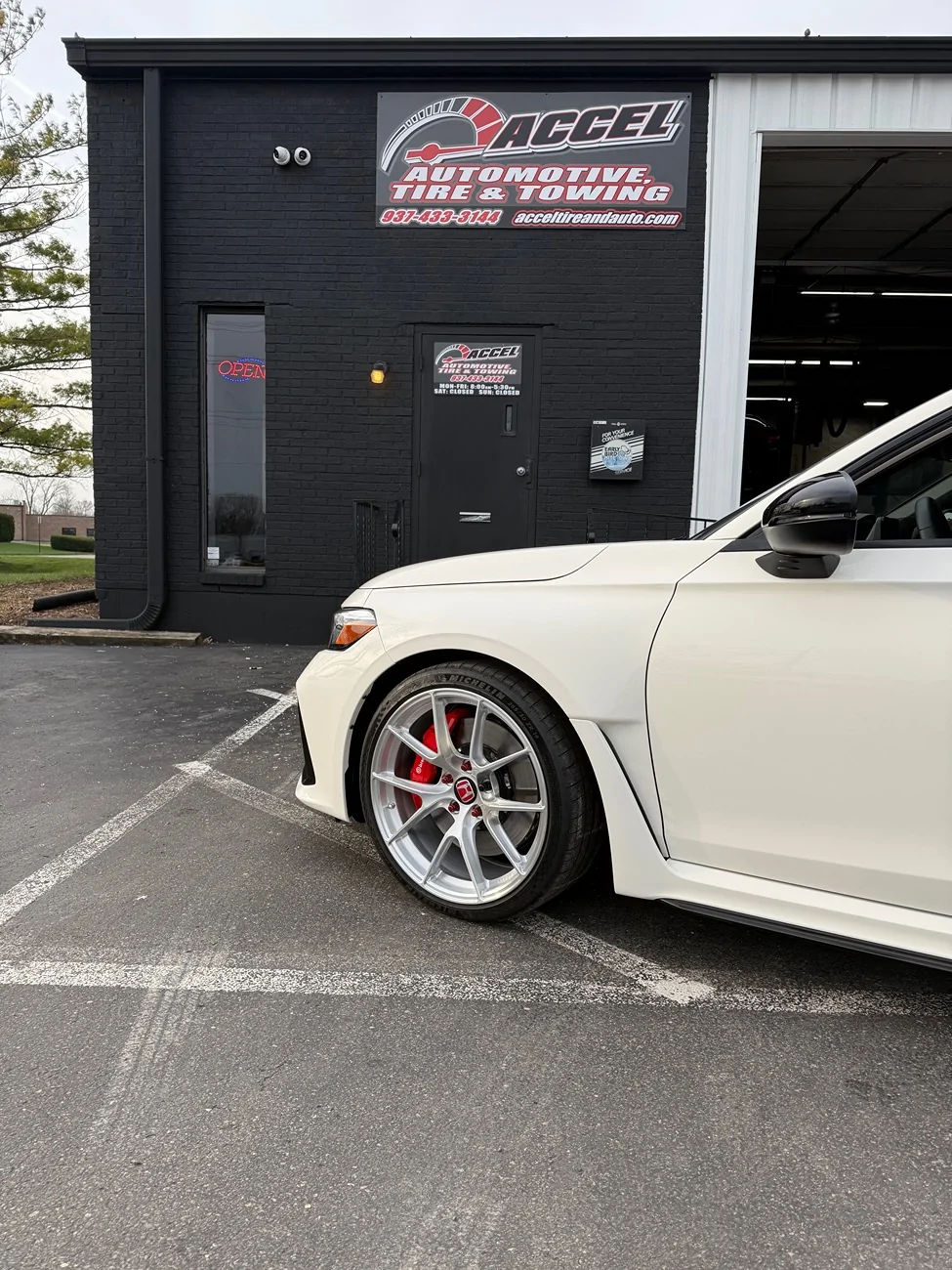

How is fitment? any rubbing and how much poke. I thinking about running a 18x9.5 +35 which has a very similar wheel poke to your setup (1mm different).
00057
Nov 9, 2017
851
36
SATX
It is 100% perfect fitment.
Doesn't stick out at all and now that its totally settled in I love it

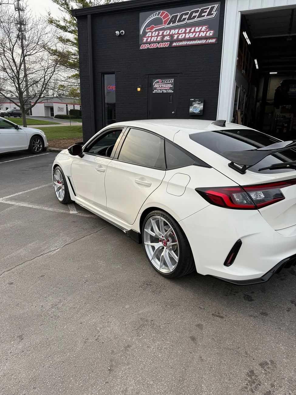

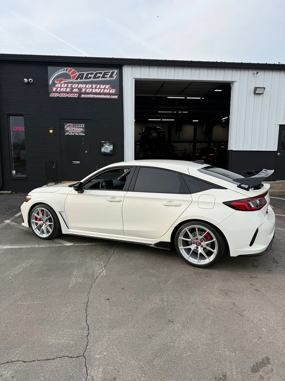

Just installed my Eibach Pro Kit springs. Came out nicer than I expected. No rubbing with this aggressive offset too! Love it!
wheels: TE37 SL Black Editions, 19x9.5 +36, stock tires.
