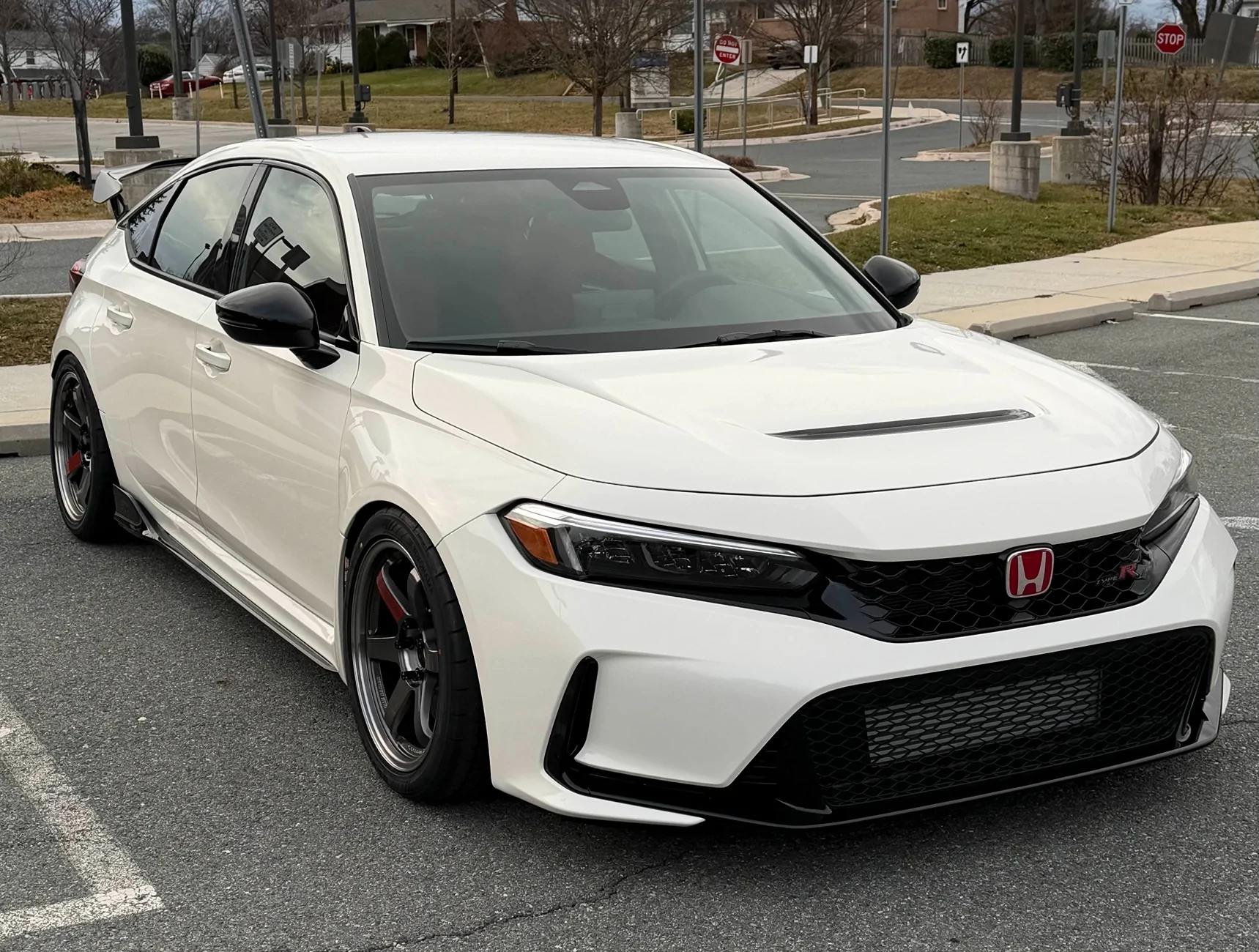

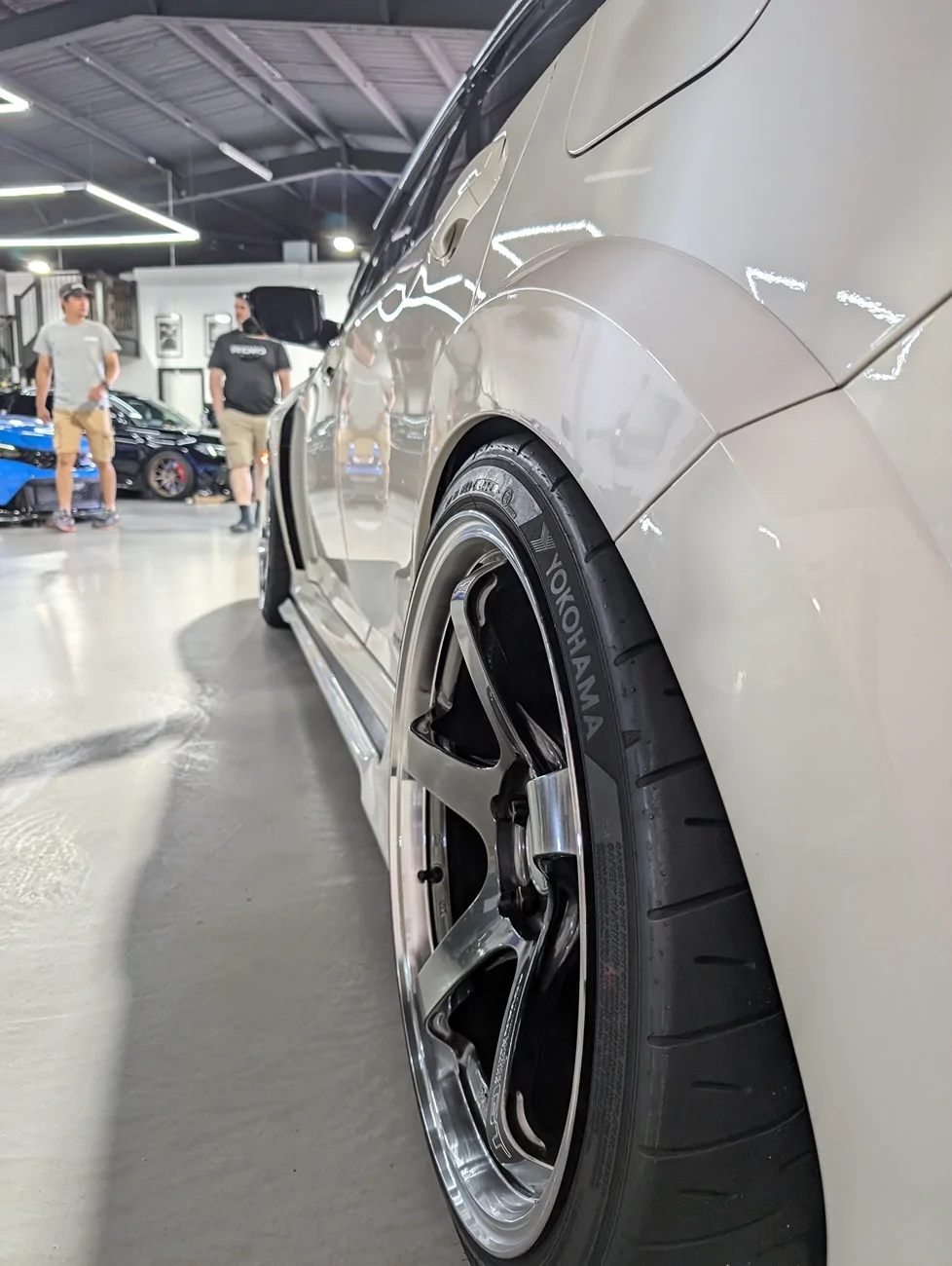

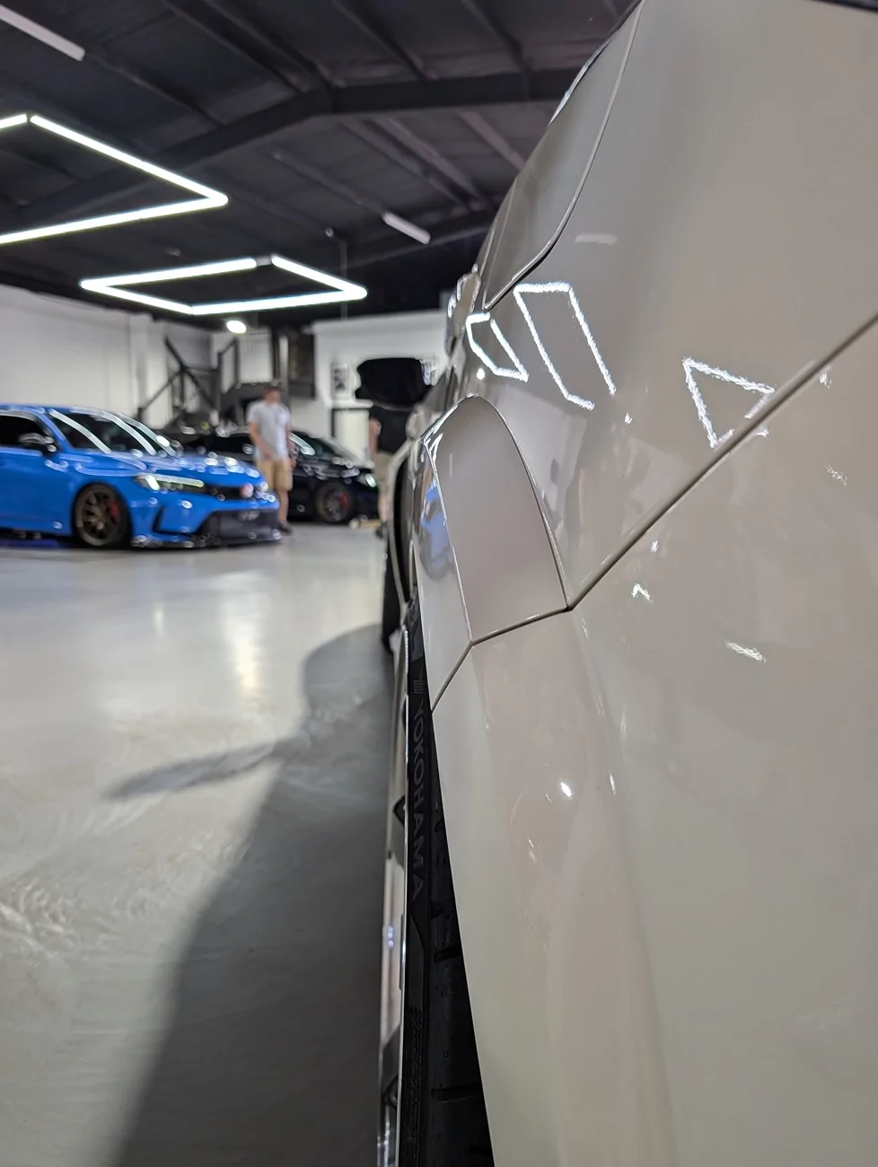

Those come in the 19x9.5 +45. I’ve really wanted to see how they look on a FL5 but can’t find any pics of them installed.
I do think in the 18s, they will look awkward on the FL5. The lip and spoke design will make them look smaller than they are.
They only come in 18x9.5 with the 5/114 and 5/100 stud pattern. With the 5/120 stud pattern they have 18x8.5 18x9 and 18x10 no in between which is weird. I'm from Australia, and went to my local performance/customizing workshop who deals specifically for the fk8/fl5 and they have a FL5 running Advan GT Beyond wheels in 18/10 +32 with no issues after putting -3.5 camber in the front and -2.8 in the rear. They told me I'd be able to get the PF06 in the 18/10 +28 to work but will be very aggressive but by adding -3 to -3.2 in the rear.
I'll post pics through of the 5L5 and their FK8 running 18/10 +32

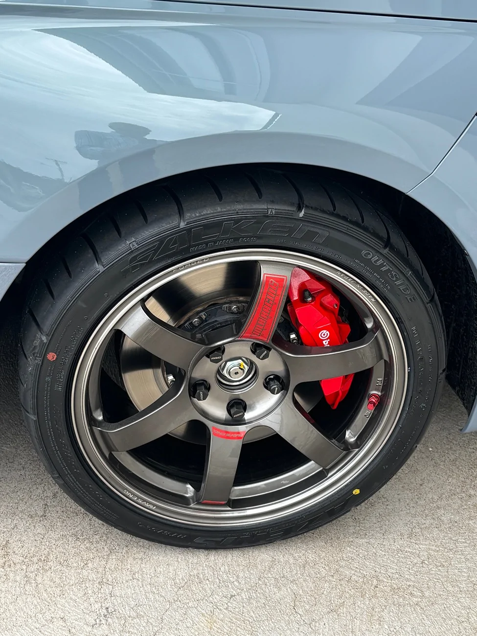

TE37 45 offset. Lost two OEM centre caps during track day (fronts) . Rims heated off & the caps literally popped off. Anyone else have this issue

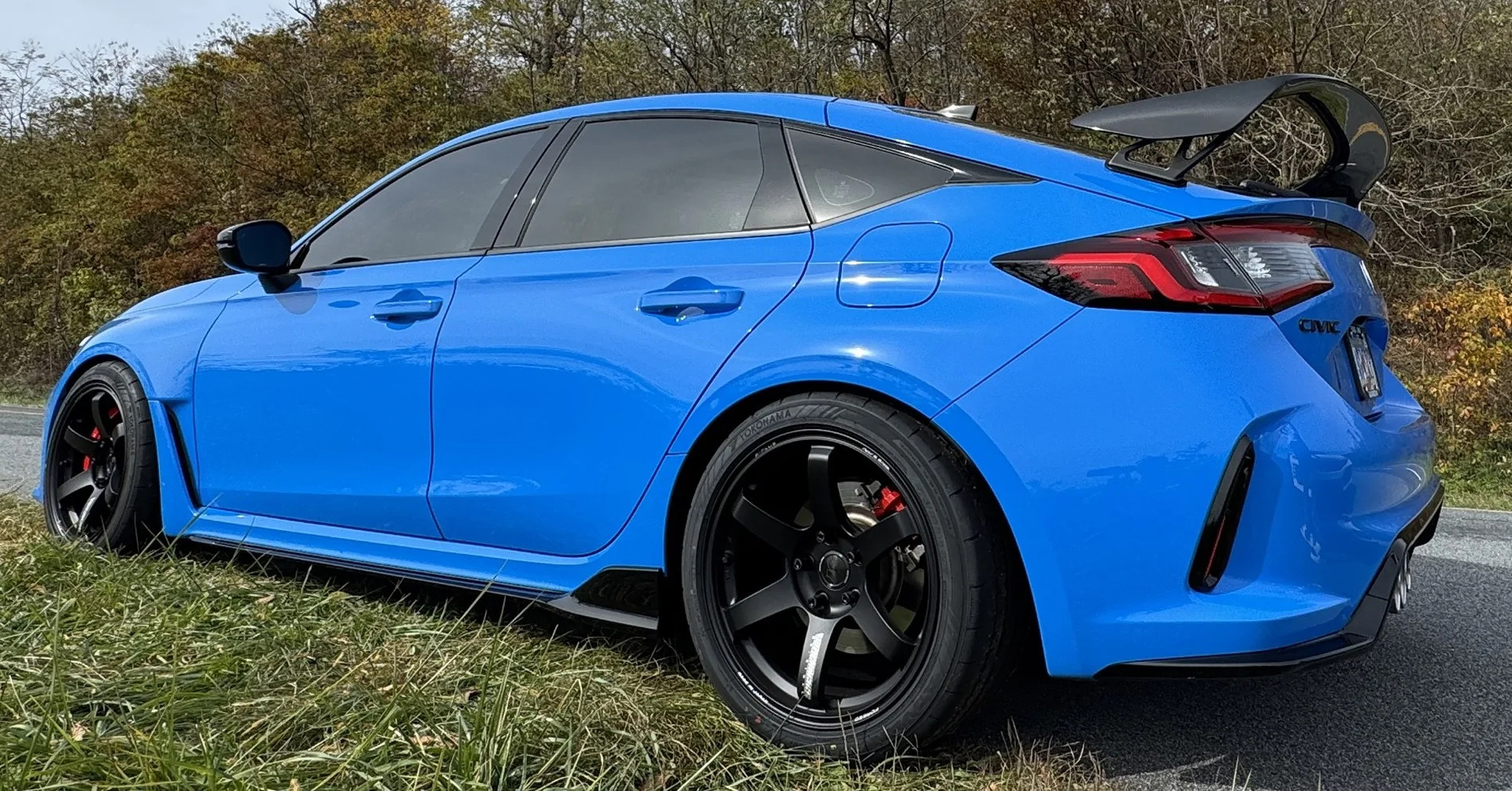

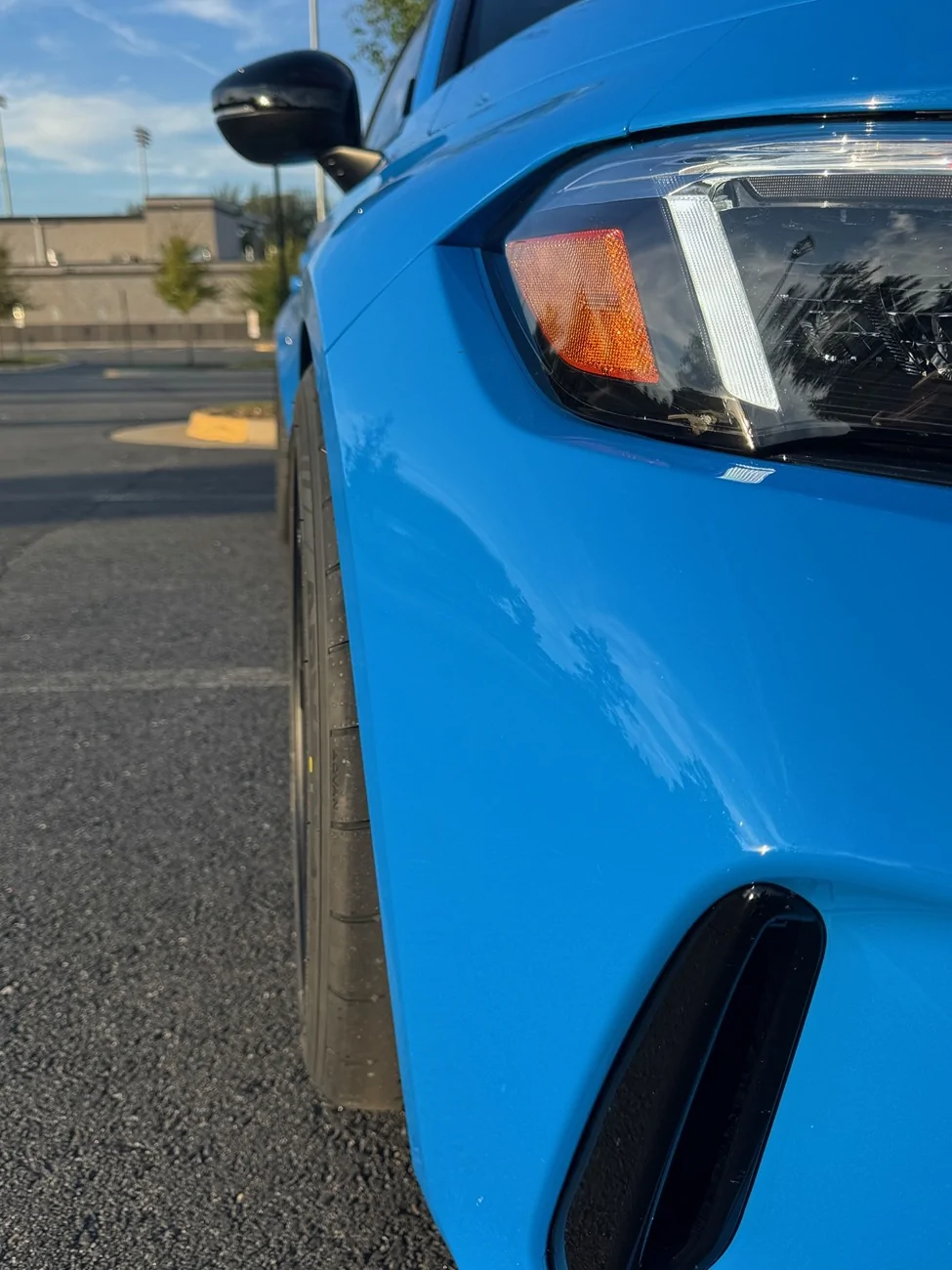

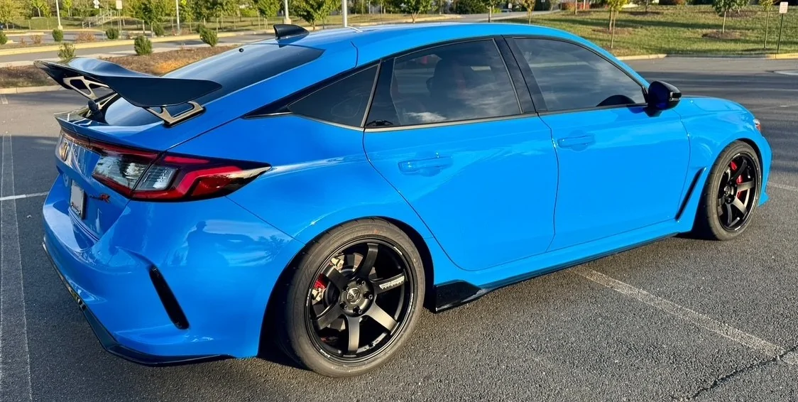

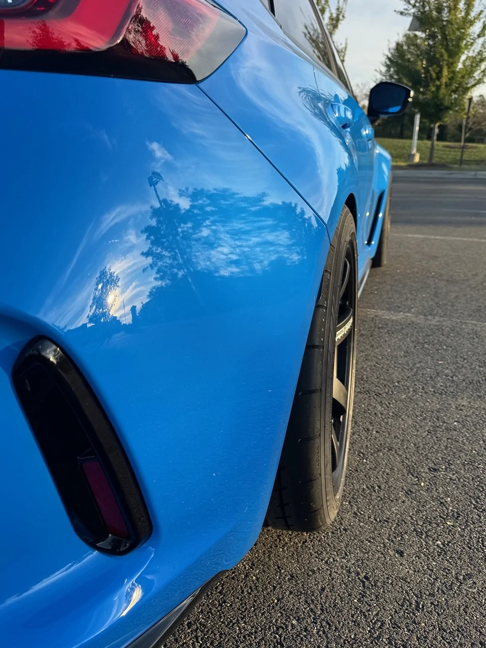

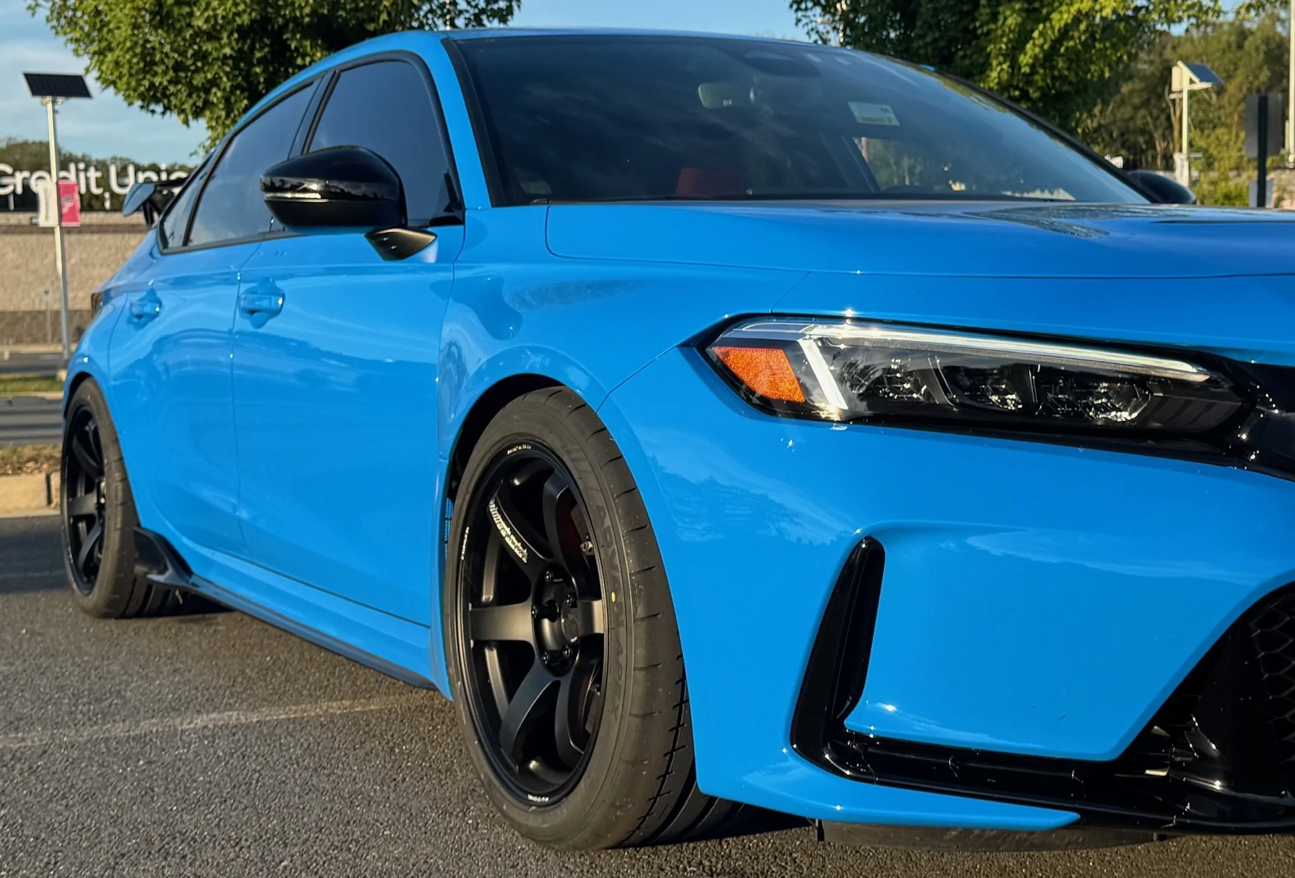

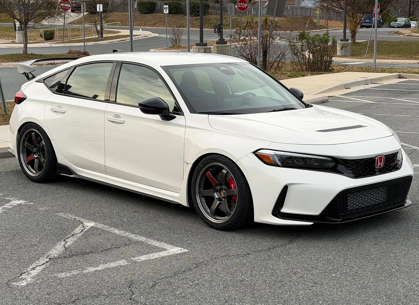

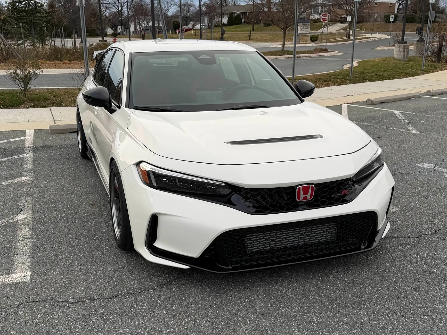

Took a bit of risk with this setup, as I couldn't find anyone running the same suspension. Thes are RSR springs, with 18x9.5+38 and 275/35 tire.
The RSR's sit lower than sportlines or swifts, so was concerned about potentially rubbing particularly in the rear. Ended up with zero rubbing. Fitment is basically perfect, stock alignmnet pin is still in, and the ride quality is drastically better on 18's. I'm actually left wondering if my oem wheels were overinflated as the ride is night and day.

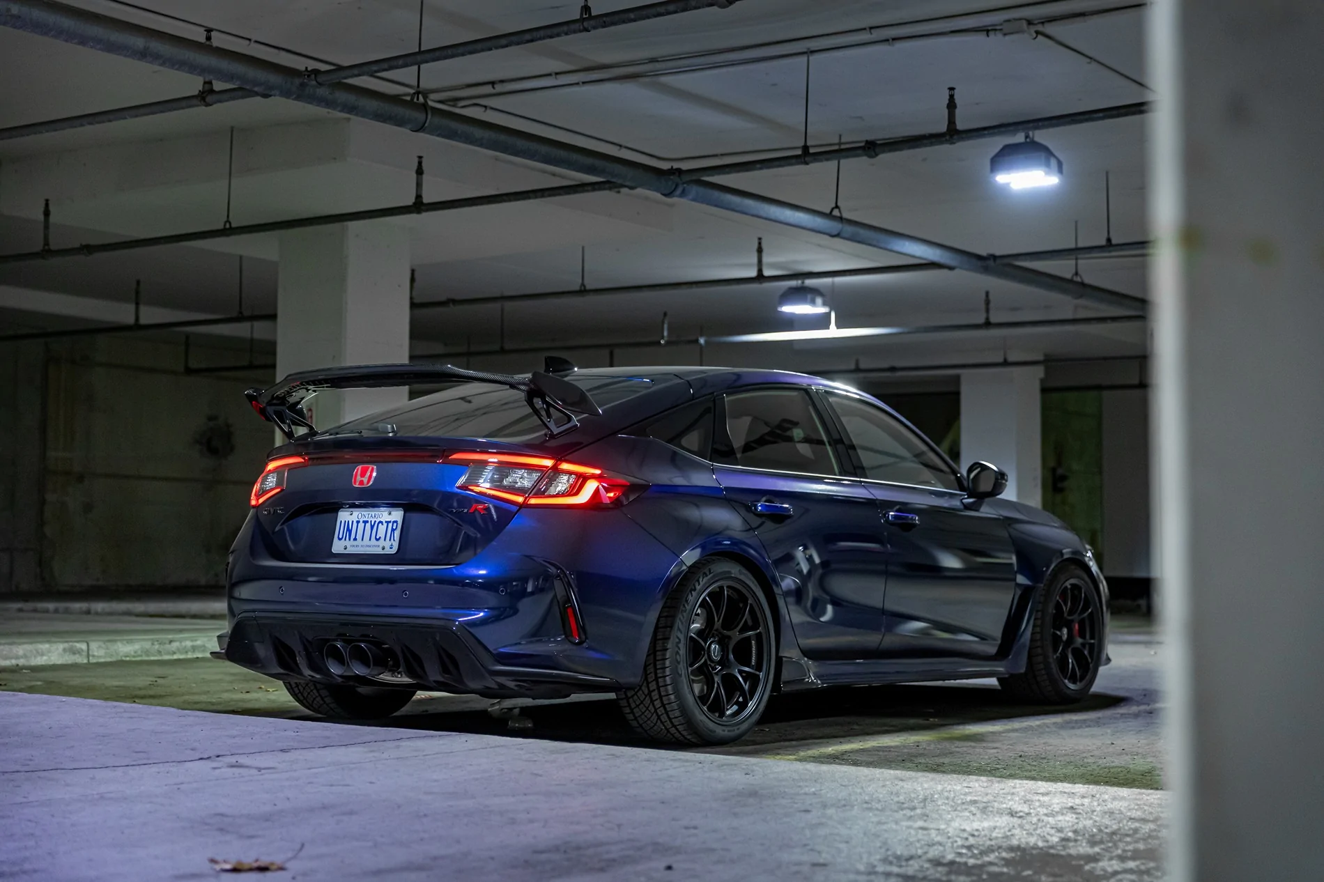

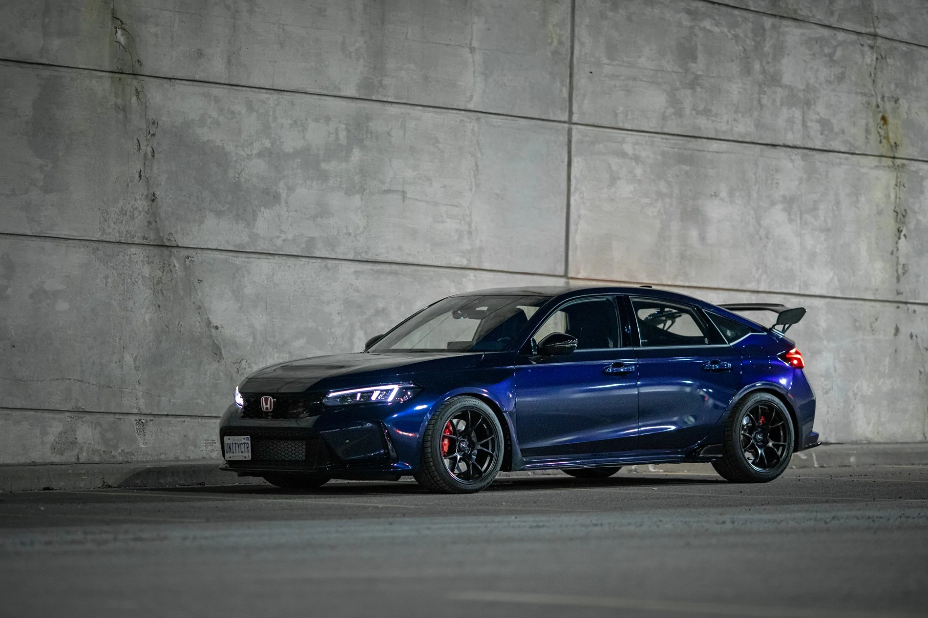

18x10.5 +47
285/35R18 Continental DWS06+
No rubbing with H&R Springs, and briefly this set was installed on our second tester FL5 with Swift Springs. Also no rub - thoroughly tested with passengers, bumps, full-lock turns etc.

what else is done on this car besides sprins? Pulled pins, ball joints, etc?
Unity Performance
Humza
Dec 16, 2021
373
815
Toronto, ON | Buffalo, NY
unity-performance.com
Pulled pins for camber, but it wasn't necessary for clearance. Factory ball-joints.
It's a rounded shoulder UHP All-Season tire so there is more room than the squared shoulder 200TW offerings. We've sold over a dozen sets in this spec - I haven't collected data from customers that details what tire brand and model, size, and suspension mods they have.
