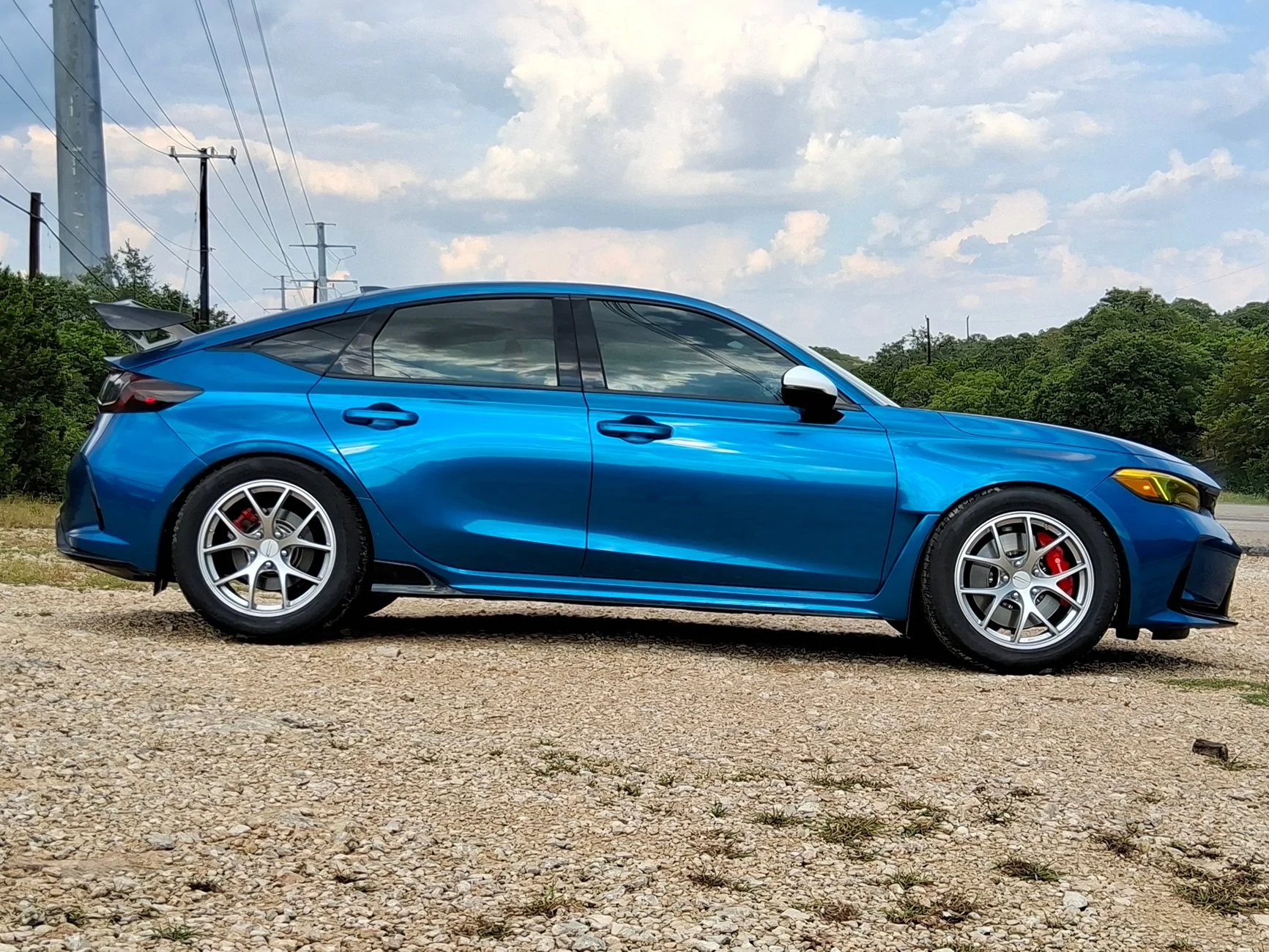

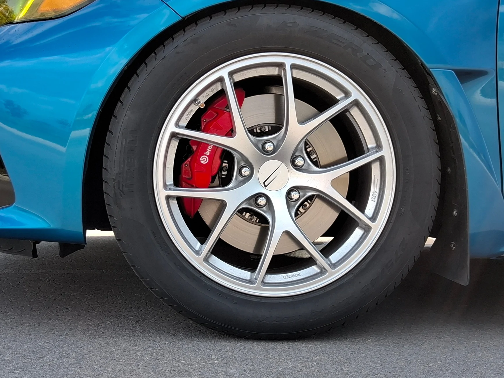

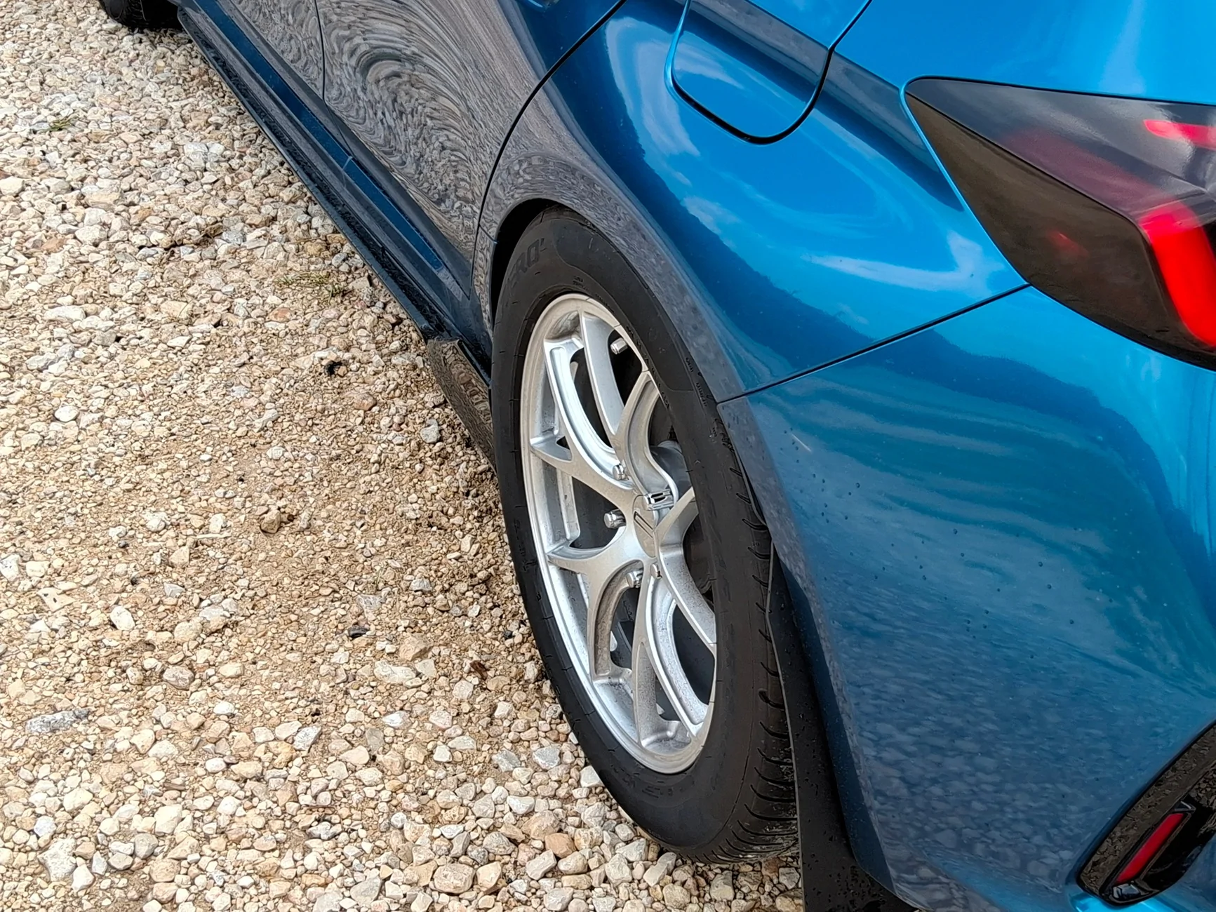

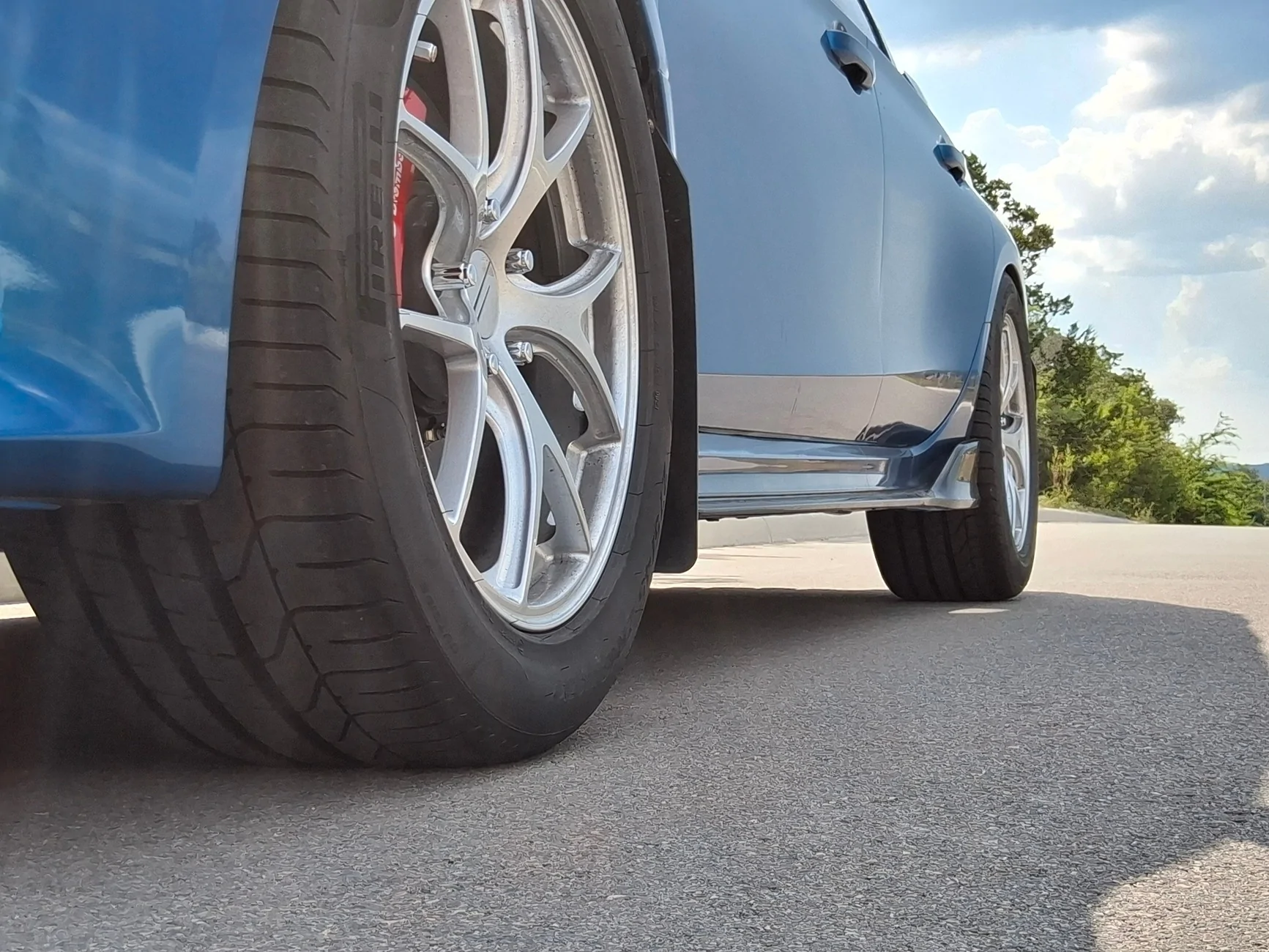

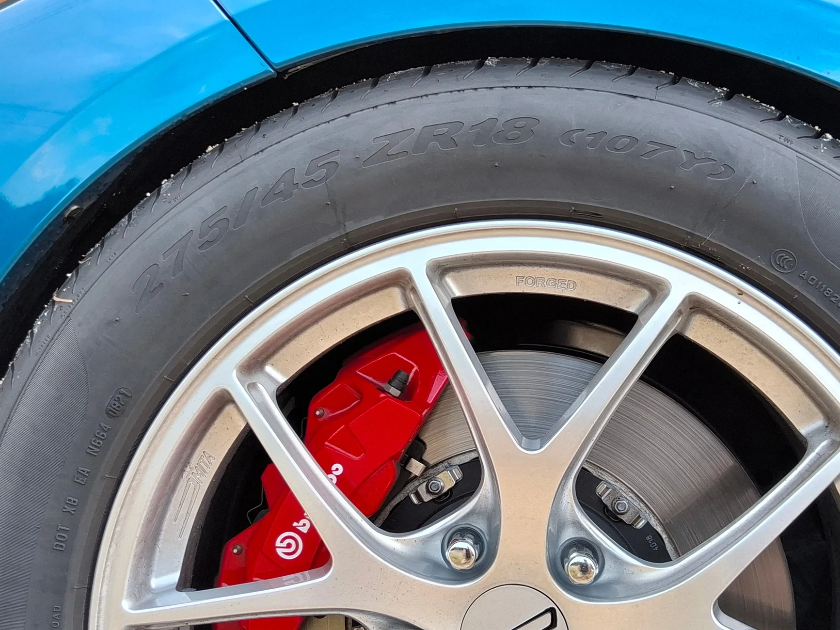

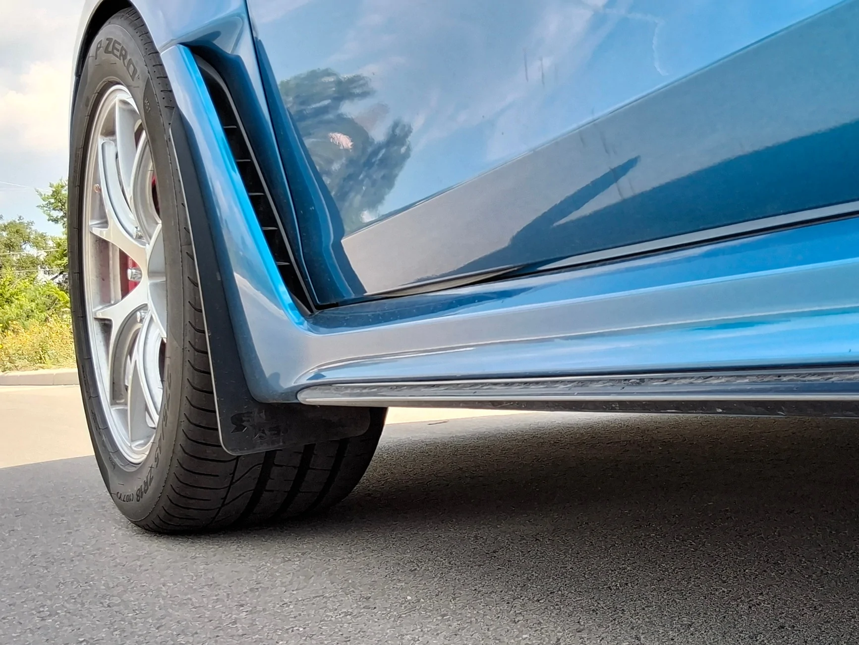

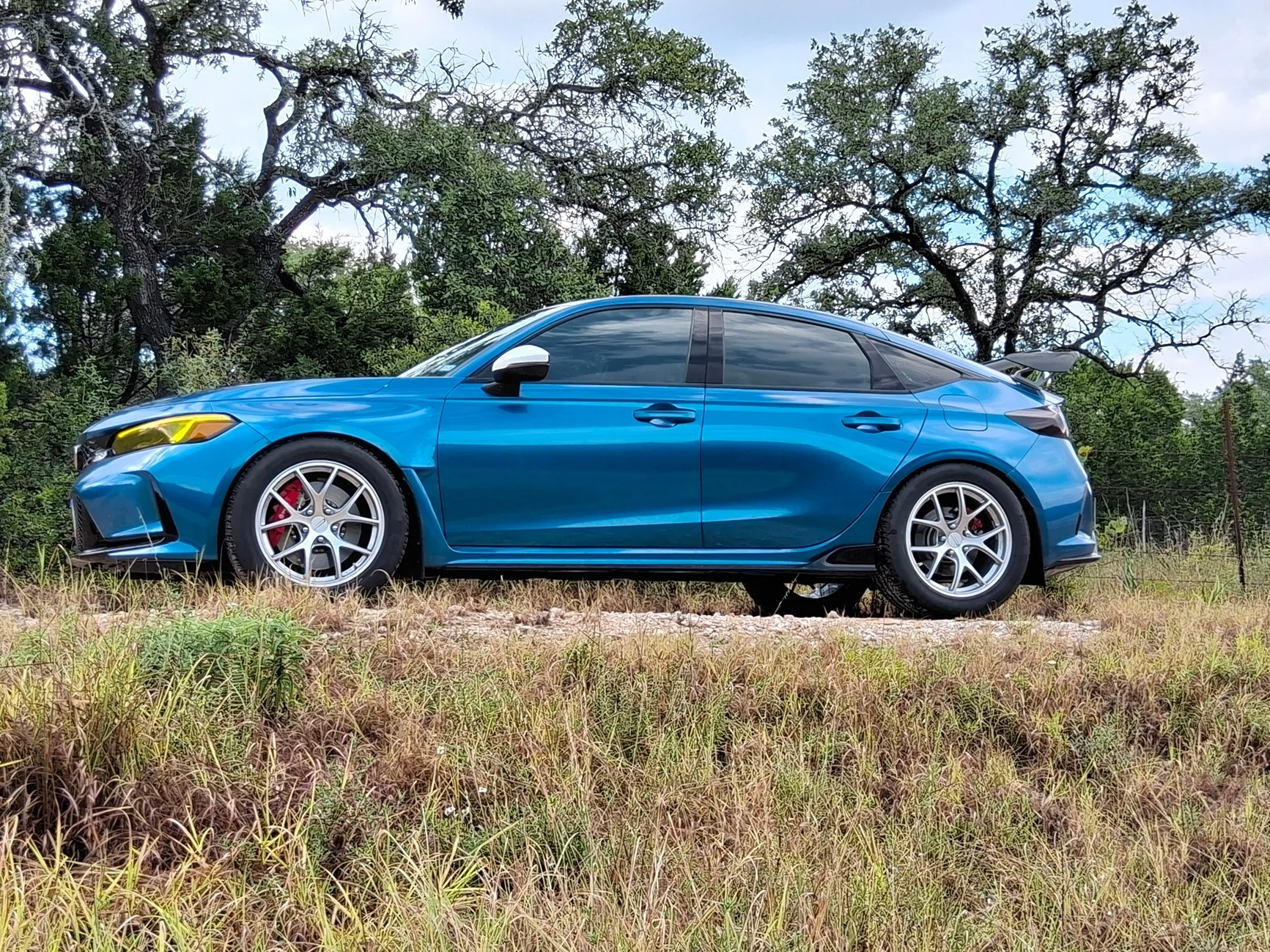

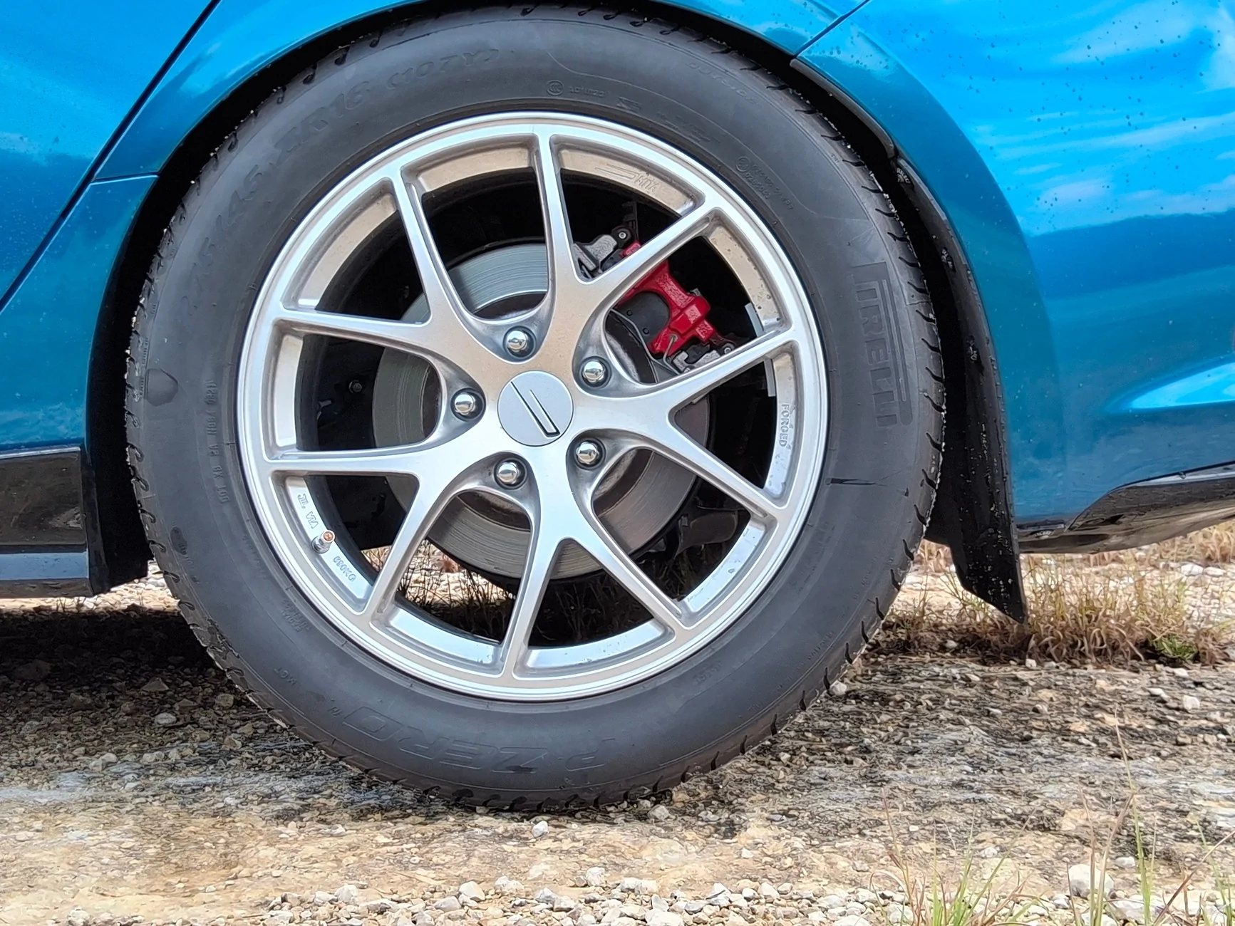

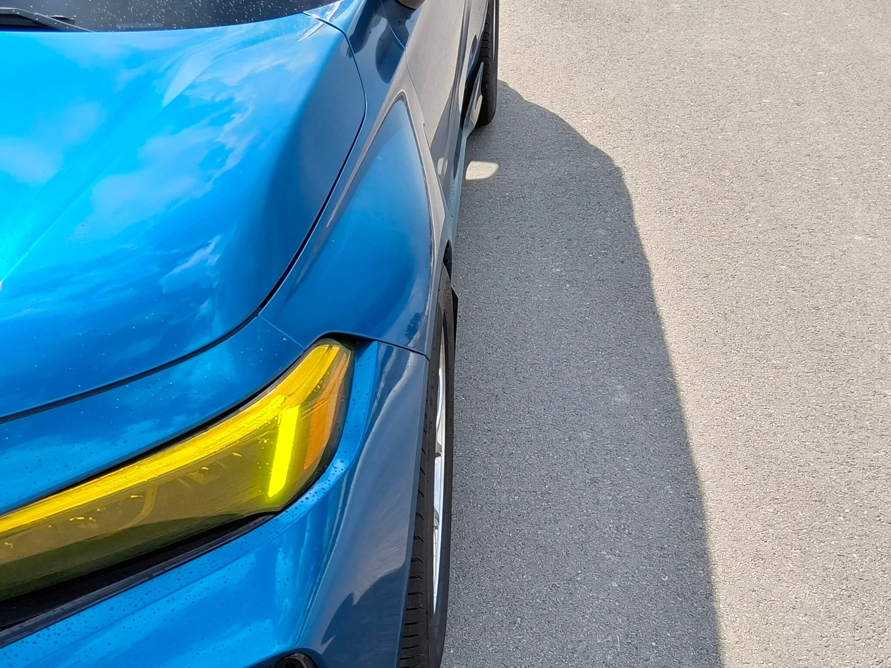

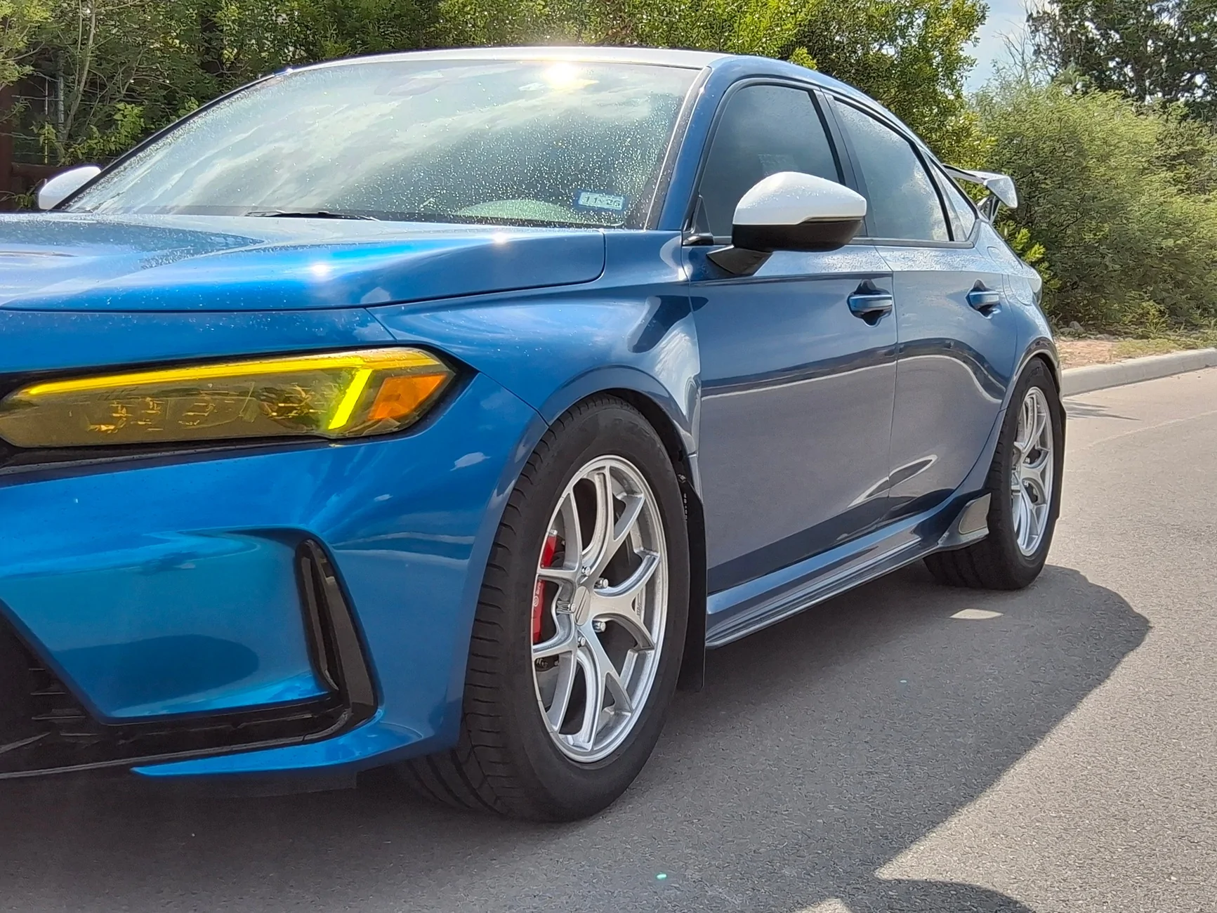

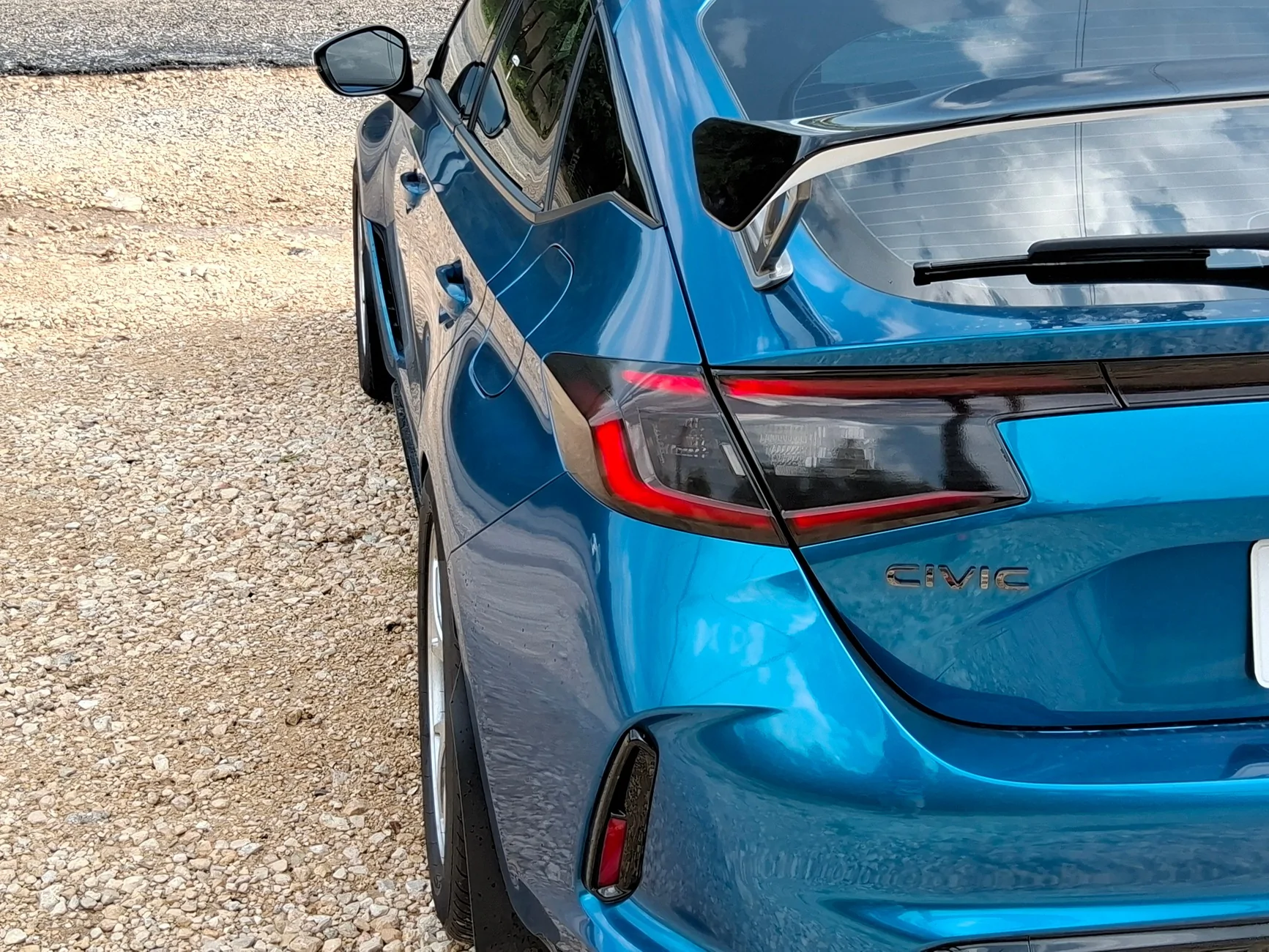

Here is ONE of the variables that pushes the fitment, admittedly, beyond the limit of usable performance. I did it for science... and because fun!
My FL5:
* OEM FL5 suspension
* OEM FL5 damper module
* OEM stock camber.
I installed Pirelli P Zero 275/45 ZR18 summer tires on MITA Motorsports FKS 18X9.0J ET +45 wheels.
Comfort suspension mode is too soft and causes rubbing upon light braking while turning and driving over minor bumps and dips in the road.
I drive only in Sport mode for now, and I still get some rubbing during moderate braking while turning and driving over medium bumps and dips in the road.
Any hard braking will always rub the front tires on the wheel wells.
However, the ride quality is super smooth, which is nice for highway driving.
Priorities, ammiright?
Gonna probably go with 275/40 ZR18 tires next time around on the 18X9.0 wheels.
I hope this little science experiment helps other people decide on proper fitments for themselves.
Cheers!

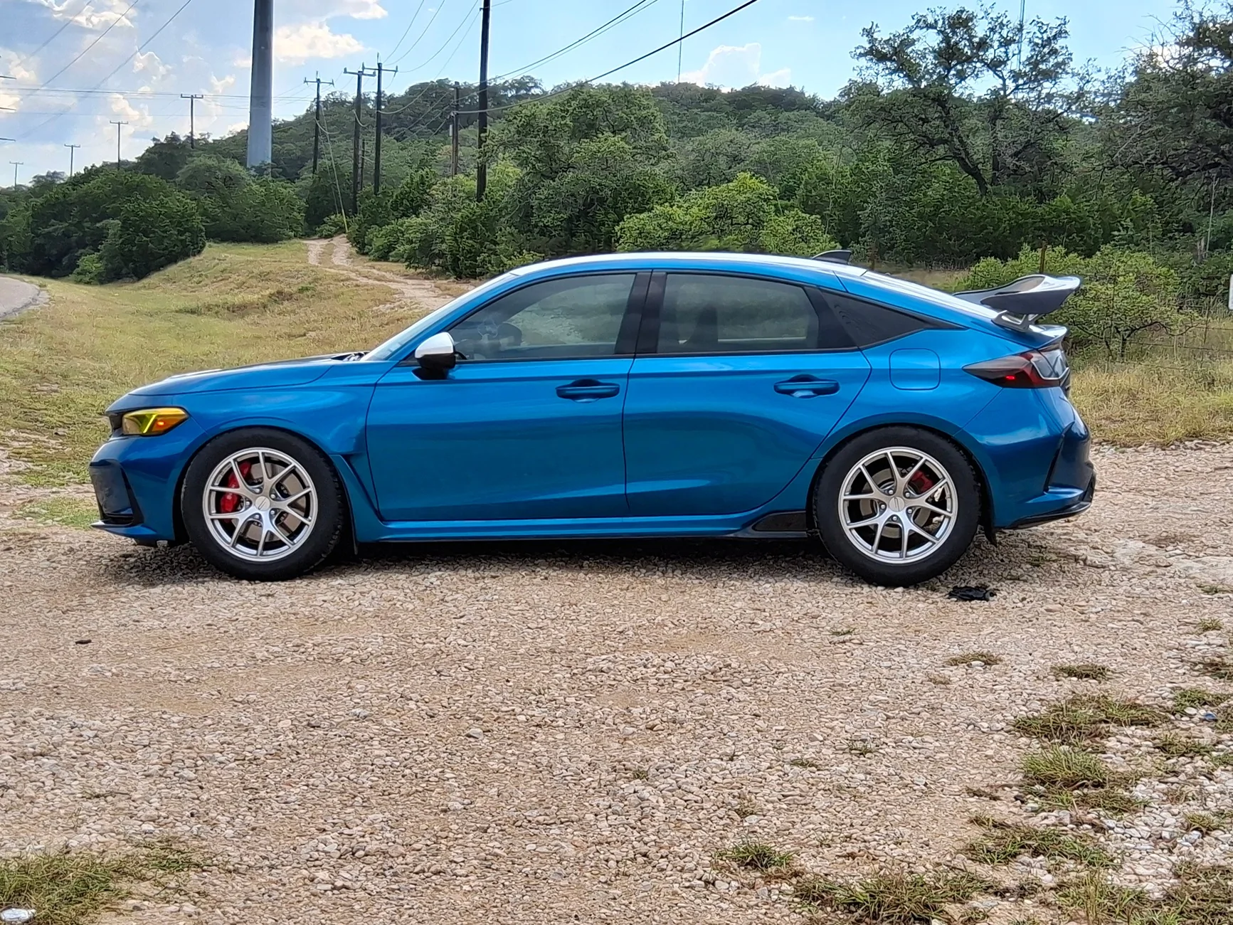

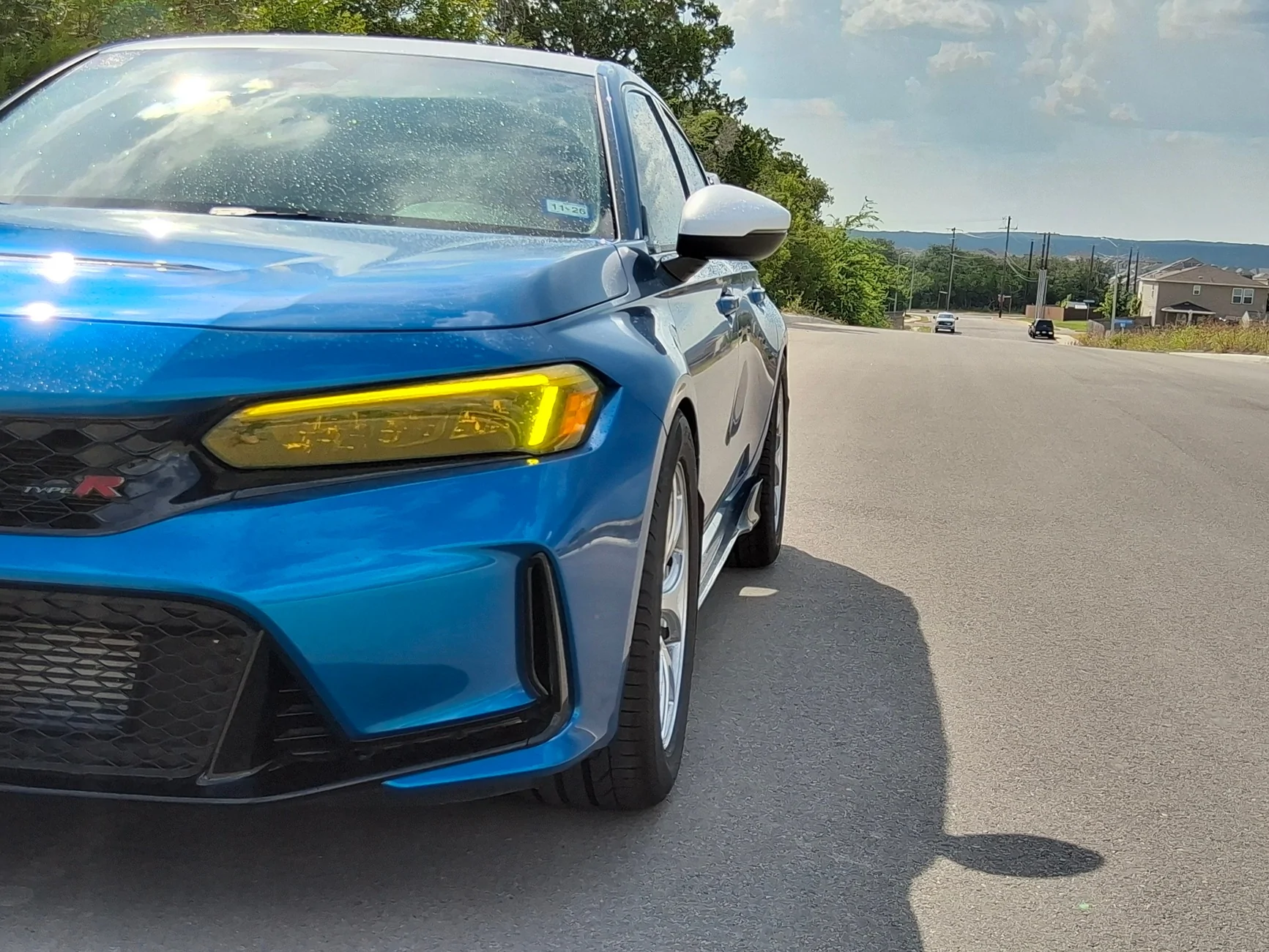

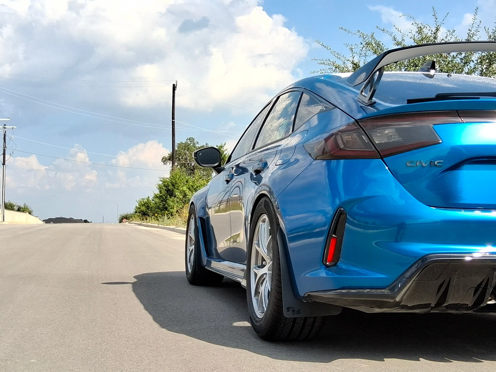

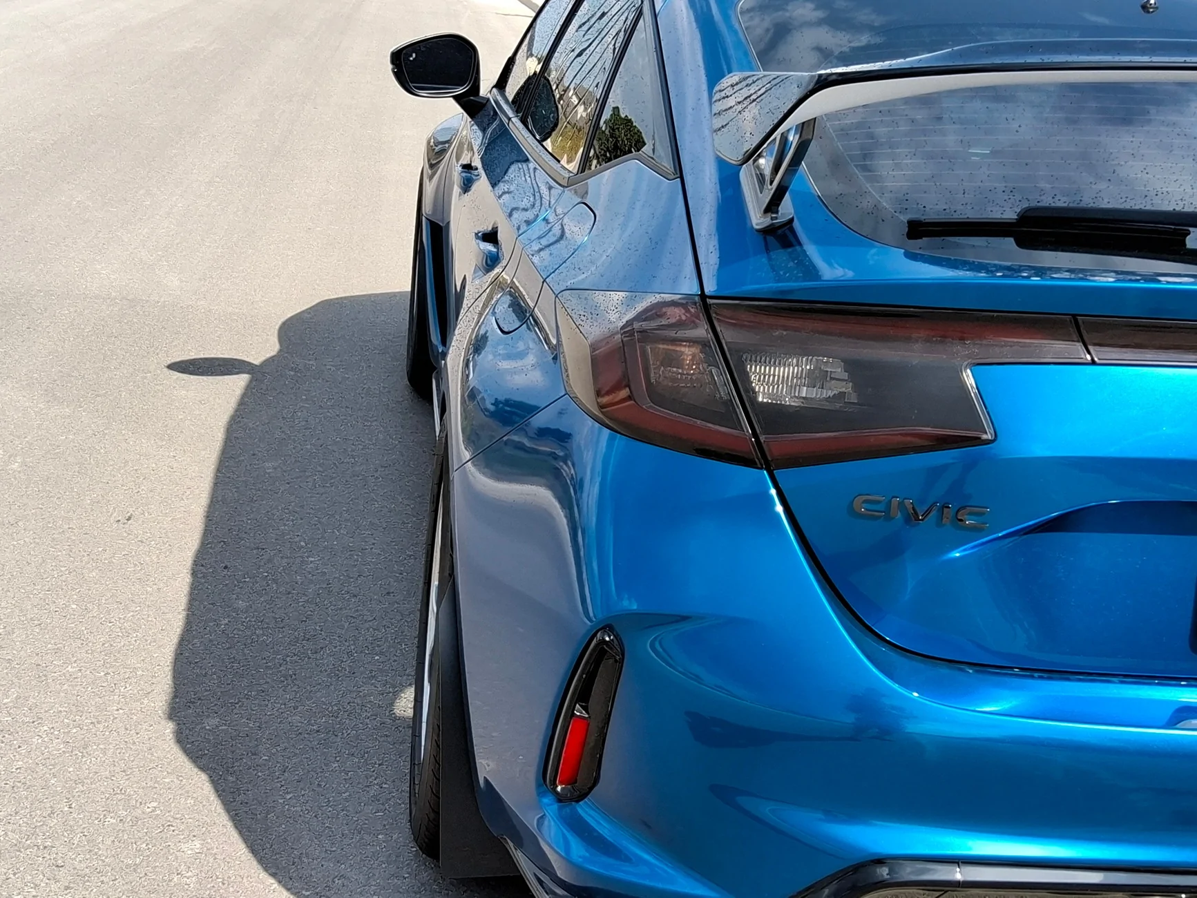

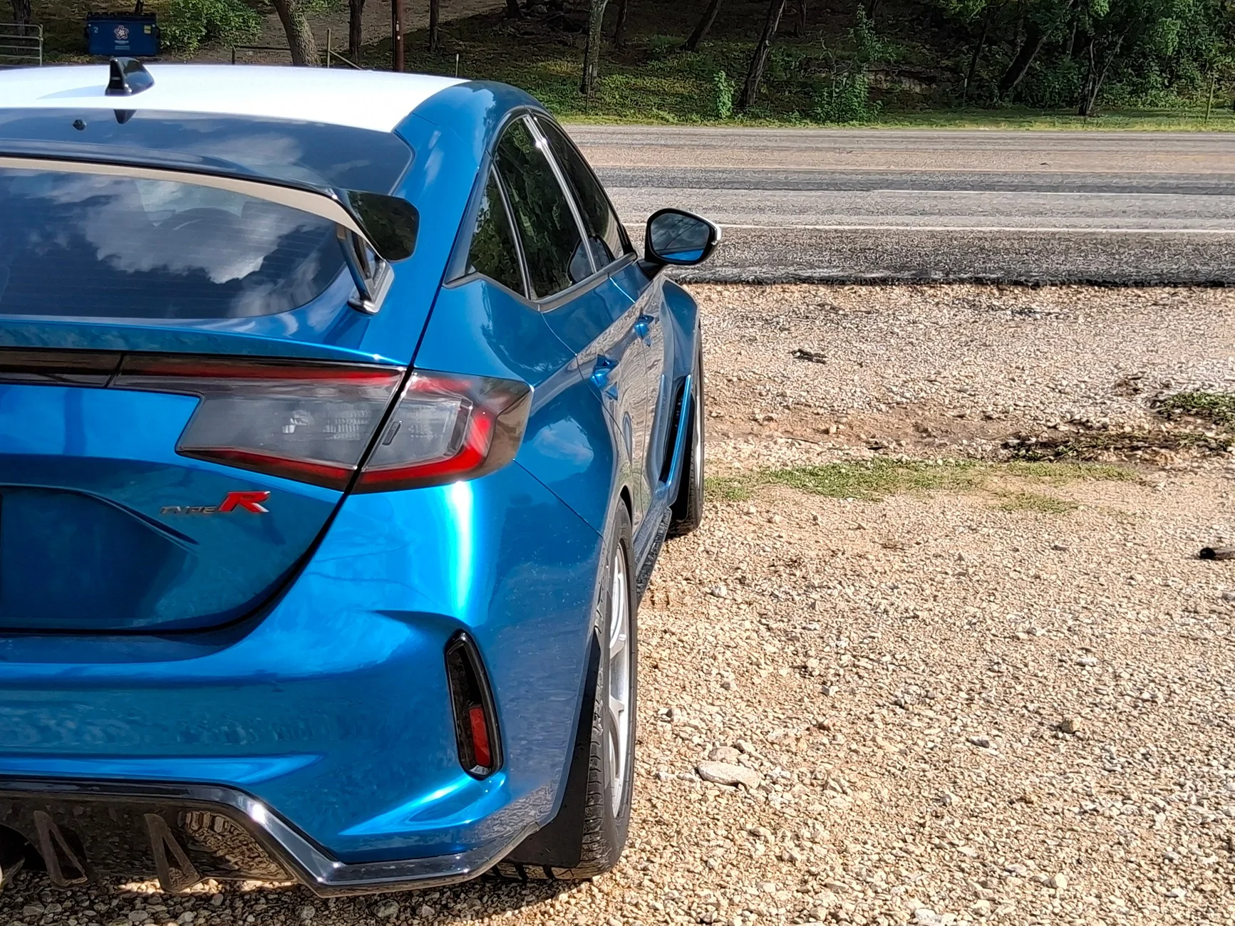

Some photos "On the trail":
11th Gen Honda Civic Official Wheel Fitment Thread for 11th Gen FL5 Civic Type R 20250820_173047
11th Gen Honda Civic Official Wheel Fitment Thread for 11th Gen FL5 Civic Type R 20250820_173904
11th Gen Honda Civic Official Wheel Fitment Thread for 11th Gen FL5 Civic Type R 20250820_174139
11th Gen Honda Civic Official Wheel Fitment Thread for 11th Gen FL5 Civic Type R 20250820_174328
11th Gen Honda Civic Official Wheel Fitment Thread for 11th Gen FL5 Civic Type R 20250820_174351
11th Gen Honda Civic Official Wheel Fitment Thread for 11th Gen FL5 Civic Type R 20250820_174409
Cheers.

18x9? why go narrower than the stock wheel?
I wanted a narrower wheel / wider tire combo than OEM.
The wide wheel on narrow tire stock combo may be great for track performance, but it is a bit too stiff and squirrelly for my liking during road and highway driving.
A curb has already reached out and kissed one of my stock OEM wheels. So I like a taller + wider tire on a (barely) narrower wheel for comfort and peace of mind.
Obviously, the 275/45 ZR18 is a bit TOO tall. I'll likely be installing a 275/40 ZR18 next time around.
