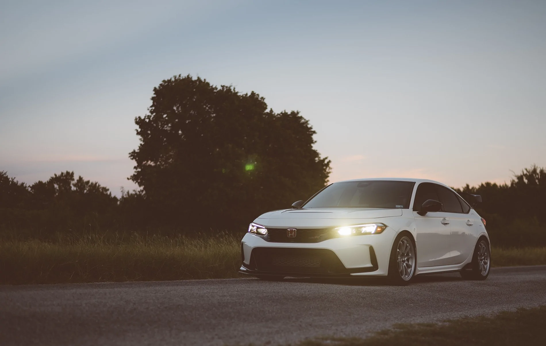

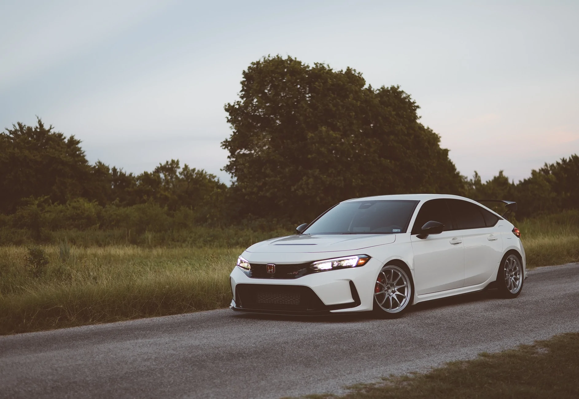

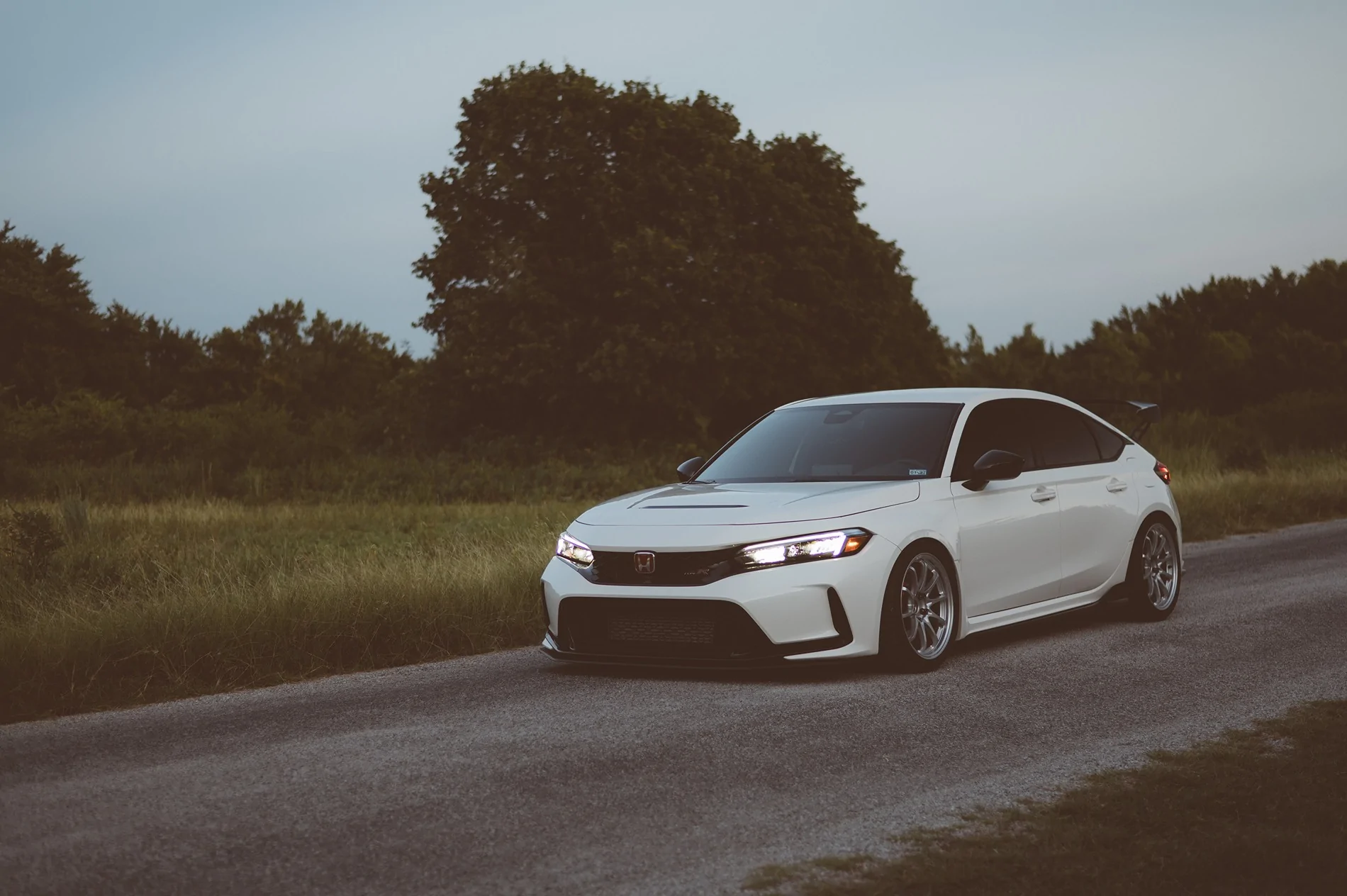

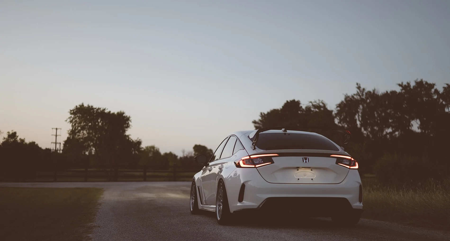

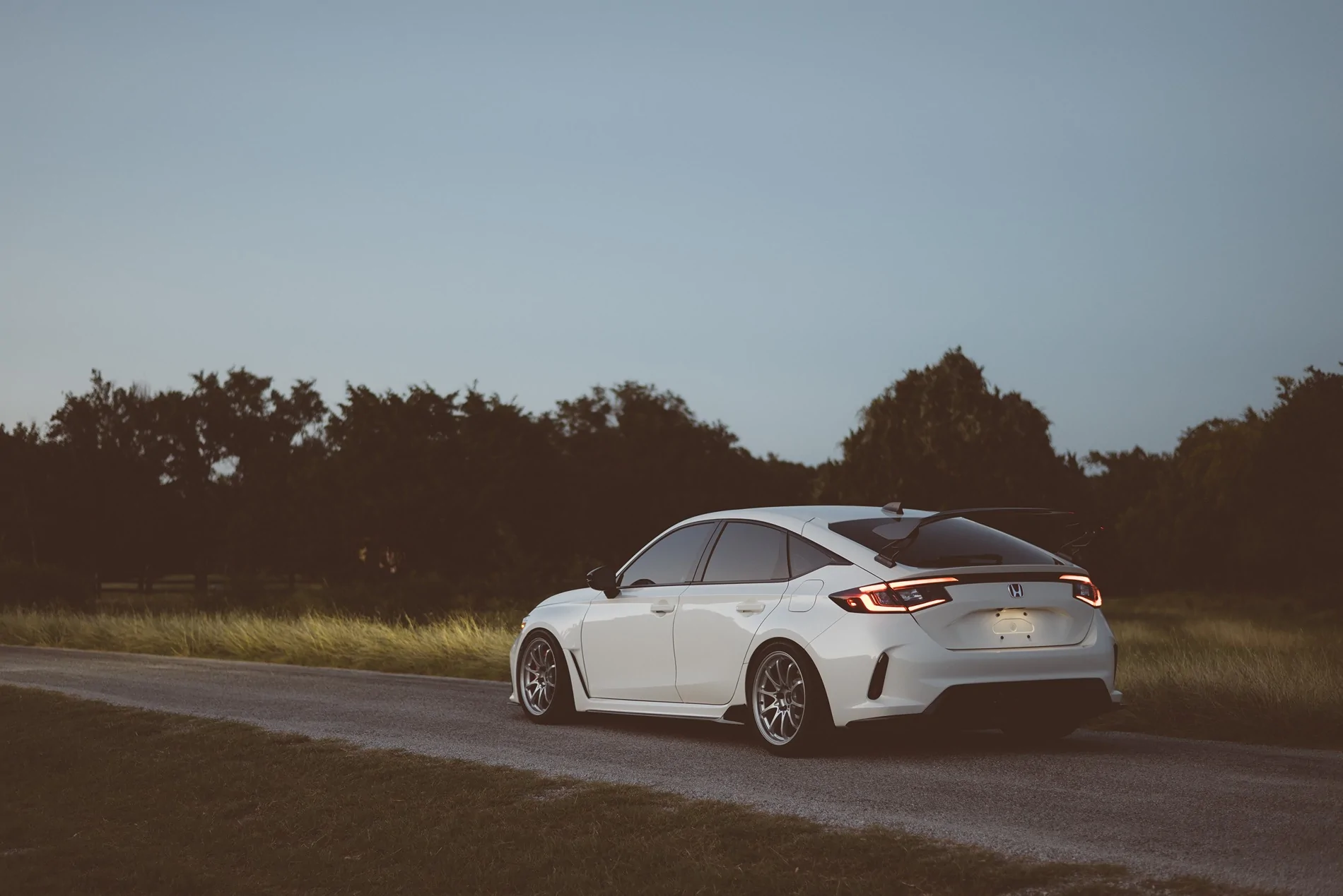

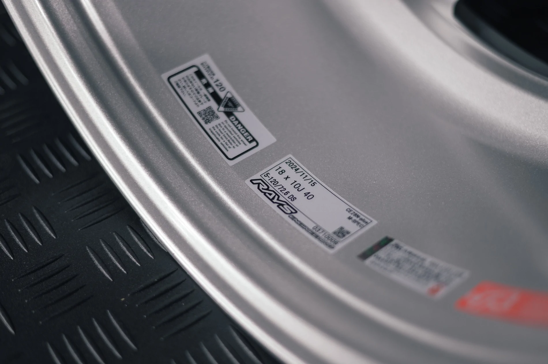

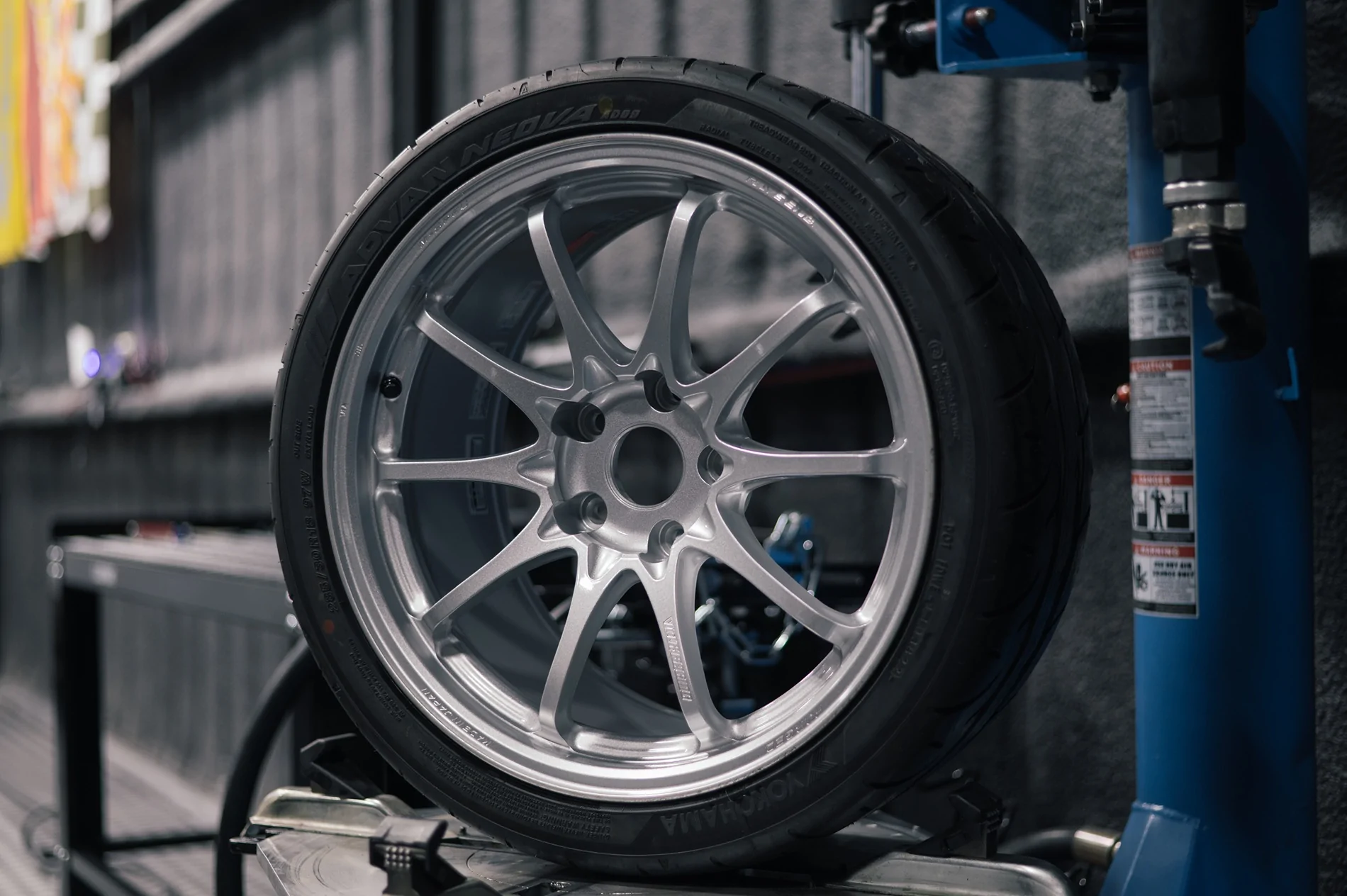

Got one of our orders in for new wheels.
Volk Racing CE28N Plus M-Spec in Diamond Silver
18x10 +40 5x120
Yokohama Advan Neova AD09 285/30/18 (originally wanted to do 295/30 but 295 was on backorder from our distributor).
We have a set incoming for fall for same spec CE28N Plus M-Spec but in Diamond Dark Gunmetal and will be for sale! Also have a set of landed Diamond Silver (exact same thing you see here) ready to go as well.

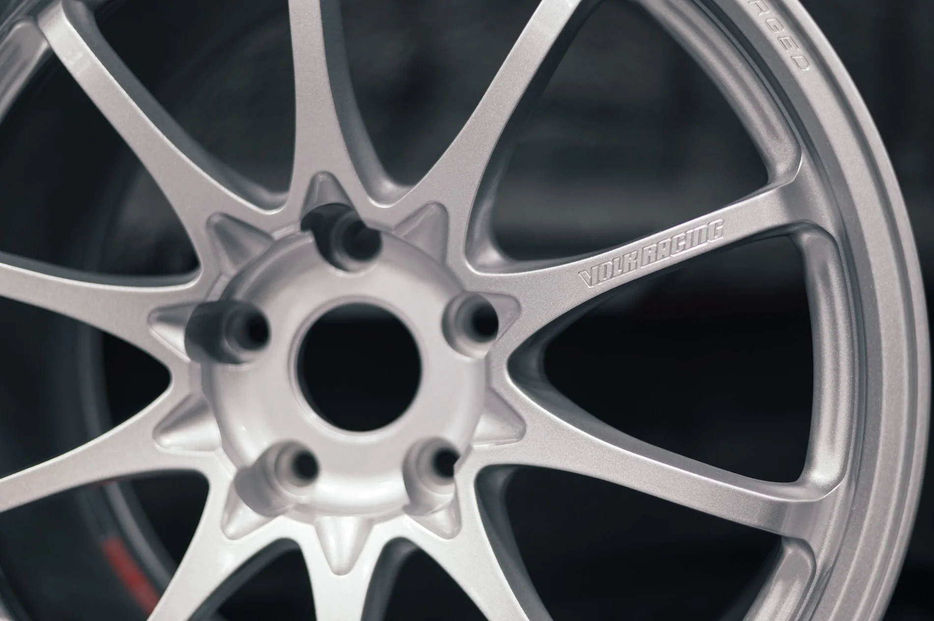

Anyone running CE28N+ 18x9.5 I found that the center cap size outer diameter is about 65mm and the inner diameter about 63mm to clip in. These fit perfect and I’m very happy with how they look. So much cleaner looking. Nothing worse than nice wheels with rusty brake rotors in the middle
