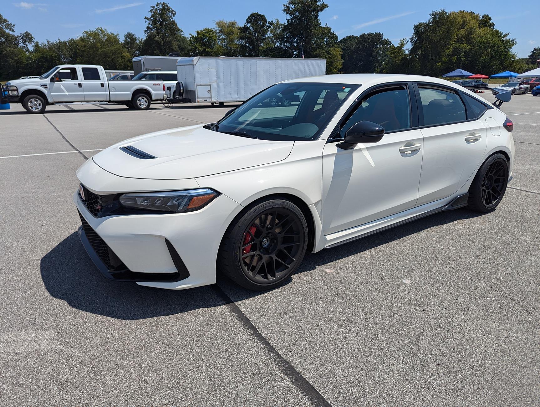

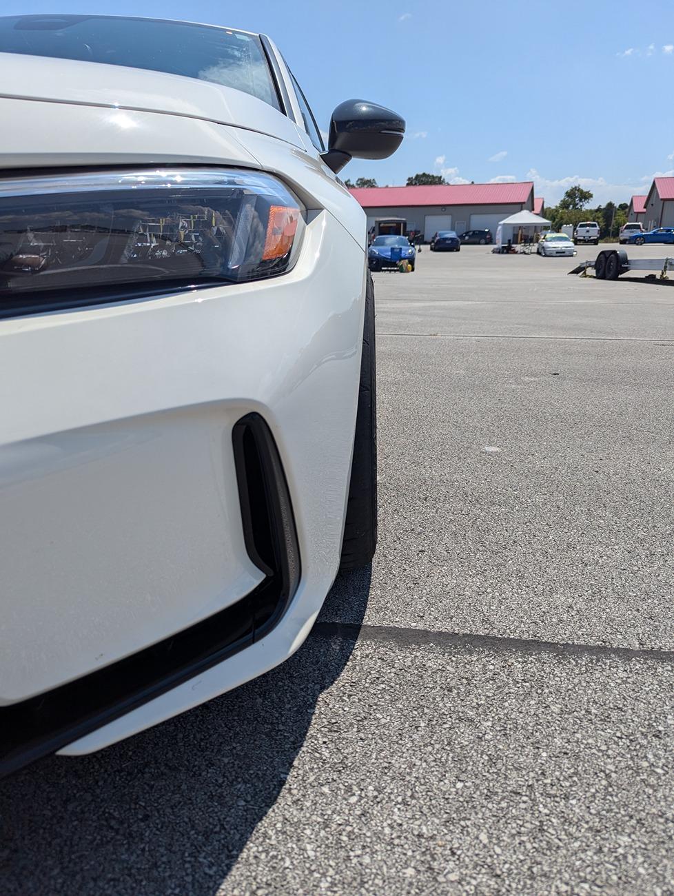

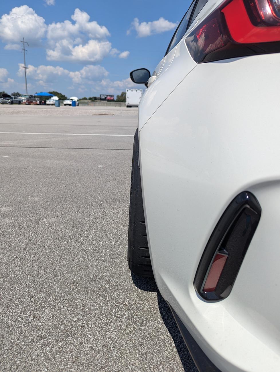

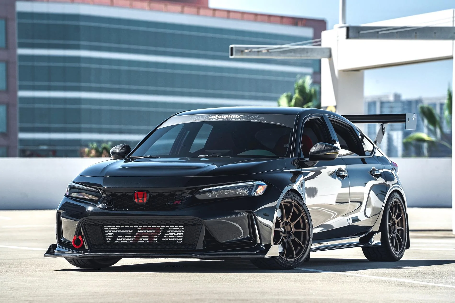

There are a lot of narrow wheels in this thread so I figured I'd share my setup. :)
18x11 ET44 Apex Arc-8
285/30R18 RE-71RS
Ballade Front Camber Plates (~-2.5°)
Swift Lowering Springs
There's more poke than I'd ideally want (ultimately this is the set I'll use when I go further with coils and rear camber), but so far no rub even with the poke, even at autocross.
285/30R18 RE-71RS

I’ve been eyeing the 57DR on your site but I feel that I would regret the offset. Is there a reason why they went with +38 instead of something over +40? I want to wrap it with 275/35r18 and lower it with Swift or Spoon springs.
Should I risk it with that wheel or save up more money to get CE28 or TE37 with a +4X offset?
I am planning on running this exact set up, i already have the Spoon springs. Did it work without any rubbing and without any further modifications?

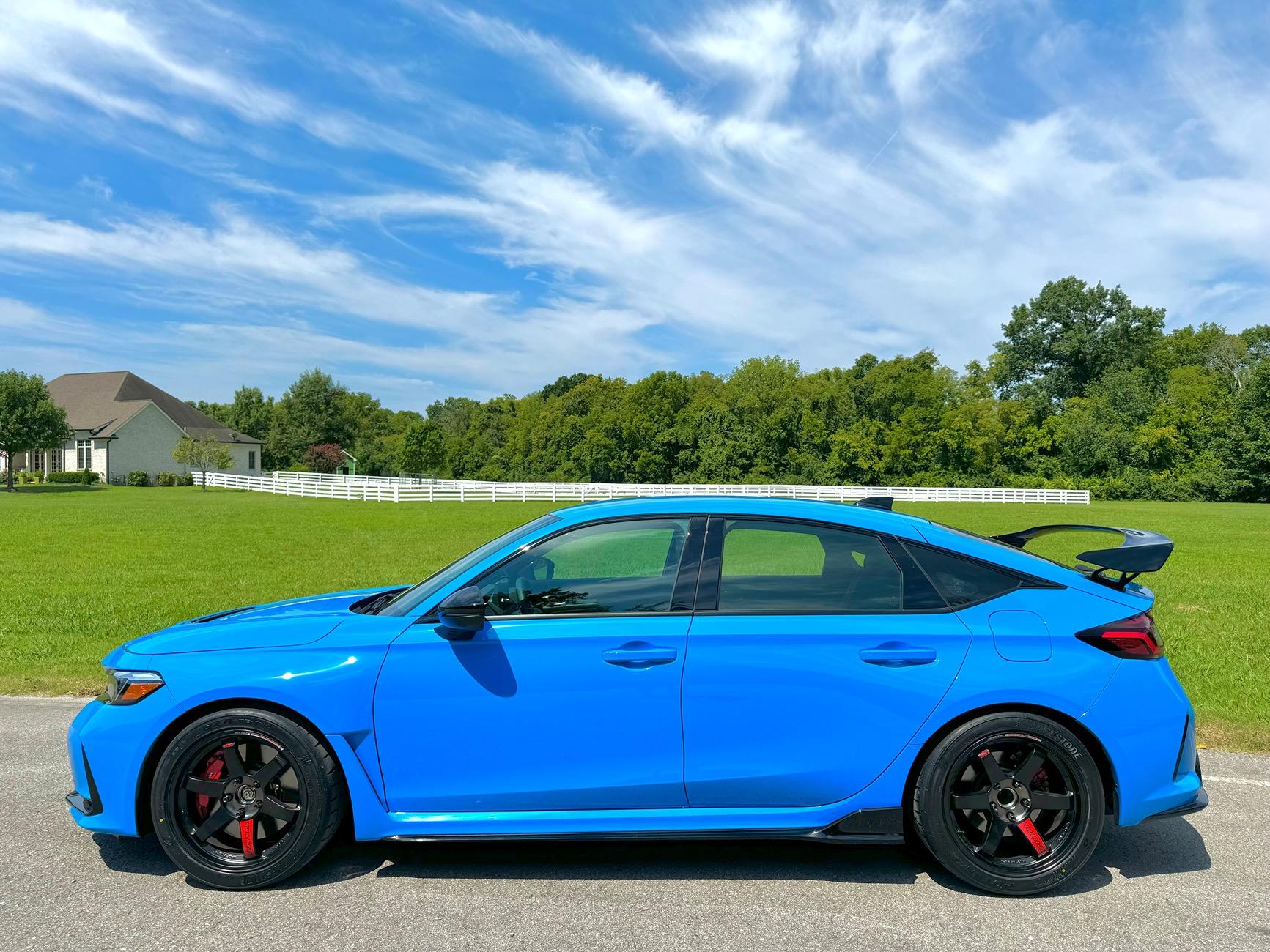

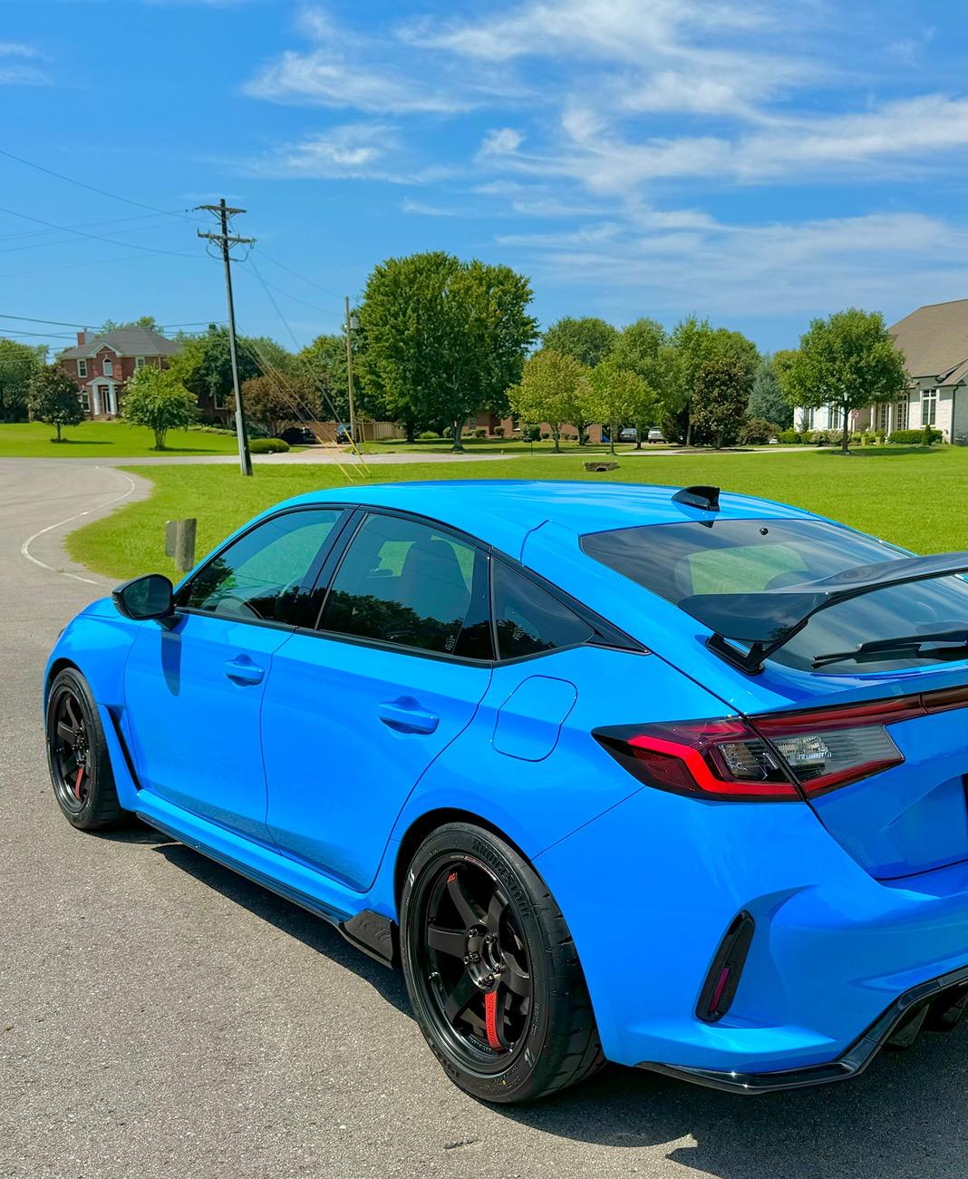

255/40/18
18x9.5 +37
Stock height
This looks pretty good. My wheels just showed up and I don't plan on spending money on tires right now so I've got time to make a decision since I'm very hesitant on lowering my car. I've had many in the past but as I get older, I find myself not wanting to deal with the decreased ride quality even though I love the look of tire against fender.
Back and forth.
Back and forth.
Same. No way I want to lower mine. I think it looks pretty decent with the slightly taller tire.
Back and forth.
Get some good coilovers. Properly set up you will have a much better ride/look then stock suspension.

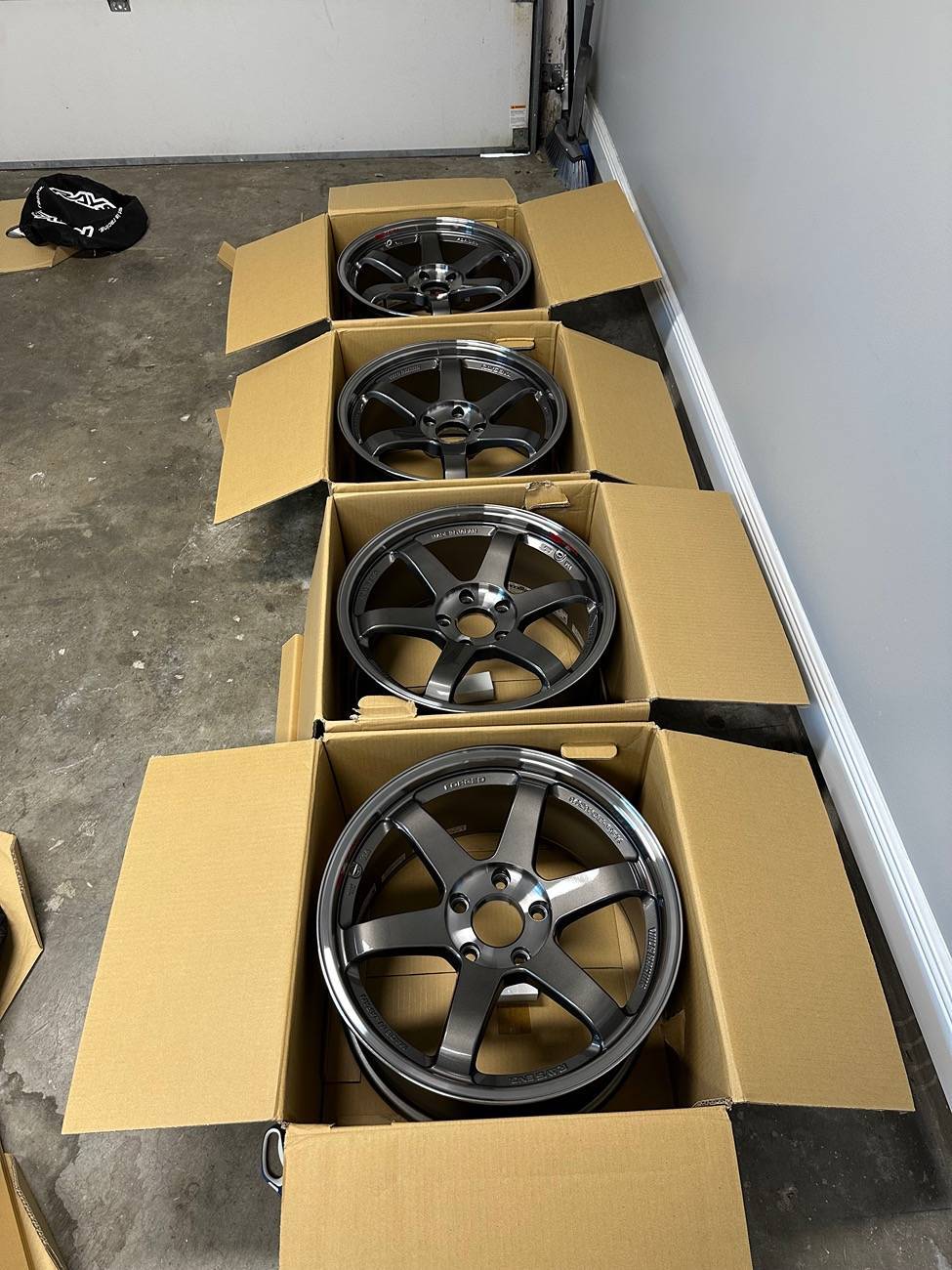

My bank account is giving me the side eye after just buying these volks lol
In that case don't tell your account about the additional expense of lugnuts, hub rings, tires, mount, ballance and alignment lmfao ?
Lugs and rings are in the garage, conti ecs02's are sitting in my tire rack cart lol
