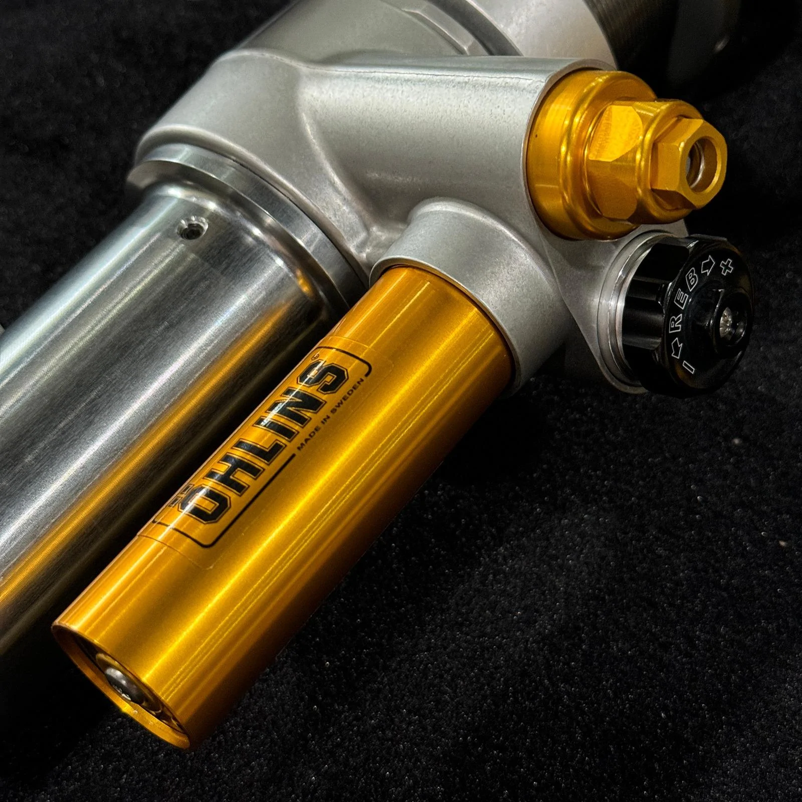

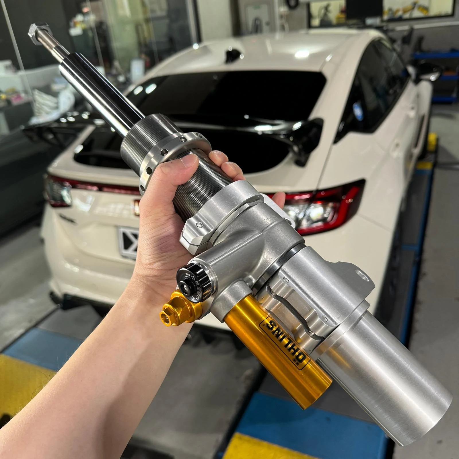

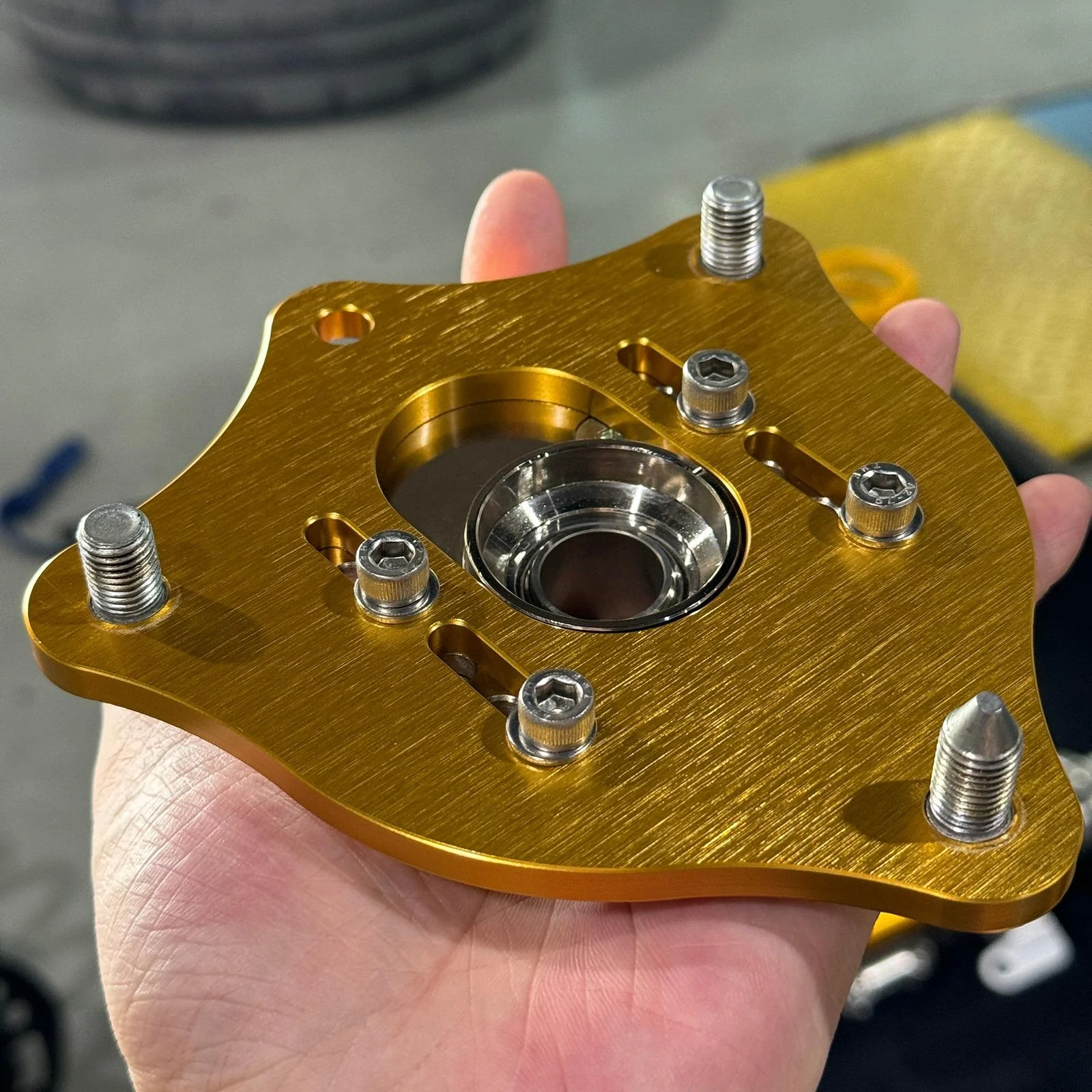

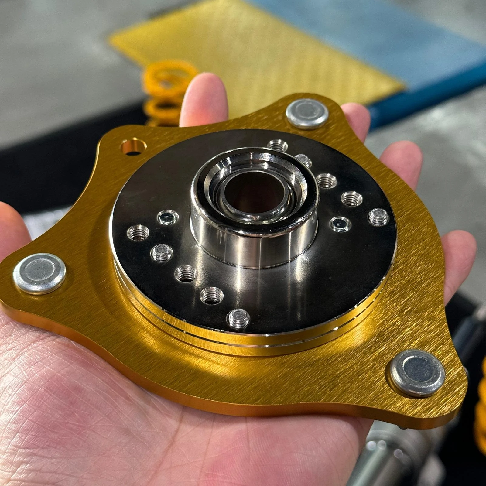

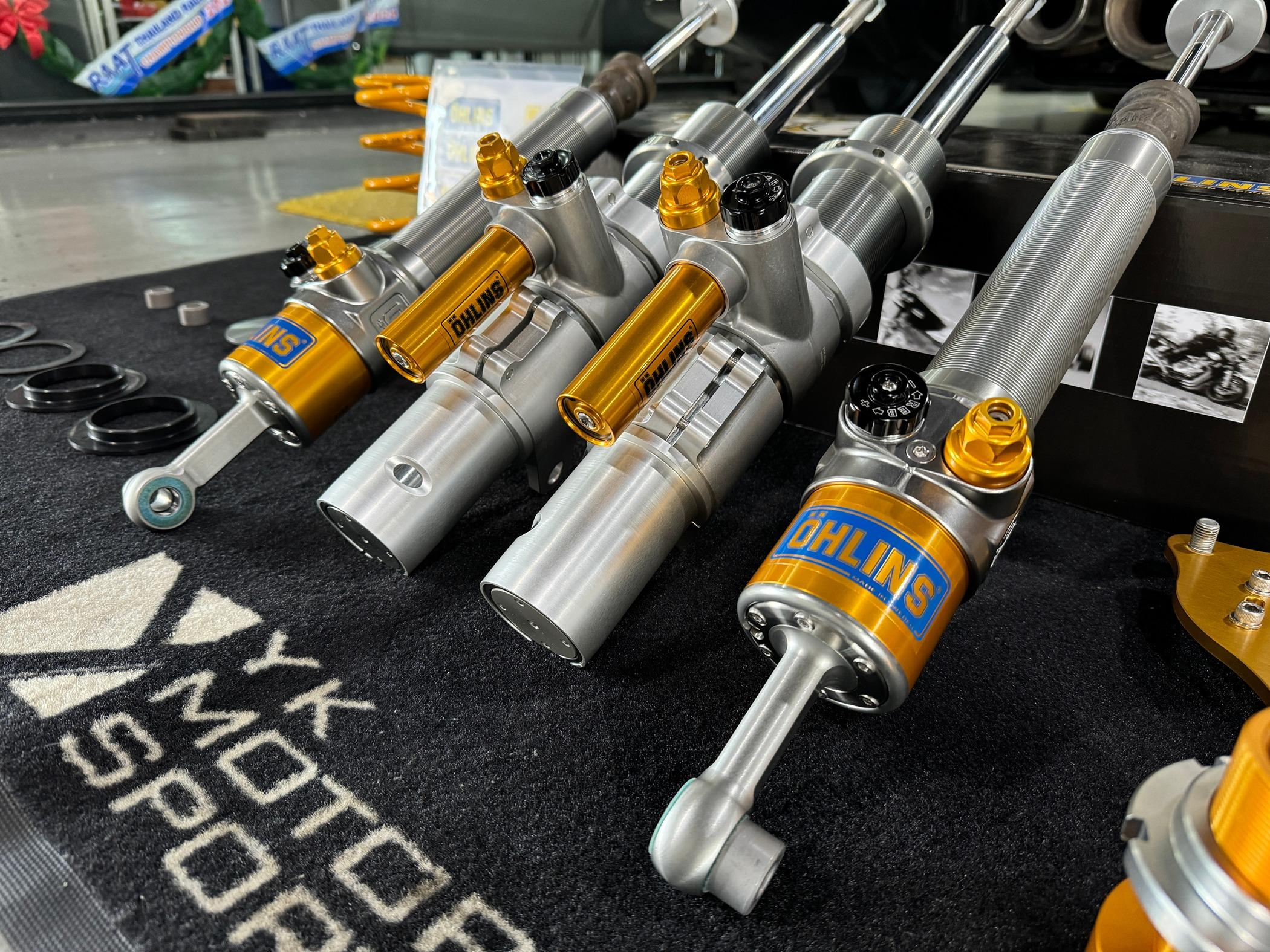

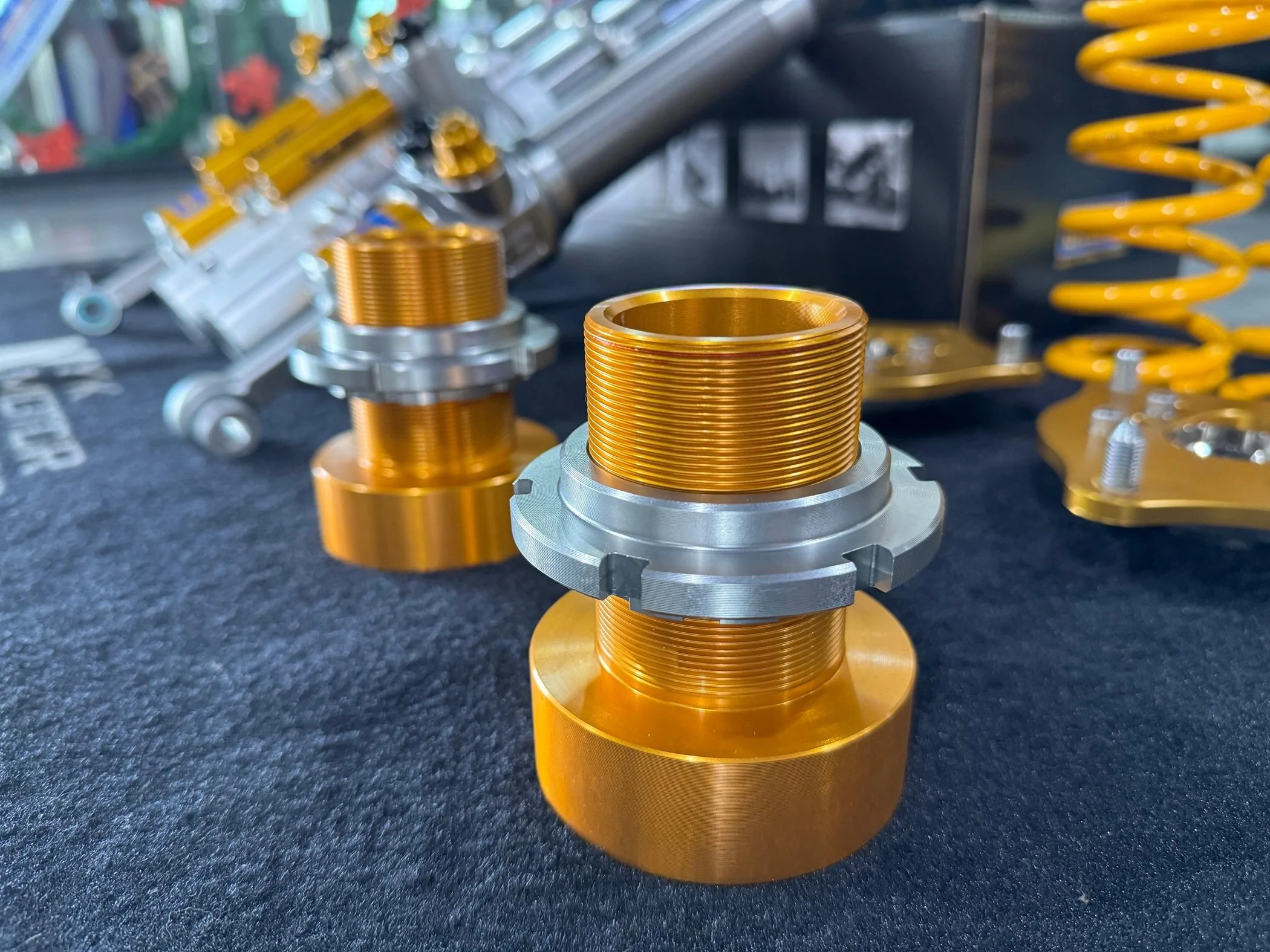

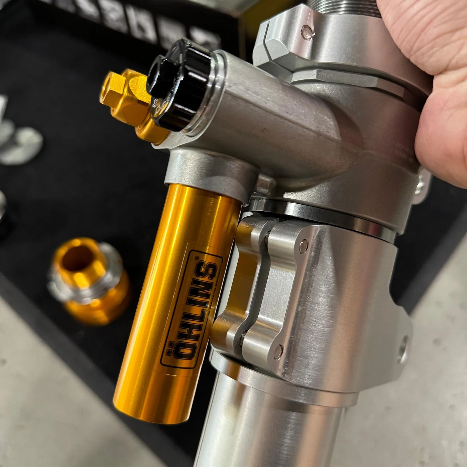

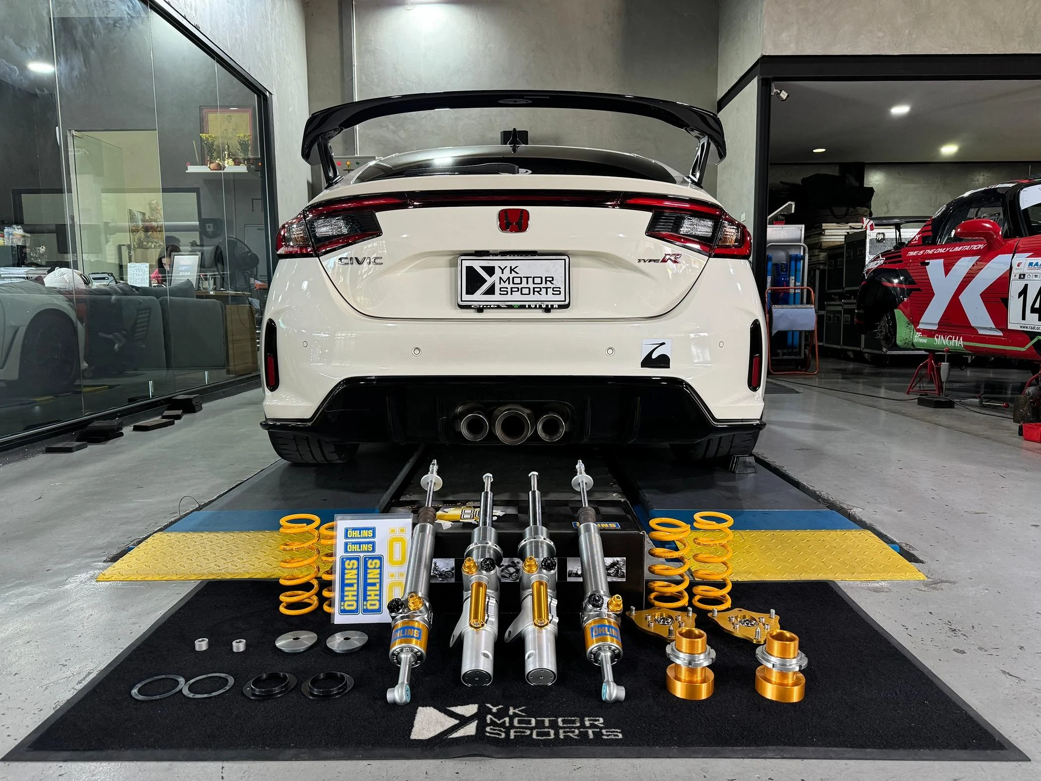

My Öhlins TTX is now complete. The main body was produced in Sweden, and the peripheral components were completed by Öhlins in Asia. With 3-way adjustability, let’s continue to move forward with our passion.

They look beautiful, let me know how you like them. Still deciding on what coilovers to get.
This shock absorber system is being installed on my car.

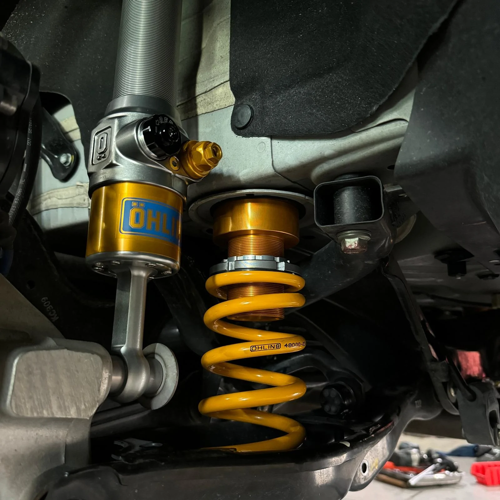

Did you consider the option to use a true coilover for the rear vs the divorced setup?
Yes, I initially asked the team whether it was necessary to use an integrated structure. The team responded that it was not ideal; they recommended a separate structure instead. Although I don't know why, the team has extensive racing experience, so I decided to follow their advice.

Gosh, this is beautiful. How much is it and how long is the lead time to get the TTX ?

The real Ohlins. Beautiful.
Ordinary suspension systems simply cannot compare to remote canisters. Night and day difference. If you know, you know.

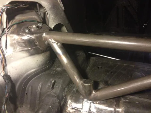

On most cars with a divorced suspension setup, switching to a true coilover rear setup typically requires reinforcing the shock tower. This reinforcement goes beyond just heavy-duty plates; it usually involves actual shock tower welding, often as part of a larger cage piping setup, like this:
