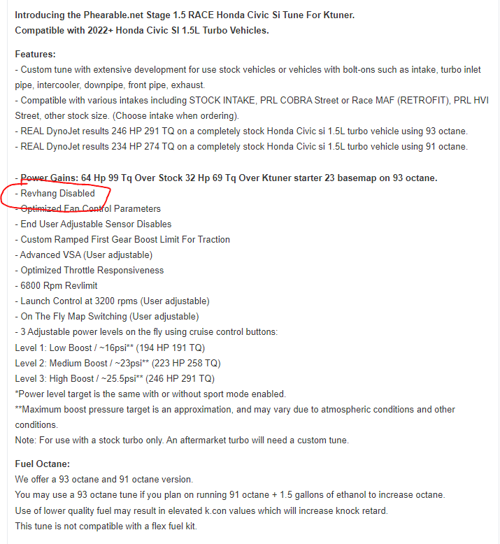

Does anyone knows stock tune PSI?
Ktuner 23 PSI vs Phearable level 2 a big difference?

I think stock supposed to be 16psi in certain conditions, I only ever saw 14 tho, there is a big difference between ktuner 23 and map 3 on phearable, map 2 and ktuner will be a smaller difference but i’d still take phearable over the basemap, the basemaps are specifically made to be on the safer side

How does it disable rev hang? Isnt it a product of heavy flywheel?

On the stock tune watch the rpm when you push the clutch pedal in, it will hold current rpm for 1 second before it begins to drop, that is the artificial software induced rev hang to reduce vehicle emissions, after you put rev hang disable tune on and press clutch in the rpm will begin to drop immediately
The actual speed at which the rpm drops is a mechanical rev hang which can only be changed by changing flywheel/clutch
