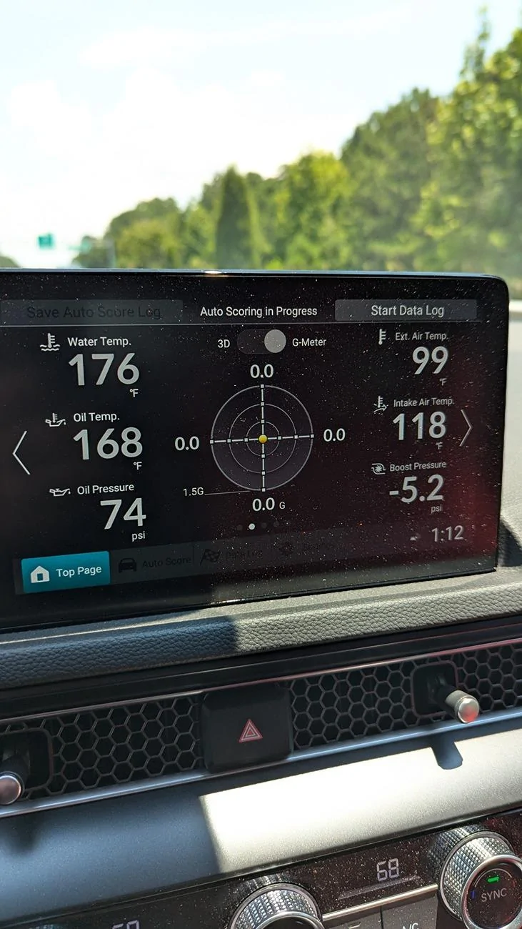

I'm really impressed so far with the performance of the Spoon thermostat. I didn't expect it to have such a big impact on coolant temps. I'm going racing next weekend, and will get a chance to see how it performs under stress with factory coolant!
How are you going racing if you have no tune? ?
11th Gen Honda Civic PointByPatrol #21985 Build Journal! RIP #9243 1720276564866-nu
Also on the thermostat remind me of turning off your Code for that so you don’t get one.

@PointByPatrol is the oil temp a calculation based on coolant temp? If so would you need a different oil temp readout? I thought I remember reading that oil temp displayed wasnt true oil temp?
Yes, the oil temp is calculated, but it uses coolant temps as part of that equation. We'll see what happens!
