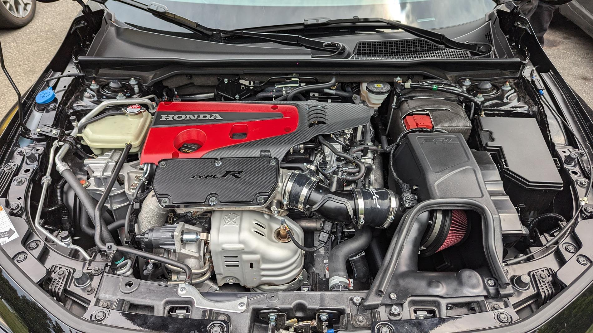

Here's the video guys!
Here's what we've got going on. Please feel free to ask any questions that you may have!
All parts, even the 4piston stuff was provided by @Two Step Performance
4Piston Short Block:
Standard Bore
Wiseco Pistons
4Piston I-beam Rods
ACL Race Bearings
Cooling:
Spoon thermostat
Cylinder Head:
4Piston supplied bare cylinder head
Ferrea valves, valve springs, retainers and locks.
Viton Valve Seals
Stock Porting
Stock Cams
Titanium Turbo and Downpipe Studs
Titanium Valve Cover bolts
Fuel:
XDI 1400 CC Injectors
XDI Fuel Pump
Factory fuel line drilled for higher flow
Turbo:
27Won Kuro (dual ball bearing)
Tune:
Hondata Base Map provided by Jester Tuned
Fluids:
Driven 5w30 Convential Break-In Oil
Factory Coolant
Lots of Moly Lube!
Intake, downpipe, and exhaust are all factory!

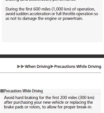

Does our manual say just 4k rpm max until 600 miles? Great job by the way!
Websitesdown
Jun 17, 2024
426
344
Yep. It's stated in the manual!
Thank you! I'm an idiot. I read through a lot of post here actually and everything I had read here just stated to not push it too hard for 600 miles, but no mention of the rpms related to not pushing it too hard at all. I've been babying it so it's okay I'd say 4k to 5k tops but yeah, never trust what you read on the internet is the moral of the story I suppose.

It's not though. Obviously you don't want to shift at 6K RPM, the clutch and brakes need to be broken-in properly, but there isn't a set limit.

No Eventuri this time around?
No. Primarily because I'm shooting for the 425hp mark. There have been dyno tests that show that having the second inlet instead of just the one that meshes with the hood is advantageous for builds over 400 horsepower.
