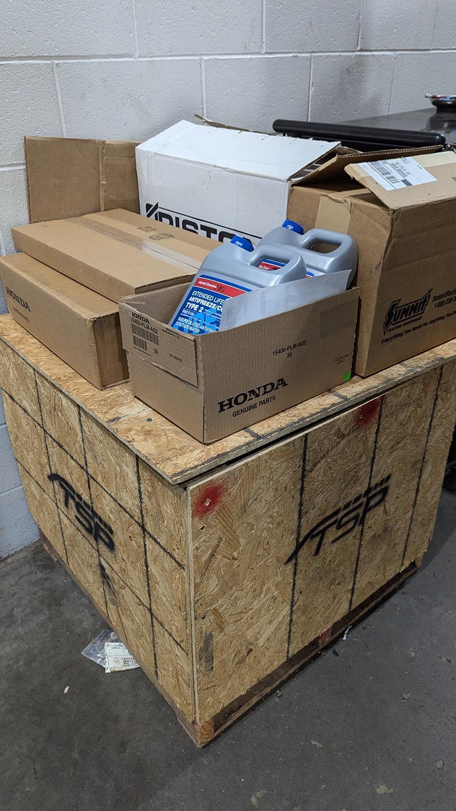

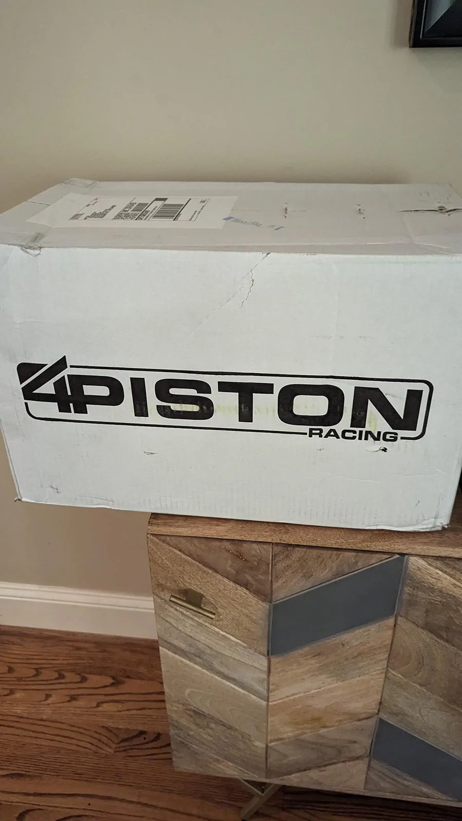

The engine build is tentatively scheduled for this Saturday, provided I can obtain all of the final parts needed for assembly!
Any of you guru's have any recommendations for break-in oil? Something with a high zinc content?
This may be old school, but this has been my process in the past:
First oil fill is with nonsense garbage conventional oil, and is used for the first engine start. After running the engine for a few minutes to burp the coolant you then drain that oil, and replace the filter with a new one, and then fill up with a break-in oil and run on that oil for 500-1000 miles. Then you drain that oil and replace the filter and move on to regular oil.

I may have missed something! Why the new engine?
Nothing wrong with the current one in the car, but I had been amassing these parts, and they were to be installed in the white car before I crashed.
I'm looking to create an extremely reliable 400-425hp pump gas engine. The cylinder head will be capable of 9,000 rpms should an accidental money shift occur, and the bottom end is rated for 850hp, which means I get to bring in the boost sooner without worrying about damage to the rods.
