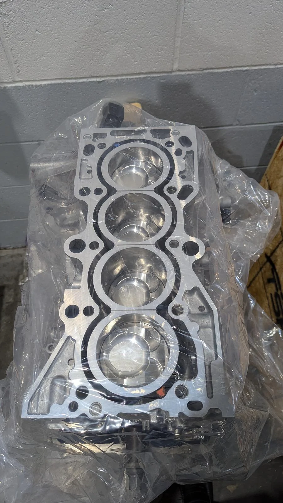

The engine build is tentatively scheduled for this Saturday, provided I can obtain all of the final parts needed for assembly!
Any of you guru's have any recommendations for break-in oil? Something with a high zinc content?
This may be old school, but this has been my process in the past:
First oil fill is with nonsense garbage conventional oil, and is used for the first engine start. After running the engine for a few minutes to burp the coolant you then drain that oil, and replace the filter with a new one, and then fill up with a break-in oil and run on that oil for 500-1000 miles. Then you drain that oil and replace the filter and move on to regular oil.

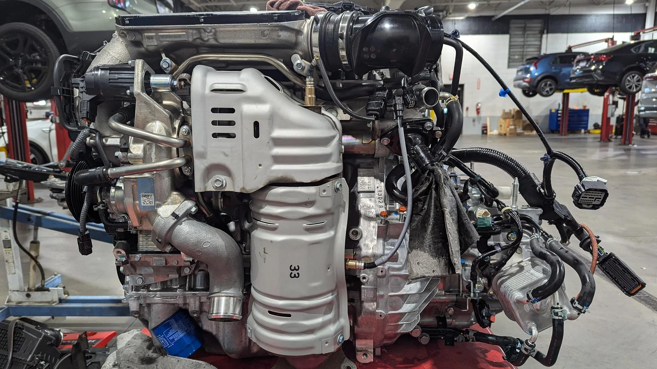

What’s going in today?
2,118
3,551
You are really pushing this platform forward. Thanks for sharing your journey. We are all benefitting from the good, bad, and ugly.
Maybe I missed it, but can you share the specs of this motor?
