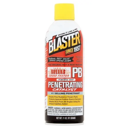

Got my downpipe in the mail and tried installing today and ended up breaking off one of the turbo studs any advice? Should have taken it to a shop in the first place.

You should try spraying this stuff on the studs holding the down pipe on and let it sit over night.. then spray it again right before you take the hardware off and it should help out with getting the hardware off without breaking another one:thumbsup:

At least I wasn't the only one to bust one of the bolts. Btw had to pull the turbo off and drill the F***ER out and re tape
Man you really snapped a stud off then!!

How hard was it removing the turbo? Im taking it to a shop tomorrow hope they can drill it with out taking it out.
