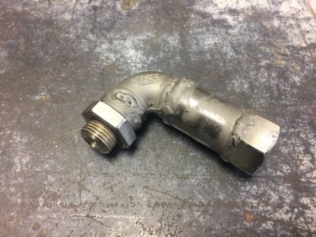

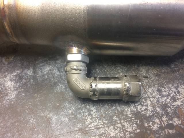

Saved some $ by making my own defouler with spart parts at the shop (and doing some lathe work, ish stainless is pain to work with).
I need to sand it to make it more clean and check if there is no leak on my welding.
