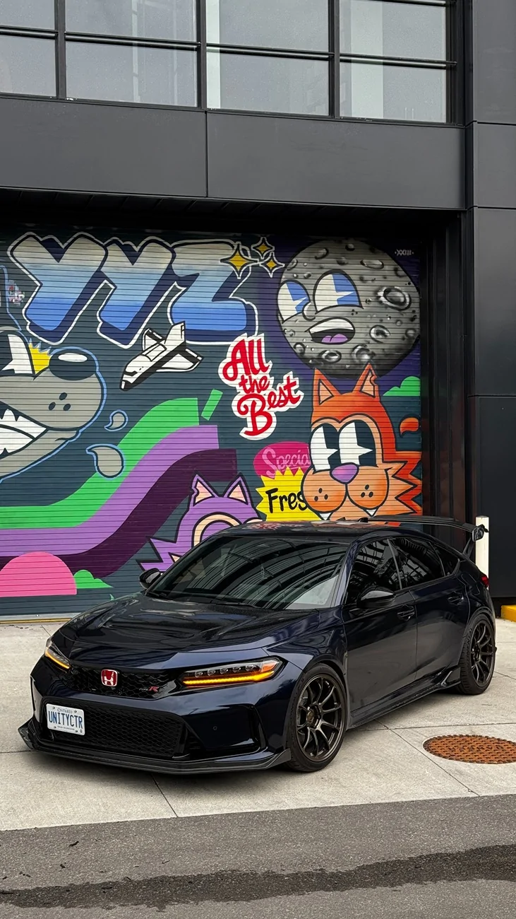

In all honesty though, the car is still as mild as it can be given all the mods. I daily drive it and the Mrs. doesn't hate it - in fact she's encouraged that we take it out a few times recently. We went into downtown Toronto on Sunday to check out a car show. Downtown is notorious for bad roads, so I was worried about the lip and how choppy the ride could be - glad to report that the whole drive in was pleasant, and I cruised around the city streets in gears 1-2 with relative ease. Dropped her off to see a friend, then had a little daddy-daughter date with my 1-year-old, took some shots of the car, and just drove around admiring the graffiti, shops, and downtown vibe :)
