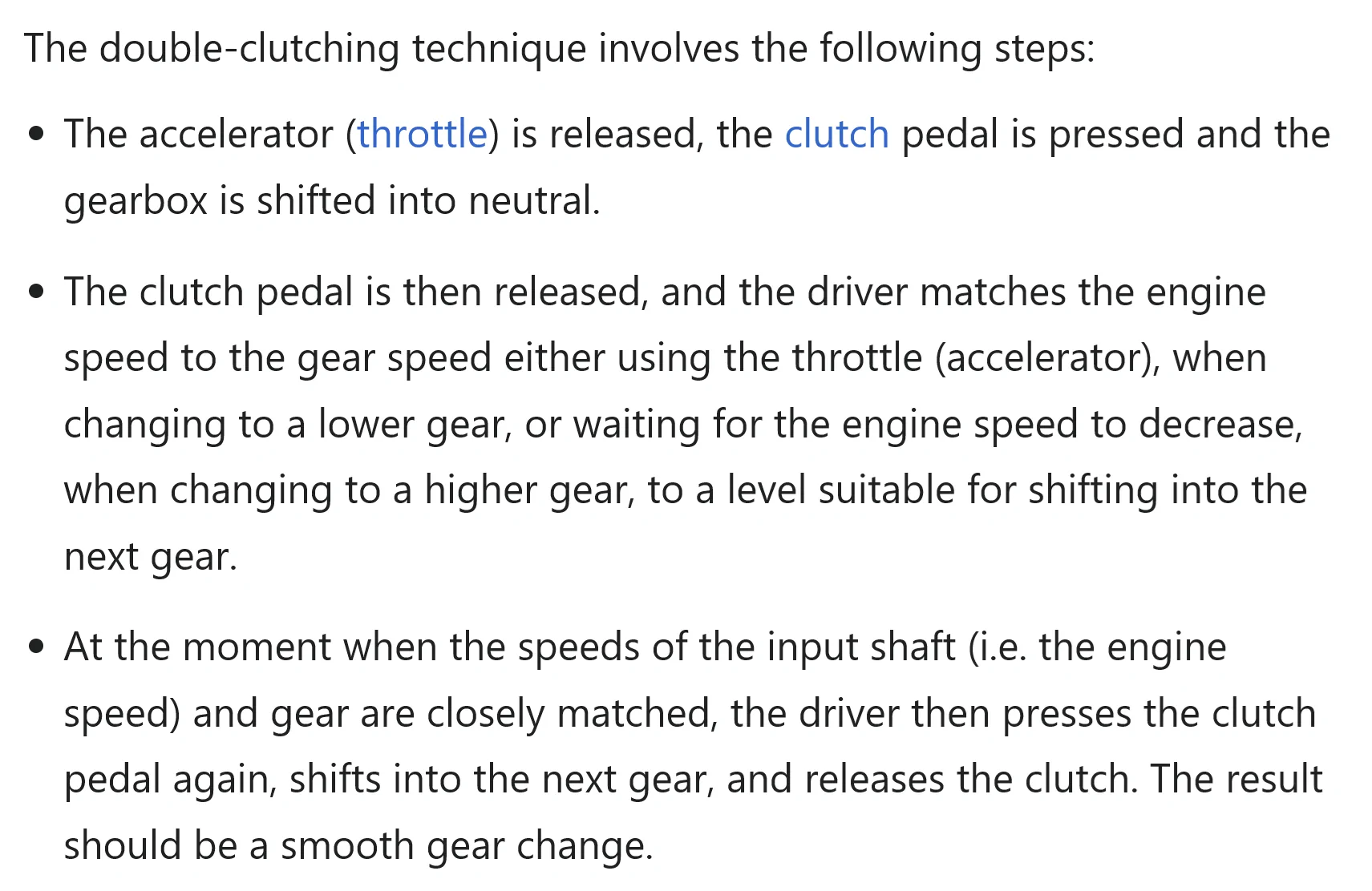

All I see is one cat who doesn’t know what double clutching is. Cuz when you’re in neutral. And clutch in. And give it gas to rev match into second gear while you’re moving. That’s literally a freaking double clutch.
That's literally not a double-clutch. That's a single clutch.
If you did that on an unsynchronized transmission, you would grind the hell out of that gear.
Perhaps you should edit Wikipedia and let the entire rest of the world know that they've been double-clutching wrong:
https://en.wikipedia.org/wiki/Double-clutching_(technique)

Alright I think this is getting derailed by terminology.
What folks are basically arguing is: “rev matching takes load off the synchro” and that blipping in neutral is basically double clutching.
Correction:
  • Blipping/rev matching with the clutch IN doesn’t reduce synchro work — the engine is disconnected from the trans input shaft, so you’re only changing engine RPM.
  • Double clutching can reduce synchro work because you blip in neutral with the clutch OUT, which actually spins the input shaft closer to target before selecting the gear.
Rev match = smoother clutch/drivetrain engagement.
Double clutch = less work for synchros.
