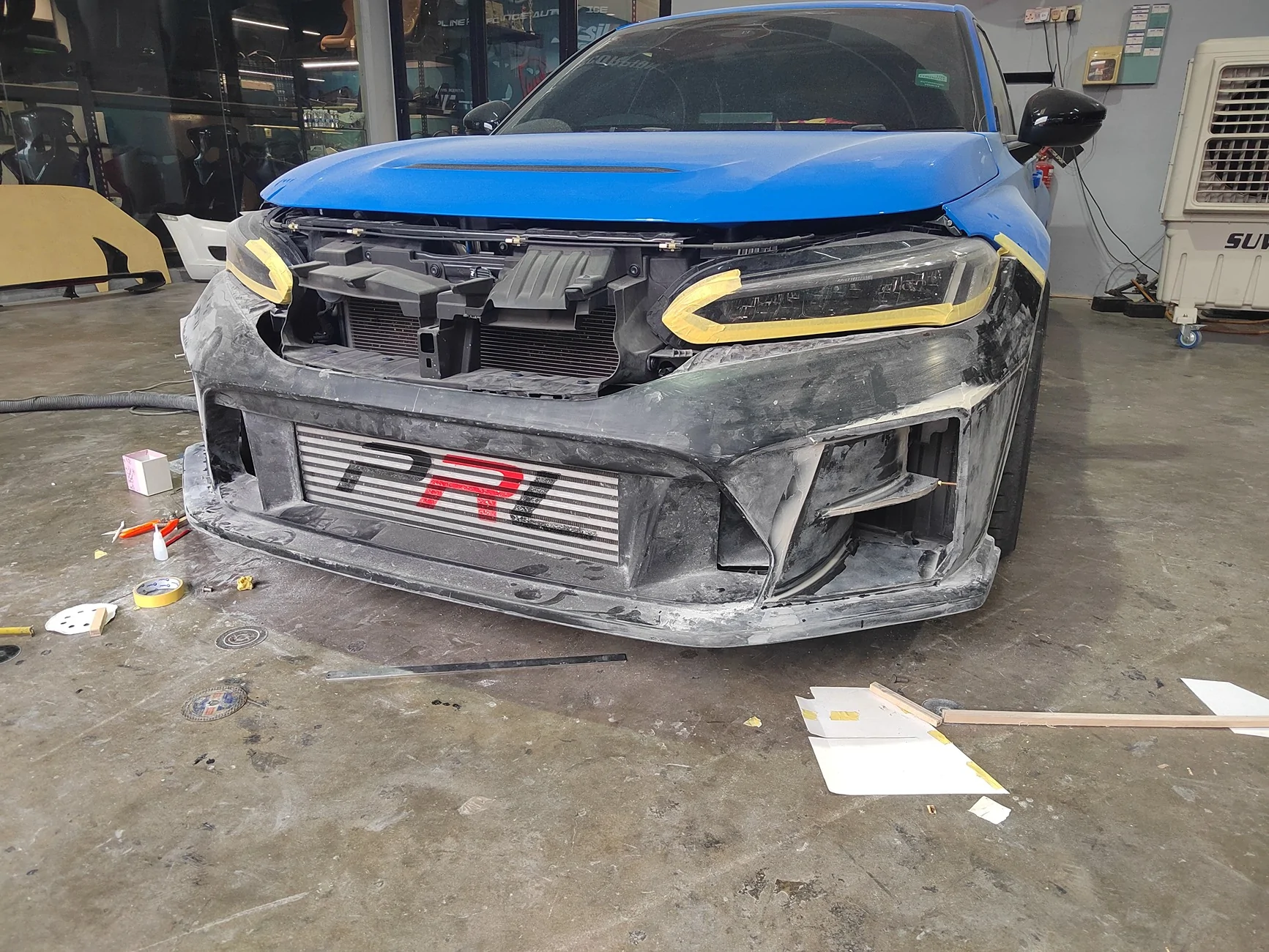

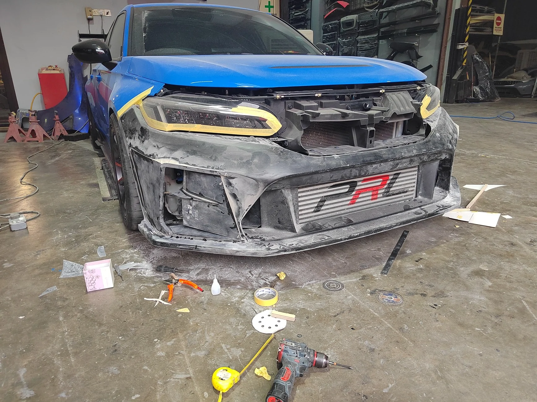

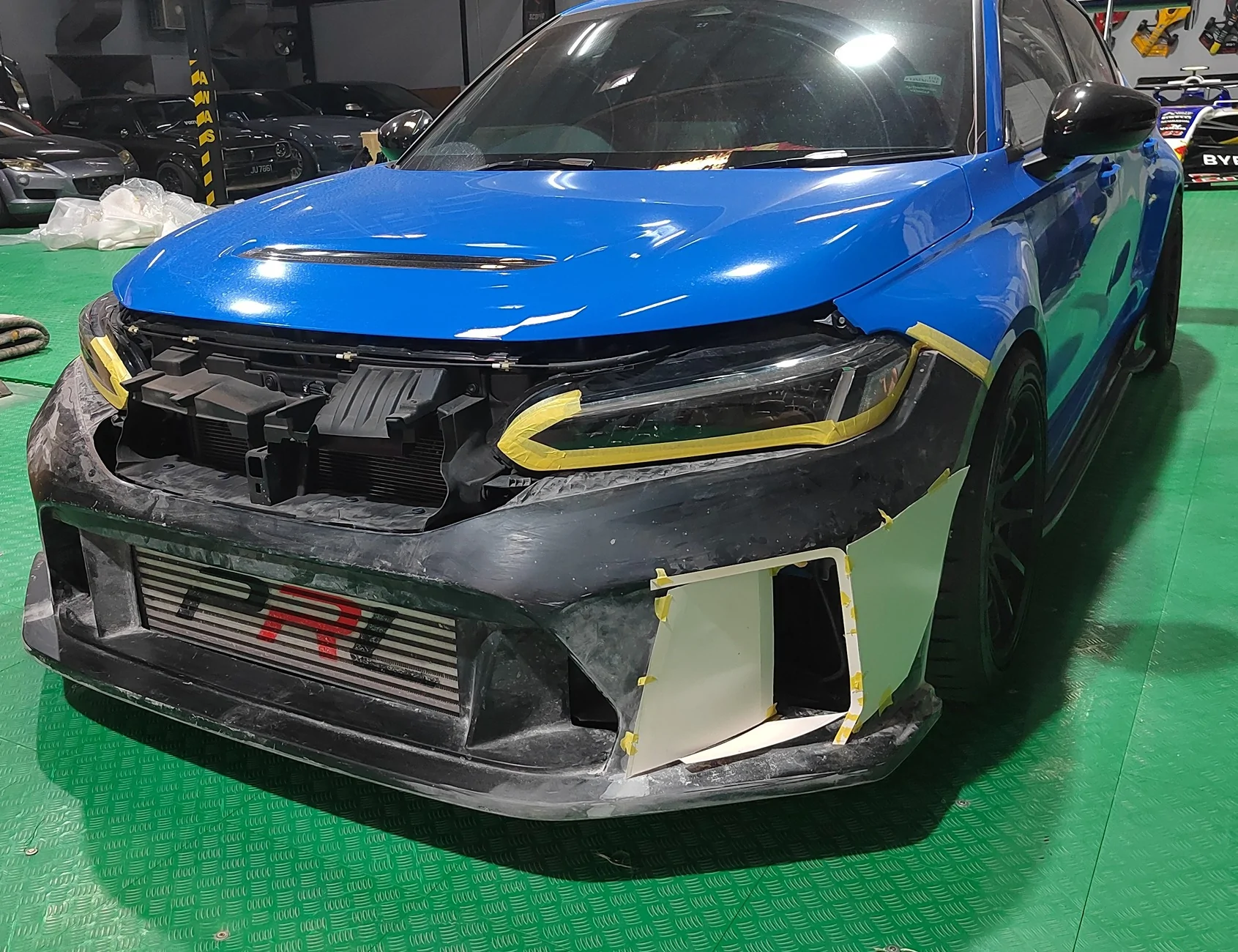

Update on my prototype SBX Modular "Spork" front bumper. Going to a modular design for the air ducts so people can choose different options such as canards, fog lights, open duct, different styles etc. This is the progress of the 1 air duct... next is the other side then the lip/splitter then the winglets etc.....I plan on making an intake to go direct to the duct also if i can figure out weather proofng...while im testing this one they will be playing around with the inserts and fog light options etc to get the best fit

Have you thought of a duct to be compatible with something like the acuity side intake that goes near the passenger side light?
Yes i made a post the other day on my facebook group.....im working on figuring out weather protection the best way.....id like to make my own intake tbh but maybe I can collab with a company to do it. that shit would gte fresh fresh air lol

That right side looks better than the spoon looking side too btw, being able to see the wheels is sick lol
see its my design but i thought the same thing LOL but of course ill like my own haha should be good concept should have it done soon.The modudular part is whats fun. I can make anything :)

Many changes left to do on it like the winglets and extending the splitterout a bit......this is just to test fitment etc.....whileim doing that testing they willbe working onthe modular stuff

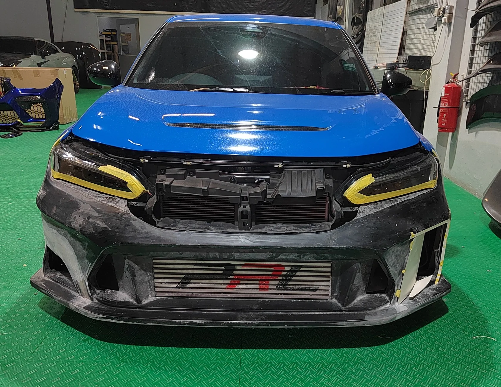

Small update on the SBX Bumper
It’s finally starting to take shape starting with the air ducts. We got the general duct appearance roughed in on the driver side and they’re now working on the passenger side.
After that, we’ll start filling in and smoothing out the overall shape and then move onto the splitter/lip, which will be extended a little with a small winglet.
Main goal has always been direct flow to the oil coolerthat willbe priority. Everything elsewill be build around it including fog lights above it
Still a lot more to come on it with a few suprises down the road
Stand by

IMHO, I think the new side ducts need to be pulled more towards the intercooler area to better visually integrate with the OEM brake duct intakes. In the current configuration, it looks like the OEM brake duct intakes take priority where the new ducts were added as a side job.

bumper is done thats it! there was no change to the brake ducts
The side ducts aren’t intended for the intercooler and the OEM brake ducts aren’t being changed. The brake duct location stays exactly where Honda designed it. These are separate functional openings FOR OIL COOLER thats the main concept, and the bumper design is already set. Thatsall I care about is flow to my oil cooler not some small duct like I have nowto itThe side ducts are being refined now, but they’re not being moved into the brake duct/intercooler area that would disconnect my main focus of oil coolers. the ducts are exactly where the oil coolers sit. some sit high in the second duct like HKS and some sit lower in the bottom duct. Thats all i care about is theoil coolers. Fog lightsnext
