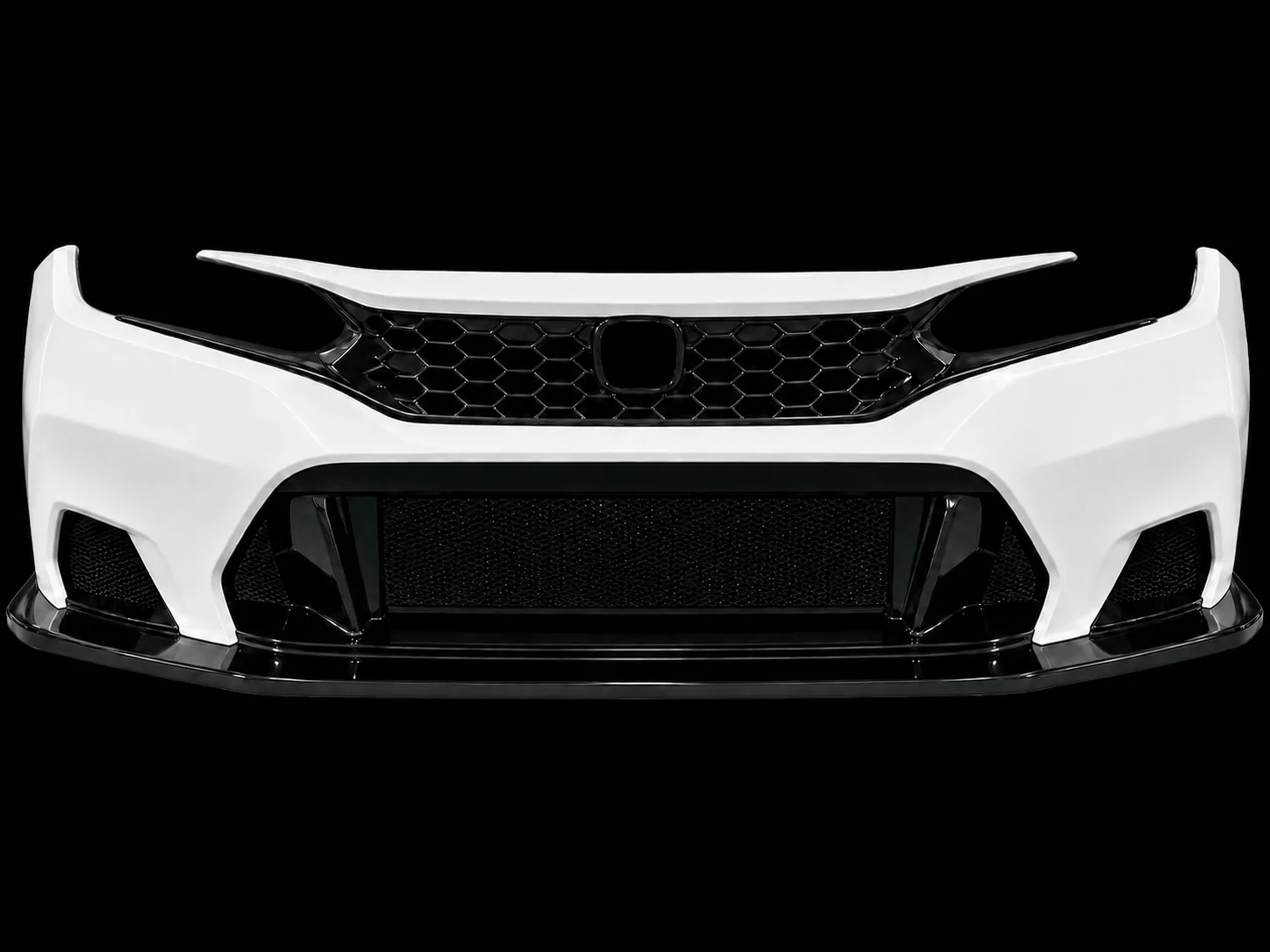

trying to figure out a way to make it optional. ths is my mockup

That actually looks pretty good there!
sat here for 5 hours trying to fgure out a good spot. not many other options that wont be like cut into the bumper which looks terrible. I am trying to see if i can make a bracket thats optional to add them

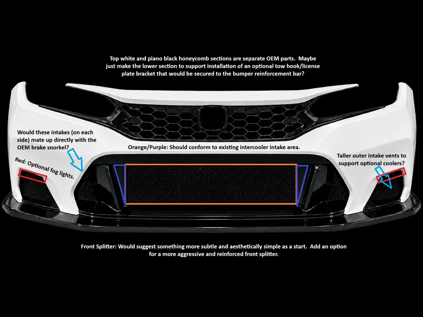

Looks like a great start. Here is a PIC with my suggestions to consider:
If you have not already done so, maybe reach out to @siwelnosaj as well for thoughts/suggestions?
i think "strip style" fog lights would look better than round ones.. i was thinking the lower portion of where you have just because you may be able to get a little more light out of it (than the top portion) and it may be easier to design :dunno:
Second to this, I think having an aggressive lip built into the bumper potentially takes away from future modifications. Ideally I think you should keep the actual physical dimensions of the bumper as close to the stock one as possible since it would open up lip compatibility to other brands.
Also this is my own personal taste, but if you have the air curtains as ducts, maybe you should take a page out of bmws grille design and make it less "meshy". If people want a mesh, you could option one with a mesh closer to stock.
Totally agree with fog light placement here. I always feel like fog lights should always be on the same vertical plane as the low beams. Like the FK8, MDX, first gen TLX etc
