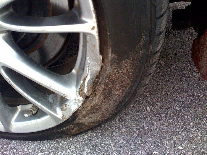

I am having trouble understanding what "the lip on of the wheel has a tendency to land on the wheel" means.
That was a typo. It should be "tendency to land on the ground". The type of damage looks almost like the picture above.

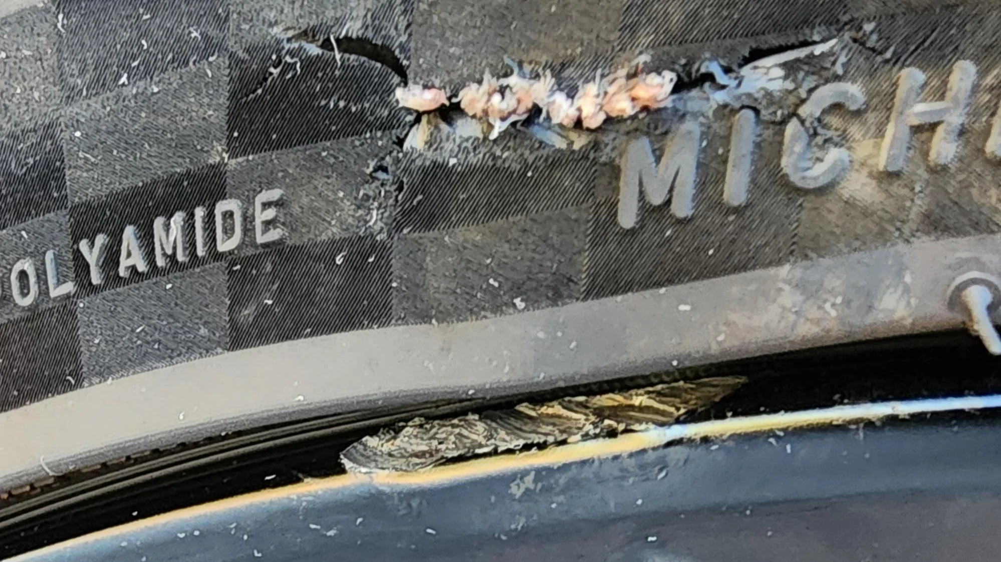

What I'm considering is the the following, when this wheel #2 got nicked on the lip from the pothole and a bubbled tire at a different spot:
1) Buy another DT1 Pilot Sport 4S (OE Tire) and refinish the wheel
2) Buy a full set of Bridgestone Potenza Sport that is the same OE size because they are on closeout from TireRack (just a not fresh off-the-line batch they are trying to sell and very cheap). I am hoping its stiffer sidewall will help with curbing the lip of the wheel during potholes

Can you avoid these roads altogether? I don't think it's worth it to purchase a full set of tires just for an experiment in sidewall stiffness.

Unless you move to 200TW tires I don't think the sidewall will be that much stiffer. If your wheel is falling far enough into the pothole to damage the wheel I don't think a stiffer sidewall is going to help at all. I wouldn't call the stock PS4S tires soft.
If you downsize to 18" wheels I highly recommend you go to a stiffer sidewall 200TW tire otherwise you'll probably notice a decrease in handling and steering response.

A stiffer sidewall is not the solution for your problem, considering your current tire has a stiff sidwall....
You need more sidewall and a bit more tire protrusion at the lip, as opposed to a stretched setup.

If you want to avoid this issue, just get all season tires, not performance low profile tires. With regular all season tires you will have way more rubber so less damage will happen to your rim. That being said, would suck driving this car with plain old all season tires.

I agree the only solution to potholes is more sidewall, not stiffer sidewalls. Stiffer is maybe if your tire was rolling over on sweepers, but you might have more options with wider section for less stretch or a 9" wheel that still clears the calipers.
