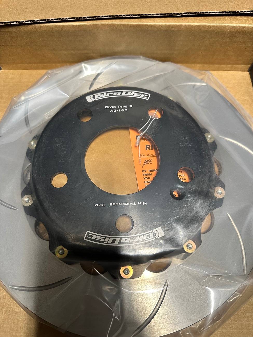

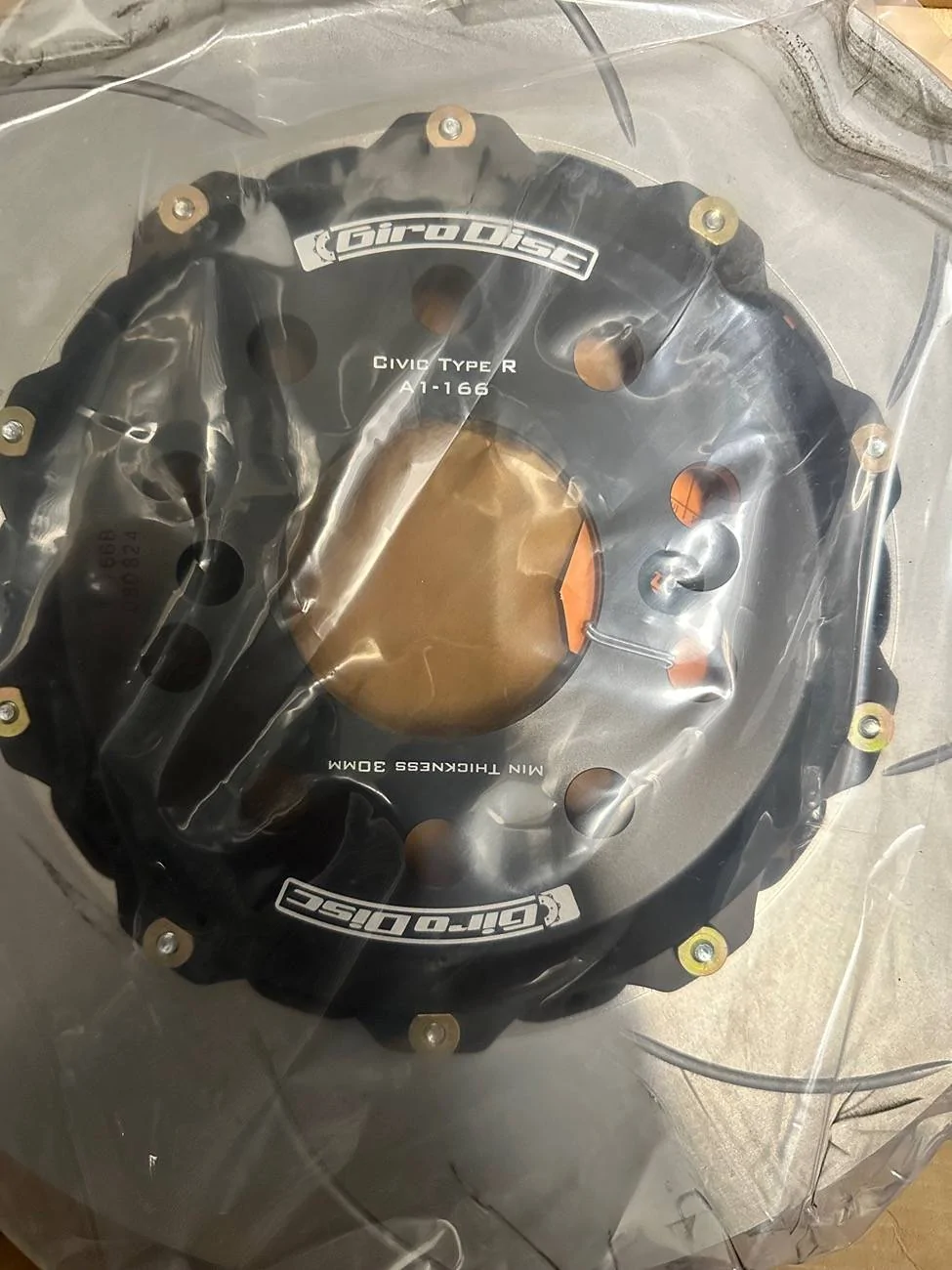

Do you know of measurement of when its time to replace the OE or the Gridisodic rotors? I bought a rotor measurement tool so I can start measuring mine

I do not know the min thickness for the OE Rotors. I believe the Girodisc Min thickness is 30MM, but you'd have to double check what the rotor hat says -- it's printed on it.
