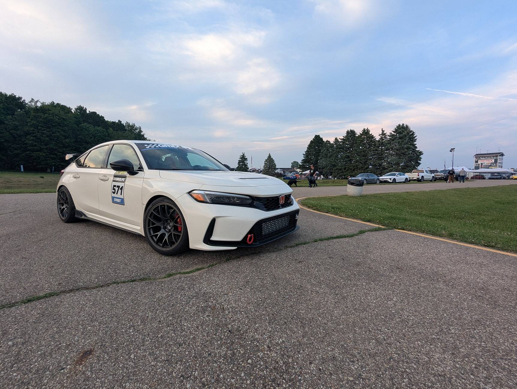

(Hopefully) ready to go at Gingerman! We had practice today and I'm finally starting to get some consistent predictable rotation - I've changed to 16kg/mm rear springs (up from 12kg/mm), and settled on ~1/8" total toe out in the rear for the time being (changed from 1/16" toe-in which was the factory setting), with +10psi in the rear and the 285/255 reverse stagger. Looking forward to the official timed sessions over the next 3 days!

svvitch
Matt
Jul 6, 2023
1,536
1,299
Michigan
Gingerman is fun and a pretty safe track to test extra rotation ? good luck this weekend ?

Makes me cringe to think about cresting turn 10 at VIR with rear toe-out….but most of my setup experience has been with RWD.
