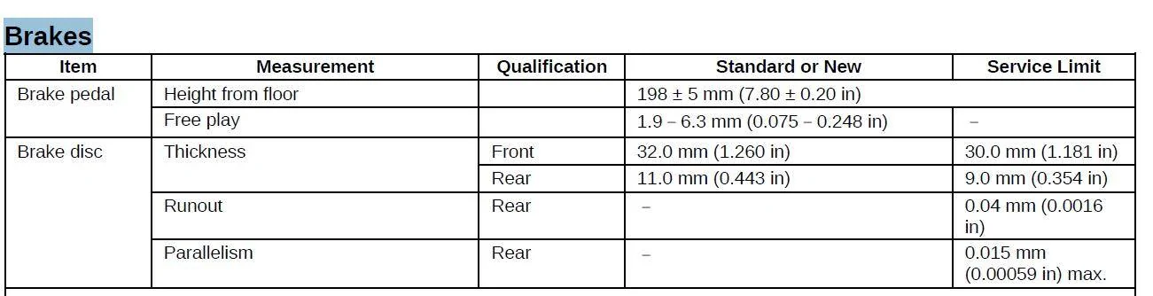

There was an online service manual posted at some point let me find the link

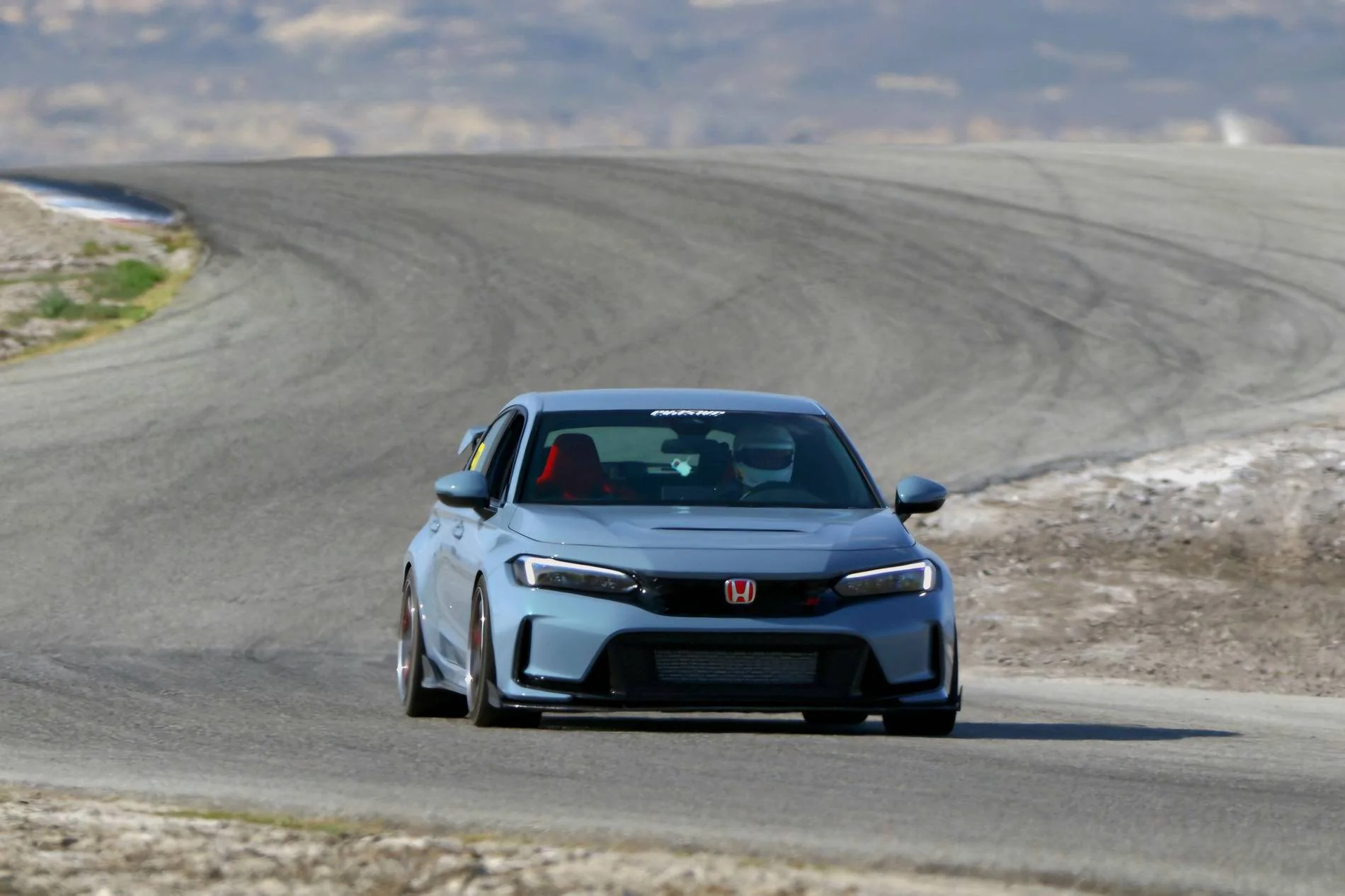

Curious if anyone can share their camber settings for a modded car? When I took my car stock, it was quite enjoyable and had a pretty neutral balance that made it rotate well.
But after doing Swift springs, rv6 rear sway bar (middle setting), evs tuning front offset balljoints (middle setting), strut pins pulled, and 18x10 with endurance 200tw's - the car balance is god awful now and SOOOO understeery... I could have adjusted the rear bar to the stiffer setting but I was lazy and just didn't think any change I could do at the track would work enough. I was honestly expecting the car to be much looser considering the added front camber and stiff rear bar, but the opposite happened... Maybe due to increased rear camber from loweing?
So the front camber is at around -2.7 and the rear is at natural -2.2 after lowering. I was considering adding more front neg and/or taking rear camber out but I also need to decide whether to balance going for an aggressive track alignment on a mostly street driven car... It's my first McPherson strut car, so I'm just not experienced with how mich camber these things need in the front to promote even tire usage and more grip...
11th Gen Honda Civic *The FL5 Track Junkie Thread* Red - Session 2 (Phil Hill) - CPRP7203_Mar2925_846AM_CaliPhoto
surprised that's all the camber you got in the middle setting with springs and ball joint.
I have it on max setting, and it was over -4, and dialed it down to -3.6 to -3.7 since it's my daily.
I was hoping middle setting would be around -3.2
There definitely is a point where too much isn't good, not sure what that is on this car.
and you were on +R, fully off, or pedal dance in some other mode?
I would also recommend to try out the stiffest setting on the rear bar.
Your camber seems to be good for Daily/Track use.
What are you toe settings and what tire pressures were you running front and back when the tires were hot?
Tire pressures were around ~37psi hot, starting at ~29psi cold. Toe, according tomy alignment printout is 0.03° total toe front and 0.15° rear
This is why I think I need more front neg camber; it destroyed the outside edge by the sidewall and the understeer just got worse after the first session.
Yeah I was hoping to get around -3, but ai guess it landed a little short. So I may have to put it on the max setting and then correct/fine tune with the strut tops to try and be mid 3's also...
I use Individual with pedal dance
