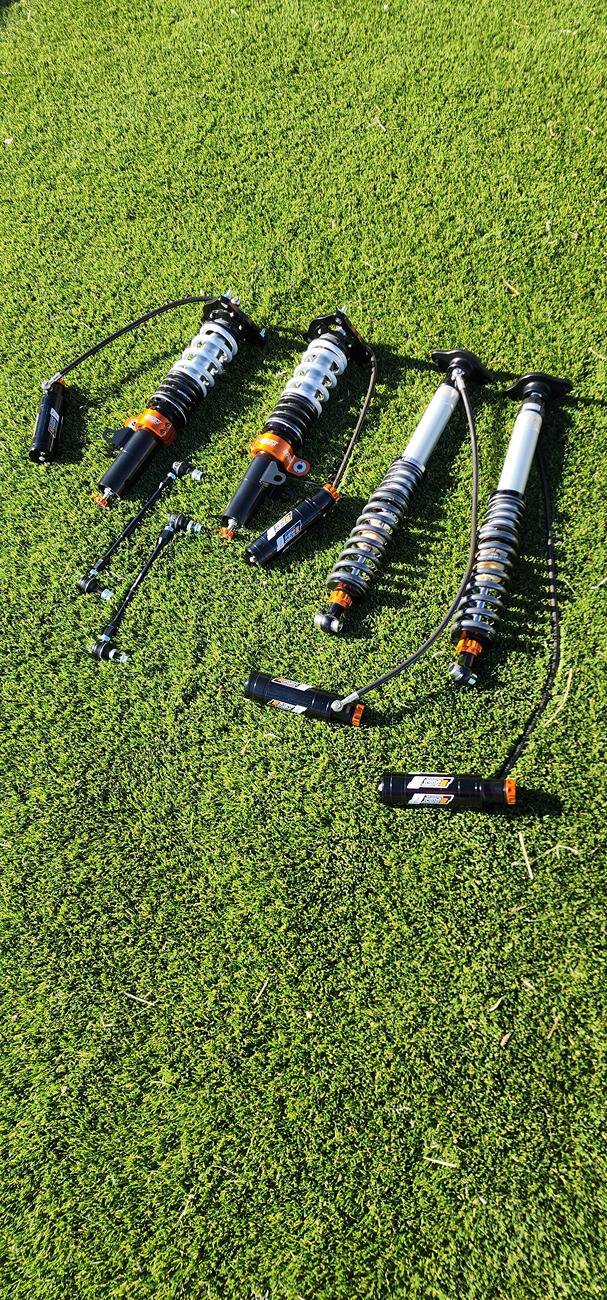

The AST/Moton that I bought are true coilover, so not sure how that's going to work, but they said A OK with OEM mounts.

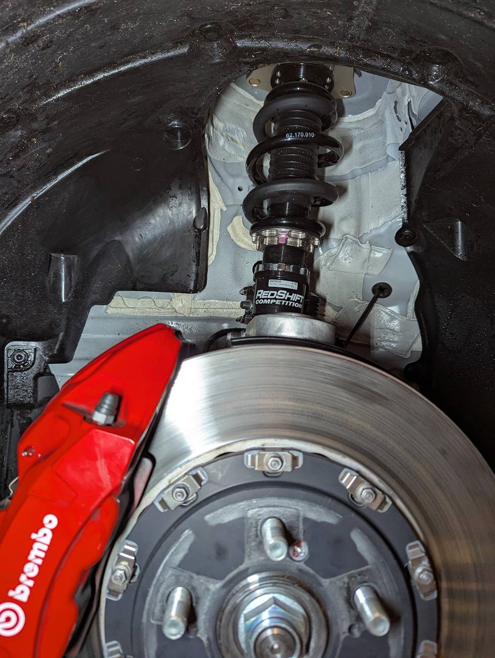

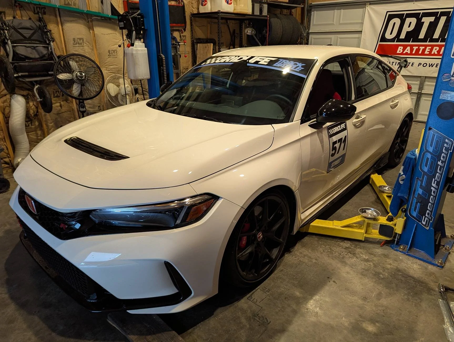

Finished up the fronts today, did a rough ride height set (since nothing is settled yet), quick alignment, and drove it 5mi, so I guess I'm good? I hate feeling rushed like this but it's just how it worked out. The fronts seemed more painful this time vs. when I did the springs - I was really fighting with getting the struts far enough out of the knuckle to pop them out - not sure why. Thankfully getting the Redshifts in was easy since they are quite a bit shorter.
I'll probably do a re-check on heights and alignments at CMP.

just make sure to check your axles out the trans and not leaking, especially the pass side
Yep, I'll check that, thanks! I did have the driver's side pop out but that seemed easy enough to pop back in - didn't seem like there was much of a c-clip or anything. I actually had more of an issue with the driver's side anyway for whatever reason.
Btw, with these coils Rex-spec wheels are extremely close to the ears on the strut at full lock, so just FYI on that. They clear but with basically 0 margin (not that you'd be at full lock often). I did have to move the wheel weights outboard though because they definitely would have gotten knocked off.
