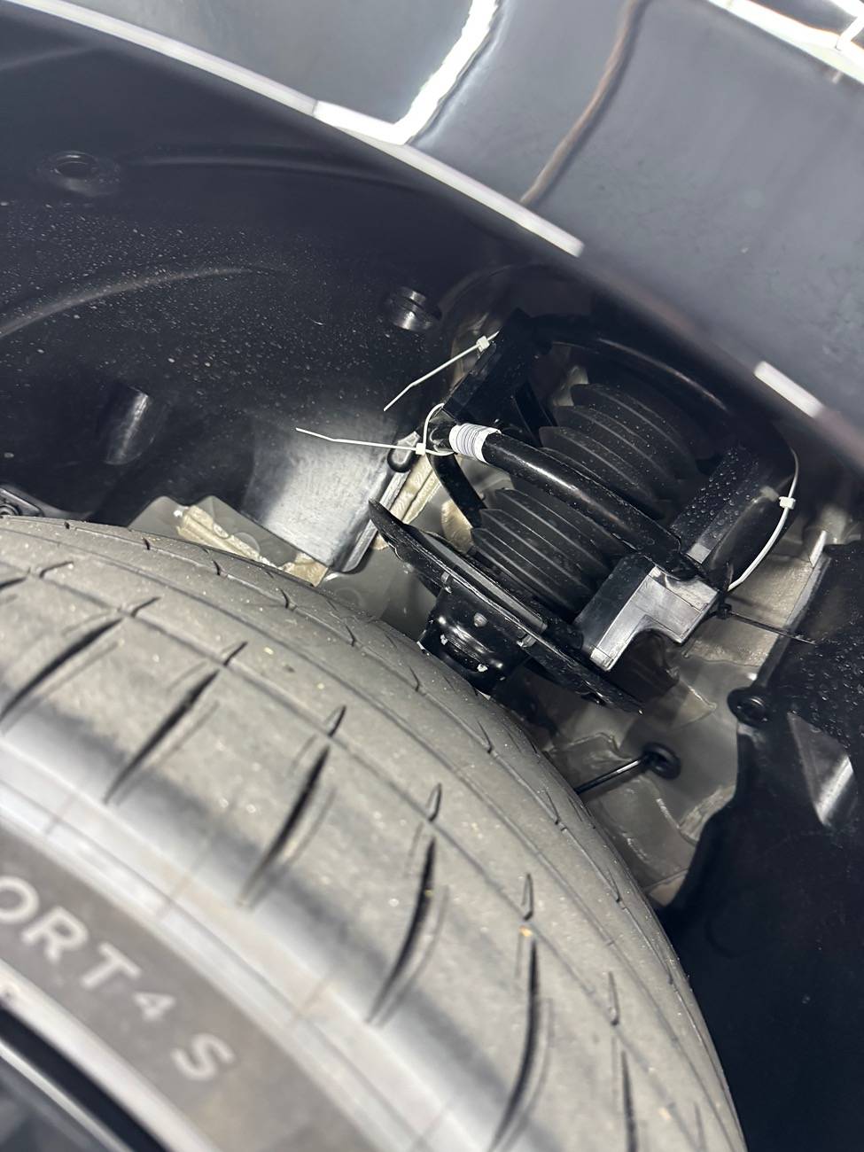

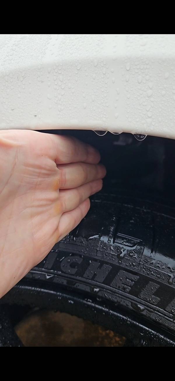

Thanks for sharing this!
I only just got mine 12 days ago from the dealer and it has about 300 miles on the clock now.
I kept thinking my car looked suspiciously higher compared to all those photos I see online.
Sure enough, I checked my front springs after reading this post and found the blocks were still strapped on. :(
I contacted the dealer and they had them removed immediately and paid for a full tank as a good will gesture.
I haven't driven the car hard at all since I got it.
Could any damage have been caused?

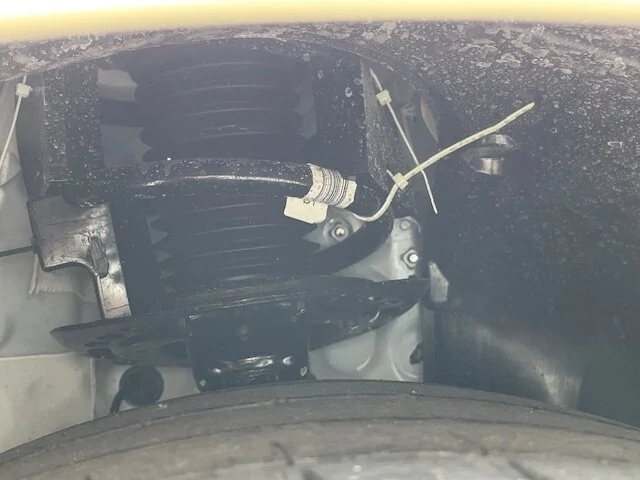

Received mine from MI shipped to CA. Drove for 50 miles without knowing the spring blocks were in and immediately thought I needed to buy the ITS damper module ASAP.
Posted a delivery picture on FB and a member immediately pointed out the height in the front was high and indeed spring blocks were still there and tires were at 51psi ?‍♂. Now comfort mode feels great!

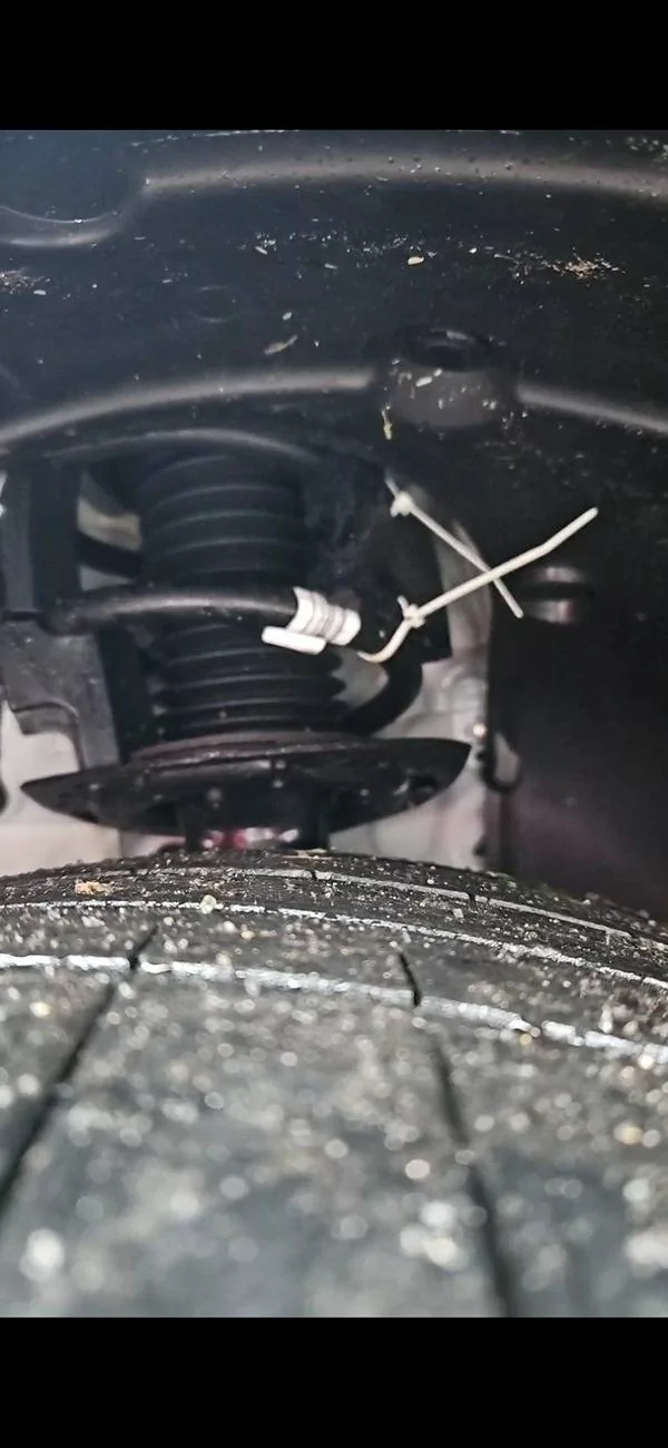

The dealer did not remove this on my car either. I'm glad I read this thread before I picked up the car. Saved me a trip back and forth.
