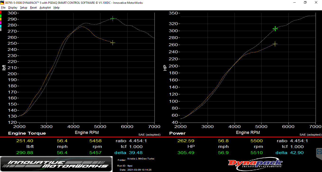

"VTEC" has been used for a bunch of reasons over the years by Honda for numerous reasons; not all of them for power. The moniker is nothing more than buzzword to describe a system that allows for multiple lift/duration profiles (whether or not those profiles are to change the shape of a torque curve or to simply create a swirl in the combustion chamber for fuel economy purposes is completely dependent on which engine we're talking about).
As far as your comment goes, we need not look any further than the previous generation of engines Honda used on a large number of vehicles - the K24Z. The K24Z lacks VTEC on the exhaust side entirely, yet has it on the intake. The exhaust outlet is a very similar configuration to the K20C/L15 engines, with an integrated "manifold", also. This engine is very popular to turbocharge in the aftermarket (I've tuned countless, personally), and I can tell you with 10000% certainty that without switching on the "high cam" lobes on the intake, it's completely useless as engine speed and boost pressure climb.
Here's a quick example of a turbocharged K24Z. The orange line is a run without high cam engagement on the intake, and the gray line is with VTEC engaged on the intake cam. The test stops earlier on the orange line because torque is already falling hard by 5,000rpm, but you can see that it carries much better with the high cam engaged. There's a 40wtq delta @ 5,550rpm from the difference in cam profile in this instance. The spread gets larger and larger as boost pressure goes up, also, as the camshaft's profile is literally a restriction to total flow through the engine.
11th Gen Honda Civic VTEC.. is this for real? IntakeVTEC
There is no downside to having "VTEC" functionality if a broad torque curve is what you're after.
I hope this helps shed some light on why making broad generalizations like "VTEC on the intake cam with a turbo is unnecessary" is bullshit.

It's not, though. Again, "VTEC" is never used at wide open throttle on the L15's with it. Accord, Civic (non-Si), and Civic Si. None of these engines are using VTEC at high load, ever. The "engage" RPM is literally 32,767rpm in the ECU for these models.
They're likely using it in this case for something similar to "VTEC"s purpose on the R18 and K20A3 engines of the past.
