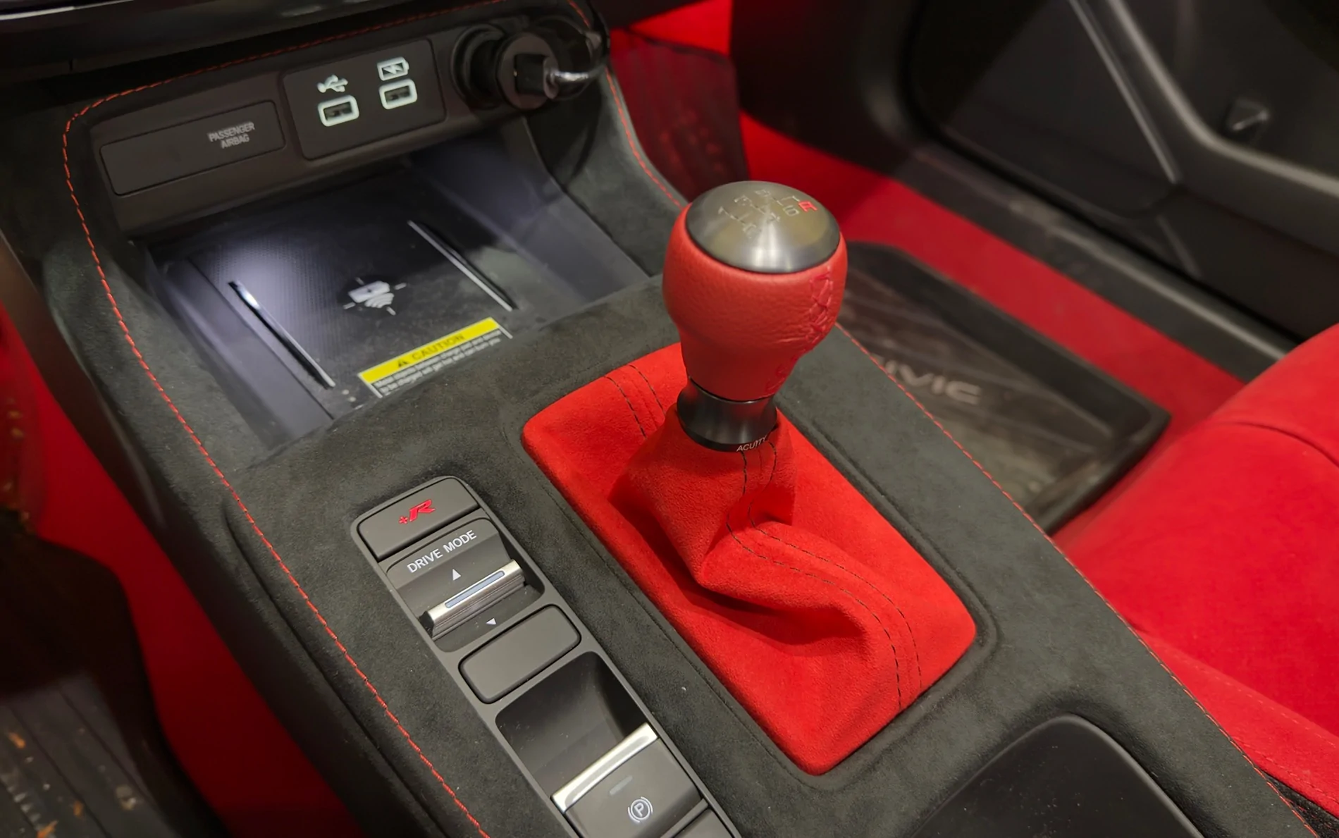

Replaced the center console/shift boot, side, and center console trims with some Alcantara from Overland, along with a shift boot collar from Acuity.

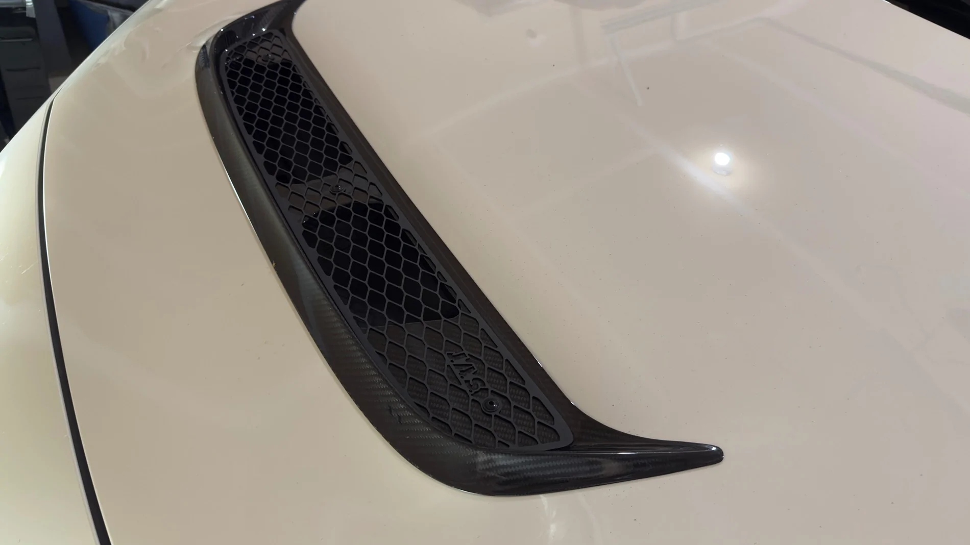

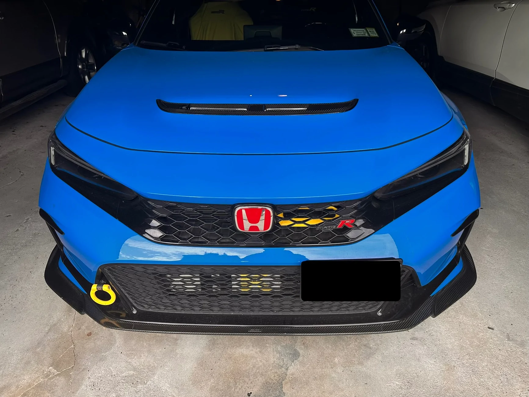

Also received and installed my FL5 mustache from JAS. This is my first carbon part and the weight difference from the OE hood vent is significant.
Welcome to the Mustache family my friend.

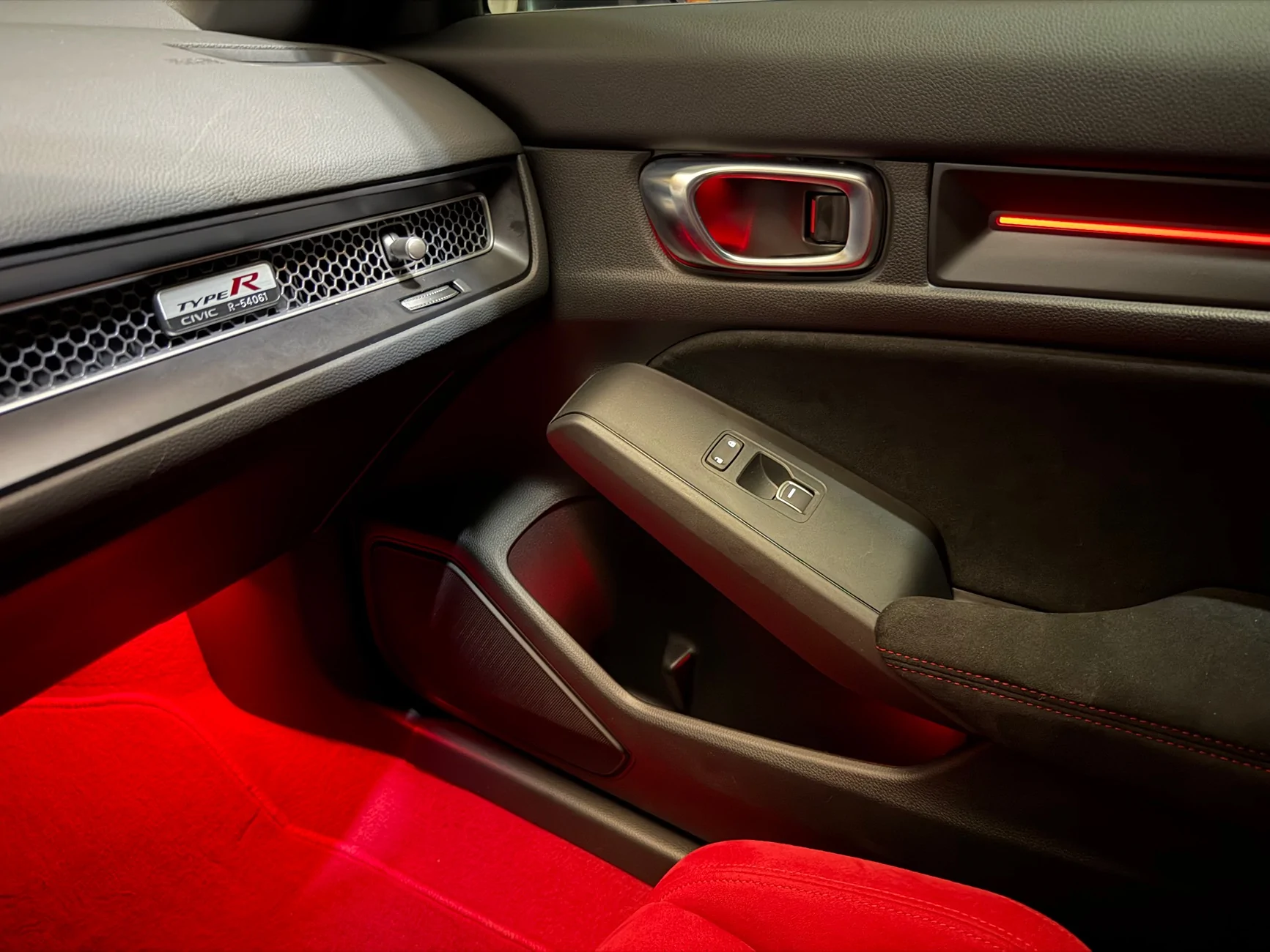

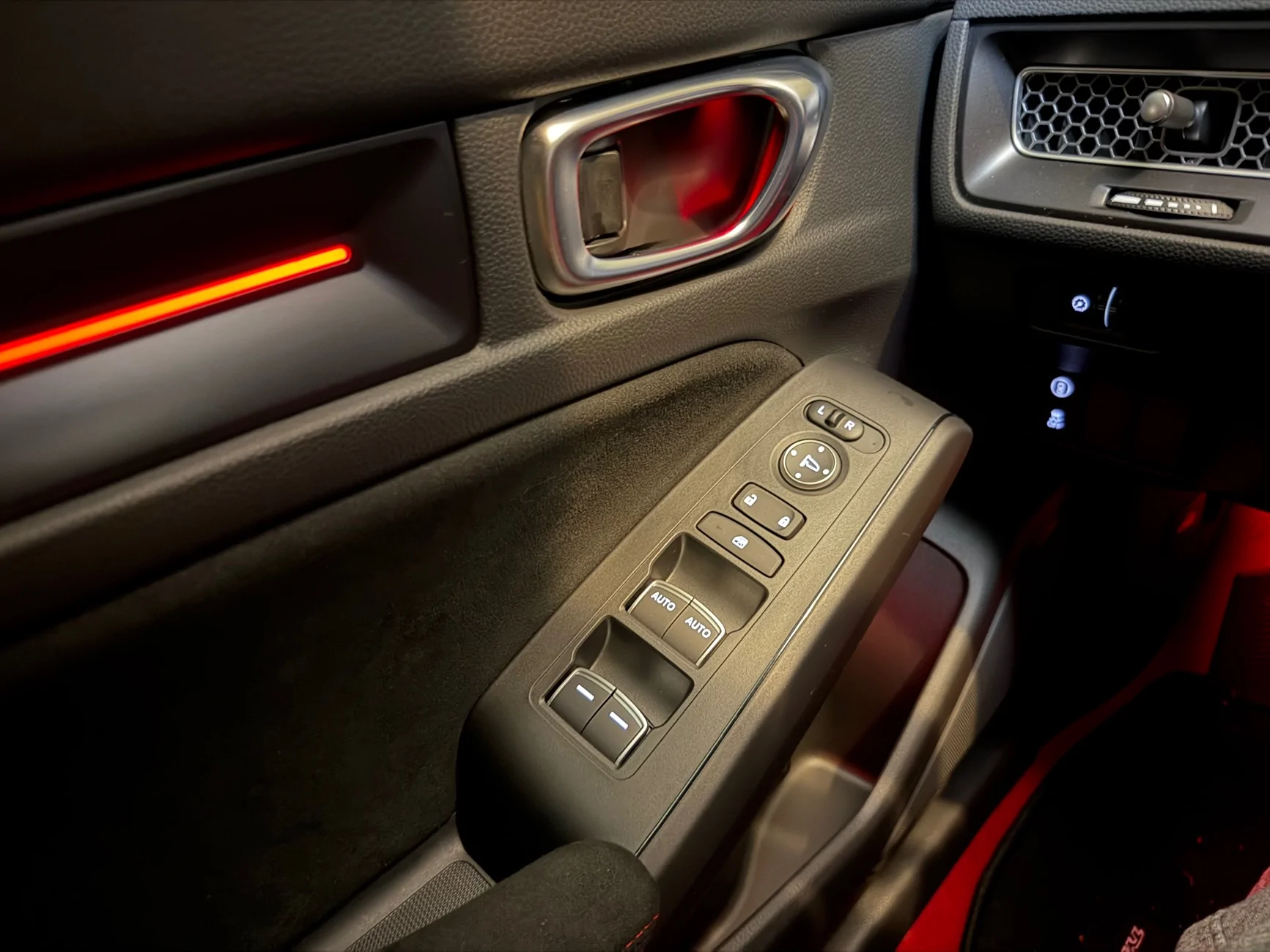

Just installed my illuminated door handle and pocket lights. Ordered these from Black Hawk Japan a little while back , they were on a slight back order. I got them this past Thursday so I had to get em in this weekend! Part number for reference 08E20-T43-002B

If you’re in the US, keep in mind the 15% tariff + brokerage fee.
I reached out to them around the time the parts were released and haven't revisited it. How would you characterize the quality of the parts? How was the packaging when received? Also, what did you pay in tariff fees relative to your order total? Any regrets and/or what would you different if you had another crack at it?

Part is solid. There could be something to be said about fitment on the passenger side where it tapers off, but only if you go looking for it. Install was easy (put a blanket over the engine bay just in case you drop a nut).
It was shipped securely. Through FedEx I paid $220 for tariff + brokerage. Customs was a pain, having never had to fill out the forms before.
No regrets. Looks great and was a bit cheaper than the Spoon alternative for a carbon hood vent.
No regrets on my end! Parts came very well packaged and fitment was spot on for me. I did not use the mesh grill on the hood vent though.

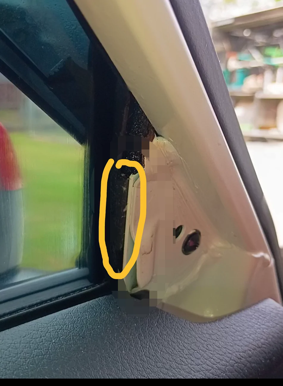

to the owners who have that annoying tinny sounding window rattle when the window is down approx where the angled piece meets the sail plastic trim
3 visits to the dealership and they still had no fix for it
so I winged it and worked out the rubber was hitting the metal when window was down at a certain point
I placed a 2mm thick rubber in between the rubber and metal and added some silicone rubber and presto.....ggg
Thank you both for sharing your perspective. The parts look great! I just may move forward with picking up a few pieces.:hmm:
