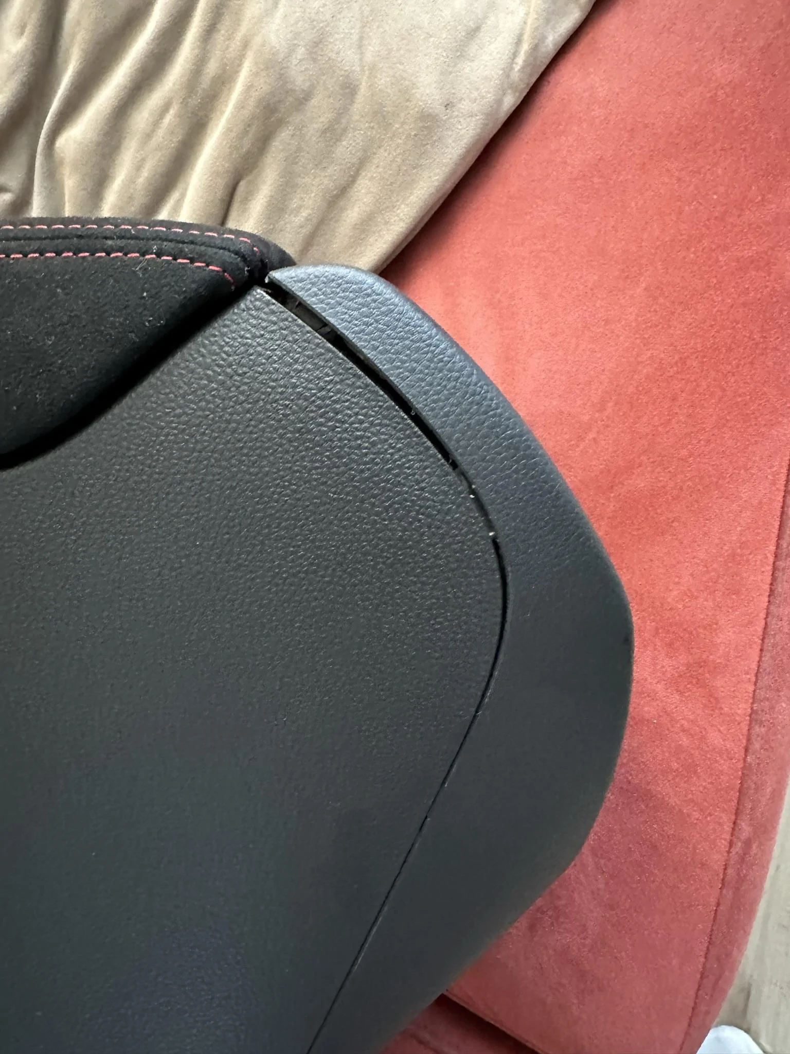

I'd like to say I was 100% successful with the rear a/c install but I couldn't get it to close back up all the way, good enough that I'll deal with it later but it's not right. I've emailed mikstore to see if they have any tips on what I need to do to get it to close flush.

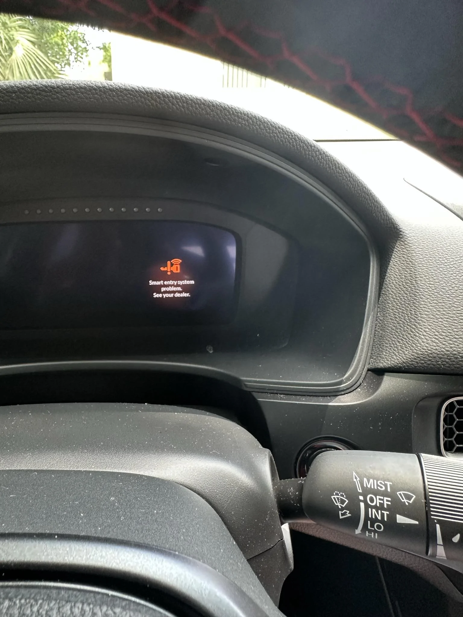

I also generated a nifty error code which is preventing my key from proximity starting the car after I closed up the center console and plugged everything back in:

That really sucks … I did my A/C conversion about 5 months ago and never had to trim anything but then again I didn’t order through Mikstore :hmm: do you have a link to the instructions they give you? And is the part the use 100% OEM? Now as far as the error code you are getting… did you disconnect the battery before doing the install ?
Various directions, pics, etc from here:
https://mikstoreph.com/products/civ...1&_sid=94235d575&_ss=r&variant=44322196685050
I *assume* the stuff is OEM. Where did you get yours from? If I have to buy a new rear panel I can deal with that.
Disconnect the battery first? No sir, so I'm sure I'm to blame here but I didn't see any blown fuses or anything.

I’m thinking you might have forgot to fully connect a sensor in the center console .. something to try out and just double check your connections… might be a small miss or a connector not fully seated… :coffee:
Willing to share the part numbers?

Yep, it's a sensor - it's too hot for me to face fixing it today... and I'd love to know the part # too @JDM_DOHC_SiR in case I can't get the fit perfect.
At least it works and works well!
Sure.. Here is what I used for part#'s
83451-T24-T01ZA : Rear A/C Panel x1
83406-TVA-A01ZA : Rear A/C Vent x1
83453-T24-T01 : Rear A/C Duct x1
83460-T43-J00 : Front Lower A/C Duct x1
83465-T43-J00 : Rear Lower A/C Duct x1
91550-SFJ-W01ZE : Clips x3
Those are the main parts but the hard part for me was finding the lower HVAC duct that connects to the lower A/C Ducts, what I had to do there was purchase a broken used HVAC unit from a JDM FL1 on Yahoo.co.jp Auctions since I didn't want to pay 500$ for a new HVAC unit. :banghead:
Thanks a million! Looks like I could just buy the panel for like $15 and swap the stuff over from the current one if I can't get it to be flush.
Fixed the key issue, there was a plug that goes to the right side of the center console I had missed. Took me a bit to figure out where it plugged into once I found the hiding plug.

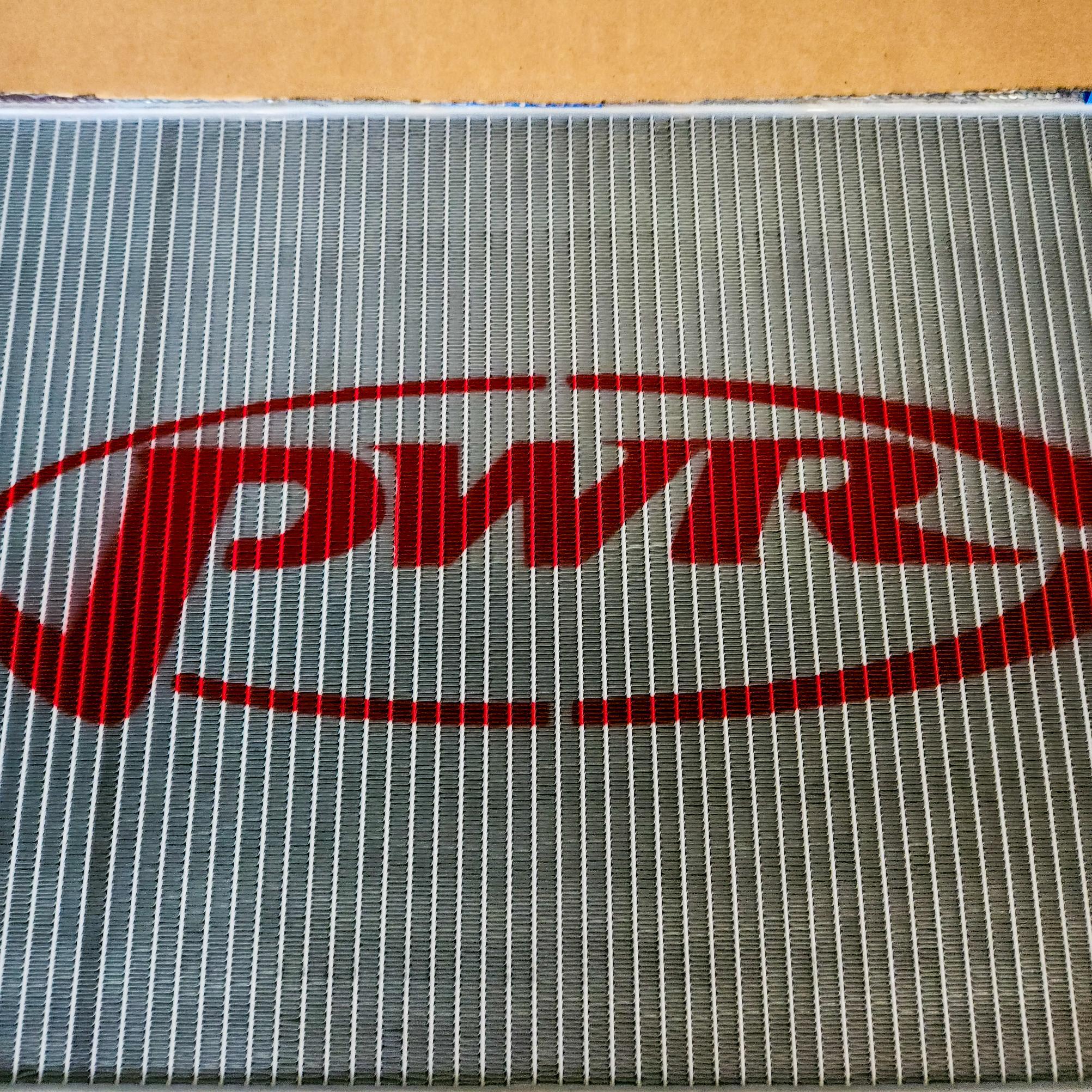

Was going to put in the pwr radiator, but it is scratched pretty bad. Waiting for them to send a new one now
