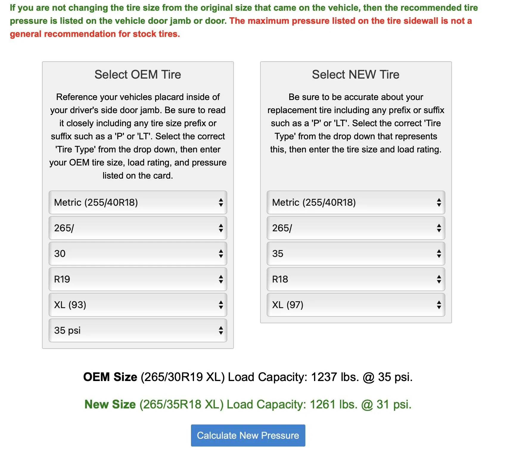

The recommended tire pressures for this car on the OEM 265/30R19 tires are 35F/33R. I see many running 18" wheels with 265/35R18 tires. What pressures are you running there?
If I use the caculator here:
https://tiresize.com/pressure-calculator/
I get the below for 35 fronts. It recommended 31 for fronts, 4 psi lower. Same for 33 rears - it will recommend 29psi, 4 lower. Is this the thing to then follow and do?

@urbo73 4 PSI lower than stock seems like a lot. That’s 11% less in front and 14% less in rear…but I guess it makes sense. It’s only a slightly smaller wheel and slightly larger tire. I’d probably start with what the calculator says (as it seems logical to me) and see how it rides, handles, and also check tire wear. From there I’d adjust by maybe +\- 2 PSI to get it dialed-in how you like it. Note, I’m not a tire expert.

I actually have the OEM 19”s, but with 265/35 tires instead of the 265/30. So same sidewall as 265/35R18s, but on OEM 19” wheels. Speedo is off a bit, but it’s worth it for me. For me, the calculator recommends 5 lower F/R, so 30/28, but I’m now driving with 33/31 and seems more than enough. I’ll go with 32/30 for a bit more compliance and still be within the recommended range.

Yeah, but one thing is true: 35/33 is not the correct pressure for anything but the stock tires, and even that's a bit high as it's for max load (4 passengers + luggage). The calculator correctly, I believe, translates that to other size tires based on load. Whether one chooses to follow that or not, that's another question. But that was not my question.
