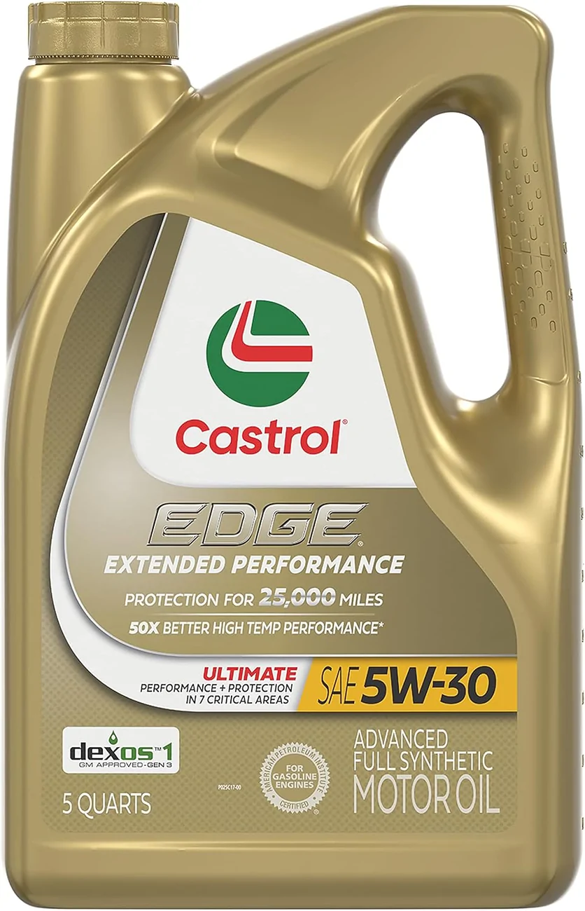

I'm totally curious about trying Castrol - still Dexos Certified - Anyone try Castrol Edge?
Can you imagine going 25k miles between oil changes?! These oil companies are 1 step away from claiming that their oil will never need to be changed again.
I have a bottle of the Edge in black with the Dexos 1 Gen 3 label on it. I purchased it for the truck I traded in for my FL5. What do you want to know? I have old PP Ultra 0w20 in the FL5 now but I'm swapping to 5w30 after this fill.

It would be good to get some lab results of edge extended performance. Just always been curious about it after the Nissan Skyline engine builder recommended Castrol as a very good oil to use.

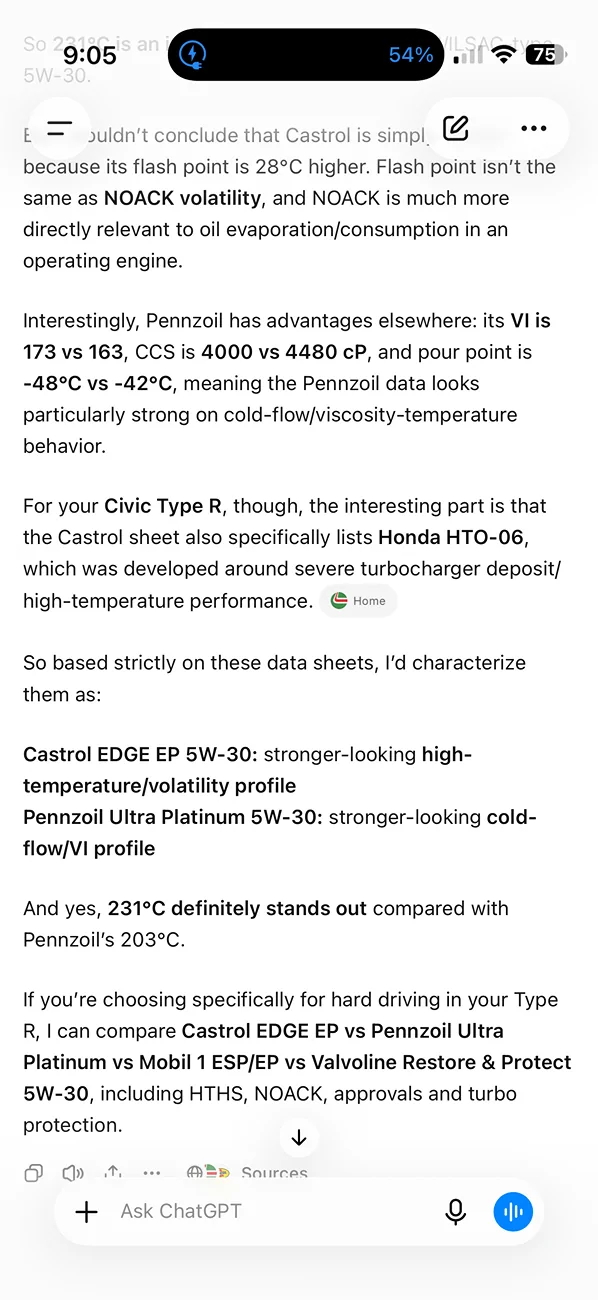

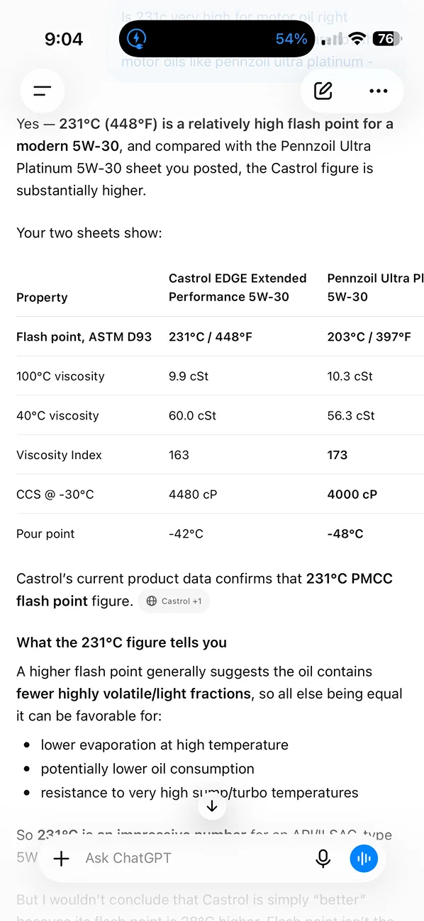

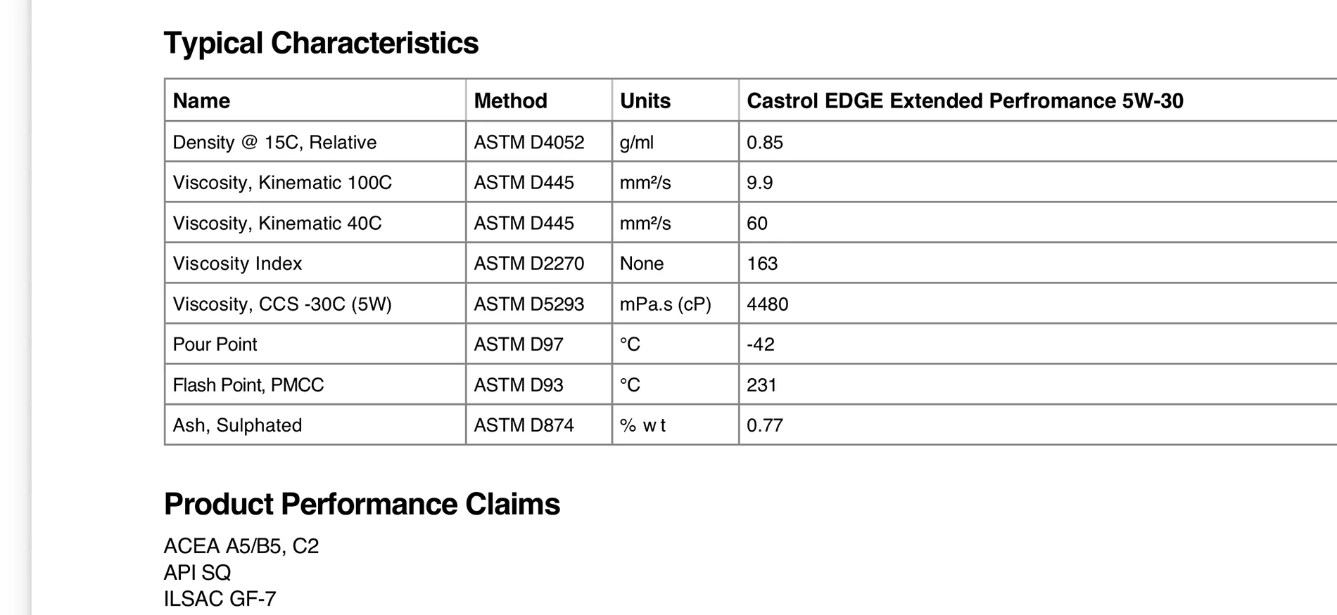

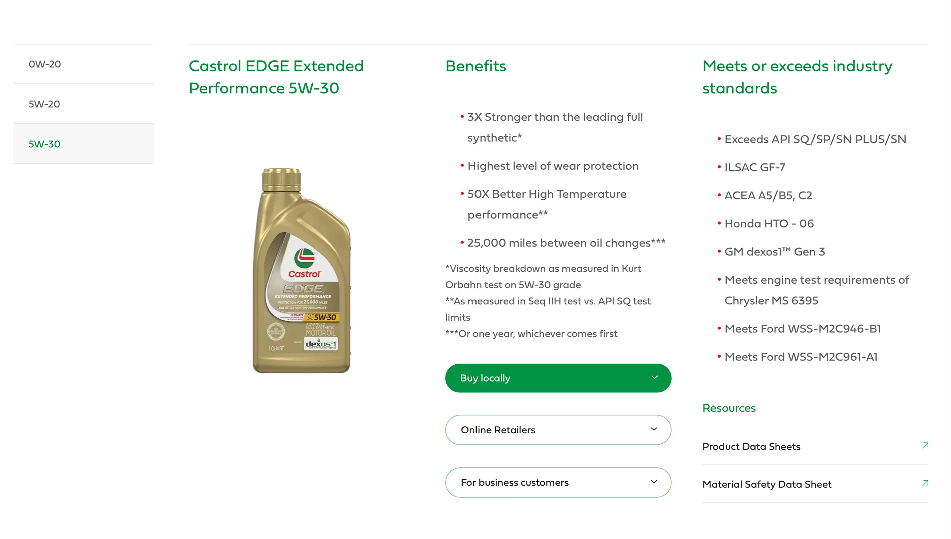

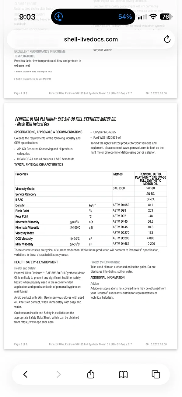

The one metric that really stands out is the Flash point temperature is way way higher. 231c vs 203c pup. hmmmmm I may try
