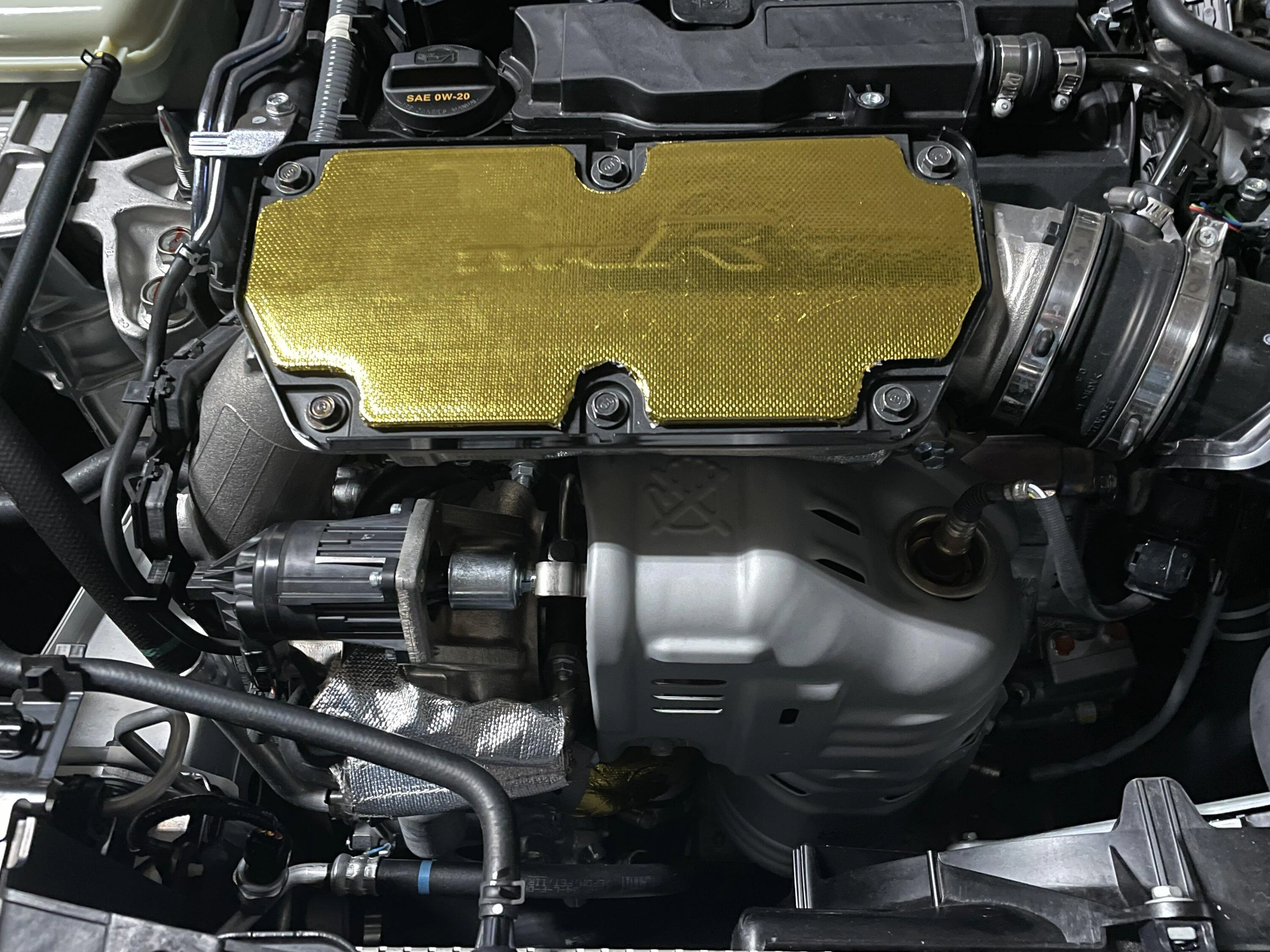

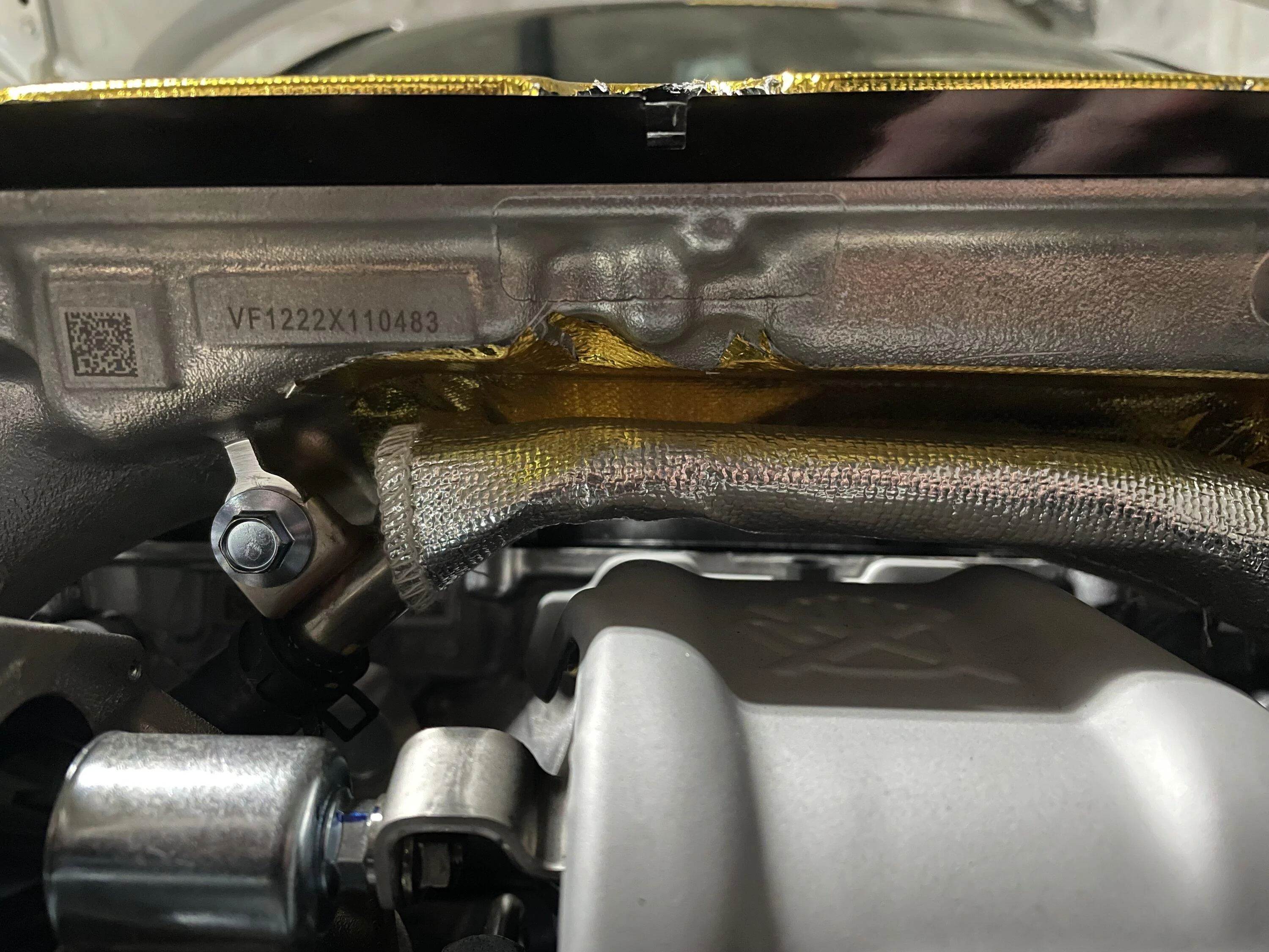

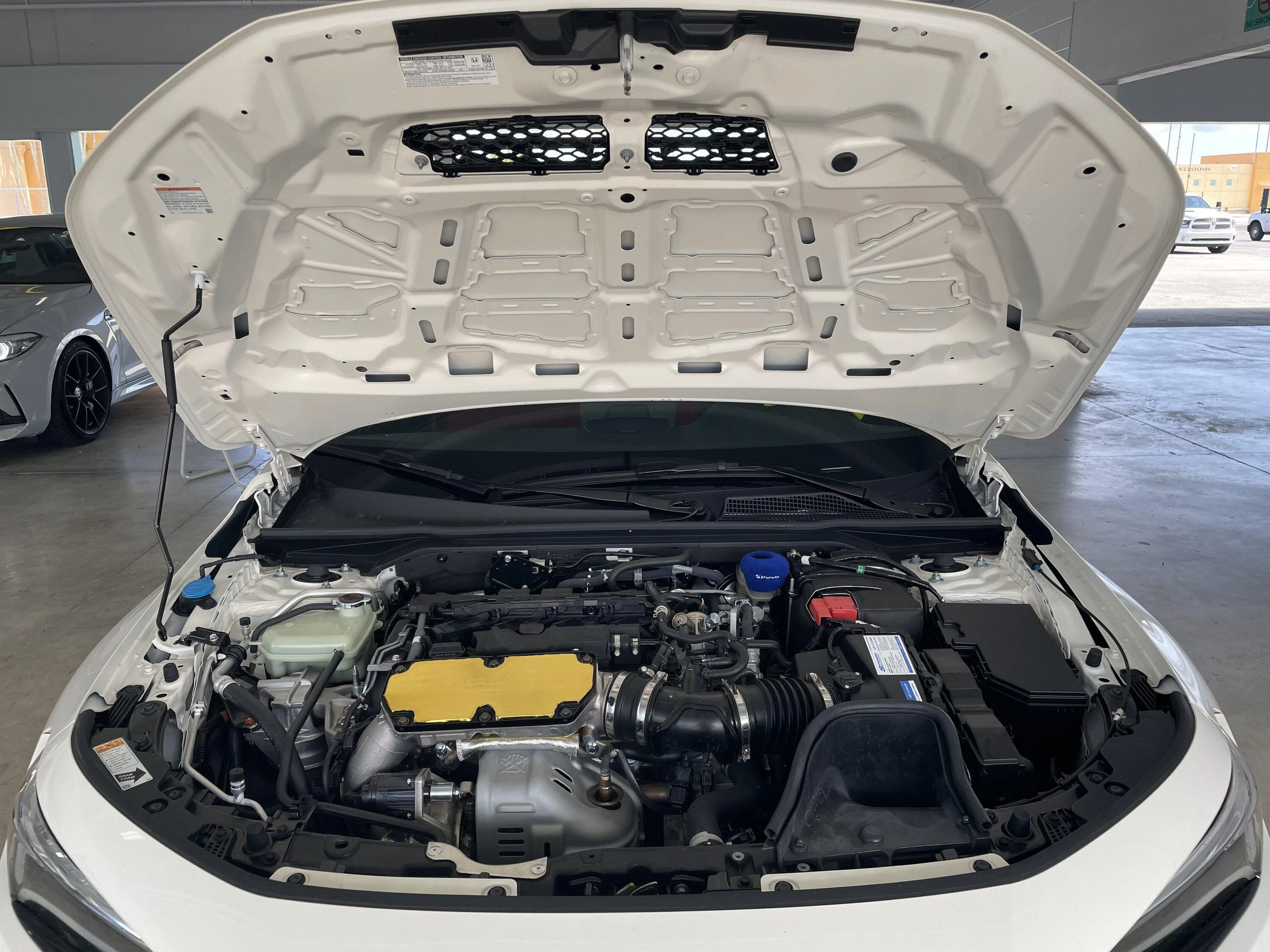

On that note, I would also like to say during my two track events I did not experience any overheating issues even with ambient temps around the mid to upper 90's, granted I did do some heat management modifications around the turbo housing as shown below in the following photos. In addition to the heat insulation materiel, I removed the rain gutter under the hood vent. If anyone else is tracking the car this makes a huge difference and it's super easy to reinstall before going back home.

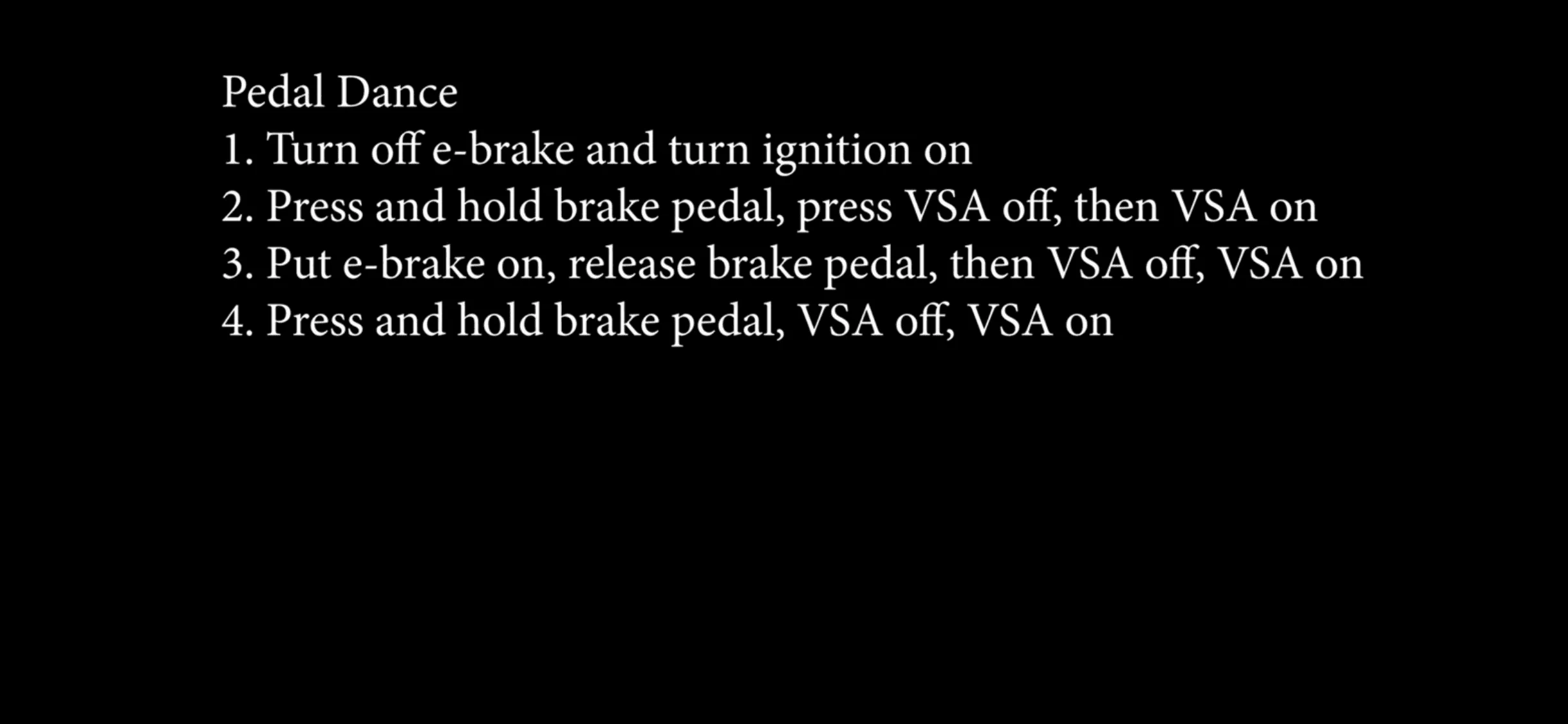

So turning off VSA via the button under the dash is just half off? Is the pedal dance hard to perform and how do you undo it?

LMAO the missed call is my favorite bit of the video!
In terms of the VSA off procedure it is pretty simple. Once you turn off the car and turn it back it on the car will go back to default. @TheTopher has a good video on how to disable it, but here is the screen grab from his video. Once done, the rear brakes stopped dragging and the car felt more natural.

In R mode you can long press and fully defeat the system, pedal dance is only needed for other modes.
I was in R Mode and I still did the pedal dance before going out on track. For me the long press still felt as if the rear brakes were dragging. Could just be in my head. Lol

Another member mentioned heat soak after his track day @ MId-Ohio. Did you experience the same and what are your thoughts on upgrading the intercooler?

No heat soak issues for me. As I mentioned I removed the rain gutter under the hood vent.
In addition I added some heat insulation materials below and above the intake arm around the hot side of the turbo and wrapped the oil lines too.
At the moment, I’m not going to upgrade the Intercooler. Power wise the car felt great out on track.
