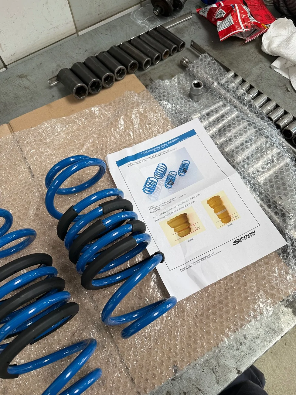

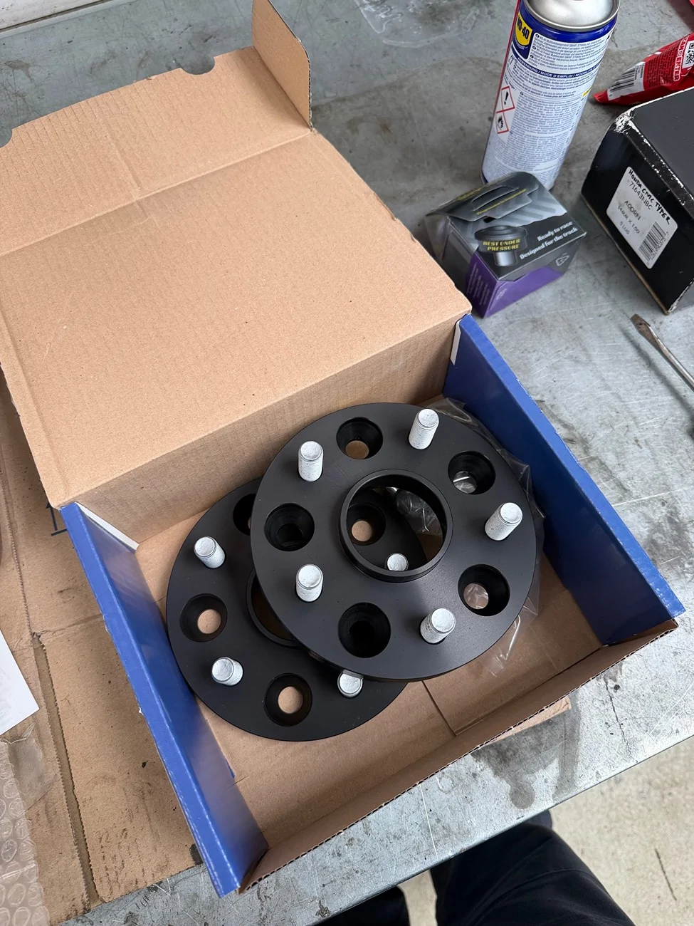

recently installed the spoon springs the revised version from dr automotive. Initial impressions is the car handles bumps so much better especially on the autobahn but I can’t truly give my opinion on handling in the backroads due to adding 20mm spacers from H&R. The fitment is great but it tracks all over the place and torque steers like crazy so I’ll be removing them soon to give a real impression.

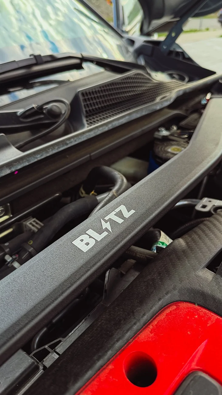

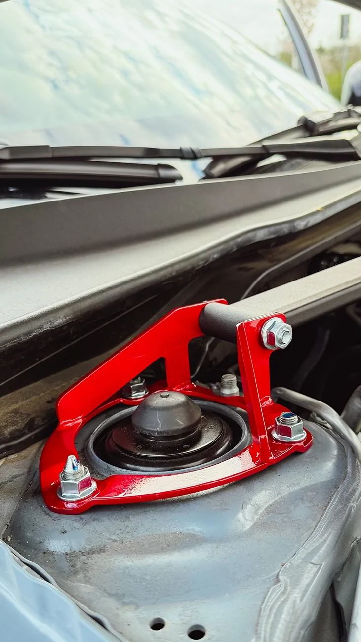

Blitz front strut bar
I kept the current setup (spoon springs with 20mm spacers) and added the blitz strut bar just to see if I can get the handling where I wanted it to be and I’m almost there. The blitz bar was super easy to install and looks… factory which fits my clubsport look. I wanted to go with the Js racing bar but after seeing the quality of the welds and wait time I had to p

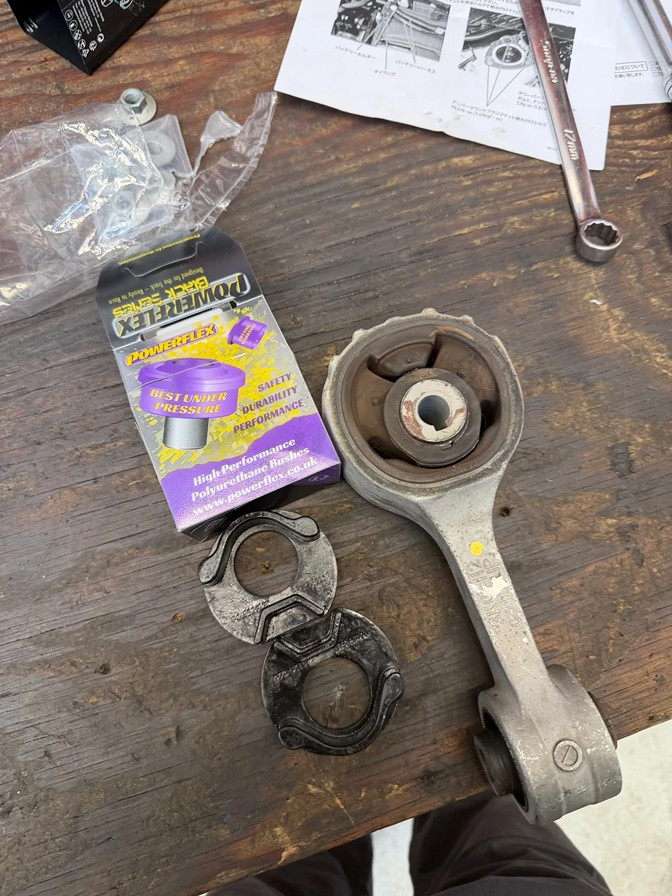

Power flex torque insert
Now this might not be for everyone due to the interior cable vibrations but it works… so I went with the race version which might not be the right move. I’m aware it will soften up over time so I’ll follow up on this if it doesn’t to my full satisfaction I’ll swap the street version. Install was easy and took about 30ish minutes to install. If your FL5 is your daily… don’t go with the race version it’s way too much vibration for a daily especially if you’re using your car for family duties.
the shifts are sooo much more noticeable and on and off throttle is crazy responsive. Feels more tactical and solid which I love a lot
