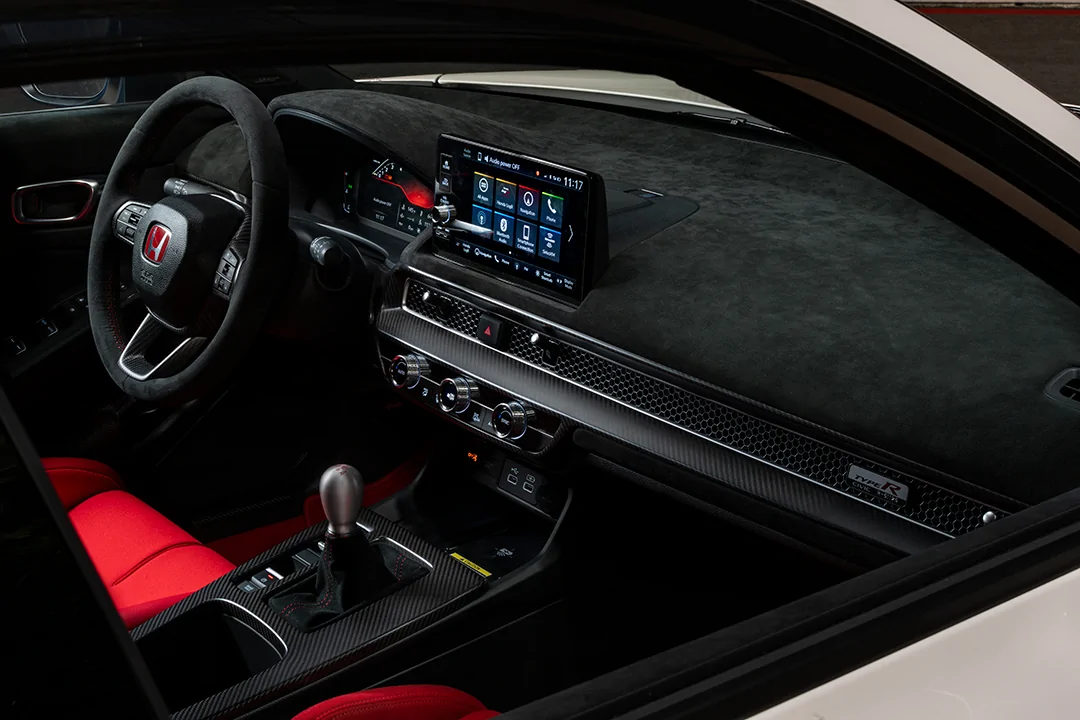

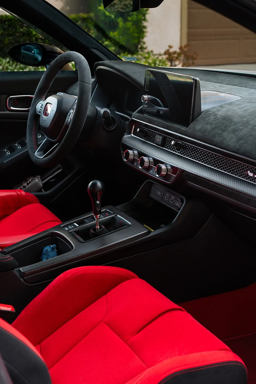

Did a replica of the oem Black Edition Alcantara dash and top of the door cards thanks to Sweidit oh also did the A pillars as well. Installed the J's Racing matte carbon fiber steering wheel housing.

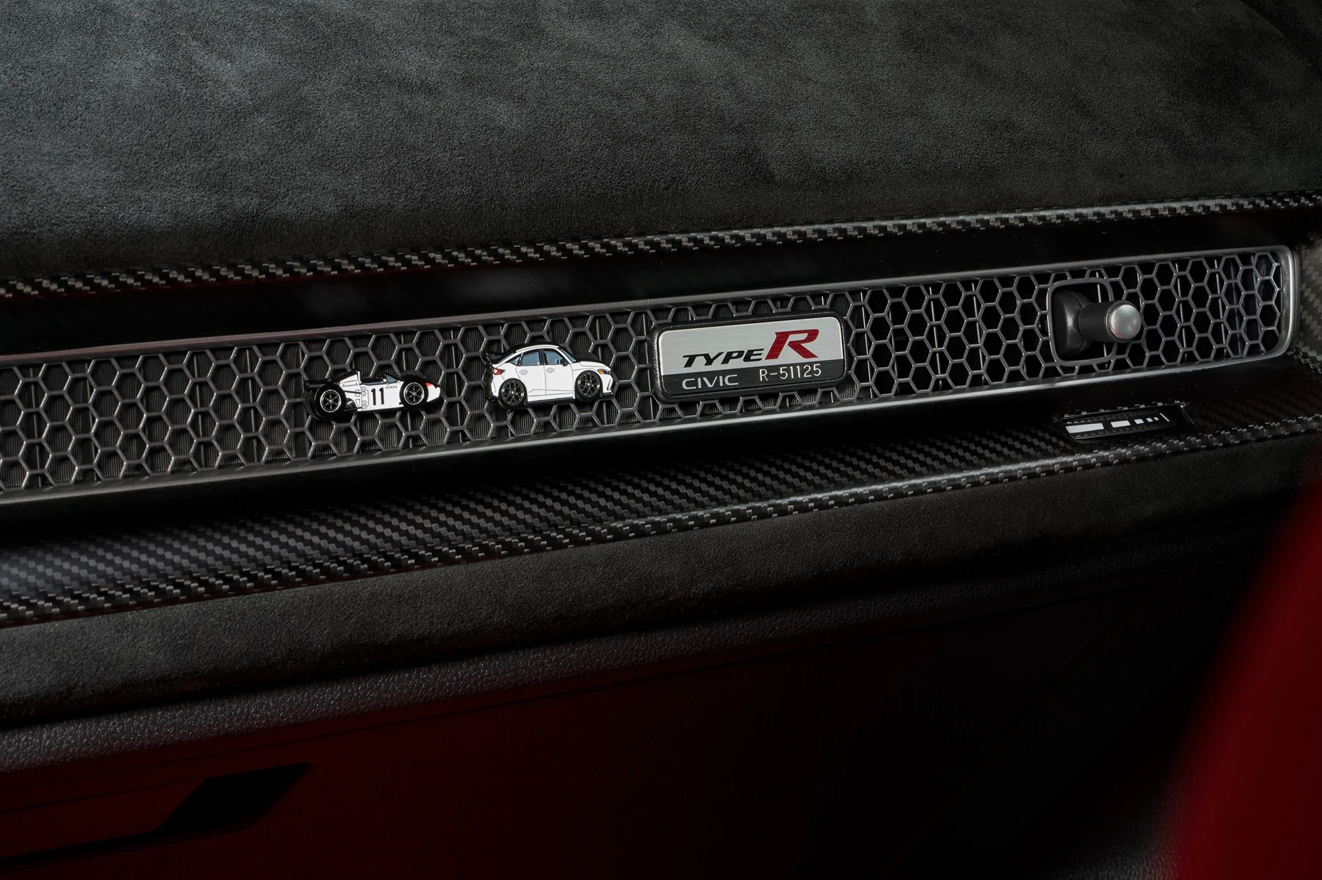

Came up with a fun way to display some Leen Custom's pins:
Just cut the rubber backings in a wedge shape and push them into the grill. Perfectly spaced to fit.

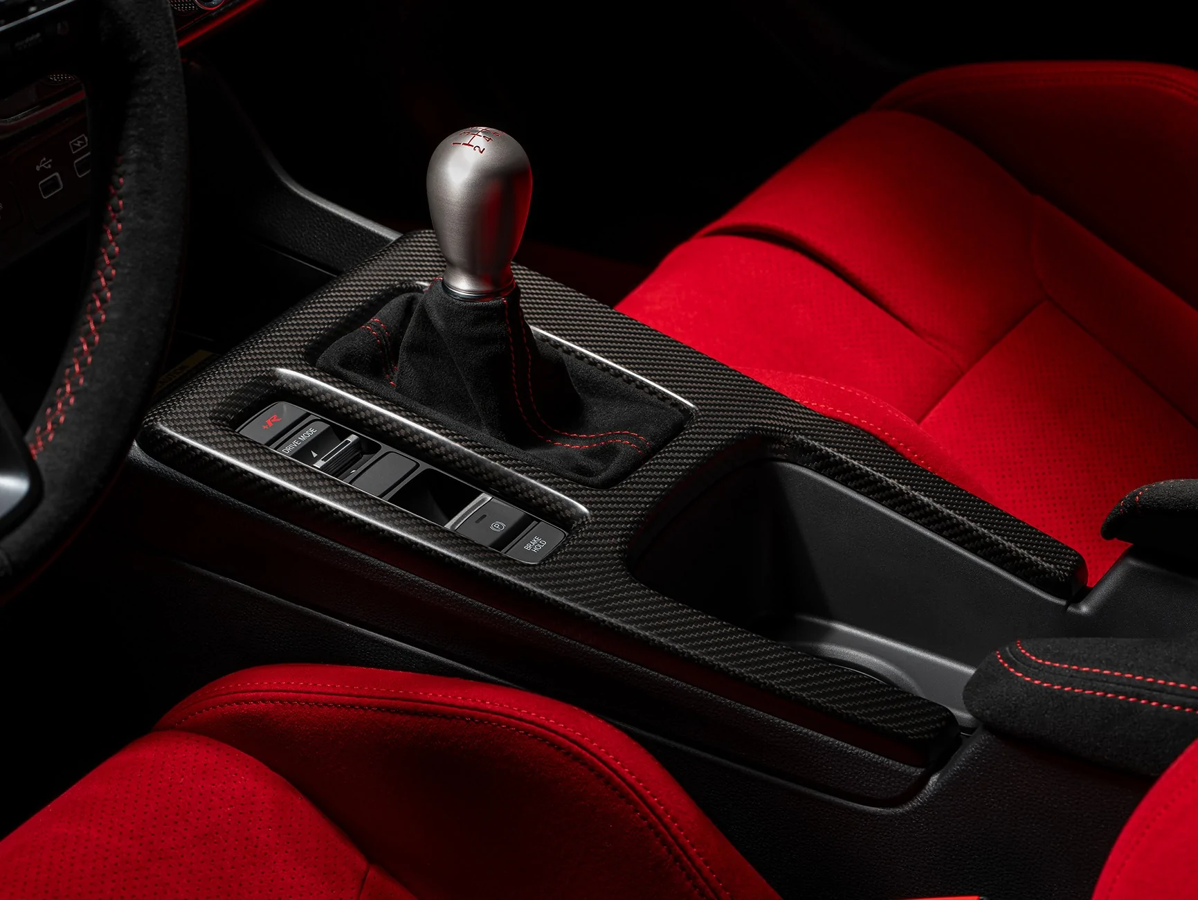

Acuity SS went in along with adding my favorite shift knob design of all time from Lonely Driver Company

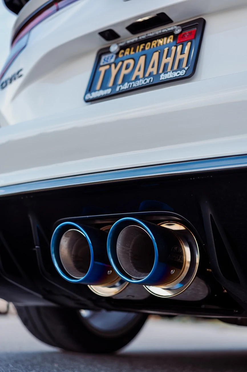

Apexi N1-X exhaust came in and I threw that shit on real quick cause the exhaust volume on this car is still just as bad as the fk8.

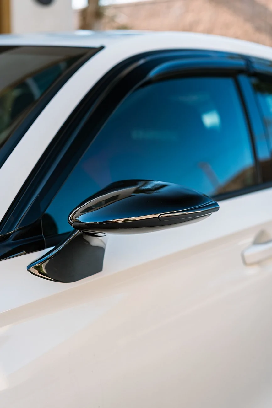

Oh Mugen window visor on too. I'm just trying to get this up to current month so I can go to bed....

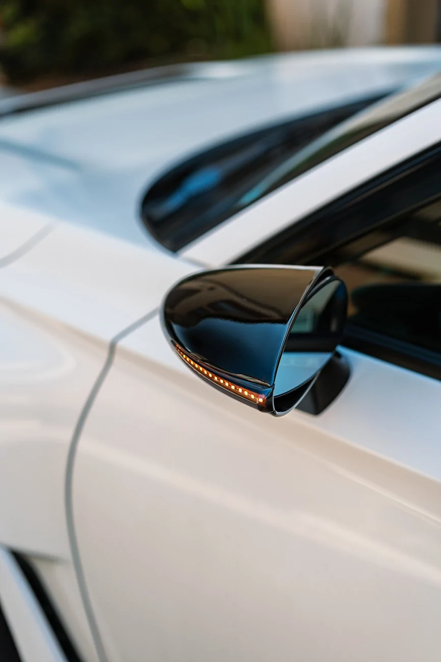

Ballade Sports mirrors finally came in after a 3 month wait. Ordered them painted gloss black. They're plug and play and retain all the oem functions

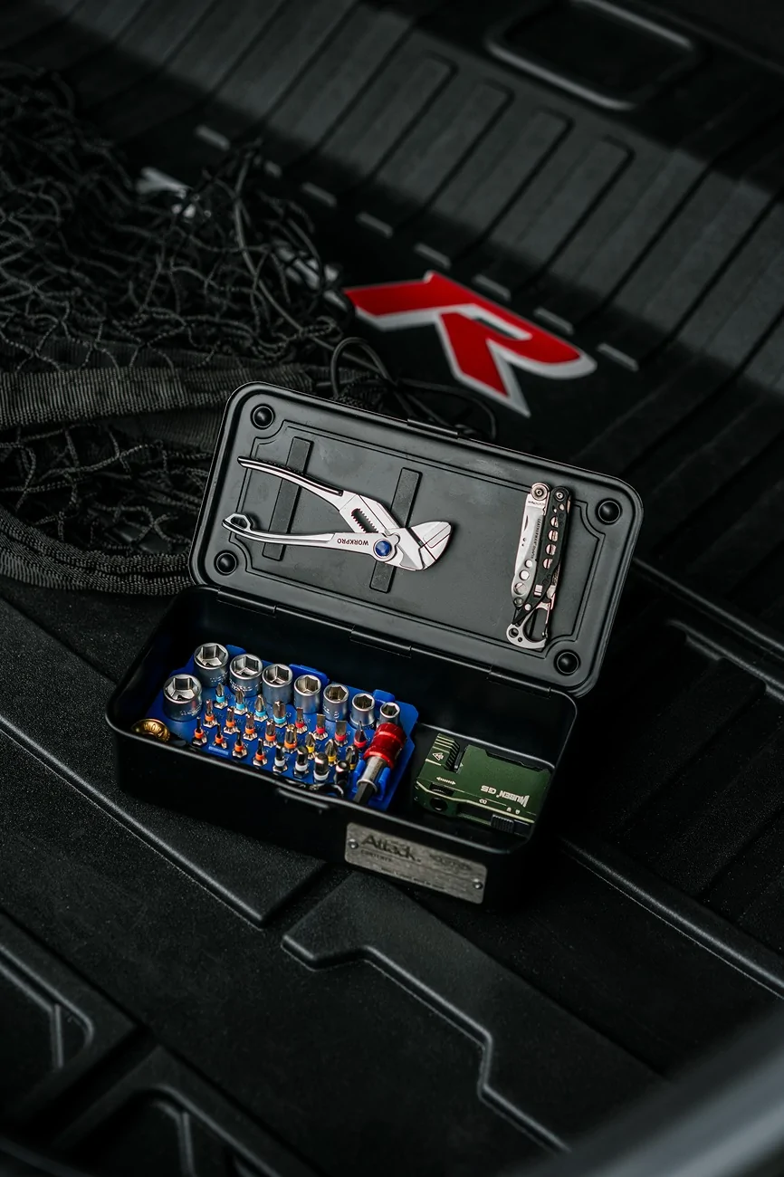

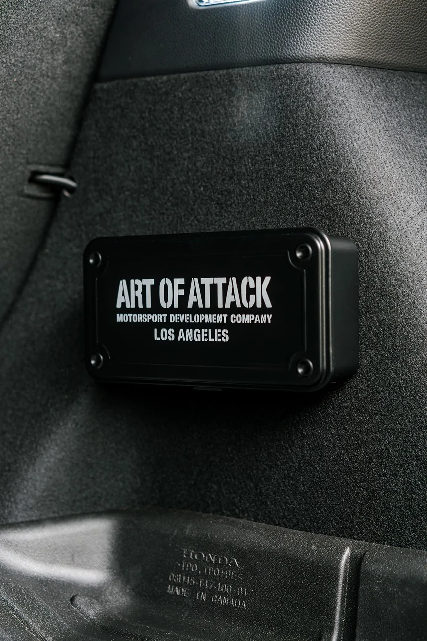

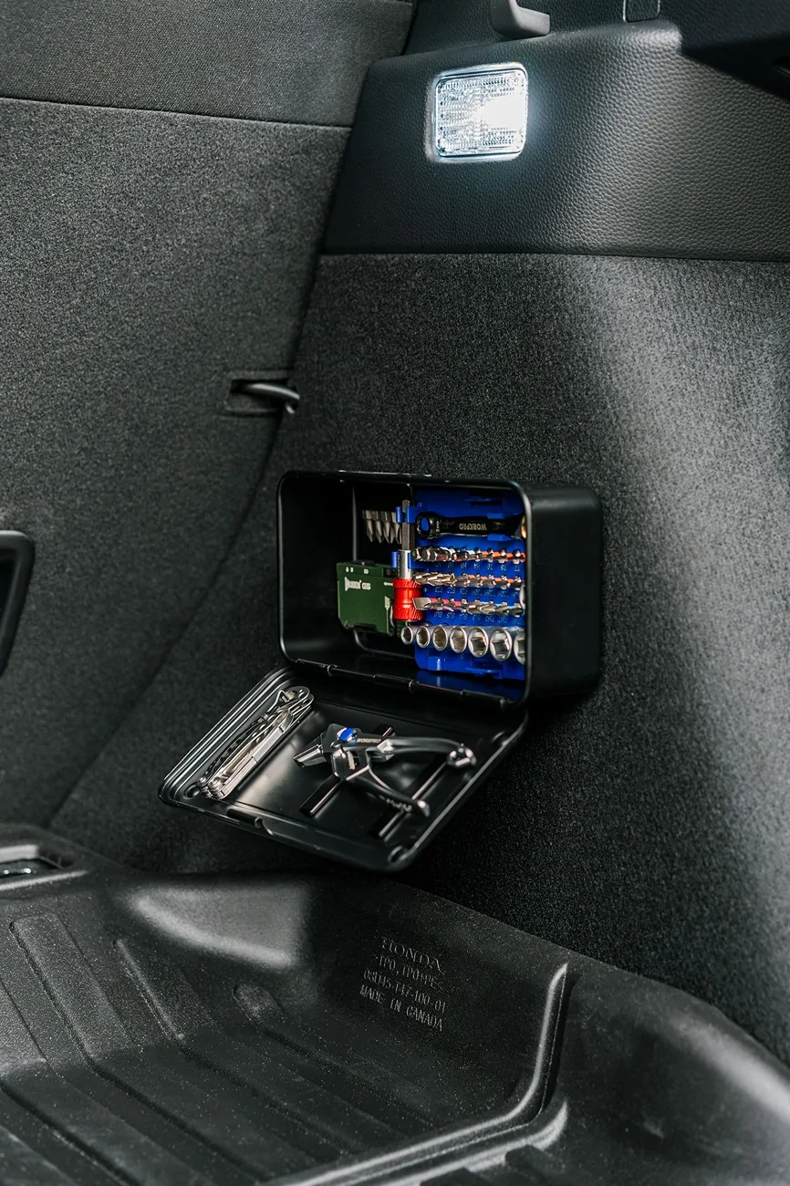

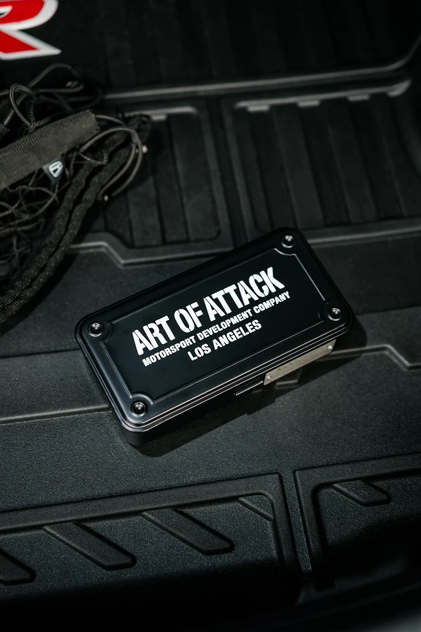

Art of Attack x Toyo Steel mini tool box. I used the ol' blackmagic "magnet" trick to have it attach to the car. I love building stupid edc kits for my cars and when Angel released this box I knew what I had to do

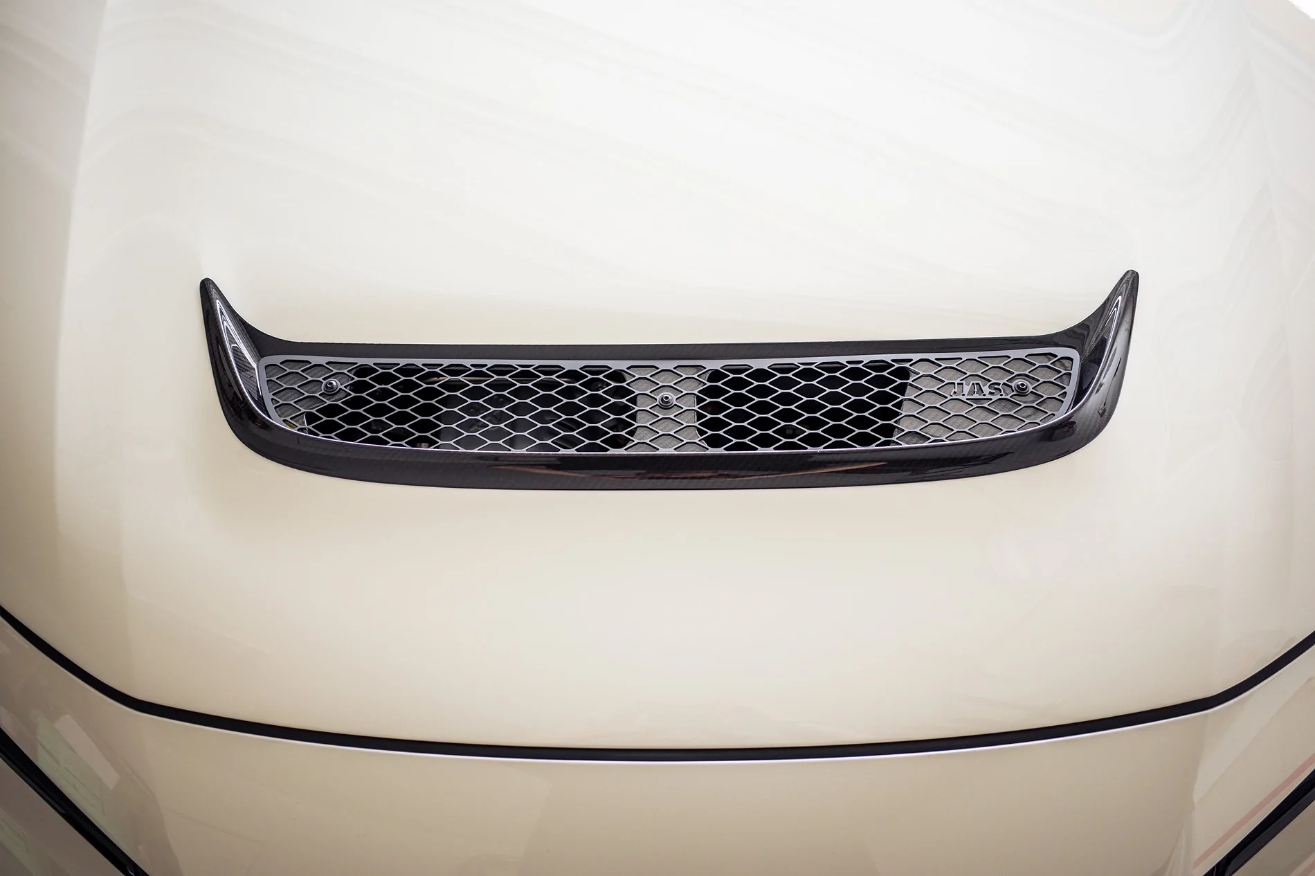

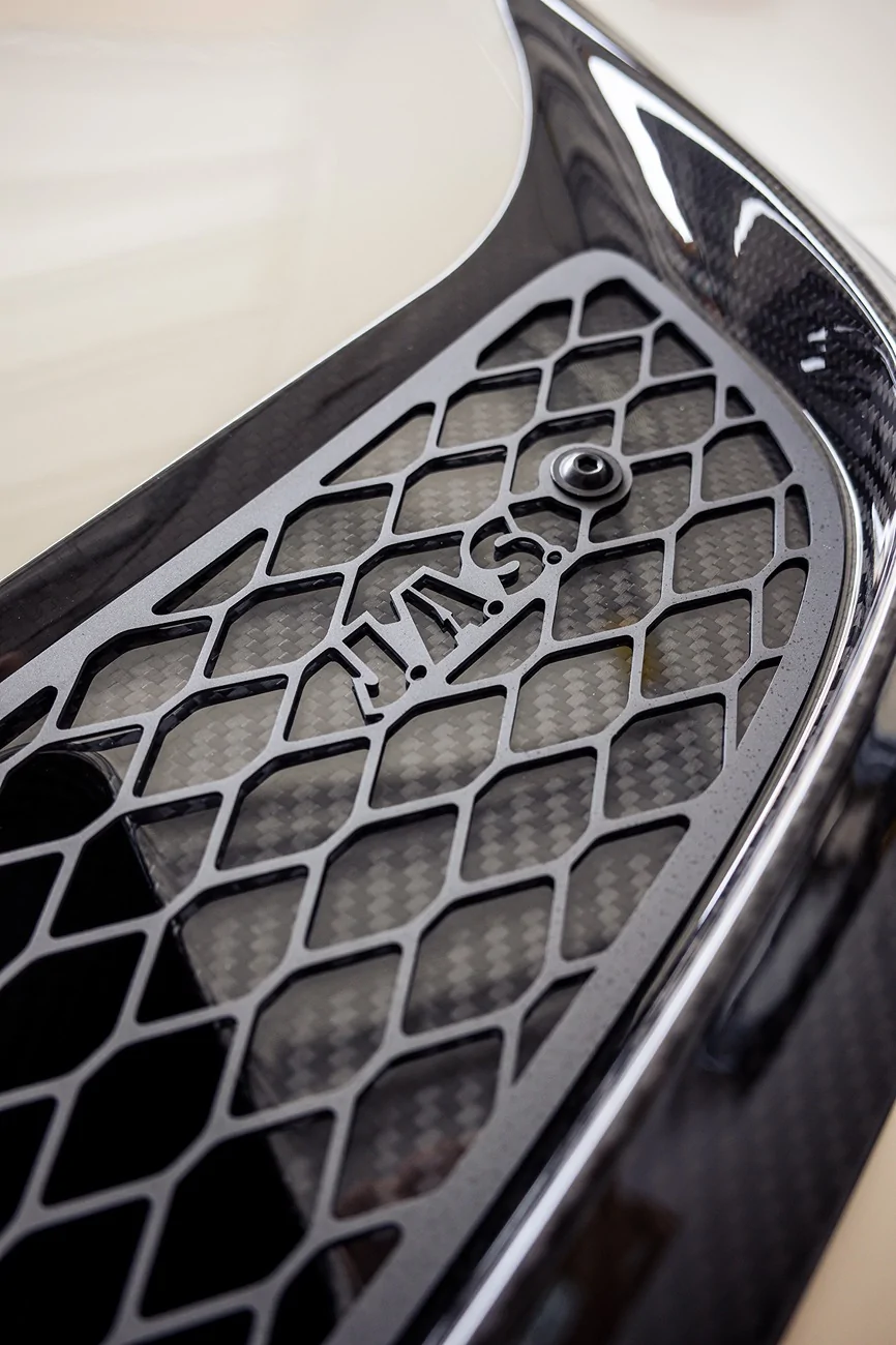

J.A.S. Motorsports parts arrived. Only ordered 3 things but it was the pieces I felt I'd enjoy the most for the time being.

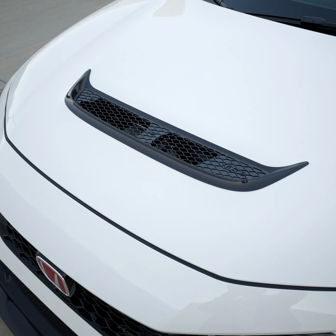

Favorite vent insert. 98% on fitment. The passenger side edge has a 1mm gap compared to the rest of the piece sitting perfectly flush. I do have ppf so I'm wondering if that's causing the issue. I also read and was told the hardware might rust and the metal grill should be resprayed as that'll rust too. I'm going to leave it as is for now since I do have a hood on order and would rather sell piece how it came from JAS.

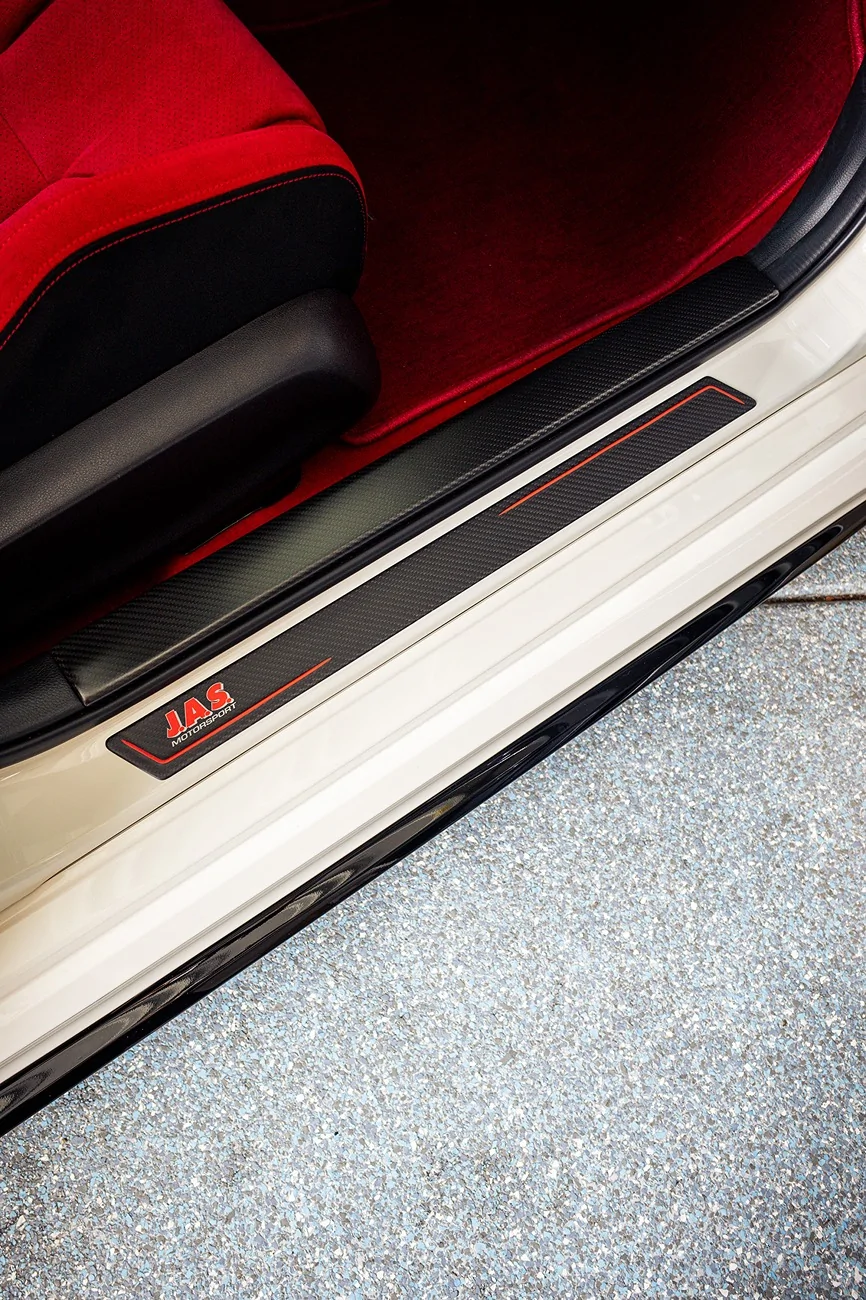

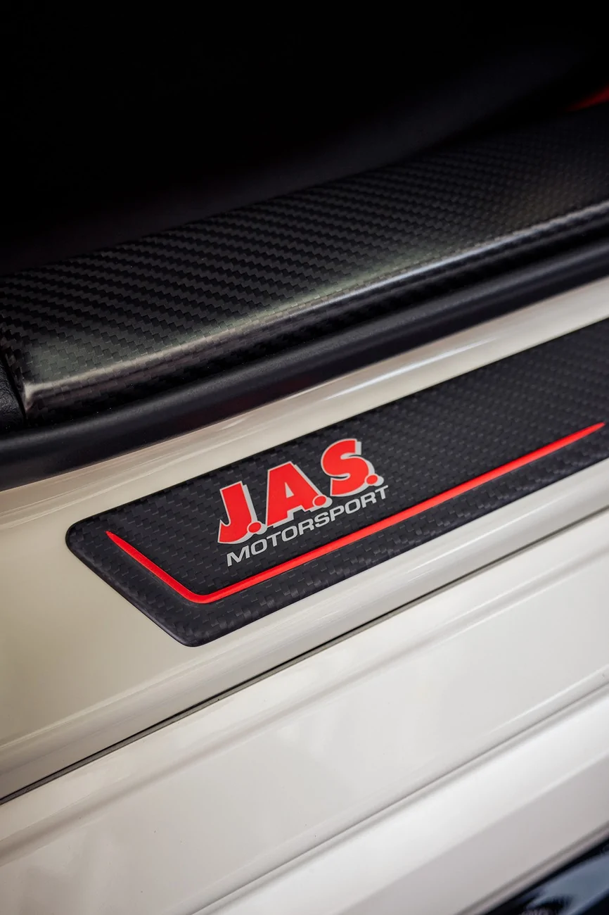

Matte dry carbon door sills! Actually bought these cause I saw they were real cf instead of the mugen ones or the illuminated plastic oem ones. I'm more than satisfied with the quality and uniqueness it adds to the interior.
The double sided tape it came with sucked so I reapplied some 3m vhb that I always keep with me. Never know when you need to afix something back onto the car in a pinch.

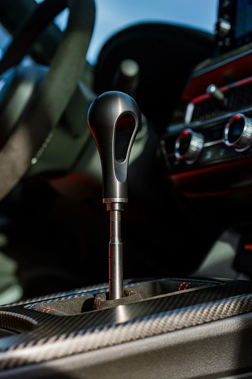

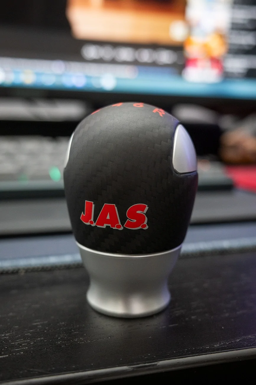

Ahhh the shift knob is very well made and basically is like an upgraded oem feel. I really do love the oem fl5 knob but man did it scratch easily for me. My work bag buckle grazed it and left a mark.
But yeah I don't think I'll use this JAS one just yet. Mainly wanted it as a collector's item cause...well it's J.A.S.

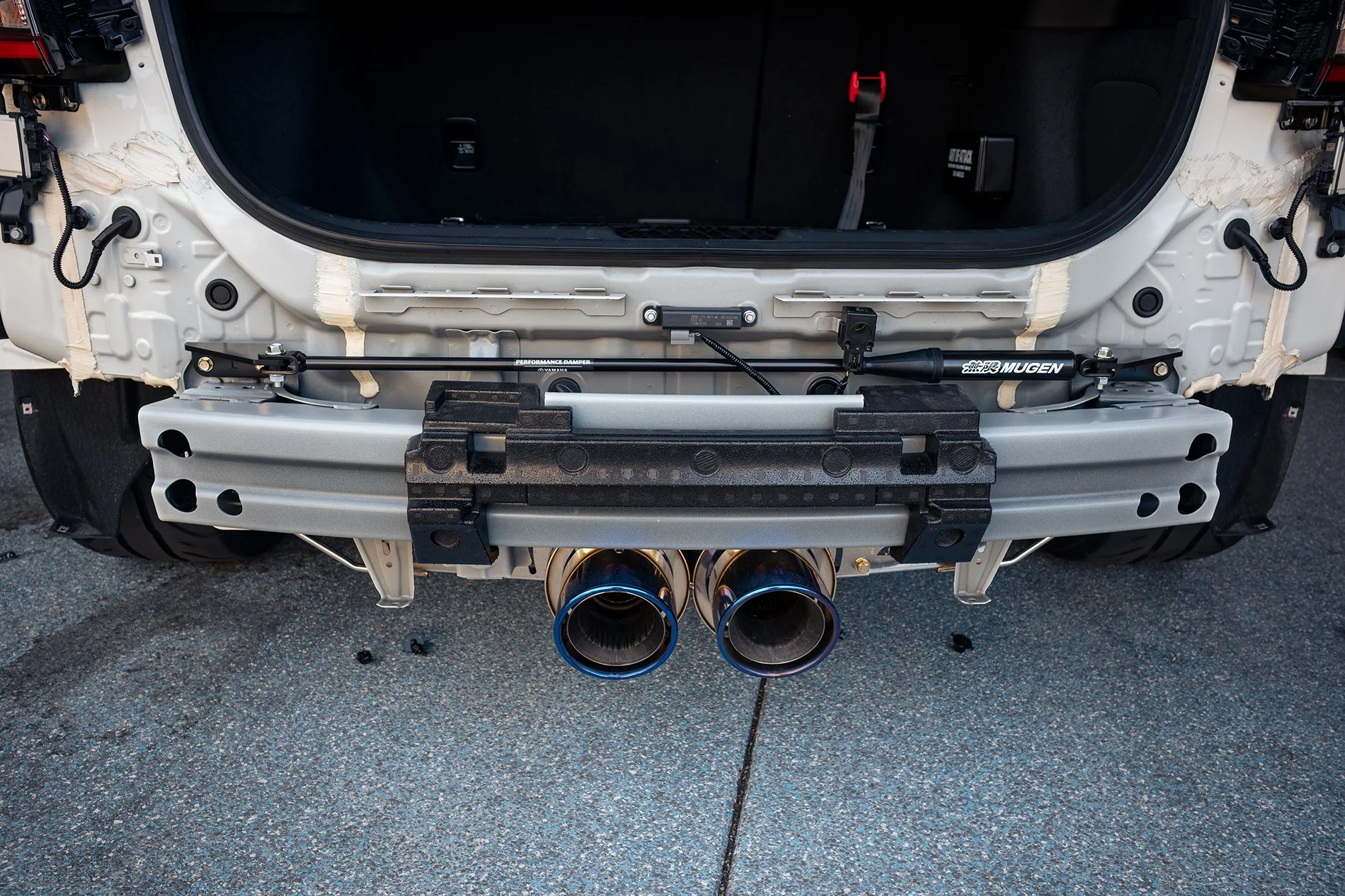

More Japan parts arrived....

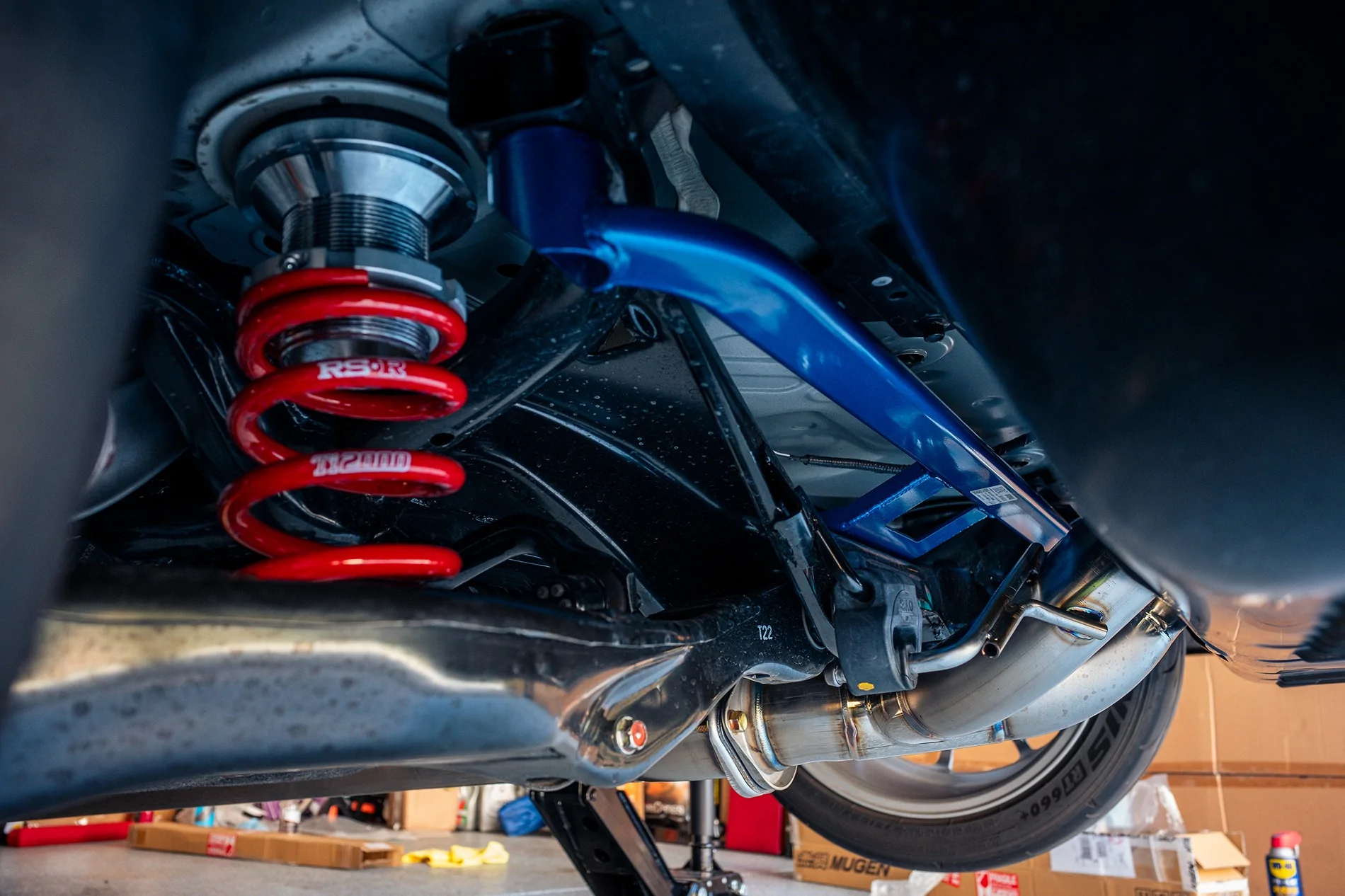

After seeing the HKS video on how much it absorbs vibrations I was sold. Honestly I could have done some power mods but this build so far is about the slowing chill things in life right now.
11th Gen Honda Civic Kazuo_WFC 2025 Civic Type R build PXL_20260421_181040255
Installed the front. Cold start had noticeable nvh reduction. I usually have this rattle from center of the dash....but it was gone. I was going to put some felt pads to get rid of it but hey ok that only cost me $900. Fawk. Haha.
Oh and the manual is for RHD so that's why the Mugen decal is upside down....I know...it's trashed now. Charge back time.
11th Gen Honda Civic Kazuo_WFC 2025 Civic Type R build 1776899871000_R0000630

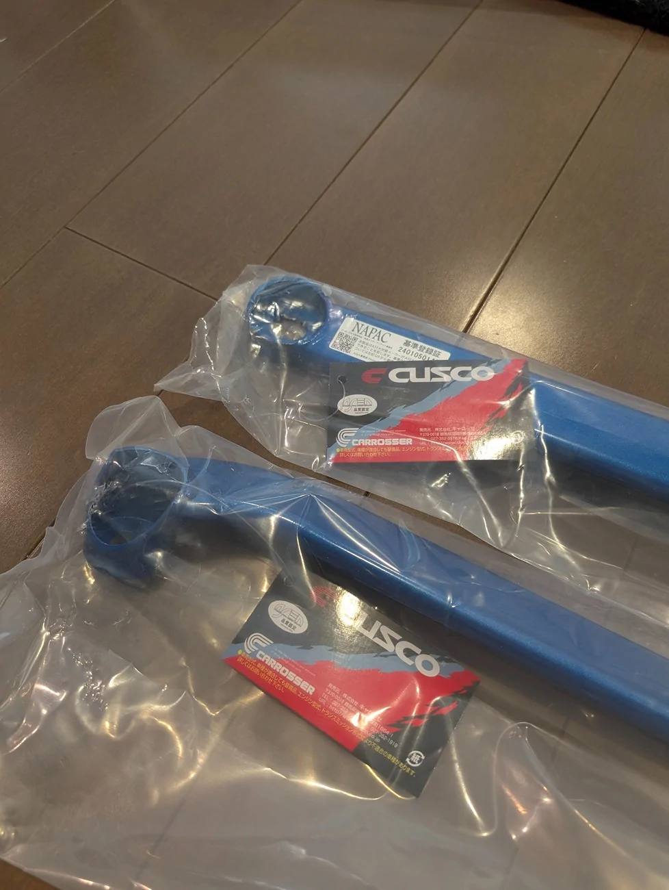

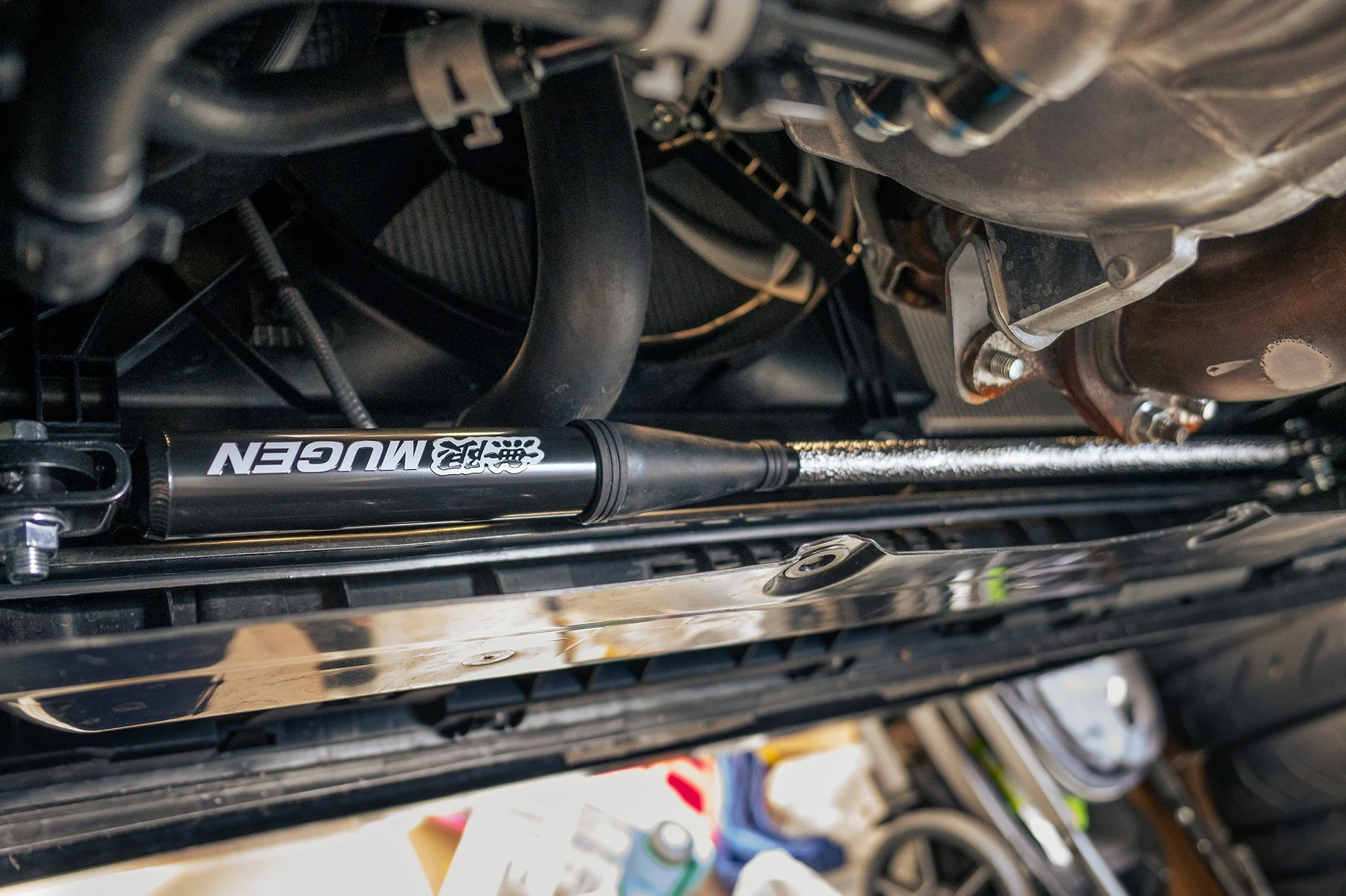

Ok so I tried to install the front cusco brace but it wouldn't clear with the hardware from the mugen damper kit. I ordered some lower profile bolts so hopefully that gives me the clearance I need to torque it down. Seems overkill when I look at it stacked together.....should have taken a photo but I was more disappointed in the moment. Anyhow we'll see if adding more rigidity changes how the damper works. Kinda works out as it'll give me a day to drive the car.
11th Gen Honda Civic Kazuo_WFC 2025 Civic Type R build PXL_20260421_175706387
I'll do the rear damper tomorrow along with adding a throttle body spring to the exhaust valve.....apexi n1 problems. Exhaust is still worth it even with the rattle but at least someone figured out a different solution besides trying to seat it tighter. Thank you fellow forum member wherever you are.

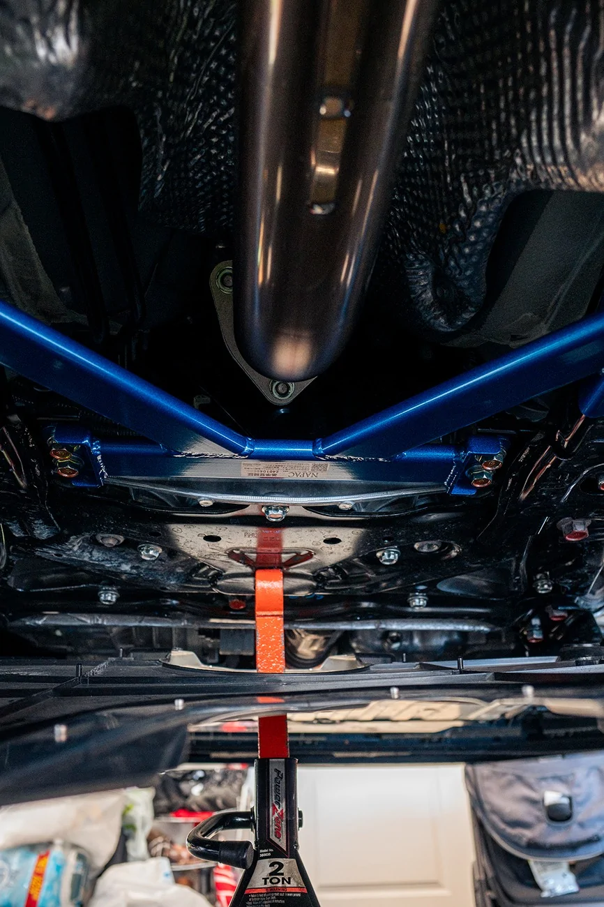

Did my 2nd oil change at 3k miles w/ Pennzoil Ultra Plat Synthetic 0w20. I'm trying to loosely follow The Motor Oil Geek's advice on how he'd do oil changes for a new vehicle from this video:
While I was under there I installed the Cusco mid brace. You can just remove the 4x 10mm toward the back of the plastic cover and 4x of the clips and 2x clips on the upper part of the plastic cover (in the wheel well). Typical 14mm and 17mm sockets to remove bolts and reuse them with some washers they provide.

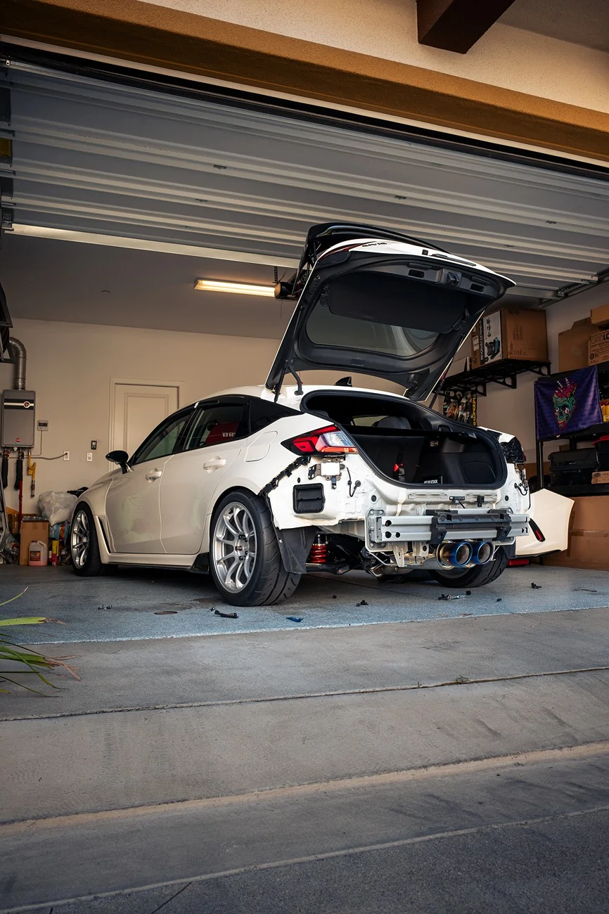

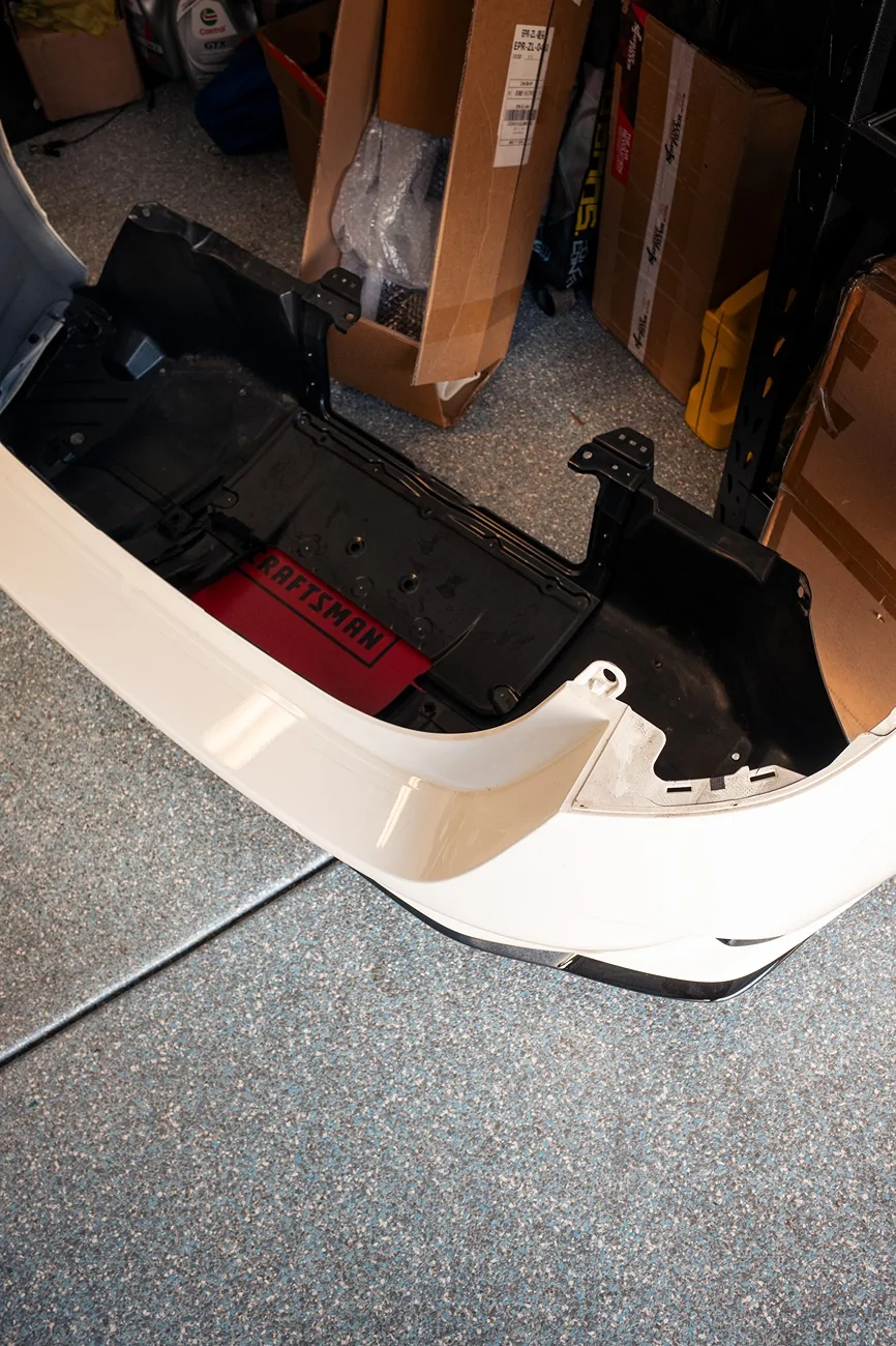

The took off the rear bumper to do the rear Mugen damper and also install the Cusco rear brace. Oh since I have the Rigid Collar kit install I made sure they were sandwich between the bar and the brace since 2 of the mounting points for the brace connect using the oem subframe bolts.
Rear bumper removal seems even easier than the FK8. The rear diffuser comes off with it. 2x 10mm, 2x of those plastic hex pieces with the 2 notches you push and spin...haha sorry no clue on the real term for them and 2x of trim clips under the diffuser as they clip into the chassis.
11th Gen Honda Civic Kazuo_WFC 2025 Civic Type R build 1776960184000_R0000634
11th Gen Honda Civic Kazuo_WFC 2025 Civic Type R build 1776960254000_R0000637
11th Gen Honda Civic Kazuo_WFC 2025 Civic Type R build 1776961442000_R0000645

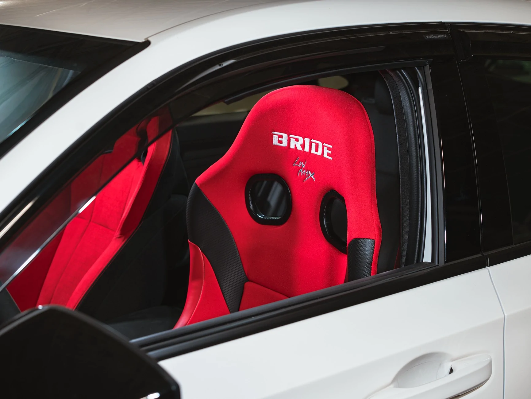

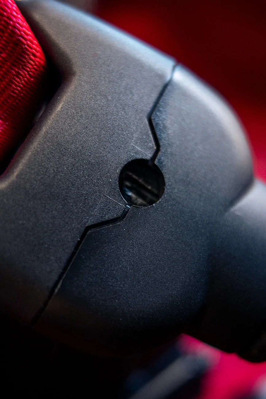

Last fix was to install my driver seat belt properly with the bucket seat. The best part is you only have to use a flat head and turn it counter-clockwise...I think it was cc. It's a latch that locks the belt to the bottom part. I was like....damn Honda really did intend people to do mods with this car...jk I'm sure it's some cost saving, part swappable shit for them.
Oh make sure to get a seat belt extender. I used to pick them up from Amazon (used them on the GT3 and my M3) but noticed they were not listed anymore....bought one from here instead and it's perfectly fine: seat belt extender pros
Also installed lasfit led bulbs for the blinkers and reverse lights.
11th Gen Honda Civic Kazuo_WFC 2025 Civic Type R build 1776974240000_R0000669
11th Gen Honda Civic Kazuo_WFC 2025 Civic Type R build 1776974273000_R0000670
