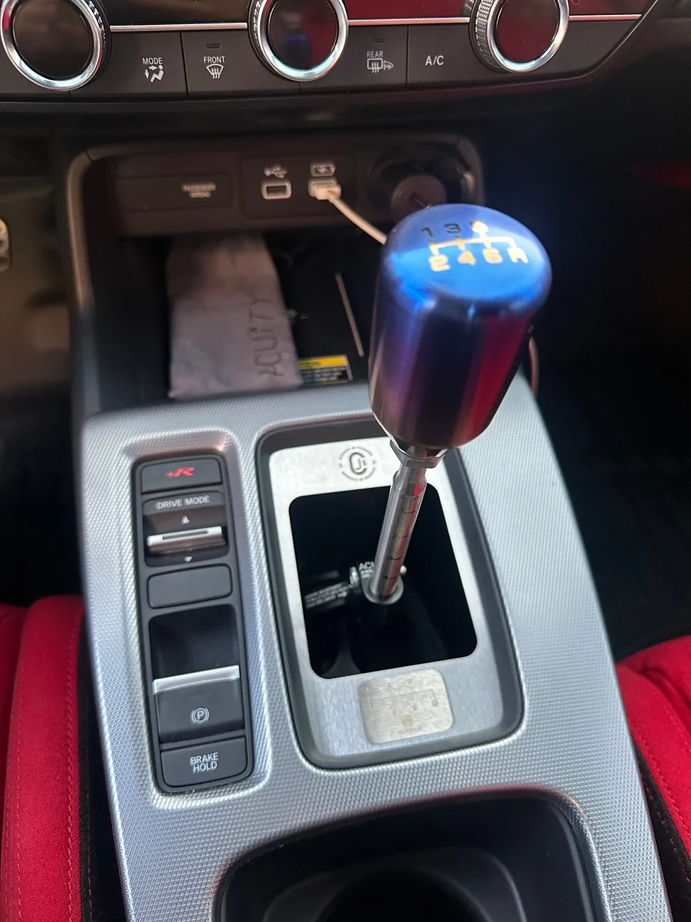

If anyone is on the fence about the acuity short shifter, go for it it’s one of the best shifters I’ve ever felt
11th Gen Honda Civic Acuity Instrument's Short Shifter IMG_5266

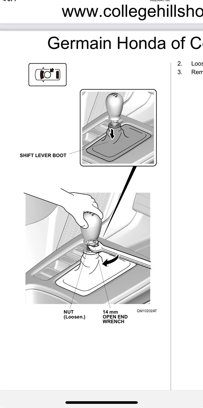

That’s funny shit right there! Wonder if Honda knows you ā€˜need’ a pick tool.
Here’s the official instructions!
11th Gen Honda Civic Acuity Instrument's Short Shifter IMG_6006
Like I said in the video, just forcing down the shift boot collar did work for the first few times in my fk8 and works for many others, but once I sold the car and took out the Acuity shifter, I had zero luck with the pull down method haha.
I'm guessing over time the tabs get pushed in too much, and they need a little help getting pulled out to get around the lock nut.
So again, I'm not saying that the Honda way does not work, but I found over time it did not work for me.
