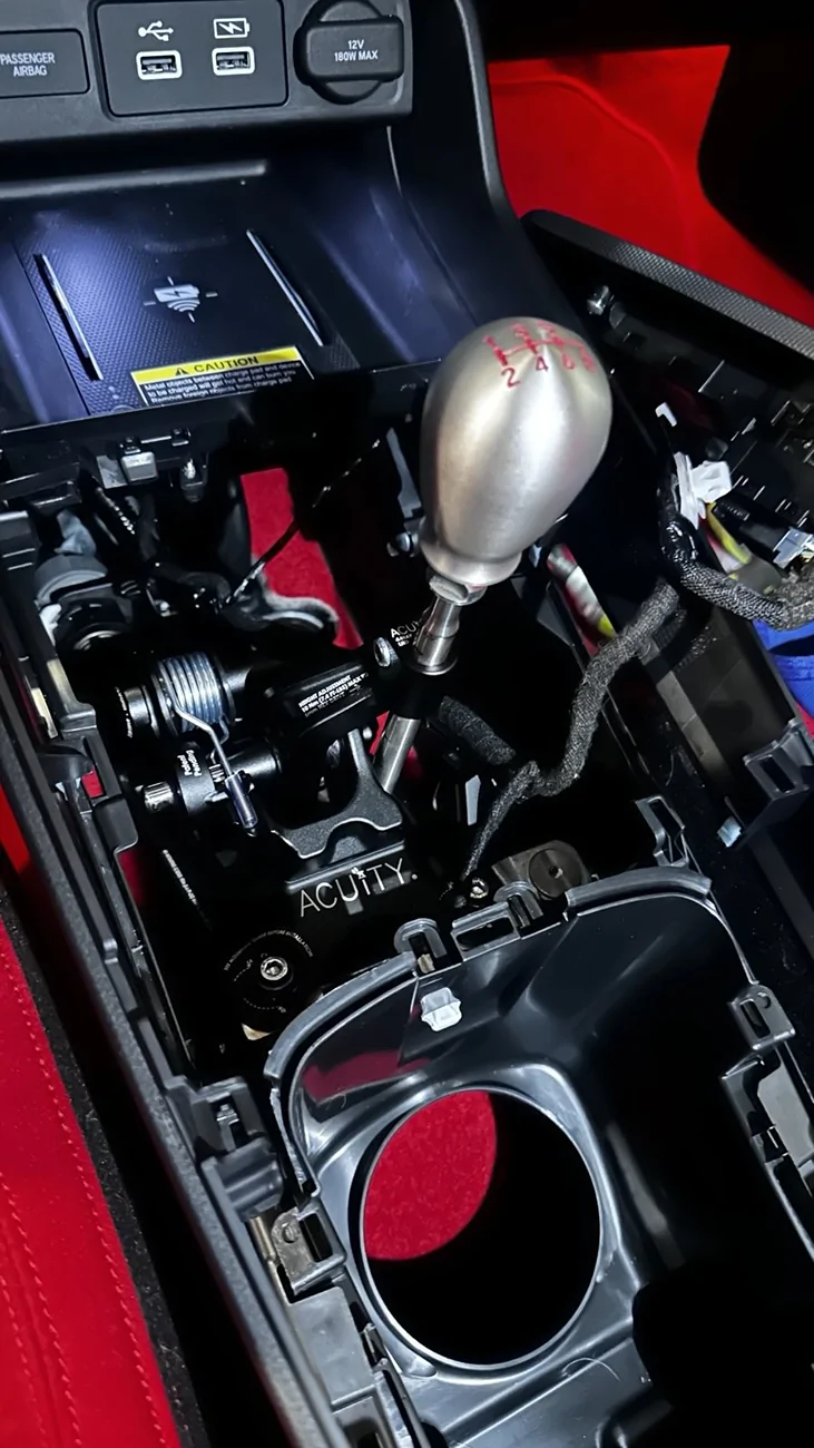

Just got done with the install and initial drive, height adjustment and final drive.
- Install is pretty easy, great instructions, keep an eye on the spring/clip that you have to take off from one of the cables, mine flew into a small hole and went under the carpet. Took a magnet stick and 15m to get it.
- Make sure you disconnect the negative terminal on your battery. The car is very not happy if you don't. Mine wouldn't start until I unplugged the stuff I reconnected, removed the negative, plugged everything back in, and put it back on the terminal.
- I kept the throw settings at stock, and just played with the height. At 4 height it felt a lot like the stock shifter with a slightly longer throw. 1 was too short but felt good (shifts were too tight), 2 didn't feel great for some reason, 3 felt like the stock shifter, and I settled on 1.5 which to me felt very good. (all had a more mechanical feel but the shorter you went, the more mechanical it felt)
The stock spring is good as is, I might adjust the gate a little bit just to see how it feels but it's kind of a PITA to get to once you start to plug everything back in.
Overall, very worth it. I don't think it can 100% compare to the S2000 direct shifter, but for a cable shifter it's very close and for something you touch on every drive it's a great mod for the money.
