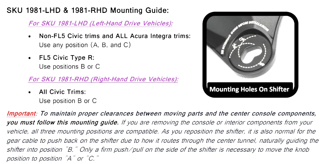

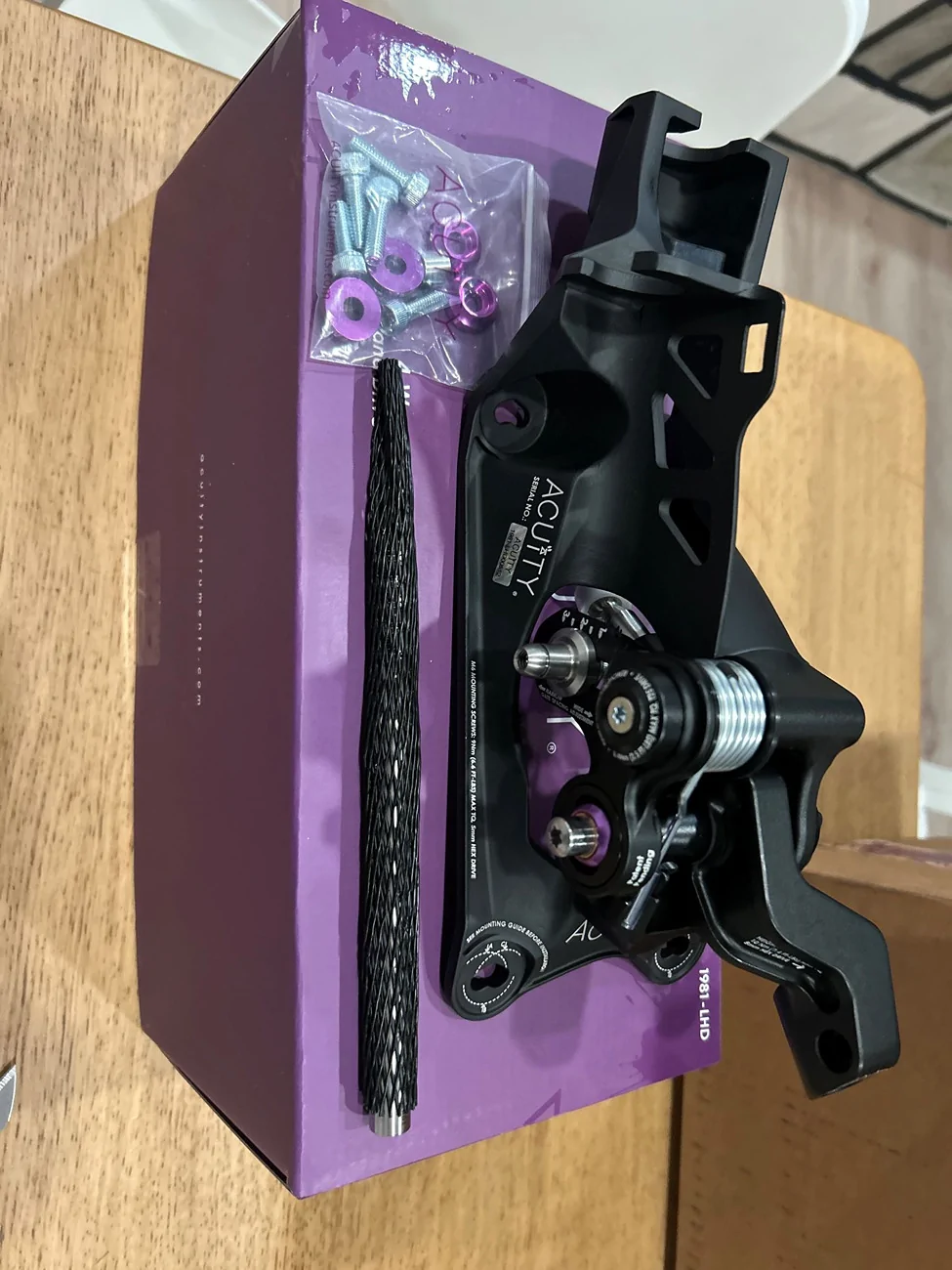

Just finished installing tonight. I'm curious if anyone has dialed in some settings that remain relatively close to "stock" as a good baseline to start with. I plan to retain the stock shift knob and boot.
Acuity manual suggests the following:
LHD FL5 Mount position = B or C
Gate = 1
Throw = 1
Height = 3
11th Gen Honda Civic Acuity Instrument's Short Shifter 1763786778992-pt
11th Gen Honda Civic Acuity Instrument's Short Shifter 1763786854475-hz
11th Gen Honda Civic Acuity Instrument's Short Shifter 1763787500182-ho

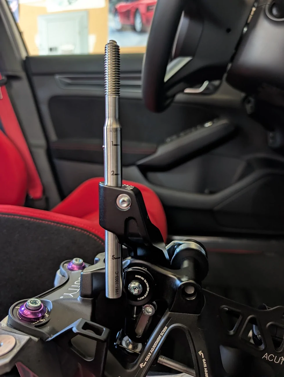

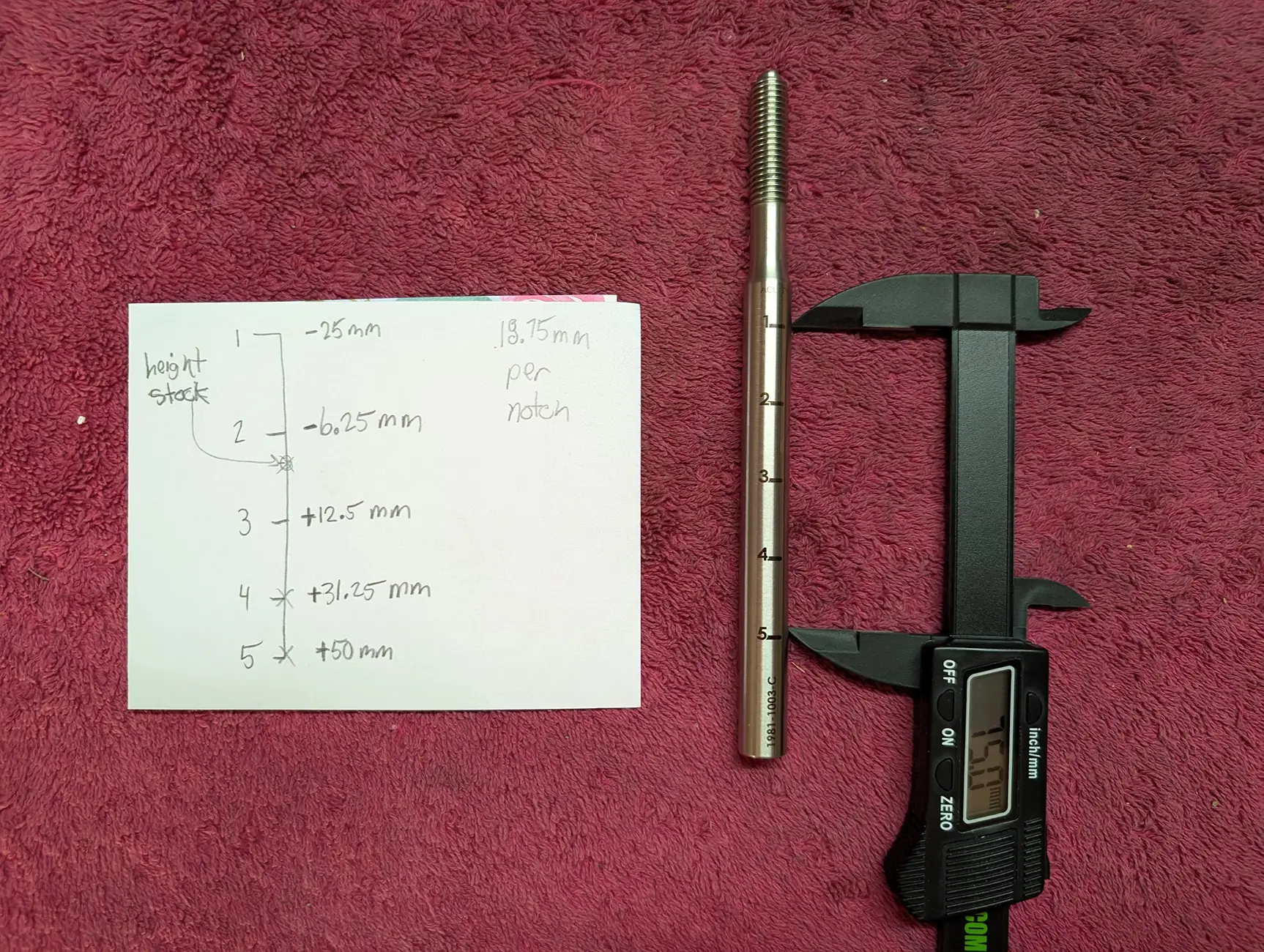

I've done a little more research and wanted to share. For me, It is important to be able to dial in a "stock" experience first, then start modifying from there.
11th Gen Honda Civic Acuity Instrument's Short Shifter 1763834723454-ld
Documentation indicates 75MM of total range of adjustment (-25mm to +50mm from stock). That looks correct.
11th Gen Honda Civic Acuity Instrument's Short Shifter 1763834773952-c6
Ideally I would have liked to see Acuity mark this setting on the shifter rod, but no biggie.

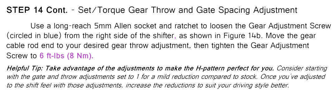

Then there is this tip in the Install instructions which seems to contradict the statement on the box.
11th Gen Honda Civic Acuity Instrument's Short Shifter 1763849683475-vt
I know I've spent way to much time obsessing over this. I just want to know stock setting so I can test things out. I'll send Acuity a note and see if they can shed some light on this.

Still waiting for a response back from Acuity, but from what I've been able to work out, the claims made on the box MUST factor in some combination of height/throw/gate settings which is not very clearly stated.
Furthermore, the addendum statement in the install guide seems to indicate that there is no combination of throw/gate/height that will 100% match the stock setting. This is understandable.

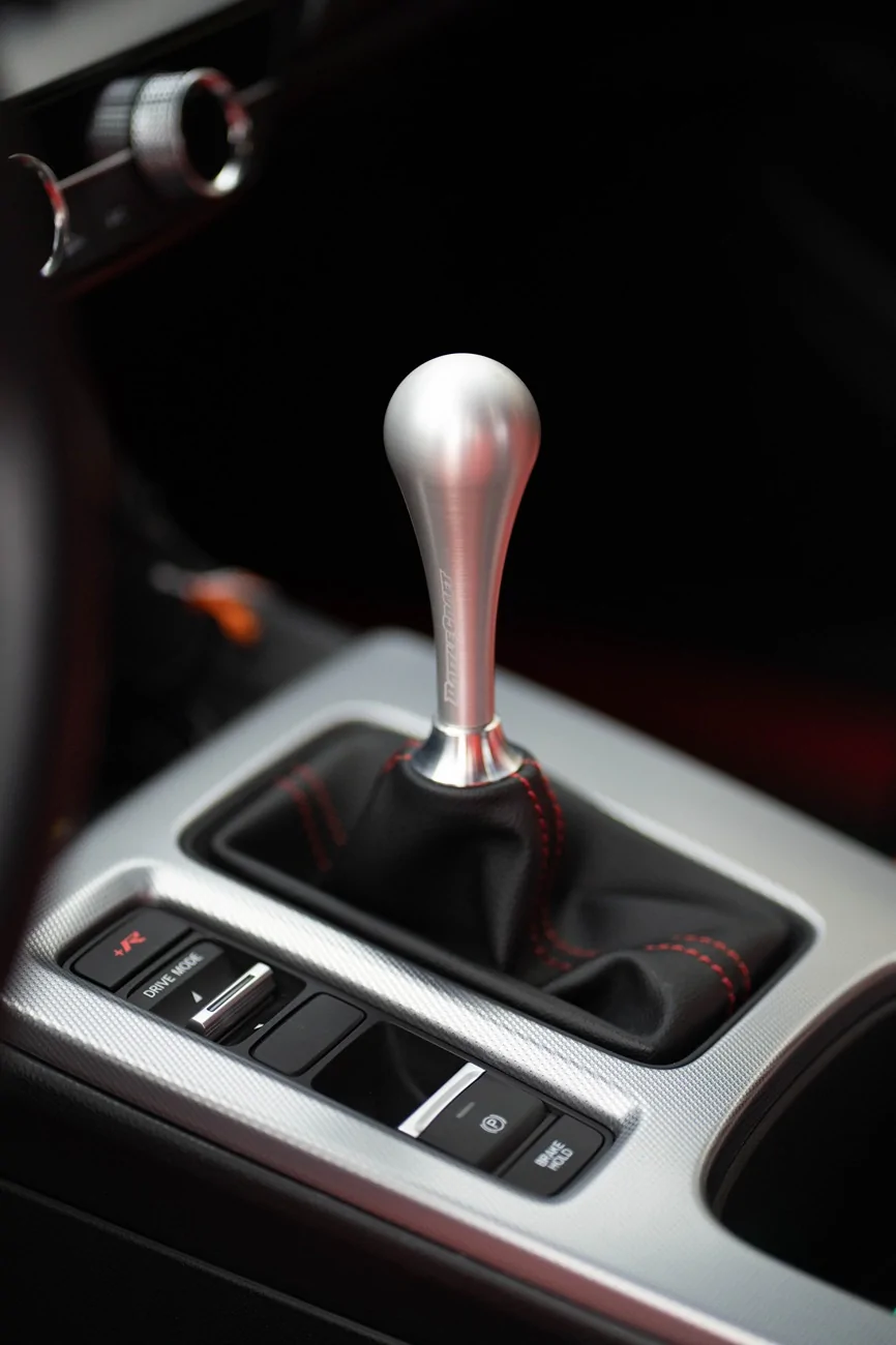

Just installed this shifter after grabbing it on the Black Friday sale.
I haven't seen many reviews leaning towards the neutral side so I thought I'd chime in.
I found the difference to be more tame than I expected but I think that's mainly because of the shift knob + collar I'm running. I'm running a 40mm Battlecraft knob + the Seeker shift boot collar. On the stock shifter, once I changed the collar I noticed things got much notchier.
Fast forward to installing the shifter yesterday, the difference isn't largely noticeable to me other than it being more difficult to shift since it's new. I figure I may need to do the bushing upgrade as well to fully get the experience but if you're running a relatively thin/small knob already without much dampening on stock, you may not feel as big of a difference like myself.
Also even when adjusting the gate spacing, 3 & 5 feel too close. I have to adjust it a bit more.
I do think it's still worth it if you're looking for adjustability though
