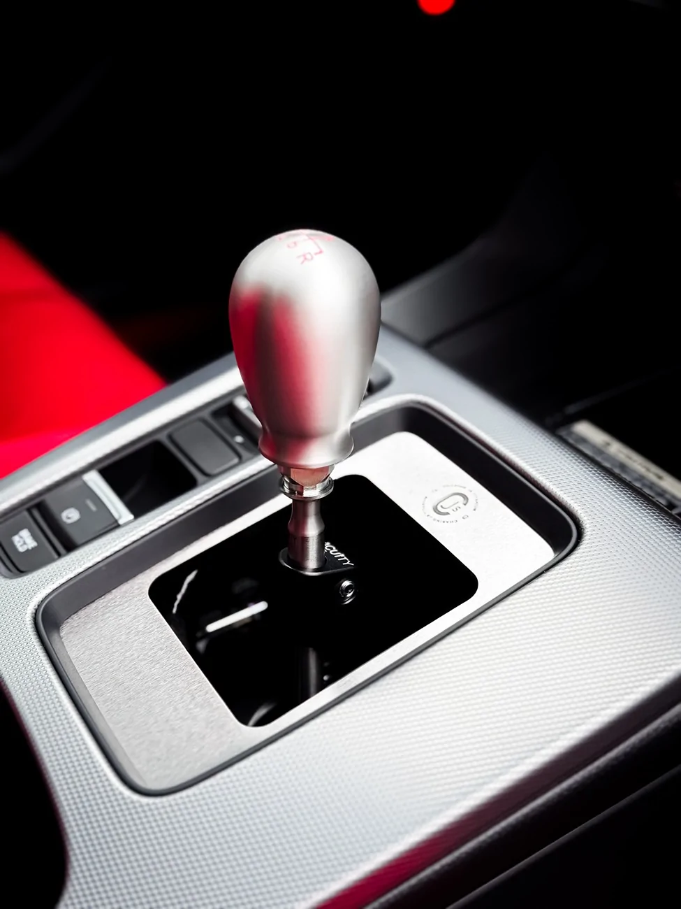

Installed mine a couple of weeks ago along with ChasingJs Shift Boot Delete Plate, going to install the Acuity Cable Bushings when I do my PRL intake this week. Dialed it down as much as possible (gate, throw and shifter height). At first, it was a bit too crazy, but now I'm very happy with it.

Looks great 👍
