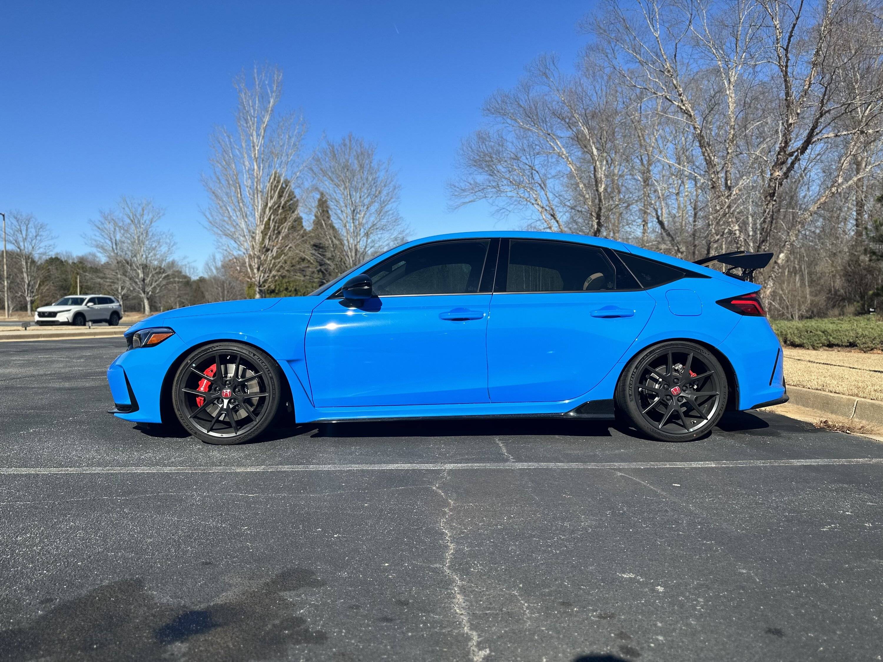

11th Gen Honda Civic Aftermarket Springs Thread ACE269E3-7DD6-48CF-A335-911B5B64A594
Swift springs and no spacers.
