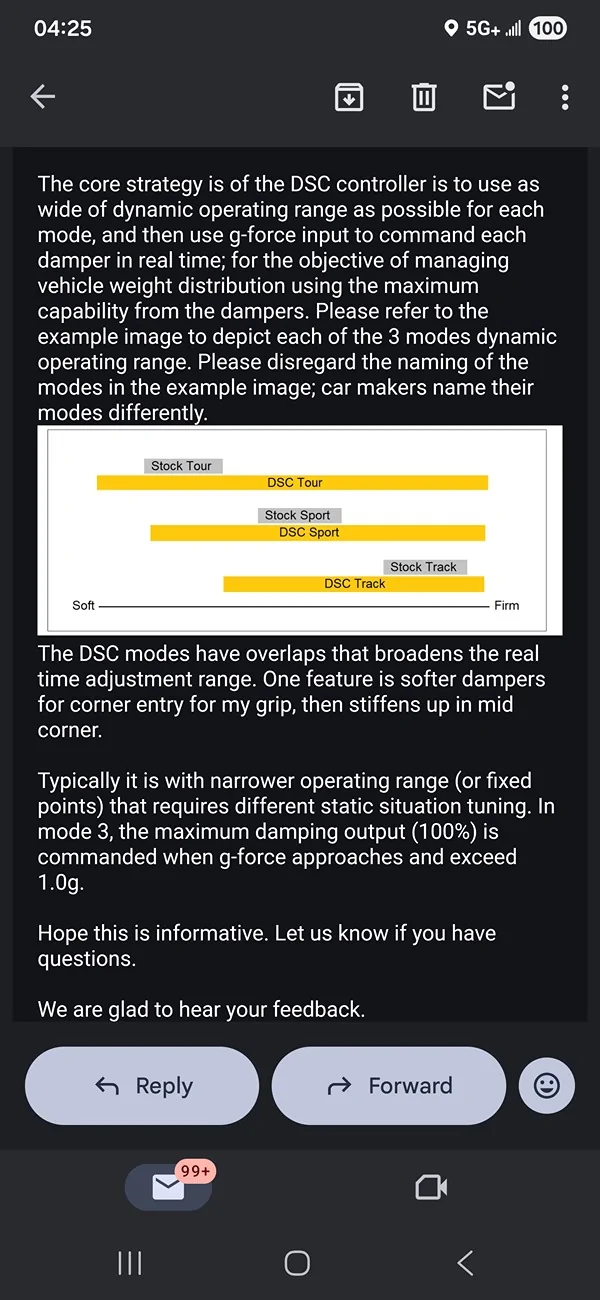

Regarding the DSC controller. I have this, and from my time with it, the results have been awesome. Others have alsp advised that it is great as well for track and road use. I have attached a photo that was sent to me by the company to visually understand what it gives you out of the box. You can also customize the settings if you know what you are doing. It is on sale right now for $995.00. I am not sure what specific brand of coilover you are going for, but I doubt they are $1000.00, and if they are, they are not going to do you any favors. If you have priced Nitron, Ohlins, RS-R, or AST, you already know the price point of coilvers for our car. As far as I know, RS-R is the only company that makes a bolt-on active suspension for our car.

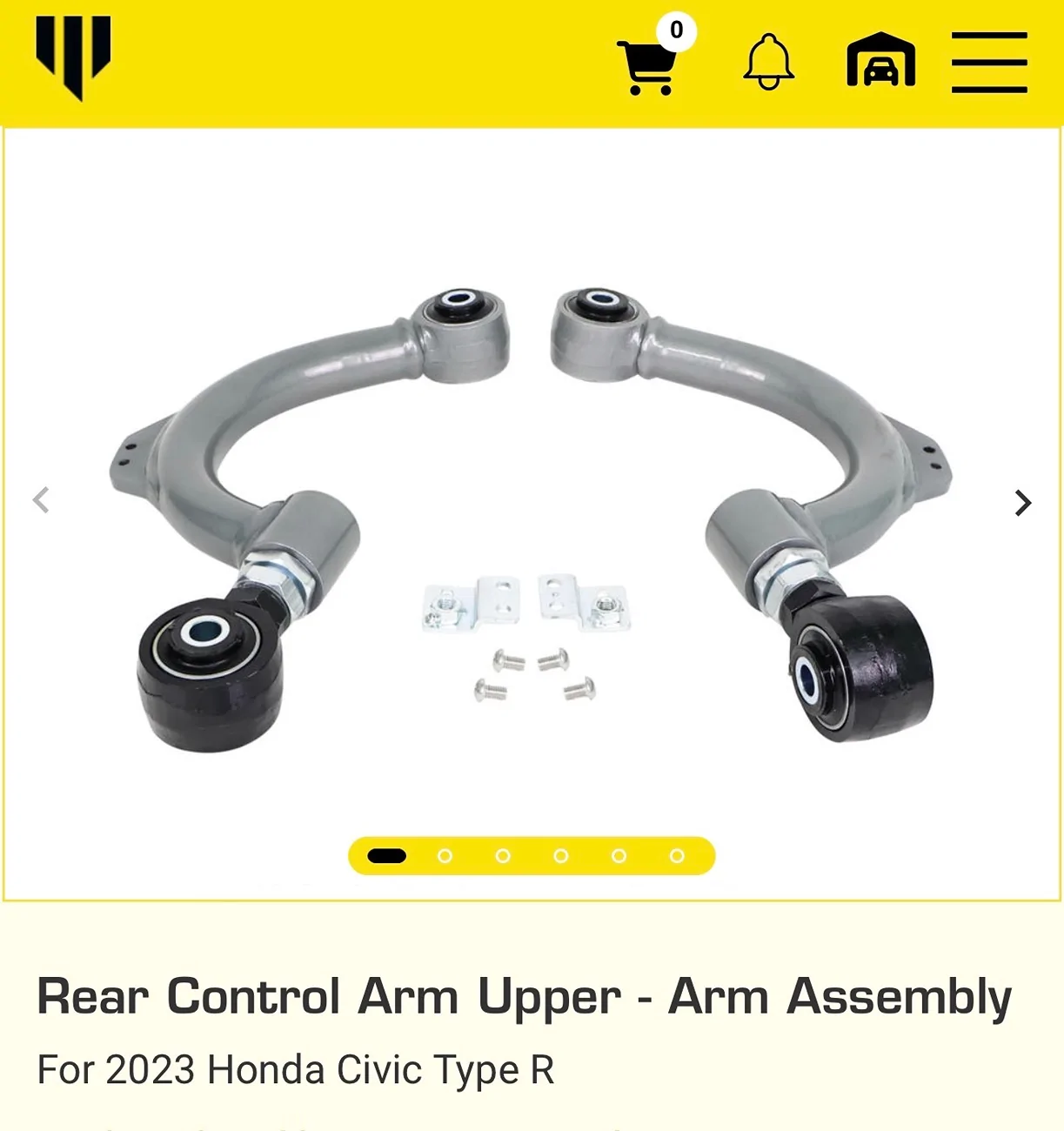

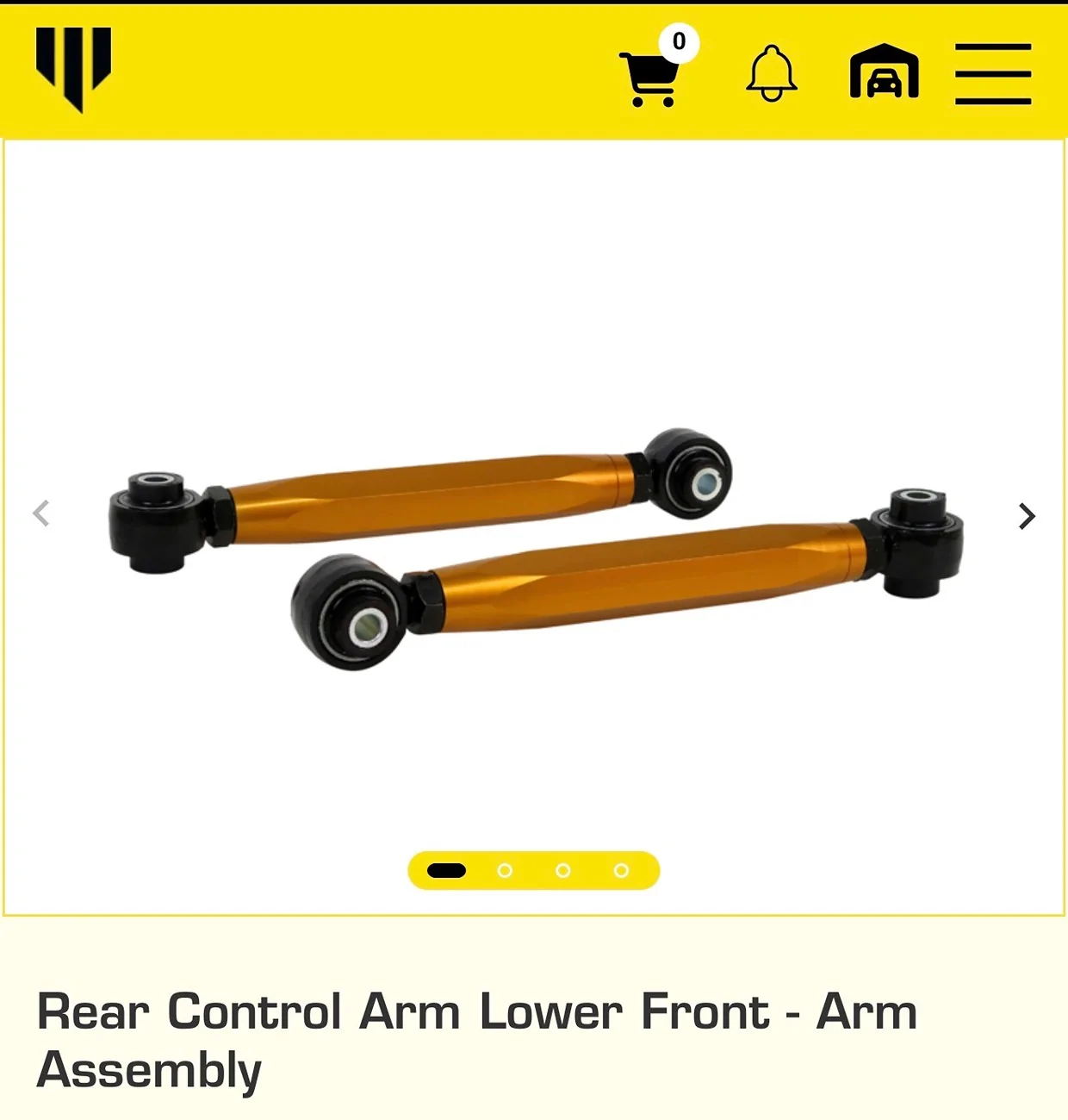

Thank you for that recommendation! It will definitely help me get on the right path. If I can achieve the rear adjustment, I’ll go with the Wunderladen Racing camber/toe arm. I’ll probably order them in the next couple of days—I just need to figure out first if the alignment shop won’t charge me twice for the alignment 😂.

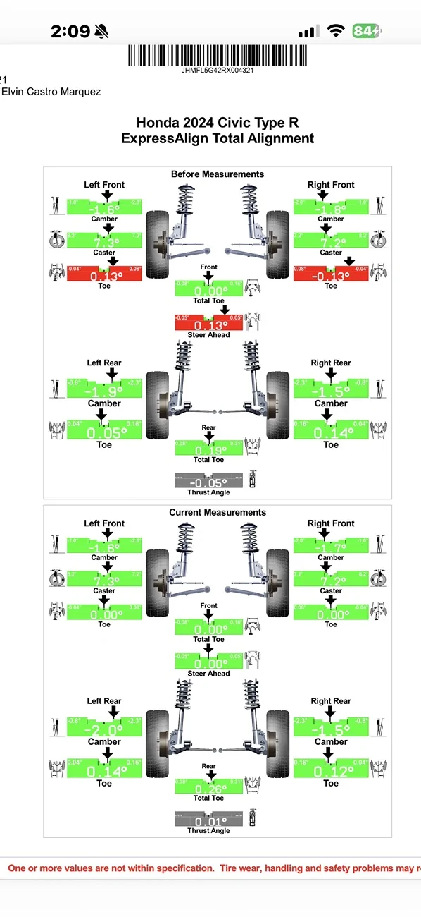

Am I the only one itching to know what his current alignment is. Cant wait to know.
I found the last alignment sheet. I hope this brings more clarity. The top part shows how the Honda dealer returned the car after the steering rack replacement, and the bottom part shows the alignment from the independent shop that I had been running with the whole time.

Ok. Thats awesome you found that. That gives you valubale data. Well, when you go and have it checked again, if the readings are the same. There is nothing wrong with the car whatsoever, as these readings are well within factory spec. So, how to get more life in your tires. You could go down the road of buying all the adjustable components to be capable of dialing the camber, toe, and other variables specifically to your liking. However, that will be a little pricey up front, but will save you money in tires in the long run. The other thing is to drive the car more aggressively in the curves, however, I imagine they are hard to come by in Texas. Always track days too.
But seriously, the alignment shop may be able to get you about .5° positive camber in the front. Not sure about the rear. This will "help" but not a overall fix. In addition, you could also try a more street focused tire option that is designed less for high speed and more for road durability.
From what I am seeing online. There are alot of reports of premature wear that resembles yours exactly. I dont think anything mechanical is wrong with your car. I dont think replacing any form of bushing is going to fix anything. Buying and installing adjustable suspension components to expand the adjustability of the suspension for your particular use case (daily/highway) is really the only true solution for maximum tire longevity.
Hope this helps releive you in a way.

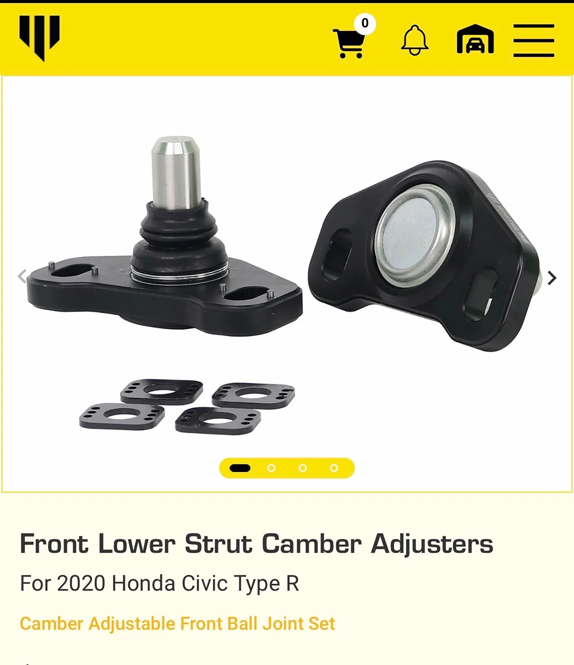

I really, regardless, ended up going with either the coilovers or the lowering springs. I will definitely take that advice, and as I mentioned, I will now be going with Continental DSW06+ tires. I will also go the fully adjustable route, just like I did on my previous Hondas. Is gone to be expensive as you say but definitely worth it and will be doing it as soon as possible to avoid future headaches.
Id not do camber ball joints if you don't plan on going to the track. You have no control with the BJs, either its the same as currently or -1 or -2 more and all could put more wear on your tire for street driving. If you do -1 (middle setting on the BJS) and push pins out you get like -2.5 degrees of camber which is street friendly but still less than pushing pins in and getting like 1.9.
There are benefits of more camber but if tire longevity is on your mint not something I would consider.
