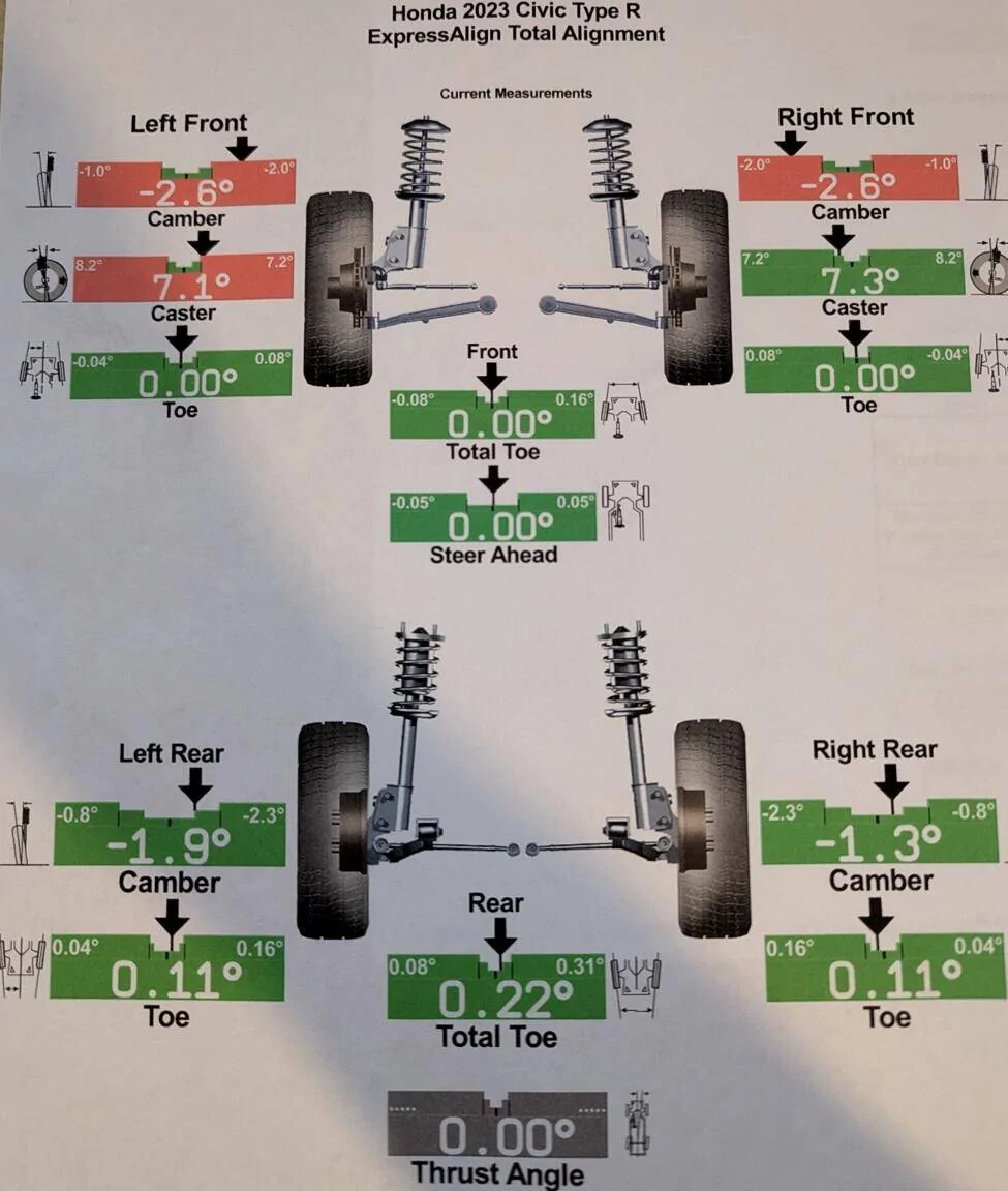

Installed some adjustable ball joints and went for an alignment. Would love some feedback.
Doing my 11th track day on this car this weekend.
11th Gen Honda Civic Track Alignment Settings? Alignment - 11-5

Seems low camber degrees for the balljoints?
Sounds about right for the middle setting on the ball joints, maybe the top is not fully pushed out to get a few more degrees. 2.6 is a pretty decent compromise for daily/track.
