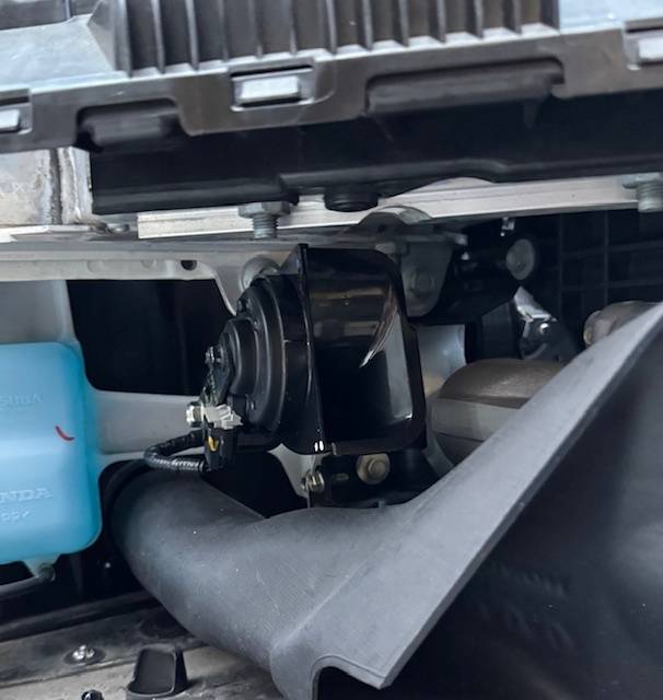

I upgraded to the Euro Horn on my 23 Sport Touring, not sure if horn placement is any different compared to the Type R, but I used this video as a guide and didn't even need to remove the bumper.

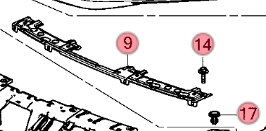

Out of curiosity, when you removed that metal piece under the top of the bumper cover, did you have to tourqe it down? Might be a dumb question.

Bit of a bump.
I'm still debating on whether to go the OEM Euro Horns or a pair of PIAAs I had on my 10th gen.
This piece?
11th Gen Honda Civic Anyone Done Horns Yet? 1713544300210-kv
Nothing torqued with a torque wrench or anything. I just hand tightened it until it was snug and did an additional quarter turn.

This piece?

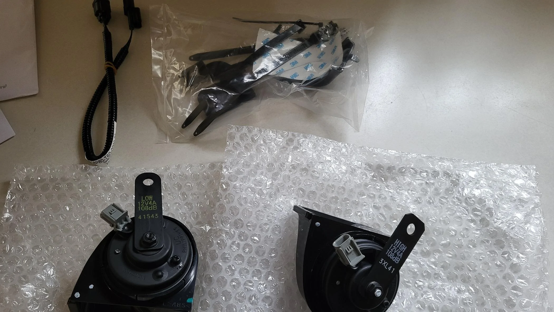

Just out of curiosity, did you install the low or high town on the lower position? The kit came with a bunch of parts and no instructions.
TBH I don't think it really matters as long as you get both horns installed, but I only used the harness extensions, and the beefier bracket for the lower positioned horn in the wheel well/bumper. No instructions are really needed, its all pretty much plug and play.

I have the same kit, it doesn’t matter which one goes where, just make sure the openings face down to avoid water intrusion. Once you get the bumper off you‘ll be able to figure out the brackets. Definitely use the new brackets as these horns are a decent amount heavier than the puny ones that come stock.

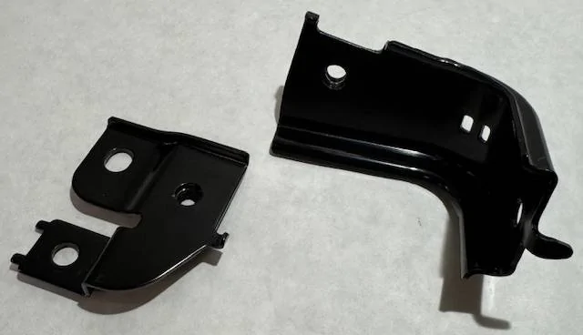

Installed the Euro horns today. I did not use the below brackets after wasting too much time trying to figure out how they were suppose to work without any instructions to reference:
11th Gen Honda Civic Anyone Done Horns Yet? 1743900988810-ja

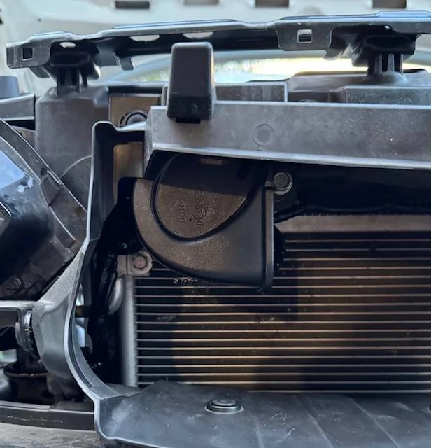

I just connected the Euro horns to the existing stock brackets. Here is the top one:
11th Gen Honda Civic Anyone Done Horns Yet? 1743901061152-83

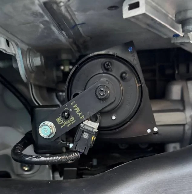

The bottom horn simply needed a minor modification to its bracket by drilling one hole to fit the notch in the stock bracket. Doing this allows for the horn opening to be facing down so as not to collect moisture:
11th Gen Honda Civic Anyone Done Horns Yet? 1743901213085-fx
Front view of the bottom horn:
