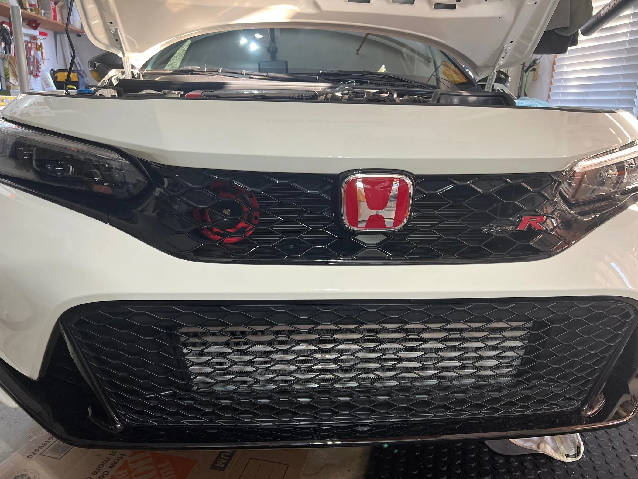

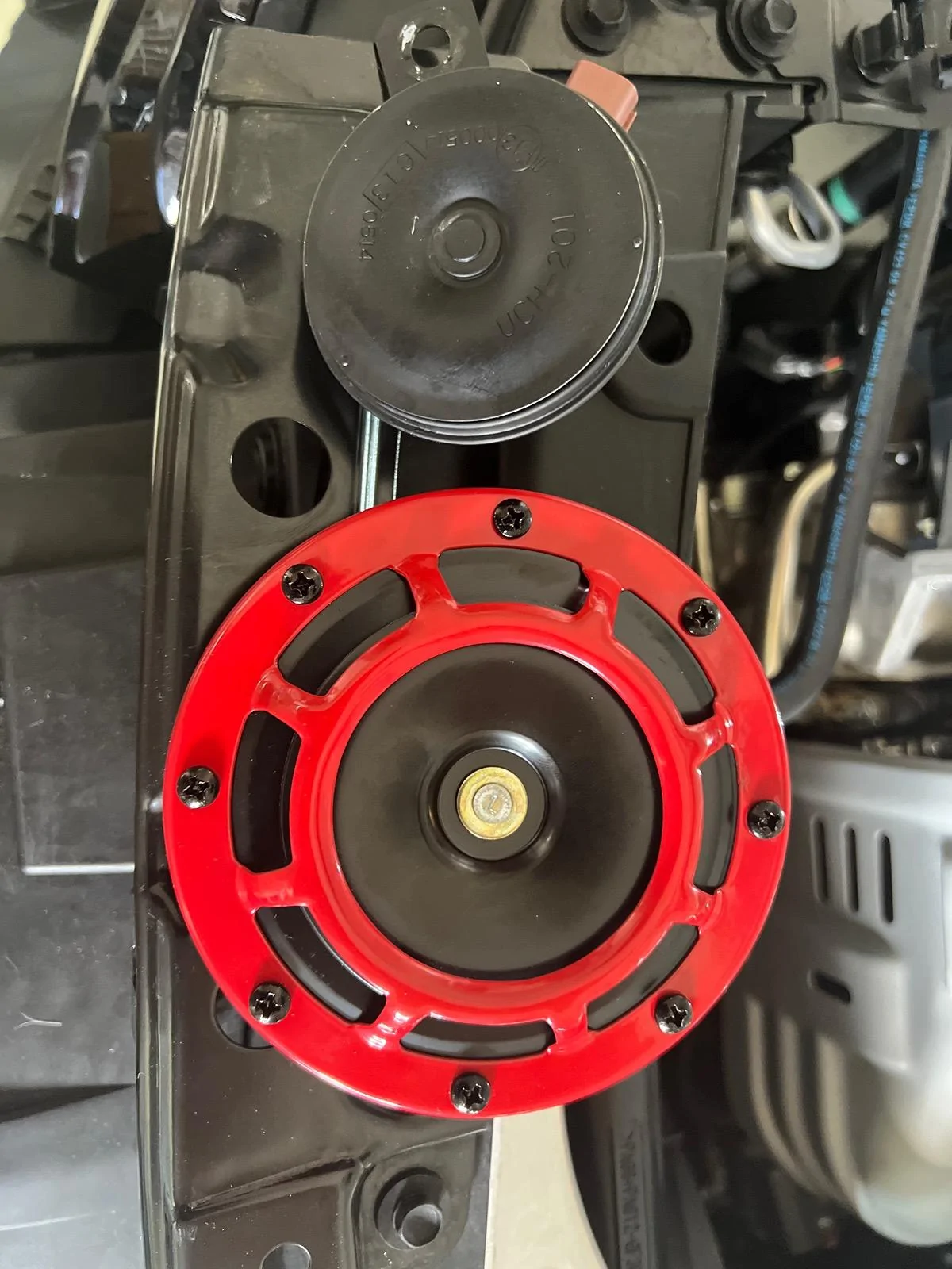

I did some Amazon horns. Much louder. Fraction of the cost Did have to make the mounting hole a little bigger on the horn adapter and had to get a 2 horn adaptor but easy as pie
11th Gen Honda Civic Anyone Done Horns Yet? IMG_7711
11th Gen Honda Civic Anyone Done Horns Yet? IMG_7712
