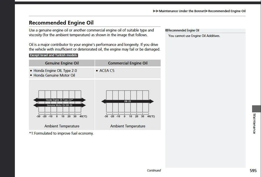

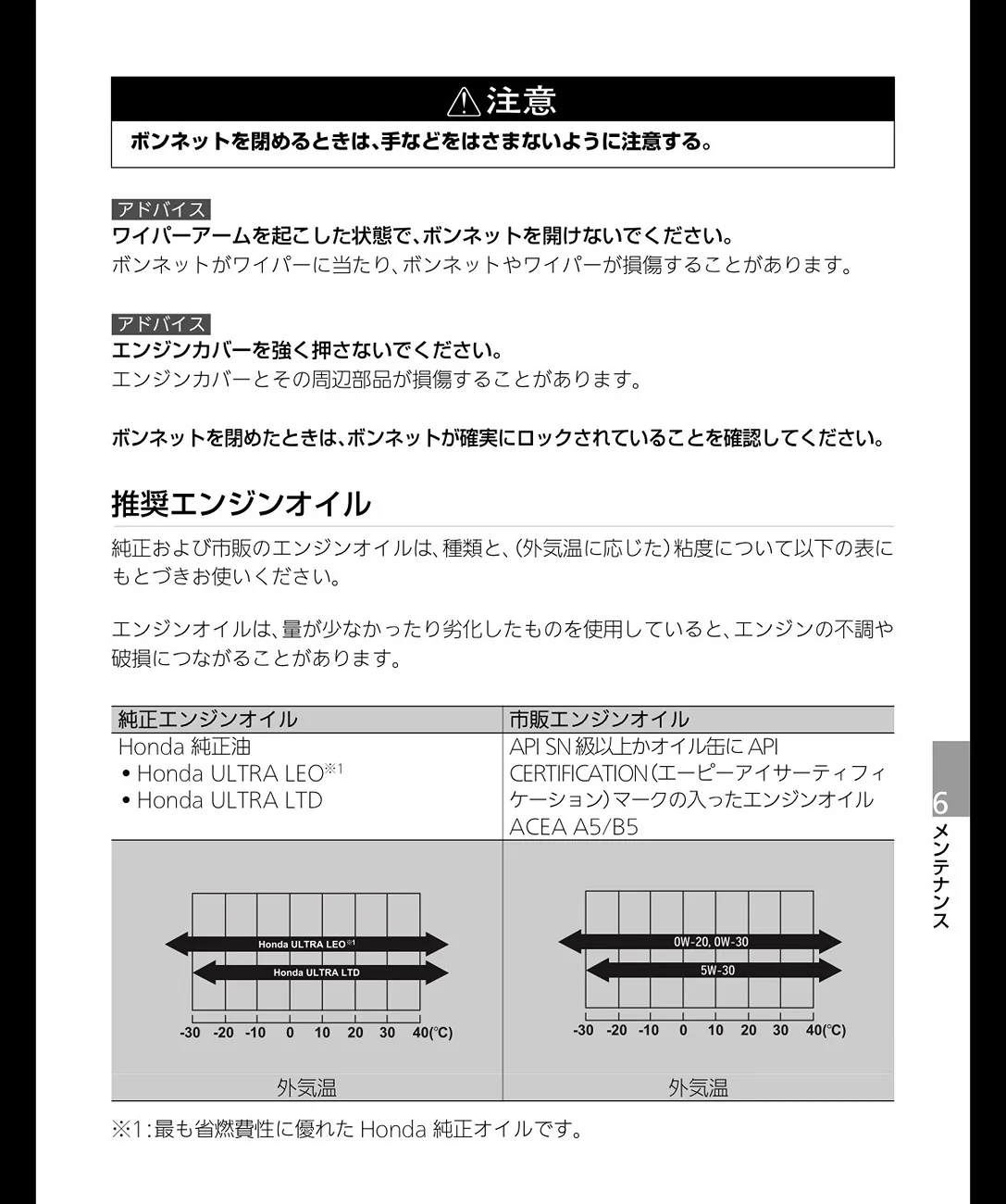

You'll find 5W-30 is fine per the European owners manual. Search Honda UK to find it. Engine internals are the same, regardless of location.
Only reason 0W-20 is spec'd here is for CAFE fuel economy. 5W-30 provides a superior film thickness, especially for high loads, which these engines are capable of.

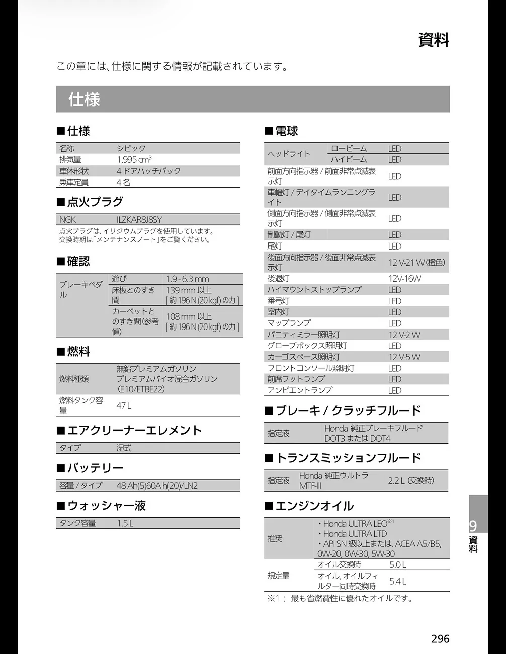

the UK manual only says 0w-20
11th Gen Honda Civic Anyone running heavier oil ie 5w30? Screenshot 2025-06-19 at 15-13-36 23 CIVIC 5D HEV (KE KG)-32T53601_01_weB COMBINED_compressed
