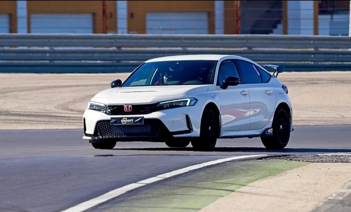

hi all!
I had the chance to go on my first track day since I got the FL5 last November and wow is this car capable (clearly the driver was the weakest item in the value chain here!). I was easily faster than more powerful cars as tuned TT RS and AMG 45S and then on the long straight they would gain on me. It is so easy to put this can in the right racing line. I had a great time. I also got to try the onboard telemetry and I have to say although I was in one of the preloaded tracks (Monteblanco, south of Spain), I had to manually set the finish line for laps to be recorded. What I could not get to work was the video from the phone, maybe you guys can help me, I use an android smartphone.
So to the point, after 8 laps pushing hard, my brake fluid gave up, pedal went to the floor and I had to pump with my foot for the car to brake, it was hot as you will see by the picture below. Of course, I got funny comments from other drivers as I had not replaced brake fluid for something like Motul 660 and had not done the brake lines. The feeling is scary and this car deserves better!
My dealership has offered me to flush the system and add 660 as well as changing brake lines for braided ones so long as I bring the parts in. I am doing fluid this Thursday but I am reading mixed comments on braided lines (not much of a change, don't do it when the car is new..). So couple of points where I could use your help.
1 - Has anyone experienced the same?
2 - Is it worth doing the braided lines? The car is only 6 months old.
thank you! pic for context!
