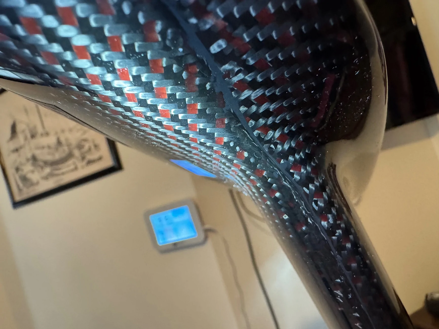

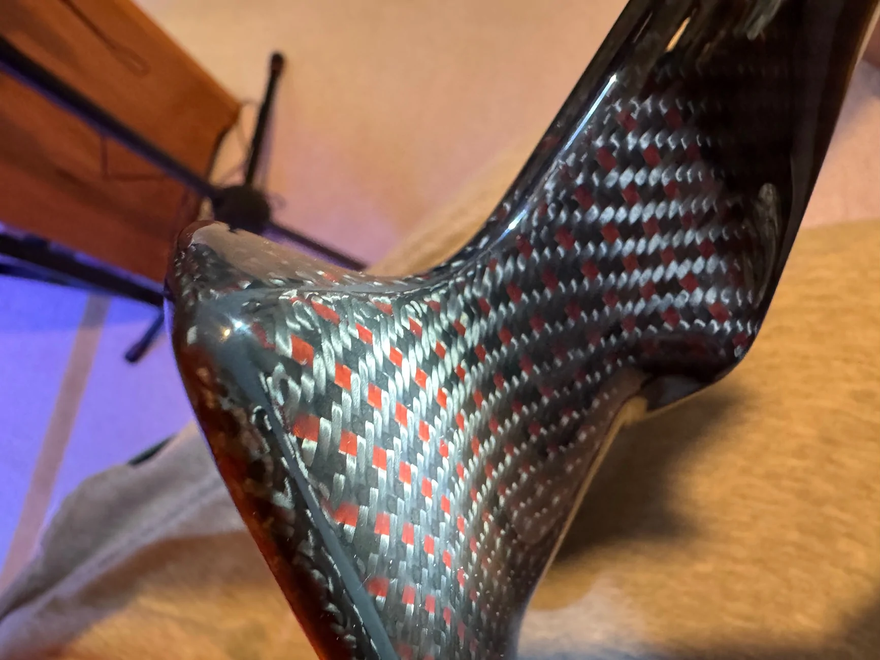

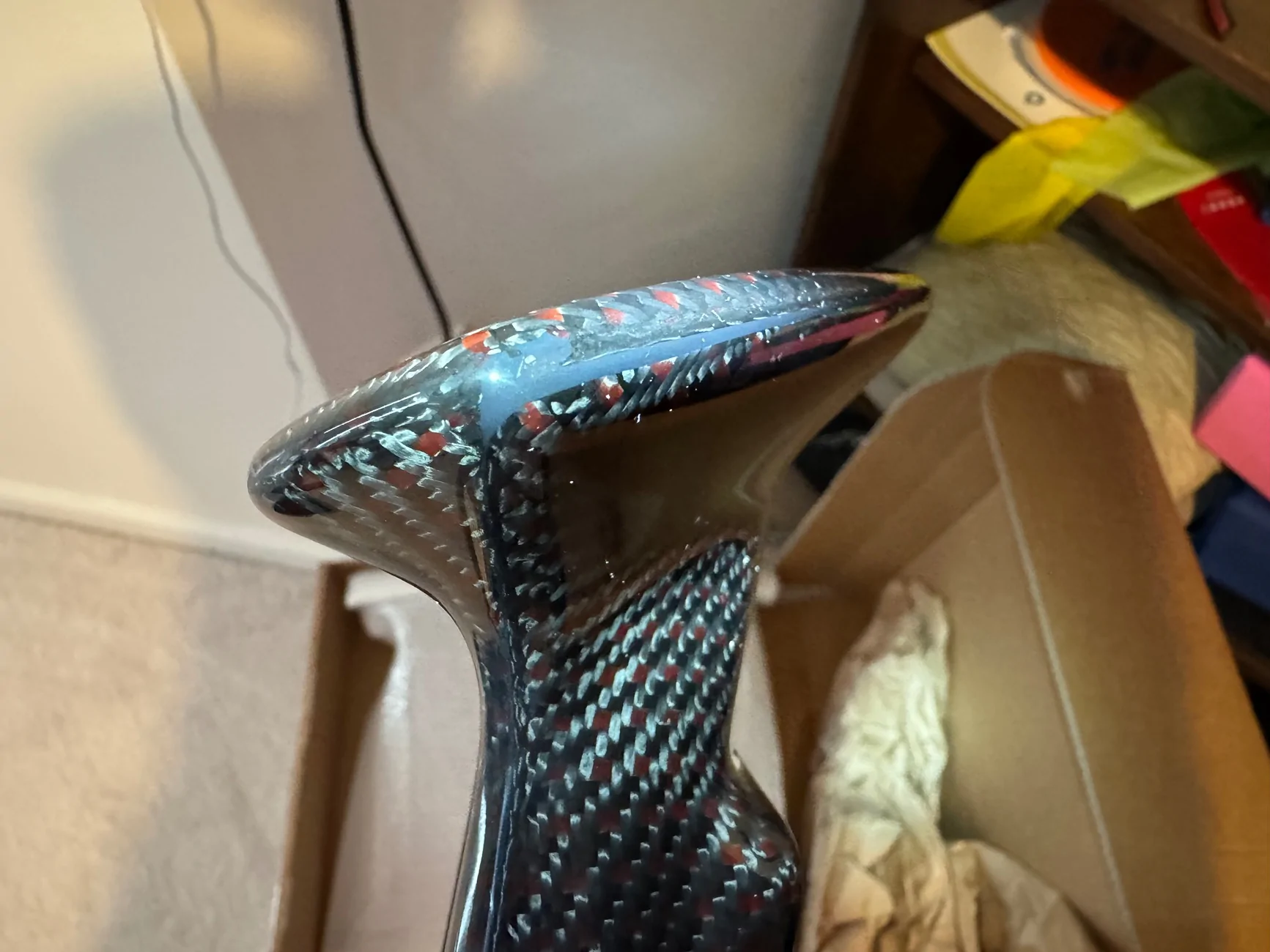

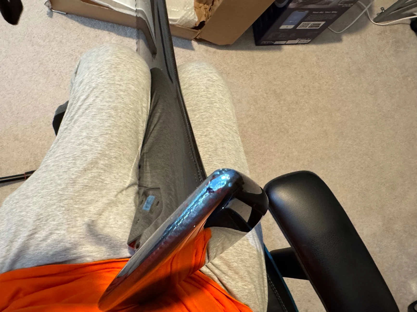

"New" spoiler arrived. As usual, the box was crushed by UPS, but ADP did add extra packaging that did help... Except this one was manufactured the exact same week as the last one and still has unacceptable lazy defects in the weave. They said they would order a new one from Honda but it seems like they just grabbed another one from their warehouse? It seems highly unlikely that a new one from Honda would be made the exact same week as the last one I had. Is it better? Yeah. Is it $2000 better? No, not really.

If its just going to be like that again, I would return it and get a refund. You'll probably have better quality from an aftermarket manufacturer.
I'm not quite ready to put the blame on all OEM parts, but there's definitely something up with this one production week. Plus, there's the new manufacturer. I'm going to call ADP and speak to the person who handled the exchange instead of just going by email and try to figure out what's going on.
I can also get it from the dealer and inspect it in front of them before paying for it. That at least cuts UPS out of the picture (if you can't tell, I really, really hate UPS for many reasons not part of this saga...).

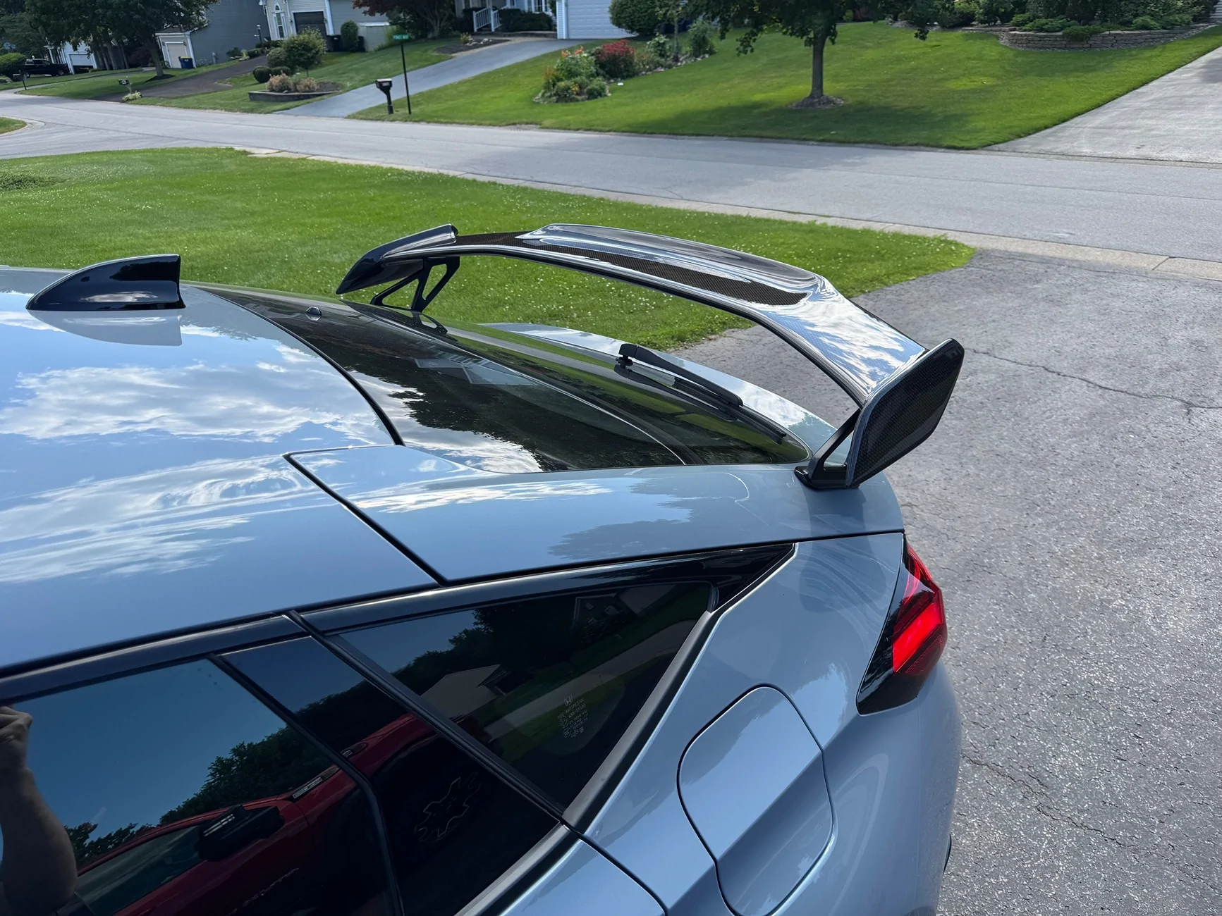

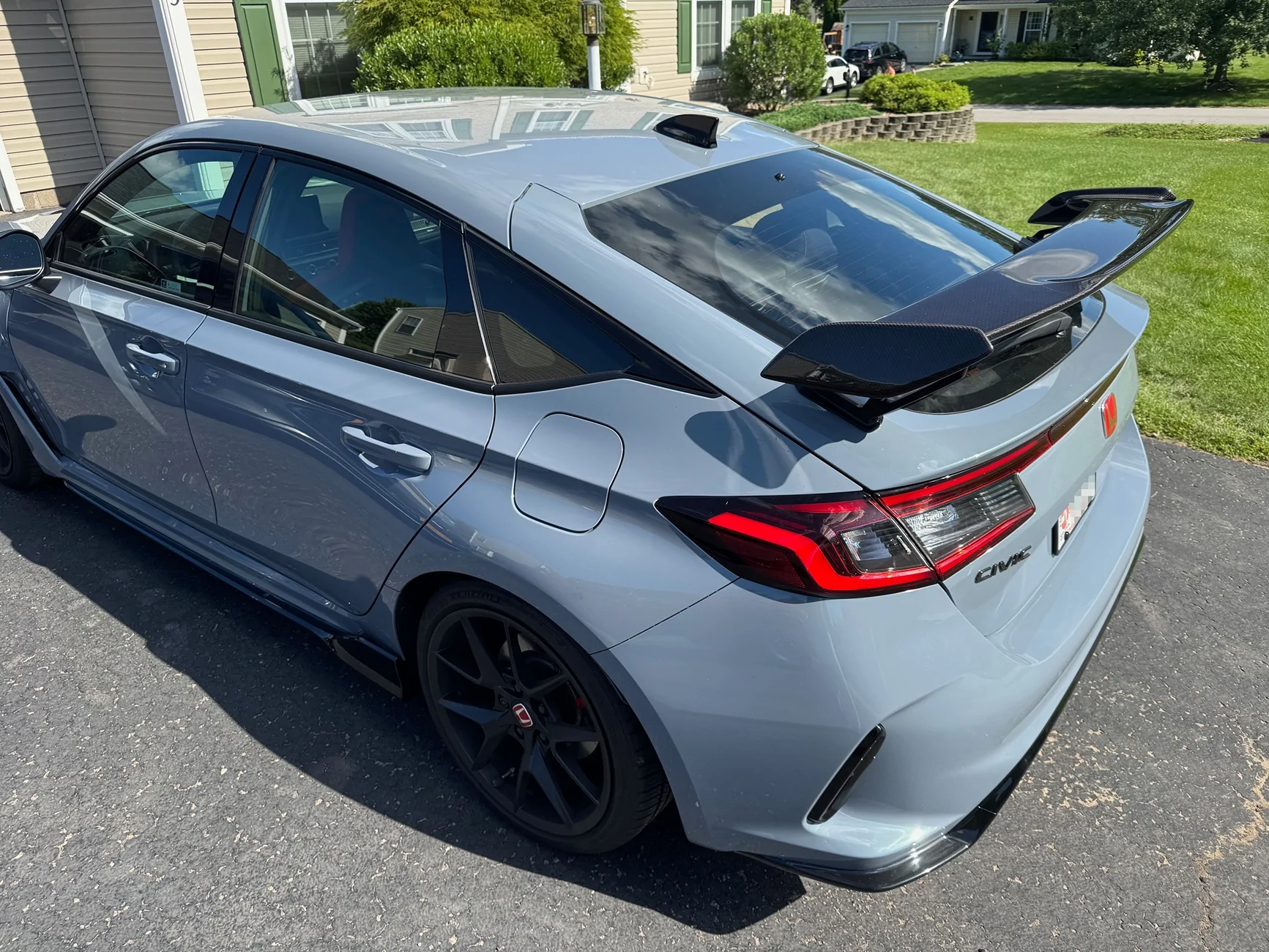

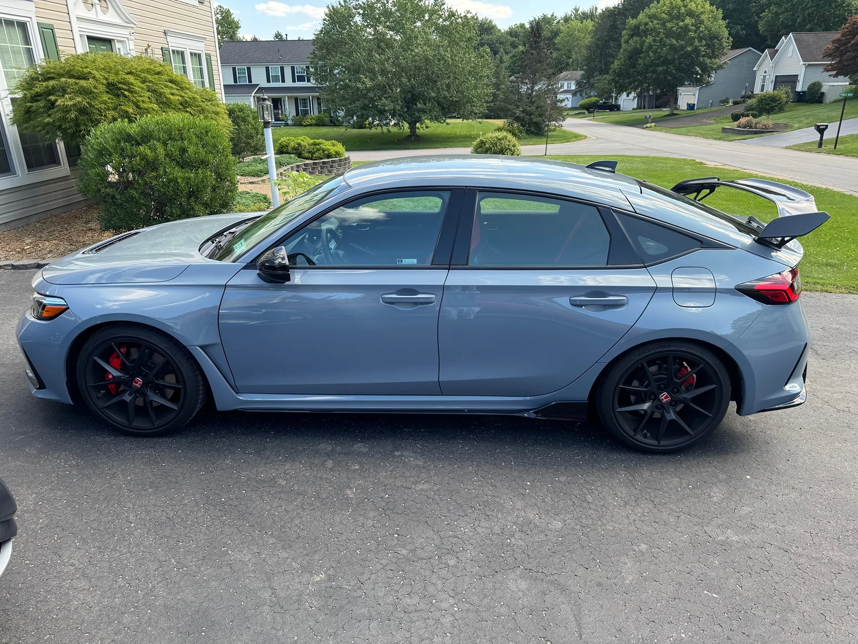

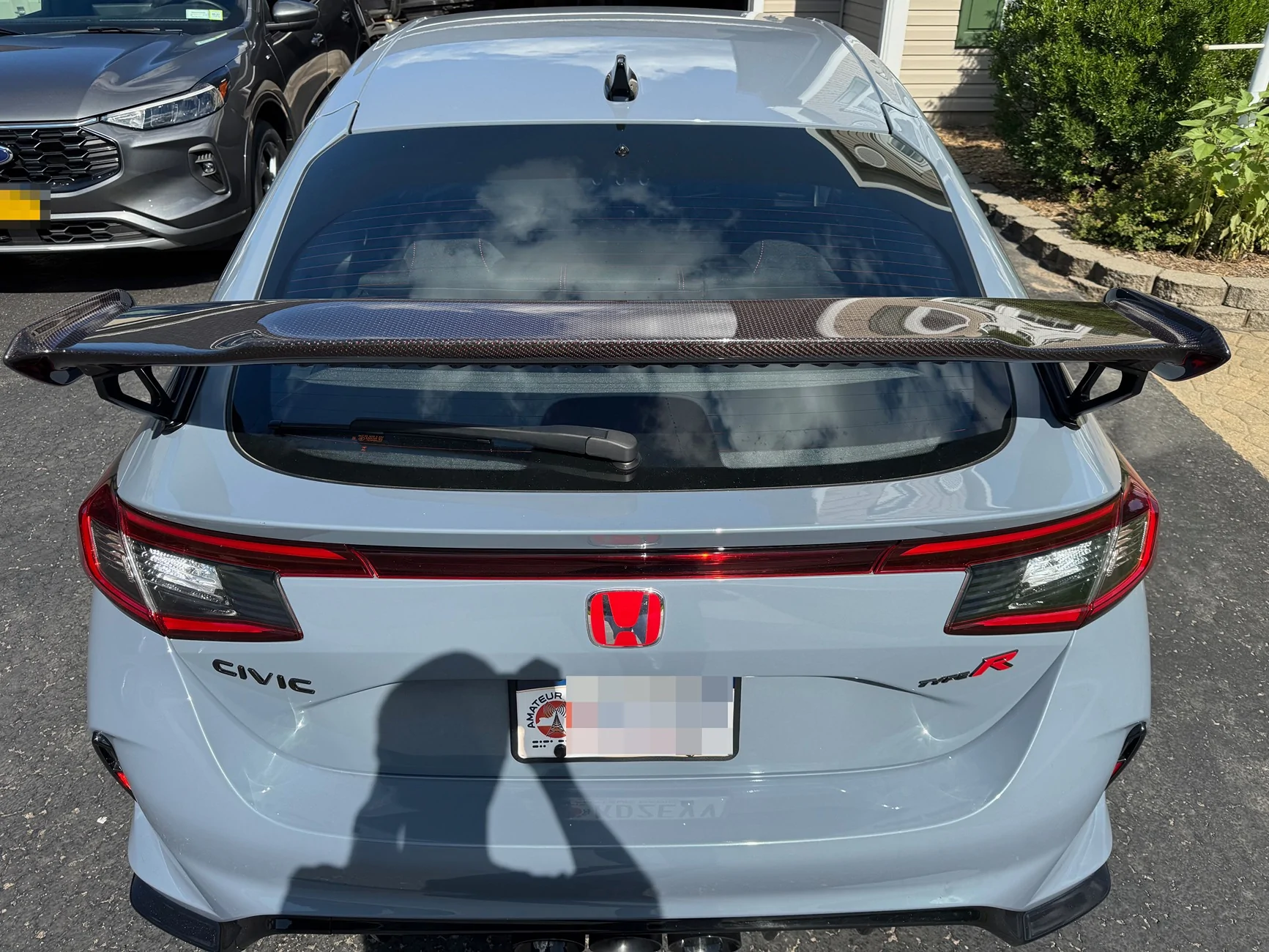

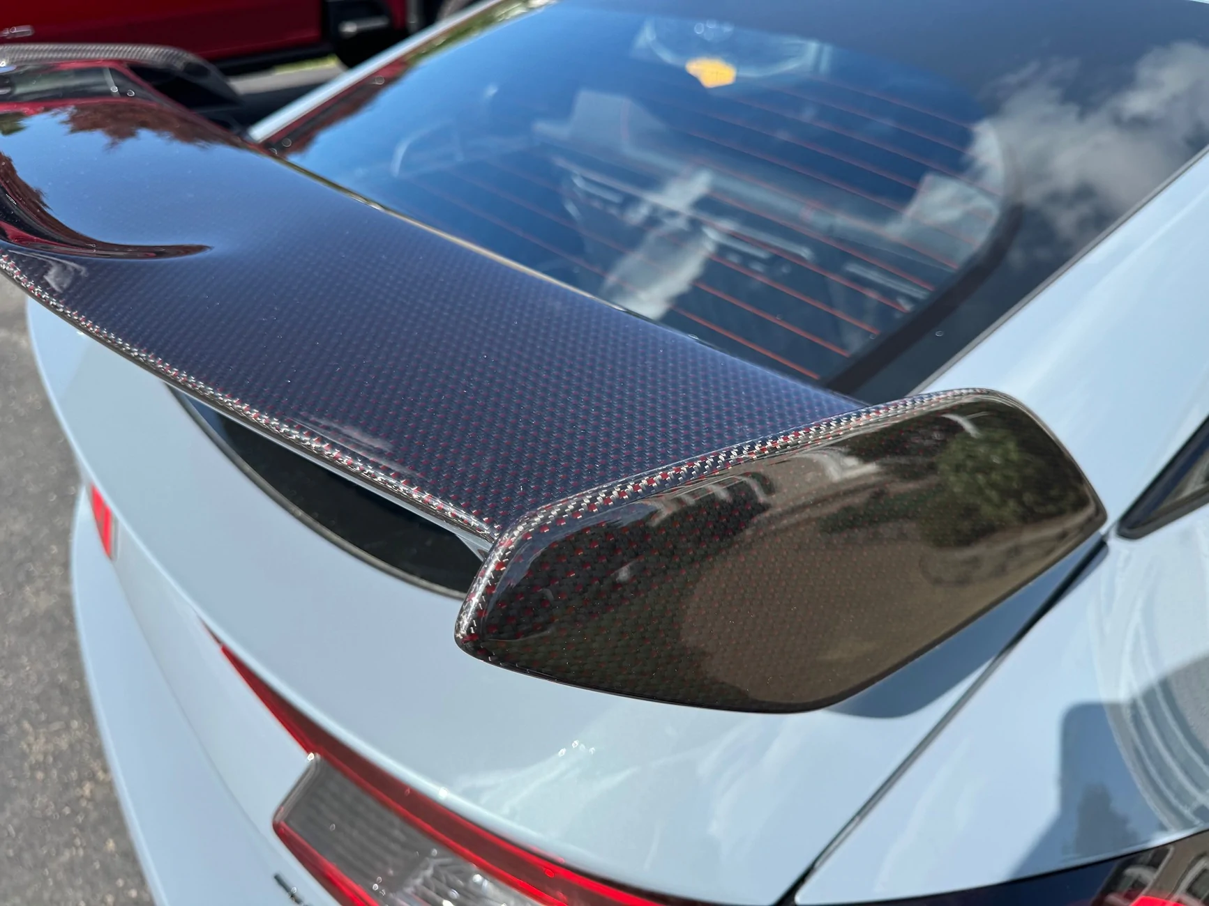

OK, so after speaking with ADP this was indeed the one Honda sent them. Apparently they sell the OEM CF spoiler fairly often and all of them came from Honda recently; they weren't just sitting in the dealer's warehouse for years before being sold. It seems Honda themselves are still going through a backlog of the Bucci parts, or at least the majority of the ones they have are still from Bucci vs the new manufacturer. Like @MooMoo said, the Bucci parts all seem to have varying degrees of defects because of QC issues.
That said, ADP said they would be OK with me installing it on my car to see how it looks, and if the defects are still noticeable they would give me a full refund. That's exactly what I did and... literally none of the defects I found while scrutinizing it with a flashlight are visible. I also couldn't find any defects in the clear coat, which seem to be a common problem, other than very fine swirl marks that I buffed out easily. I love the look of it as a whole so I'm going to keep this one. Note to anyone just coming into this thread, I'm talking about the second spoiler I received. Not the first one I showed in the OP which had ridiculous defects and damage everywhere.
